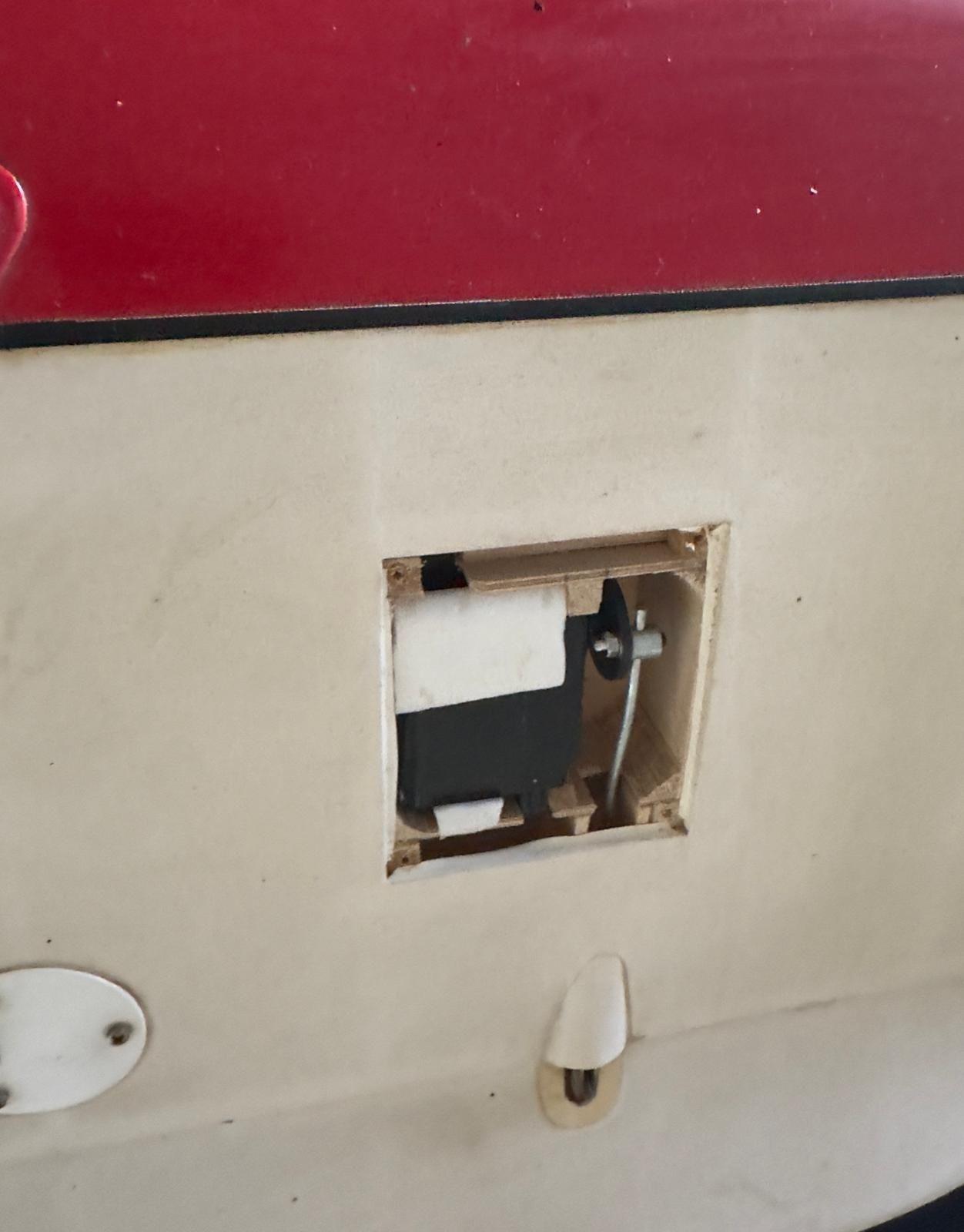

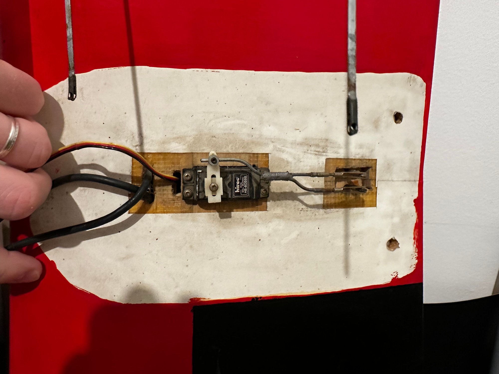

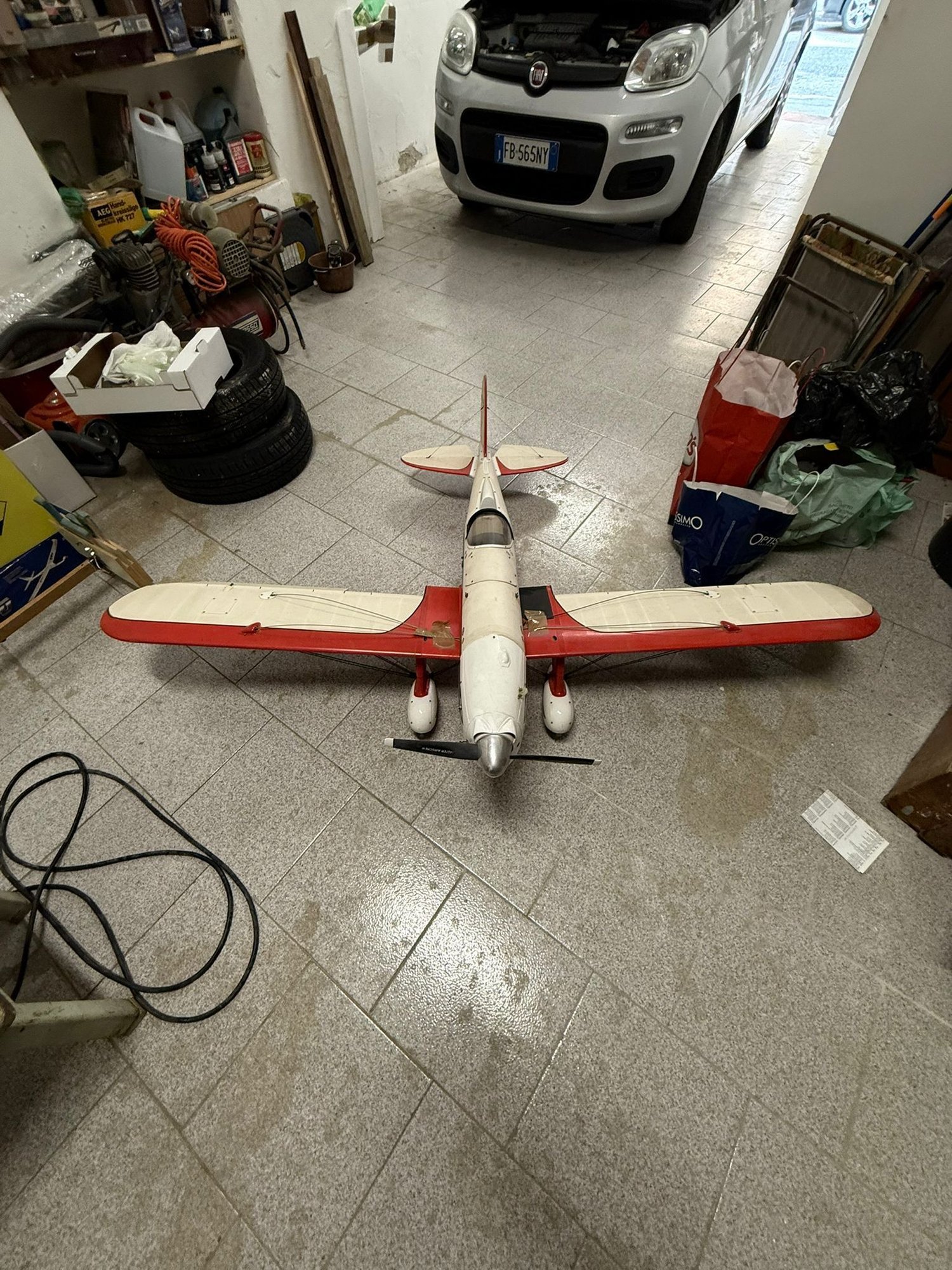

Hello to all,
I red most of thethread and I hope that someone can help me as I bought a “used” Ryan STA made out from the SIG plan and my questions are:
1- servos rating? Actually almost everywhere there are 6,something kg•cm servos and I’m questioning if it’s enough or even too much.
2- can I still modify the flaps from bellcrank to wing servo?
3- I’m planning to mount a Saito FG 17 or FG 21 instead of the Supertigre S90 so I must replace the fuel lines and tank I suppose but the person who buildt the plane didn’t ment to have access to the tank, can I create one in that area without reducing the strenght of the structure?
thanks in advance to everyone!
in attached some photo of the plane
(note how the alerion servo is sturdly fixed)
