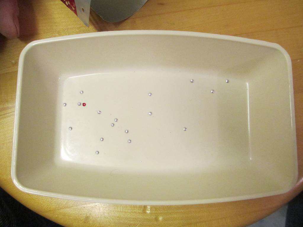

Few days ago Anthony (Waconut) had suggestedfor me tomake rivets from aluminum soda cans so I decided to try my hand at it. I took a piece of 4-40 rod and ground one end to profile the dome shape ofa rivet. After sliceing open a Coke canI used a hammer and started to punch out these tiny rivets. As suggested this should be done over some firm rubber which I need to get from the hardware store.The end resultare some pretty nice facsimiles of rivet heads. This is going to take me a while....
Note: If you notice in the first photo where I'm holding the 4-40 rod, you will see a small blood blister where I slipped with the hammer. OUCH!</p>

Old 01-16-2013 | 03:01 PM
  #914
acerc's Avatar
Joined: Sep 2006
Posts: 8,131
Received 5 Likes on 5 Posts
From: The Sunshine state, when it's not raining!
Default RE: Sig Ryan STA
If you did not draw blood it does not count. Blisters don't count!
Old 01-16-2013 | 04:24 PM
  #915
WacoNut's Avatar
Joined: Jan 2005
Posts: 6,604
Received 36 Likes on 33 Posts
From: Blanchester, OH
ORIGINAL: acerc
Robert I think you are correct, seems to be a little too timid with da hammer doesn't he
VJ,
Those rivets look great. You need to just set a few of them in place on the plane and snap a pic so we can see how they will look.

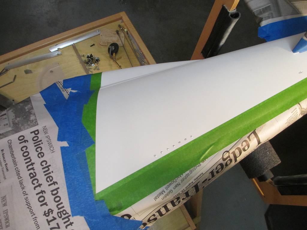

Ok I painted the last of the panel lines and this time when I peeled off the Frog Tape I paid carefull attention if thier was that paint blocker gel under the tapes edge. As you can see there was.
Now I need a little help, I made a comparisonfrom the rivets made from 4-40- rod and rivets punched from 2-56 rod. Which one looks better. To my eye the 2-56 rivets seem more scale for a 1/5 scale plane. Tell me what you think!

Old 01-17-2013 | 02:55 PM
  #924
WacoNut's Avatar
Joined: Jan 2005
Posts: 6,604
I think the 2-56 looks better as well.
You may wind up needing both sizes. I think I remoember seeing larger and smaller rivets in pics.

Old 01-17-2013 | 03:05 PM
  #925
acerc's Avatar
Joined: Sep 2006
Posts: 8,131
Like Anthony, I as well like the 2-56 size better. They just look more appropriate.
And the sticky from the Frog tape is why I like the Liquidmask.
