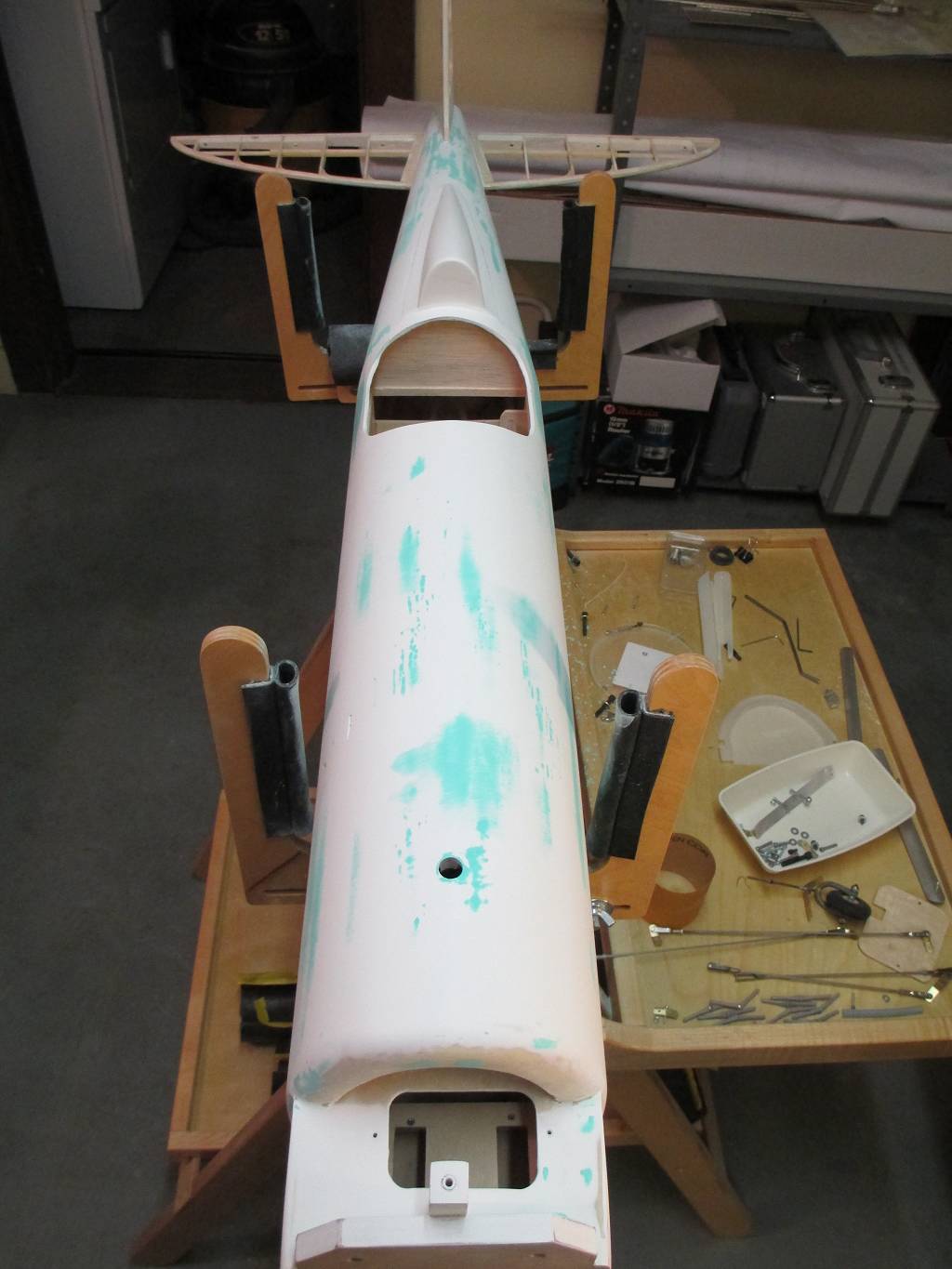

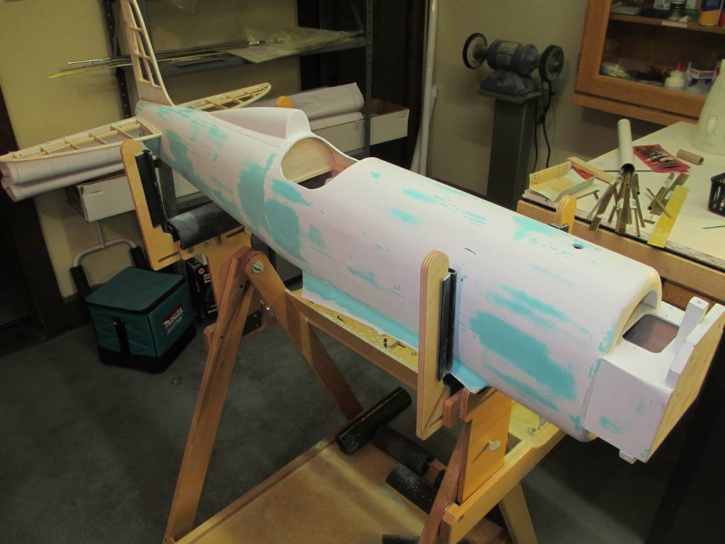

After hours of sanding I'm ready for the second coat of primer tomorrow. If everything goes well after a quick sanding I can start oncreating panel lines . This is what it looks like...

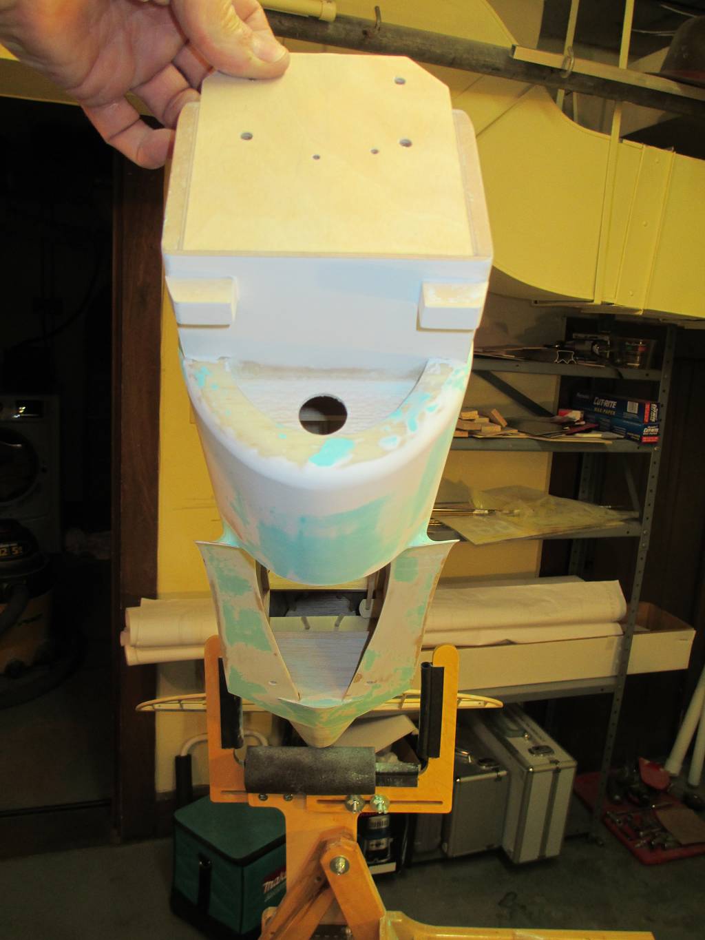

Dave, that's Acryl-Green Spot Putty that's used to fill irregularities such as pinholes and scratchesthat exist after the glassing process. It is made by 3M and it comes in a tube like tooth paste. You spread it with a plastic applicator (just like body filler) and it drys in about 15 minutes at which time it can be easily sanded.

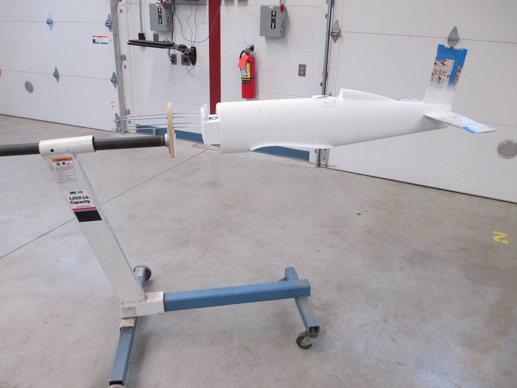

Just brought home my Ryan so you can see some photos now. I adapted the mount on my engine stand to holdthe fuselage during painting. It can easily be rotated which facilitates the painting process. I made it out of some scraps that was just laying around. Worked super, I will probably make a nicer mount now that I know it works so well.
