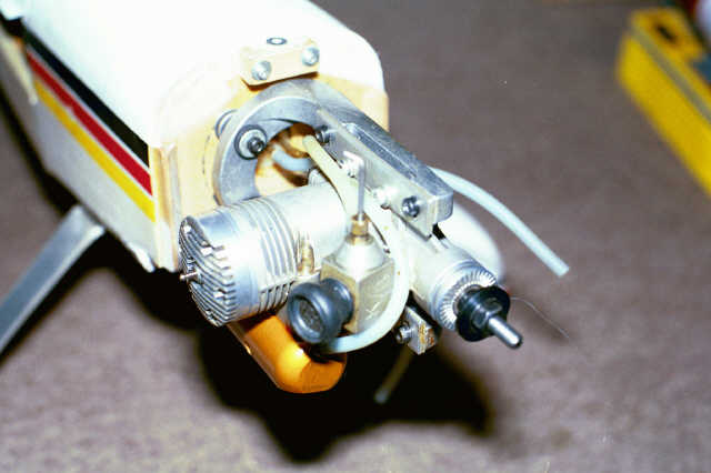

Hi, im building a Goldberg Chipmunk. The engine that I've selected is a ys 110. I know it is a bit overkill for that plane.
Anyway the stock engine mount is pure trash, and i could use some sugesstions on a good vibration dampening mount.
Any sugestions?

Here's a picture of the K&B 61 on my old Diablo. It is using the "Top Hat" shaped grommets for a soft engine mount.
Nyloc nuts are not the way to go, as the screw itself can wiggle and increase wear.
What you need to do is use a metal tube inside the grommets, sized in length to get the proper tension on the grommets when the screw comes tight. The metal tube inside makes the grommets last longer too, not having the sharp screw threads cutting them on the inside.
