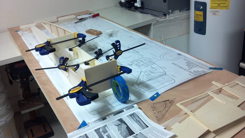

Well, it rained almost all day today, so it was a good day for cleaning the garage and getting started on my eindecker. I don't know how some of you guys talk your wifes into letting you build in the house. If mine ever lets me build or even store an airplane in my house, it's time to grab your kids, grab your guns and head for the hills because that would be a sure sign of the impending apocalypse. I digress. Got the plans taped down and covered with plan protector and assembled both fuselage sides. Next, I need to tape the two sides together and sand the edges to true them up to each other. That will have to wait until the boss lady's car is out of the garage. No balsa dust on her car. Period.

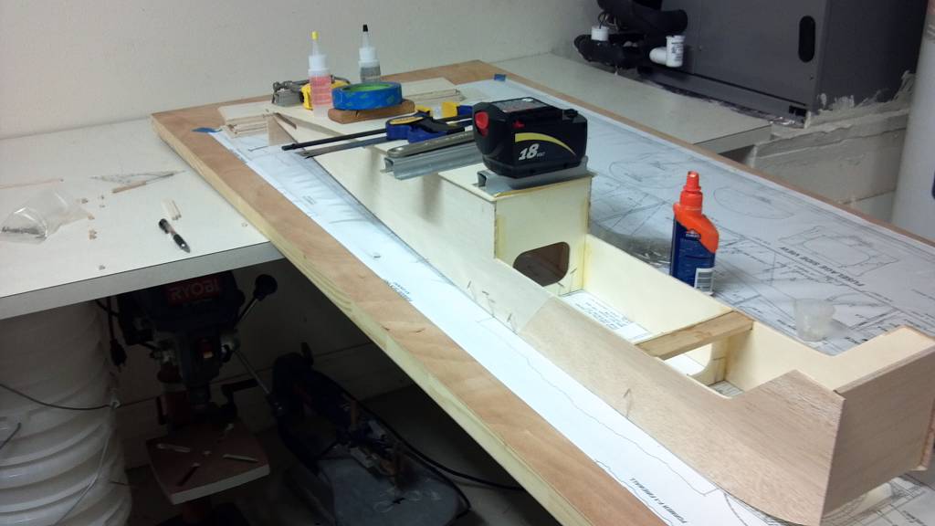

Another rainy day, so I got the fuselage side sanded to match, installed some formers, firewall and a wing brace.

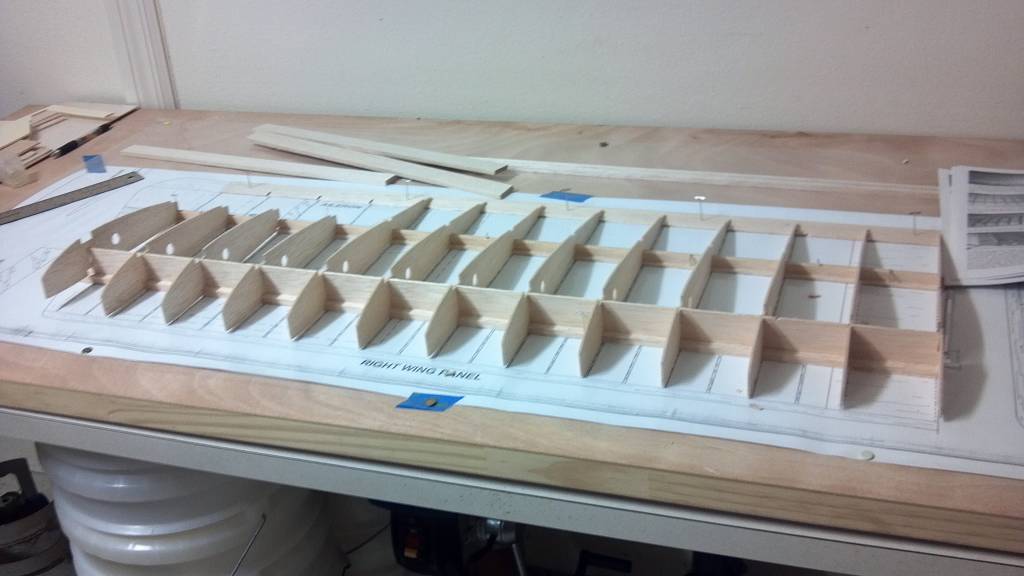

I started the right wing today. Got the plans pinned down. Spars pinned down, ribs fitted, sheer web fitted, trailing edge fitted. I'm too tired to glue any of it tonight. I'll check everything tomorrow before I start glueing. Also, I want to read ahead in the instructions before I glue anything. Just to make sure that I'm doing it right.

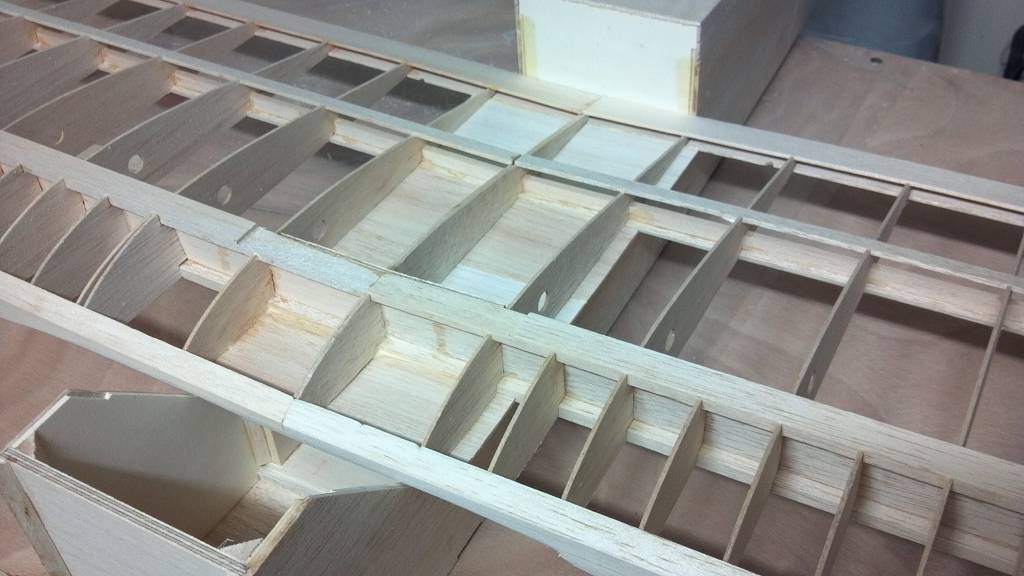

Well, I got the Extra repaired, mostly. I'm going to relocate my battery to move the CG back a bit, but that can wait. So, I got back the the fun job of building the eindecker. Funny thing is, I love building, I love flying, but I really do not enjoy repairing.
Got started on the left wing. Not much to look at, but I've got the fuse and right wing pinned up above my building board.

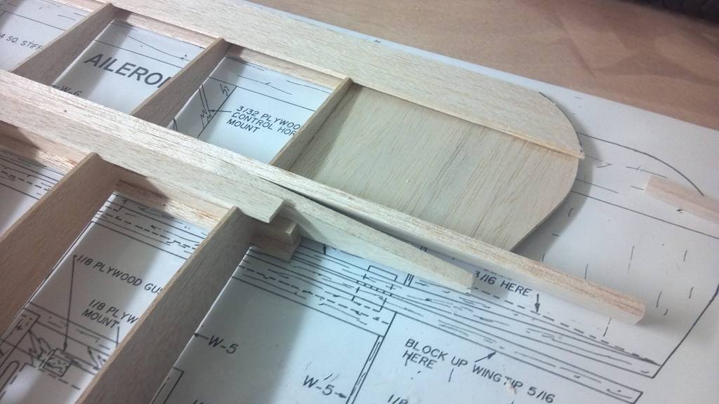

I did not quite finish the left wing tonight. Just need to finish up the wing tip. There is some shaping and sanding to do there. I've read where some builders thought that this would make a decent first kit. I'm not sure that I agree. While it is certainly not a difficult build, there seems to be some small omissions from the instructions. Glue this, remove that... If you've built a few kits, you know these thing will have to be done. Otherwise, I'm really liking the kit. It's almost impossible to srew up the wing construction, except as mentioned earlier.
