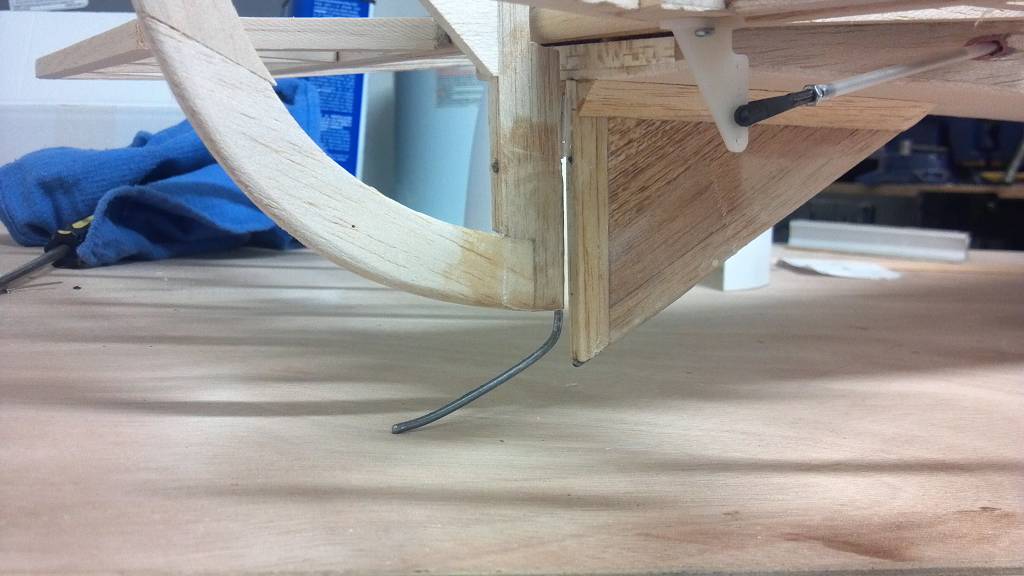

I added a triangular fillet around the base of the sub fin. Helps with the side loads from the tail skid.

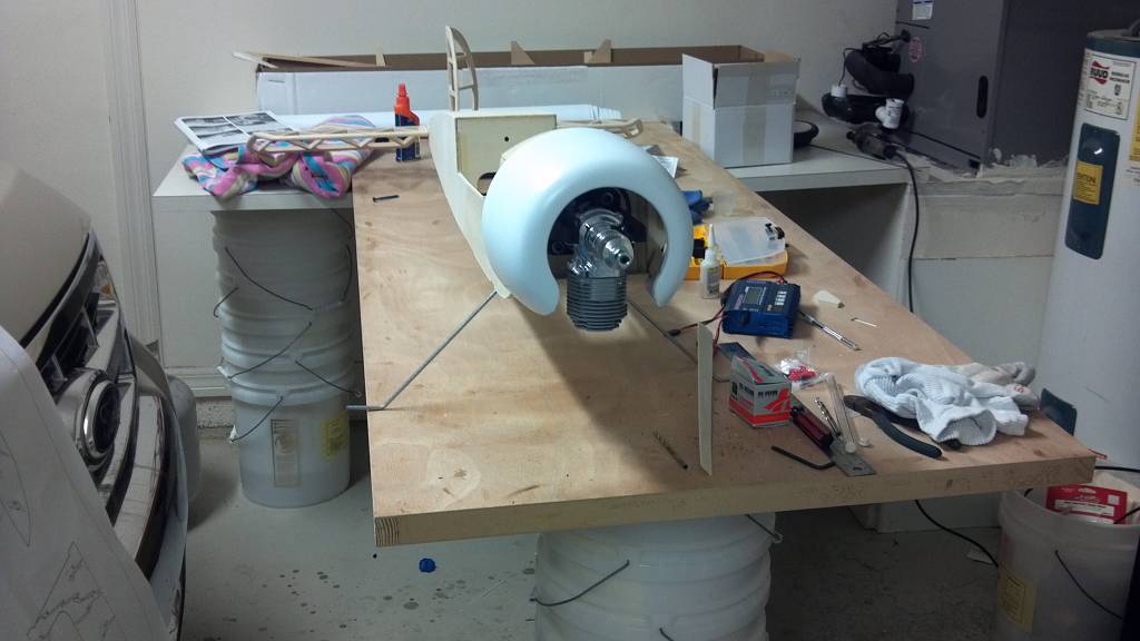

I didn't post anything yesterday because I got frustrated with myself and decided to take a break. First, the holes I drilled in the firewall for the motor mount were crooked, and I don't know how that happened. I drew the center lines on the firewall, good. Used the template that came with my motor mount to mark drill locations, good. Drill the holes, install blind nuts, install motor mount and crap. It's crooked. Instead of a nice inverted mount, it's off to the left a bit. Well, I tell myself, as long as the mount is center it won't be too bad. So I start playing around with the engine and cowl, and notice that the drive shaft sticks out of the cowl more than I like, douple crap, and I decide to call it a night. Today I figure that I can get a different engine mount and start over if Ilike, so I go ahead and mount the engine and cowl. Guess what? I not as unhappy with it as I though I would be. Tell what you think.

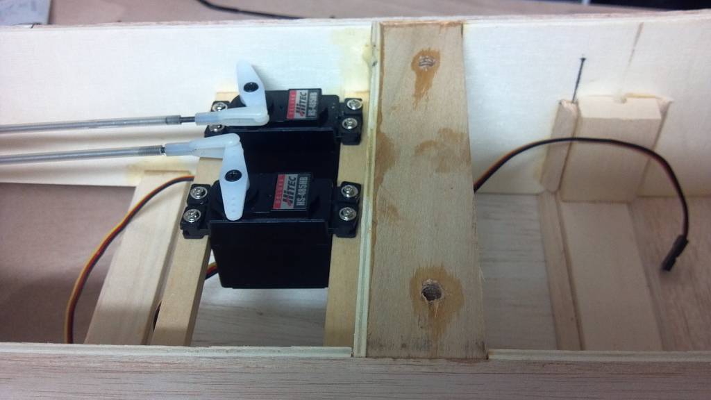

I'm currently installing servos and pushrods. Rudder and elevator are done. BUSA recommends placing them in front of the wing bolt down block for balance, but I figure with a big honking engine up front, radio battery, ignition battery and ignition module to place in the nose of the airplane, it wouldn't hurt to move the servos a couple of inches to the rear. I was having a real problem finding a way to work the throttle until I notice a machined throttle arm extension that came with the engine. Problem solved, but I will have to angle the pushrod to get the best movement on the throttle. Also, I'm going to have to pick up a ball link for the throttle pushrod.

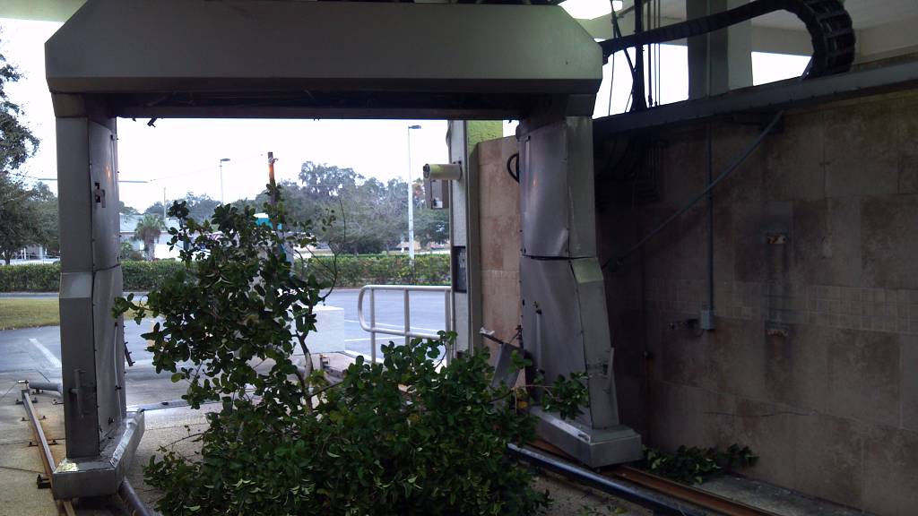

Sorry for the lack of updates over the last few days. Most likely, my building will be slower over the next few days as well. One of my businesses is a car wash. Friday night, some yahoo crashed through a row of trees and into the back of my car wash, destroying a machine that cost well over 100K. I'm working with the insurance company now to get it sorted out, but I've been busy and kinda messed up by it.

Just remember, its a machine and it can be replaced. At least the clown isn't going after you in court for putting a carwash in his way.

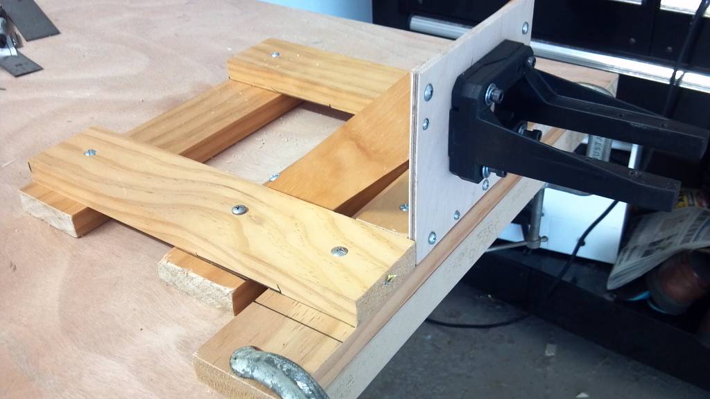

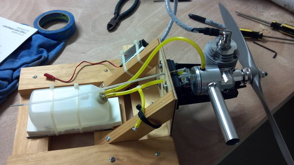

I built an engine test stand. Don't look too closely. No two wood screws are the same. That jar of leftover hardware from old household projects came in handy. I hope to get the engine out to the field next week and start her up. I'll post a video when that happens.

Engine is on the test stand and ready to go. I'm charging the ignition battery now and will take it to the field tomorrow. Video to come.

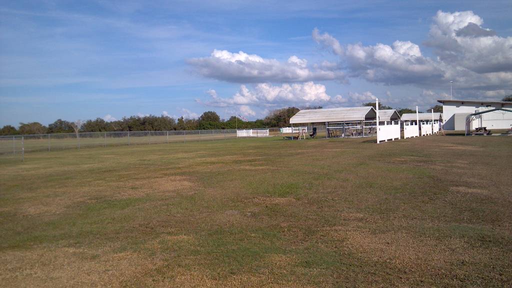

I did manage to get out to the field with my engine. I flooded it the first time I tried to start it, so I talked to some of the guys for a bit, and when I got back to the enigne, it started right up. I also posed a pic of our field, just to make you northern guys jealous. Ok, RC Universe does not support the MP4 video file I tried to upload. Use the youtube link instead.
http://youtu.be/JkLtZNZ4YJc
