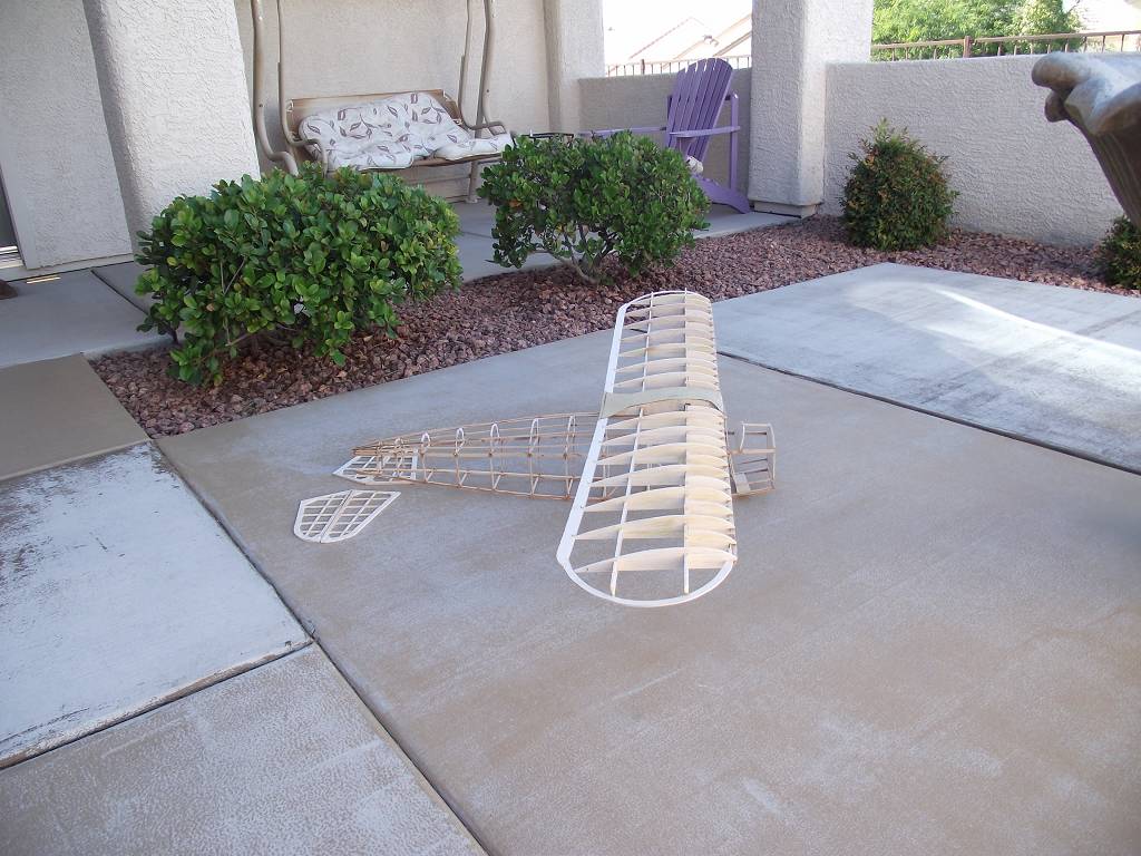

As soon as my wife turned on the football game last night I went out to the shop and started building the wing. I just love balsa and CA glue. I built the right wing half except for the wing tip before half time started. I only swore at Joe Demarco a few times, there were only a few errors drawn into the wing plans, simple things like the length of the slots in the ribs to get them to touch the building board. The question now is how did Joe think anyone could build the tip so it goes through a rib to glue to the LE. It calls for 5 1/16 X 1/8 ply to be laminated around the curve of the tip, very strong but I think I will just cut them in one piece from light ply to save time.
Flying today but when I get home I may get to the second half and demonstrate a very old trick on how to build the second half of the wing when all you have is the plan for one half. In this case the right half is all I have and I don't want to build the left half upside down.

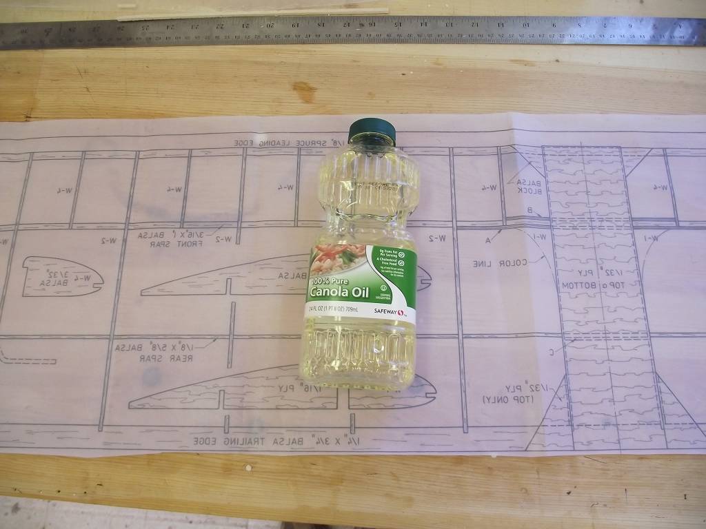

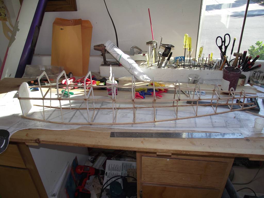

These are plans with only one half of the wing shown. Old timer trick for and old timer build, you just coat the back side of the plans with a bit of cooking oil or mineral oil and it turns the plans into something like a parchment and you can see right through them. Old timer printers can read backward so no problems at all!!
This doesn't hurt the plans so even if you plan on saving them they are still good, no damage at all.

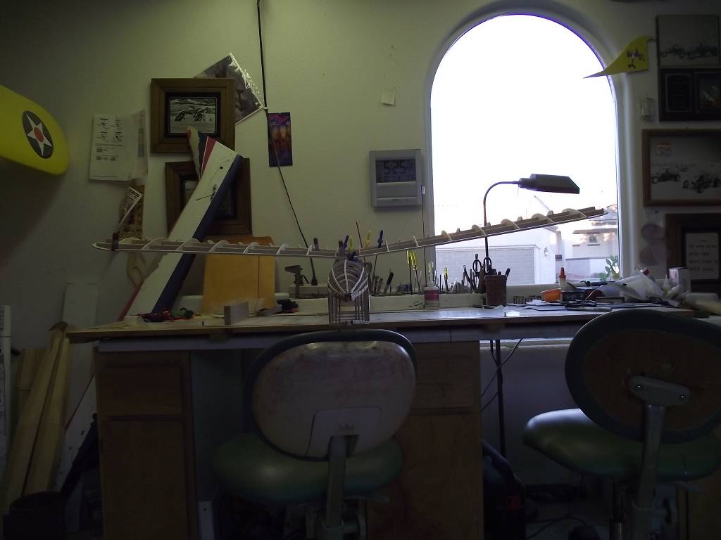

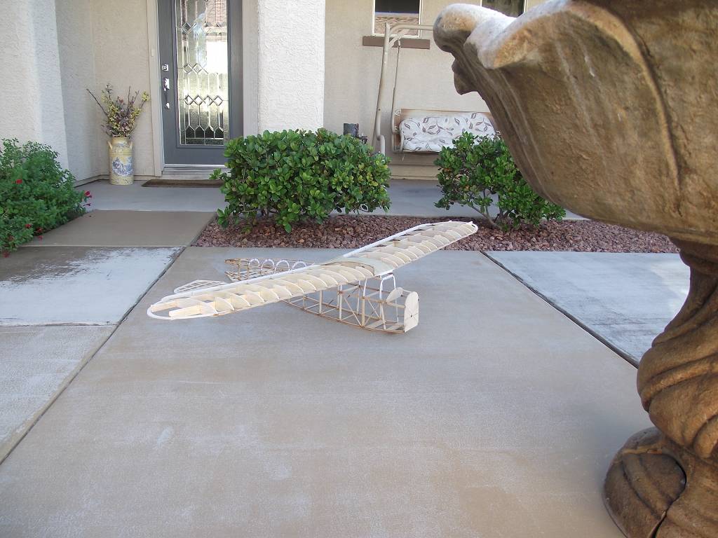

Nope, baked chicken tonight. Yesterday I did the right wing half, today I was flying until noon and when I got home I built the left side. I have the halves clipped together to show it to the fellow I'm giving it to. The question is about the dihedral, it was designed in 1942 as a free flight and has a flat bottom wing. As shown it has the stock 4 inches on each side. I asked him if he would like it reduced before I glue them together? I'm thinking at least 1/2 of what it is. It will only be three channel though. His call. The wing tips called for 1/16 and 5 layers laminated, I just cut them from 1/8 light ply in one piece.

If it were me I would leave it per plan, with a 3 channel. Less chance of getting into problems when you make a turn or loose it and need to recover from a bad move and I forgot most of the older kit I built way back when, had laminated tips with a dozen peaces[:@]

I enjoy flying 3ch. planes but back in the day the designers really used a lot of dihedral. This one isn't as much as some of them but it is a bunch. For myself I would have reduced it a bunch but the fellow I'm building it for said to just cut it in half. That is still a total of 4 inches. If it isn't enough he can add more during the rebuild!!
Gene, I don't think you could start the 1.40 in this fuse so your 15 feet may be off by about 14' 11'' Yesterday I went flying, took my Harley CG Extra with the YS 1.20, discovered I had forgot to charge the battery in my starter. Crap, I had to hand start one of those cantankerous YS engines by hand, didn't even have my glove with me!! Once I got the tank pressure up and heard that squishy squishy sound the YS engines like to make it took me three flips to fire it up. Way too much work!! Your going to love it!!

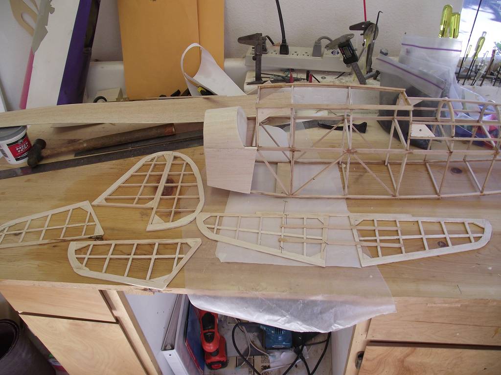

Zor, it's referred to in almost every kit as light ply and sold through every wood supply as light ply. It's just three layer Birch ply. The kit that comes to mind is the CG Extra, the fuse is built from light ply with lightening holes cut in it, sides and formers. It tends to warp easily so some kits made from the stuff used notches and tabs to keep things straight. Some of the new ARFs are using a very thin kind of hardwood outer layers with a balsa center. So far I haven't seen it sold through any of the wood suppliers I use. I use Mid West and Testors light ply. The stuff doesn't work well with CA glue so with any of the plys and hardwood I use epoxy so a build takes me longer when using it.

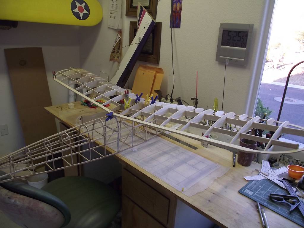

Behold, I think I see a plane emerging from all the sticks!!! Today I built the two stabs and elevators. More sticks but they are at least balsa and the building went much faster. I built each wing half when I got home from flying in two days. Took one day more to epoxy on the center section 1/32 ply using epoxy as the glue. The design of the center section just keeps the balsa from being crushed by the rubber bands. The bottom sheeting helps to align the wing in the wing saddle. Old design but still had some good ideas.

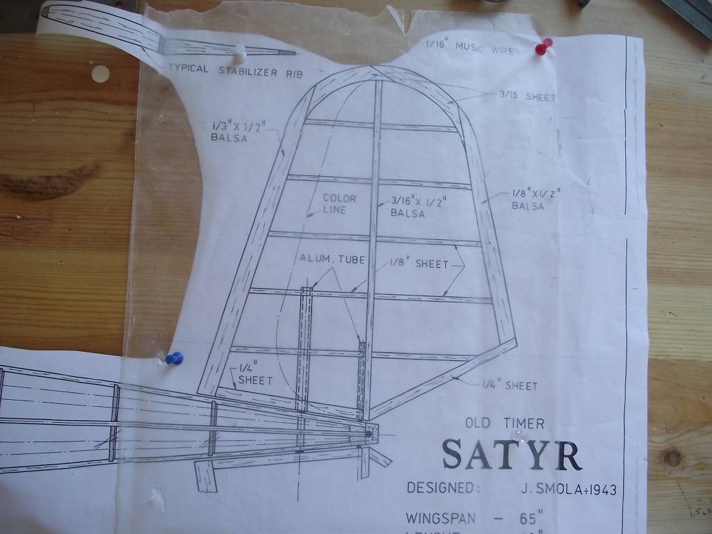

Thanks Gary, I sort of had to come up with my own design for the stabs and elevators. The templates only had one for the stab ribs and it was too much thinking to build them as a flying surface airfoil so I made them flat. Why put an airfoil on a flat bottom winged plane? way too much thinking involved. So many different sizes of wood involved. Maybe it had something to do with the free flight thing? A stab of many sizes!!!

Today I did more work on all the tail feathers, I think I'm going to sheet them. While I was waiting for the epoxy to set up I sheeted the front of the fuse then used some scarp Zor Wood to make up the braces for the dowels for the rubber bands that hold the wing. I originally used 1/8 hardwood to frame up the wing saddle then glued on some 1/8X 1/4 hardwood to that so I have a nice 1/8 inch lip to attach the braces to the fuse. After sanding the tail feathers down they are a mite thin so I decided to use some very thin sheeting and sheet them completely. The sheeting started life as 1/16 and got thinner as I ran it through the over head micro sander at the wood shop. Another tool I wish I had in my own shop.
My wife is watching football and NASCAR today so I have a lot more shop time on my hands. Next trip to the hobby shop I think I will pick up some 5 minute epoxy to cut down on my down time on these builds.
