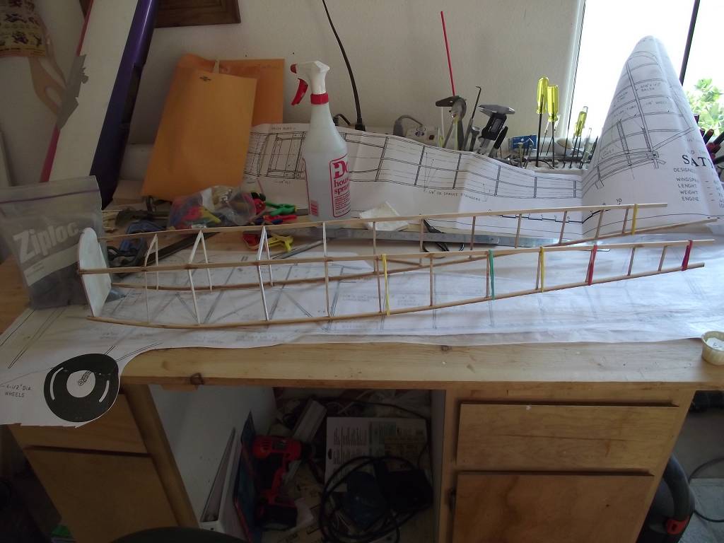

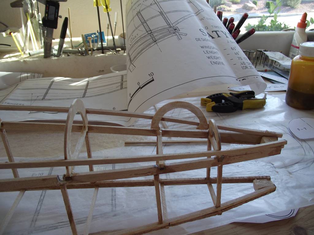

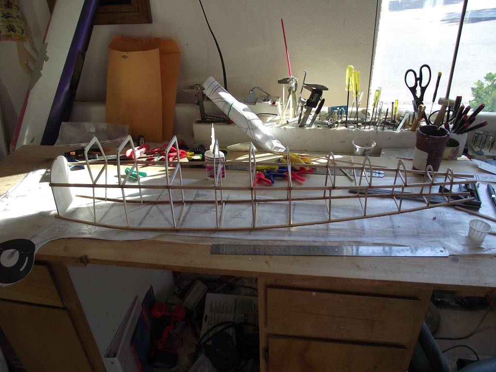

Old timer Satyr with a 62 inch wing. Cut the kit and stringers yesterday and just started gluing things. Started with the fuse first, it's the hardest part of the build. As you can see from the parts, there isn't a lot of wood in this build, it's old time construction. The plane was designed in 1942 and the plans are sold by MAN. This will be three channel with electric power. Another gift build for an old friend. There are a lot of very thin stringers. I think I will paint the parts then cover the plan with the tinted covering so people can see how it is built.

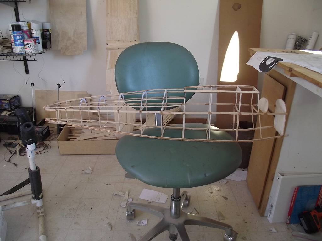

This is how they were built when I first started, a lot of sticks!! I installed the vertical sticks yesterday but that dumbass that's married to my wife forgot the last two so I had to put those in this morning. These are all hardwood sticks and CA just doesn't work well on hardwood, every piece requires epoxy so it's going to take about a week to get the fuse together. In a while I will go out and install the cross braces. That dumbass missed seeing how the cross braces were installed into notches in the top stringer so I will have to cut them before I go on. Lucky I have a small dental hand piece with thin cut off wheels or I would be doing this by hand and breaking out the little parts as I cut.

Thinking I could get away with using CA and get moving a bit faster I tried to glue in the cross bracing. It's under a light load and I ended up with little pieces of wood blowing all over the shop. I ended up having to epoxy one side and wait for it to set up before I can epoxy the other side. Balsa is so much easier to work with! I may set the fuse aside and while it is setting up start building the wing?

Buy a small sheet of 1/64" ply and make gussets.

I have a huge sheet of 1/32 ply but I want to use balsa for the gussets so I can use CA. I think the last time I built a stick plane like this was in 1960, a 62 inch cub. This is good practice for when I get to the Howard Pete but it has a lot more formers to glue to. I did build a couple of Proctor RB planes teaching a kid how to do it about 10 years ago? The building went OK but using silk span was a thrill. Now there is a lot of top formers to epoxy in, more hurry up and wait!

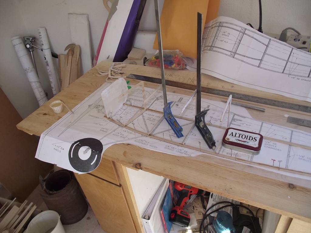

Yep, back in the 50s and early 60 this is how all the free flights were build. Back then I used Ambroids glue. I used my mothers sewing pins too, I don't recall ever seeing Tee Pins back in those days. I still use a soft pine building board these days so the pins will go in and hold. Last night as soon as my wife started watching the football game I went out and glued in the top formers. I had one fall forward while setting up so I have to go out and remove it then re-glue the little sucker!!
Back in 1963 my father came home from work with a couple ounces of what turned out to be CA glue. I never once gave any thought to using it to build models with. My dad was an engineer in Aerospace at the time and came home with all kinds of cool stuff before the general public ever saw it. Then they came out with Super glue or Crazy glue and the commercials were on TV constantly but still I never gave it a thought to building my planes? Once I tried it I was kicking myself for being that stupid. This build is making me nuts waiting for the epoxy to dry. I think balsa shims will be OK, the fuse is now very strong and doesn't twist. Lot more sticks to be added still then I will have LG blocks and a number of interior items to epoxy in. It's a lot of work but a very cool plane when finished, my friend wanted an old school plane and this one fits the bill.

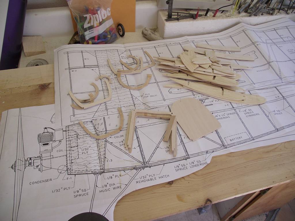

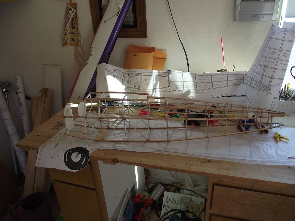

It is starting to look like something now, a plane if you look real hard and squint your eyes. If you don't then it looks like something a kid is making from an erector set. The sticks are bent and under a load so sometimes a part will snap off when the epoxy is setting up and not be in the location you left it in the night before. Walking out to the shop in the morning can often be a surprise when you see where the parts ended up. After gluing I do wet the parts so they take a warp and the pressure is relieved from the parts. This morning no surprises and it's time to put in the cross braces and hard wood mounts for the LG. I have to come up with a place to mount the battery so it can be gotten to with ease. A mount and a hatch? I have several ideas.

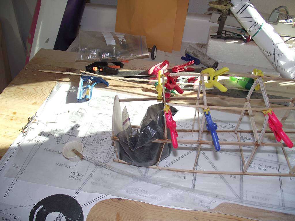

Greybeard, in the second photo did the last twotop former/turtle deck slip out of position? I see what you mean about parts being under load. It must be like Easter morning going on an egg hunt!

Just the one and it slid to the side and glued itself to the longeron. I used a bag of shotgun pellets in a bag to hold down the front one night then came into the house for the night, seems the shot rolled and the bag fell off the top of the fuse so I had to re-glue some more parts in. For the most part the fuse is finished but I have to glue in some gussets to help hold everything together in flight. In my minds eye I see little sticks poking through the covering after the first loop.Tomorrow I will maybe get to start working with balsa again where CA will do it all. This one is keeping me on my toes but it is a fun build.
