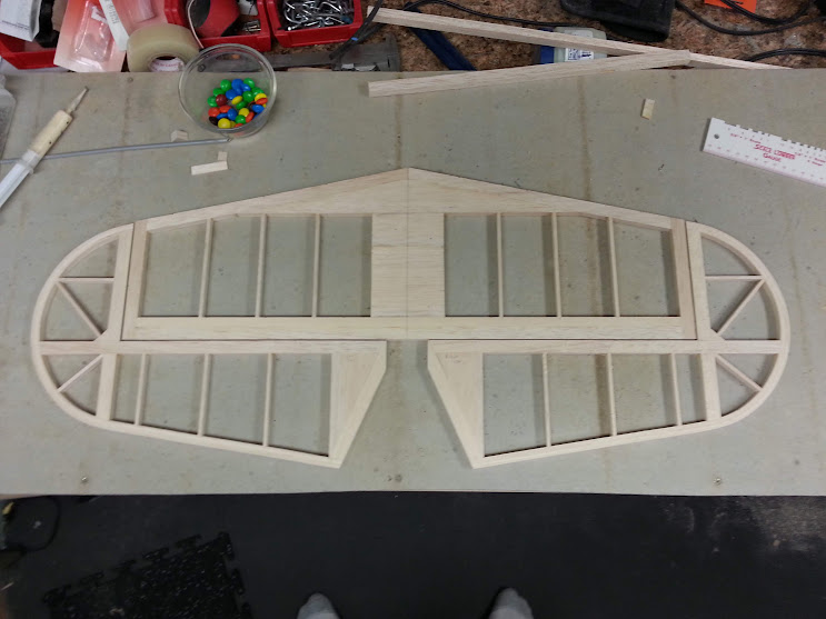

Without trying to go for a homerun and make the lightest possible decathlon, what I'm going to do is make what I feel are "prudent decisions and design changes that should add lightness without impacting the structural integrity of the plane.
step 1, build the elevators. We will keep the spruce spar and use it to attach the flying wires to, however all 15/16" wood is gone, substituting in 3/8" x 1/2". I cut down the 6" wide center section to 3" as well and reconfigured the stringers so there are now 6 1/8" x 3/8" stringers instead of the plans which show 4 I think this is still overkill...
We are trying something new for me with glues as well. No CA on this plane, any glue used will either be Titebond, 30 minute epoxy, and possibly some ambroid. In an effort to use less glue, I've found that the testors glue tips fit perfectly on Target's syringes that we get with some of the meds... so once the kiddo's are don'e being sick with there colds.. the syringes end up in my hobby shop. so far I've liked how they work, quite a bit less mess than using hte big bottle.

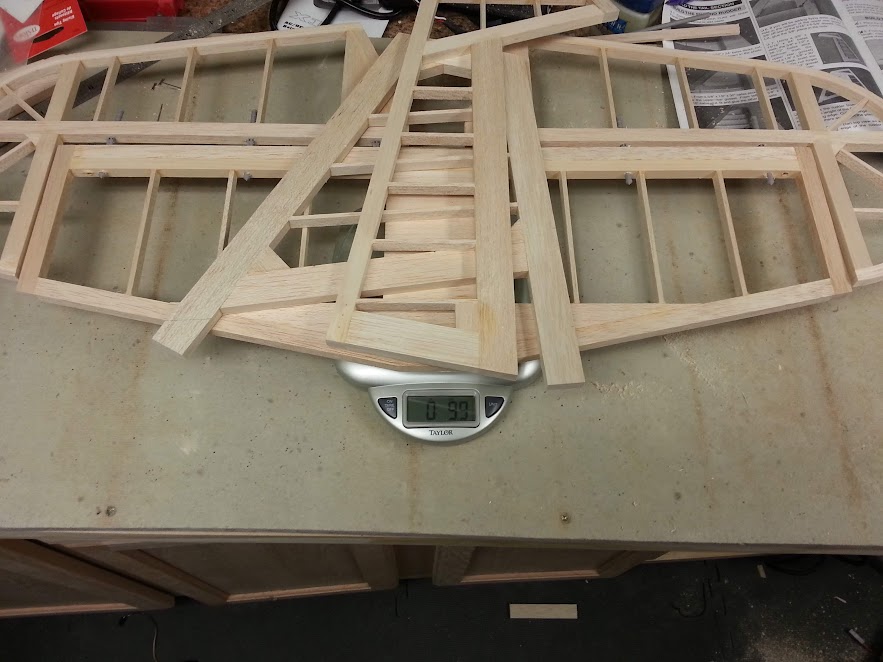

Its still a tank....I probably have half the wood that the original design calls for and its still solid as a rock, I probably could have used 3/8" square here instead of the 3/8" x 1/2". You can see on the plans I was fiddling around with adding the diagonal spars to strengthen this... but its not going to be needed, just added weight.
The rest turned out much lighter, andI'm much happier with the weight of the individual elevators. Need to get a scale to weigh them, but same thing again though, substituting 1/2" wide where the plans call for 15/16", basically cutting hte amount of wood used there in half.
I thought of cutting back on the laminations around the curved lines, however most of this gets sanded away anyway.
6.4 oz for the elevator on its own.
The O.S. GT33 weighs ~43.85 oz according to O.S.'s website, so I'm building using that as a target. For the Decathlon, the ratio of length between the engine to the CG vs the tail section to the CG is roughly 3:1, or the tail is 3x longer moment than the moment to the engine. That means for every ounce out on the tail, 3 ounces near the engine will balance it.
so. 43.85 oz / 3 = 14.61 oz = very rough target weight for tail to balance engine.
so obviously, the body between the tail and engine will contribute to this, the gas tank/cowl/prop hinges covering tailwheel, main wheels etc will all add to this equation, but for rough numbers this seems like a decent starting point. I'll be a happy man if the elevator and rudder come in at or around 10 oz.

tail weight..... 9.9oz, still some sanding and shaping to do here, however I usually save final sanding to the end.

Well Matt, I was sure shocked by what I found! My tail feathers as built weighed in at 9.6oz! That's 0.3 oz LESS that your reduced tail. I didn't do anything different than the plans - EXCEPT I added the hard points for the tail wire mounting.
I wonder if your wood was just really heavy?
I can't upload pics for some silly reason. I keep getting an "Internal Server Error"
My Horizontal Stab/elevators weigh in at 6.2 oz. The Vert Stab/Rudder at 3.4 oz. Weighed together, obviously 9.6 Oz.
