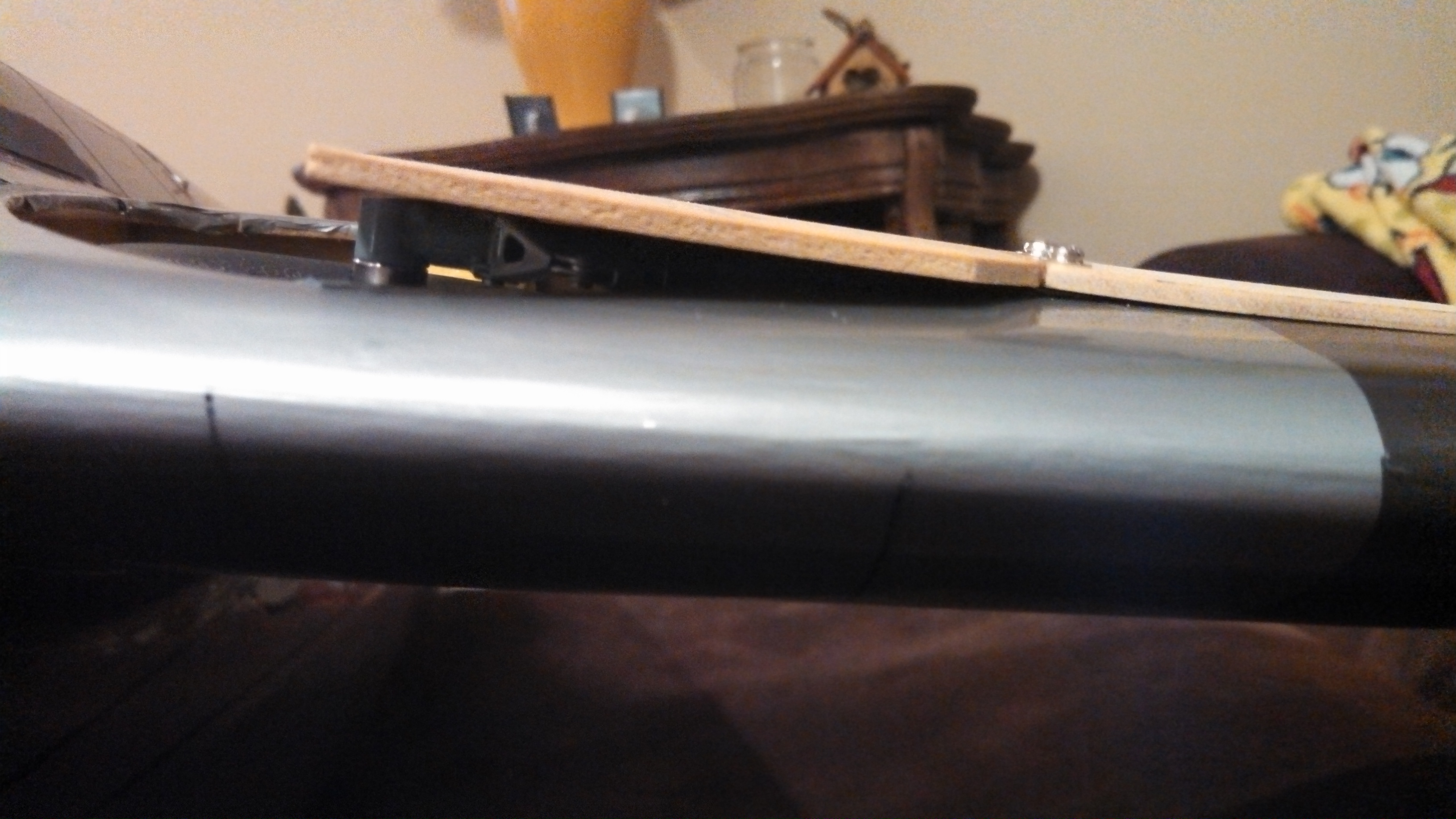

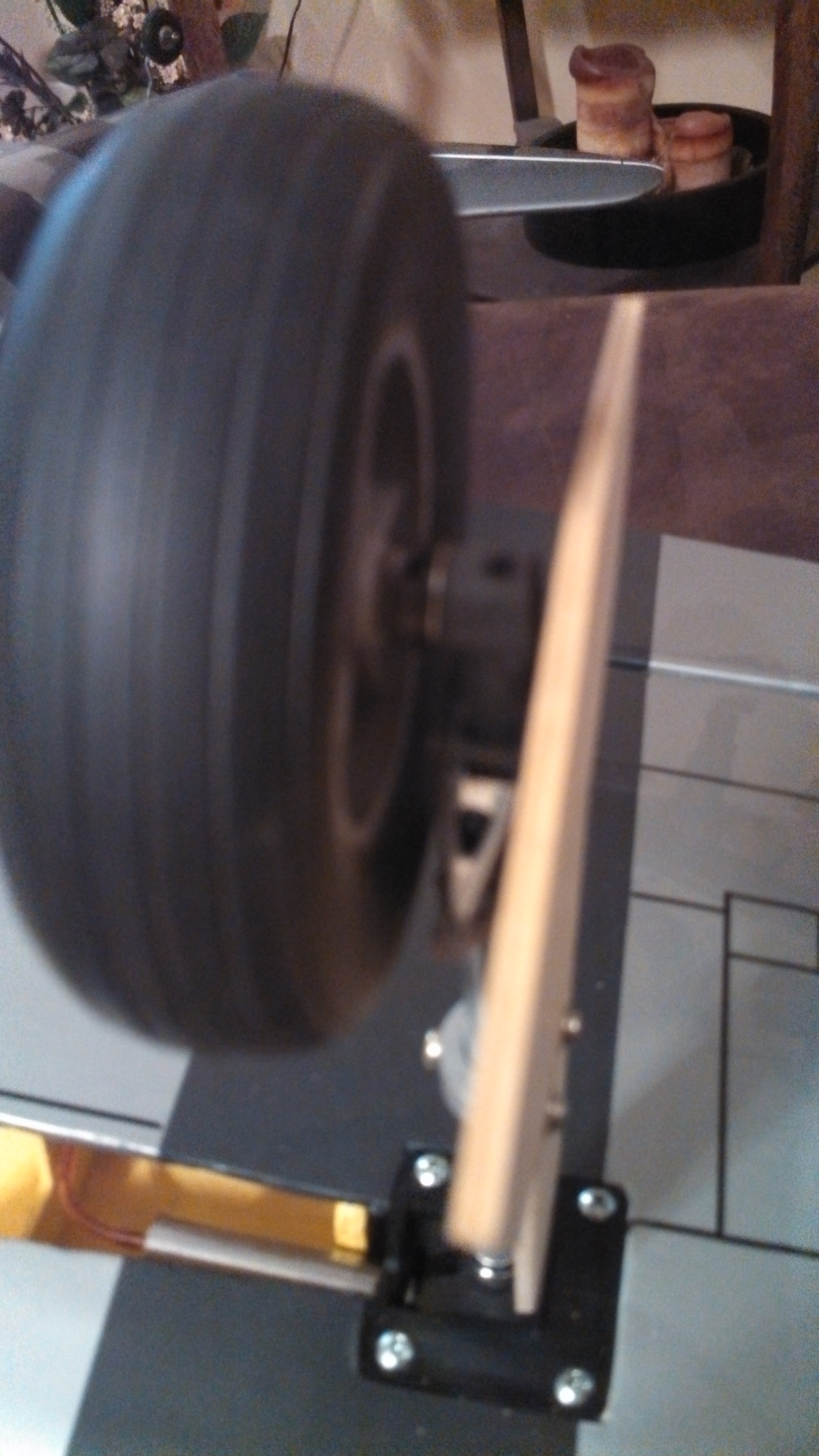

I bought a engine (Saito 120S) and the other parts I needed to finish this P47. On a hint from another thread I purchased the Strut assembly of of the Hangar 9 Blue Nose P51 to use in place of the Robart Robostruts, $8.99 a piece for the Hangar 9 Struts as compared to $45.00 a piece for the Robostruts and they are almost identical. You have to use a piece of brass tubing JB welded to the interior of the P51 strut so that it will fit the 3/16 landing gear wire, but other than that it works nice.
I have plumbed the Retracts, but my problem is now fitting the landing gear doors. The Robart Scale tires are too wide to fit in the narrow forward portion of the P47 Wing, and without using a 3/16 wheel collar on the inside of the wheel they will rub the scissor links on the strut assembly. WIthout the gear doors the wheel and strut just barely fit in the wing without protruding out into the airflow, but with the doors mounted I end up with a gap and they will not close all of the way. I am not sure what to do about this and need some advice. I am not sure what my options are to solve this problem.
#1 Find a tire with a smaller width so that it doesnt take up as much room and maybe not rub the scissor link without using the wheel collar as a spacer?
#2.Forget about mounting and using the gear doors and just us it without them?
What are some ideas or solutions to this problem?
Will it be okay to just let the gear door rest on the lower surface of the wing, or do I need to cut out the profile of the gear door and get it to line up with the lower surface of the wing? I know the latter would be better, look better and probably fly better but I'm not sure I have enough balsa sheeting to cut away on the forward portion of the wing without cutting it out all the way to the leading edge of the wing...
