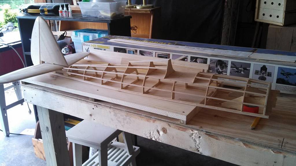

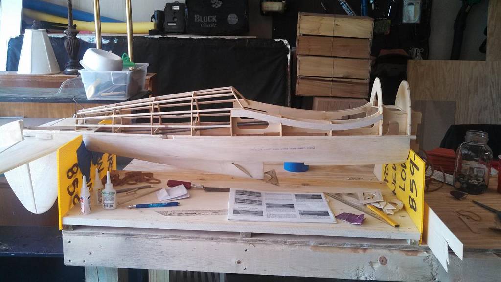

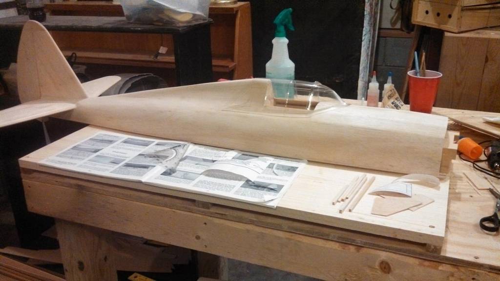

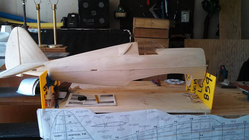

I dont consider myself to be a very good kit builder so I have no idea why I cant say no to one when I stumble upon it. A coworker approached me with the chance to buy this Topflite P-47 Gold Edition Kit and made me an offer I just couldnt refuse even though I am deathly afraid that I will goof it up and it will find its place as a static Display beside the Topflite P-40 Kit I attempted to build and never finished. Long Story.... Anyhow, this kit included the Scale Engine, Scale Cockpit, and Droptanks. I have started the build, and so far I dont think I have made any crucial mistakes that has caused me to lose interest and want to throw in the towel. I'm moving fairly quickly and although probably not attainable, I have set a goal to have this completed and flying by the end of August for a Warbird Fly In at a local Club. Even if I dont meet that goal, it should at least keep me busy on it so that it doesnt turn into a 3 year project like my first build did. ( I am happy to report that I did maiden the Piper Cub last weekend and it came home with me in one piece)
Anyhow, My question now is retracts for this airplane. Will the Eflite 85 deg electric retracts mount up without much modification if I build the wings according to the plans and the manual? Also, will the Robart Scale Struts work on the Eflite Retracts?
Here are a few pictures of my progress so far. I am normally happy with the build until it comes time to cover it, then it falls to pieces. I just cant seem to get a nice clean finish that I am happy with. Maybe this one will turn out okay..I'm keeping my fingers crossed.

Looks like some pretty good work to me ! I would go with a better retract system than the e-flight. I would look into the Robarts, or even spring-aire.

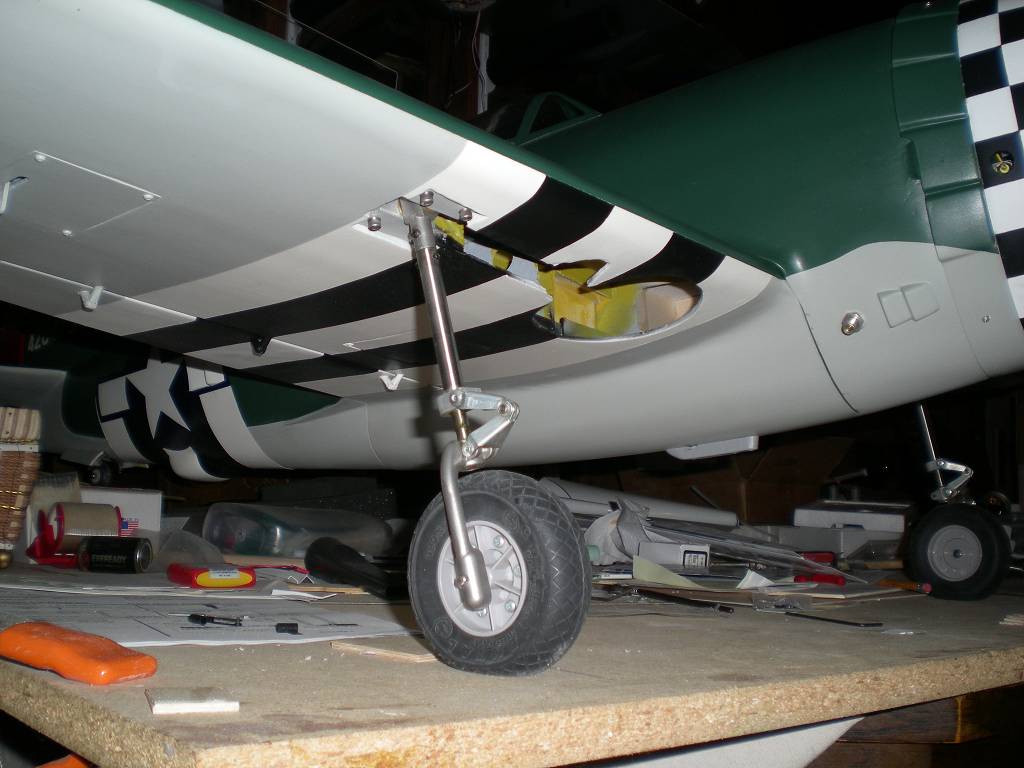

there are several decent threads on the build here is one http://www.rcuniverse.com/forum/m_48...tm.htm#4868696 but a little search time and you might be able to pick up some helpful tips on your build so far it looks clean.
TF kits build easy just follow the instructions(I use a yellow highlighter to check the boxes as I move along) and its a good idea to read ahead and familiarize your self with the steps you will be doing before hand other wise keep posting you will find most questions are answered fairly quickly around here
I used the CJM retracts for mine glassed with water based poly and painted with warbirdcolors paints, I used www.getstencils.com stencils for the emblems

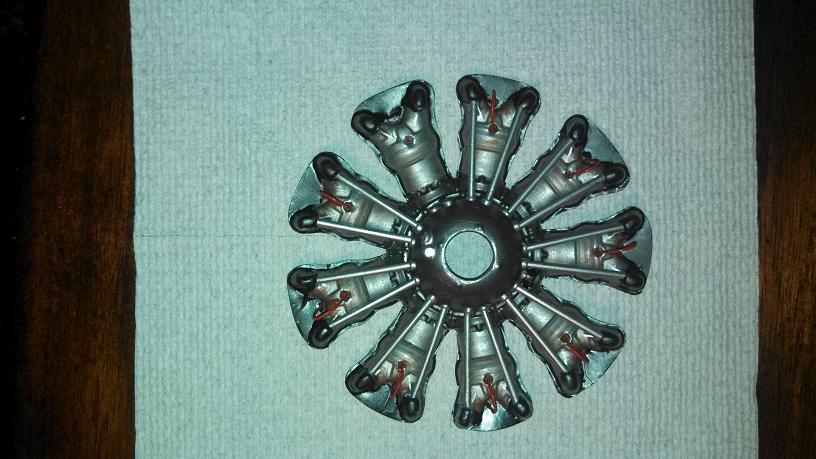

I'm moving forward with the build and have completed building and joining the two wing panels, and have also made my first blunder of this build. It seems that somehow, while joining the wing panels with epoxy I failed to make certain that the plywood dihedral wing joiner on the aft side of the spars was aligned properly and I was a little messy with the epoxy and have some squeeze out that I should have cleaned up. I failed to notice this until after the epoxy had cured! [:@] The front dihedral brace is fine, and although the rear dihedral brace was misaligned the overall wing and it's dihedral seem to be correct and still align on the jig blocks. I think I can just trim the aft dihedral brace where it sticks above the spar on the right wing panel and below the spar on the left wing panel. At least I'm hoping that I can do that without compromising too much of the strength of the wing join. I also dropped the wing while sanding it and ended up breaking out a junk of the flap skins on the right wing. I cut and pieced in a couple of patches and filled the area with filler, but I am debating whether or not to just remove the entire flap skins and do them over. These mistakes have taken a little of the wind out of my sails, but I will try to just overlook them and continue to move forward with the build.
I already had a set of #650 Robostruts laying around, so I just went ahead and ordered the #606 85 deg. Retracts and Air Kit from Robart. Now I need to decide on the powerplant.
Anyhow, although this is not intended to be a build thread, I just wanted to share my progress, report in, and share a few more photos.
