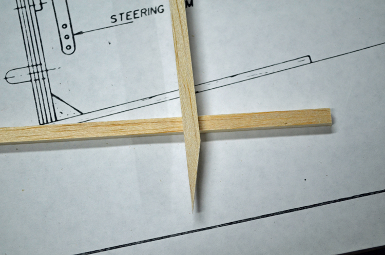

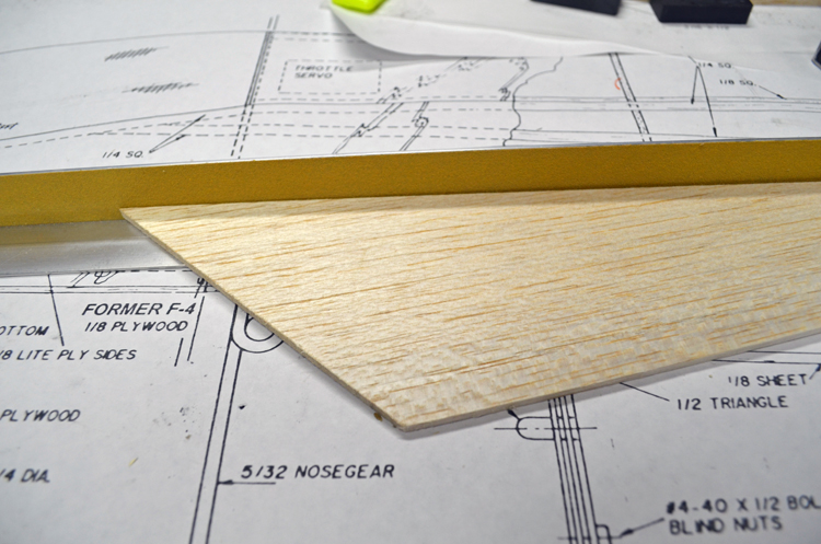

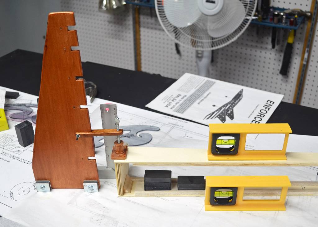

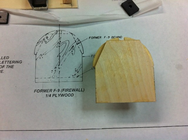

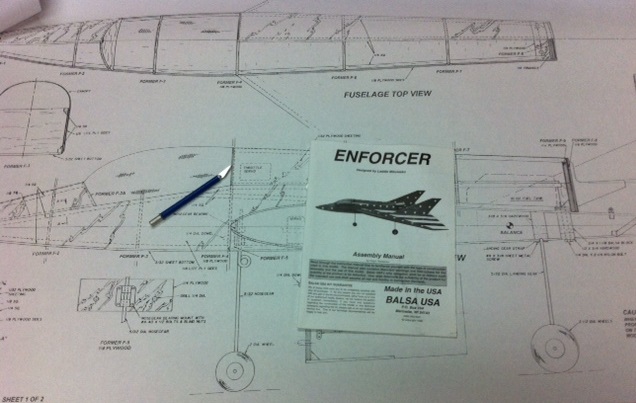

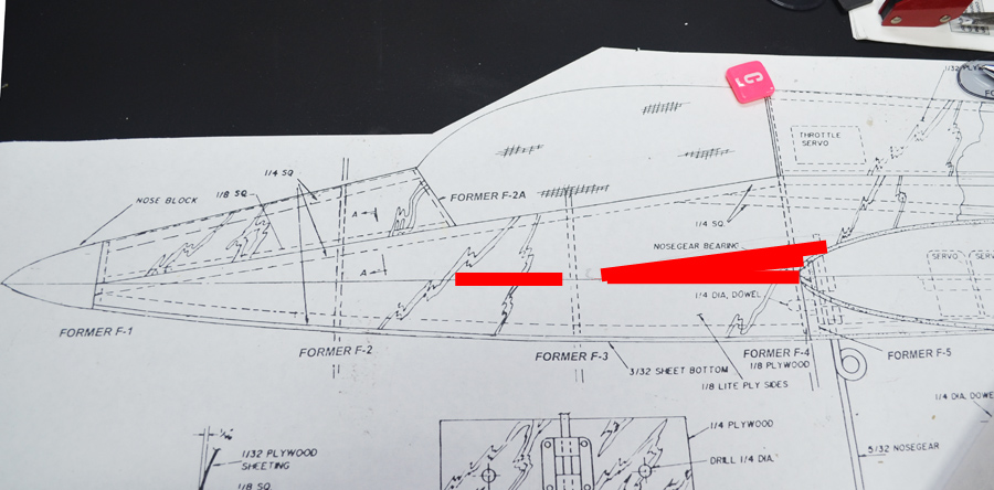

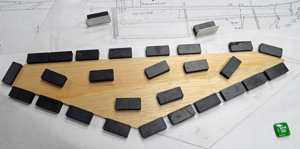

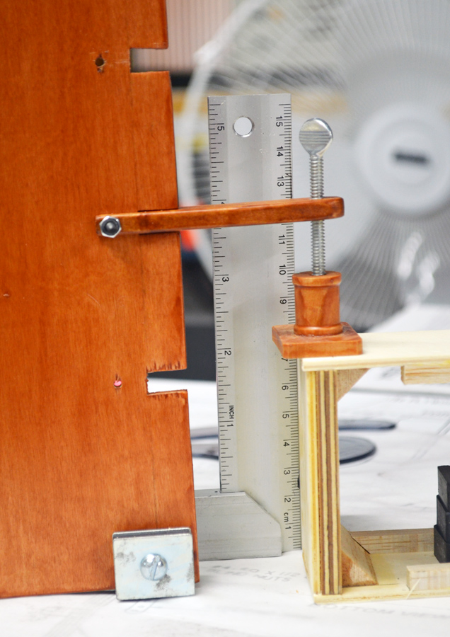

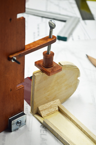

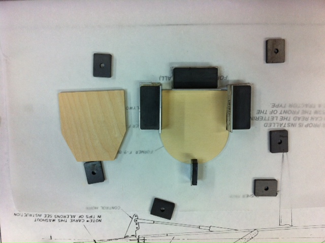

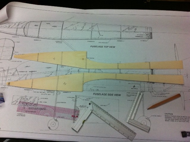

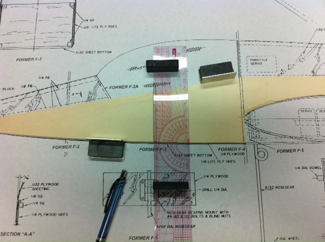

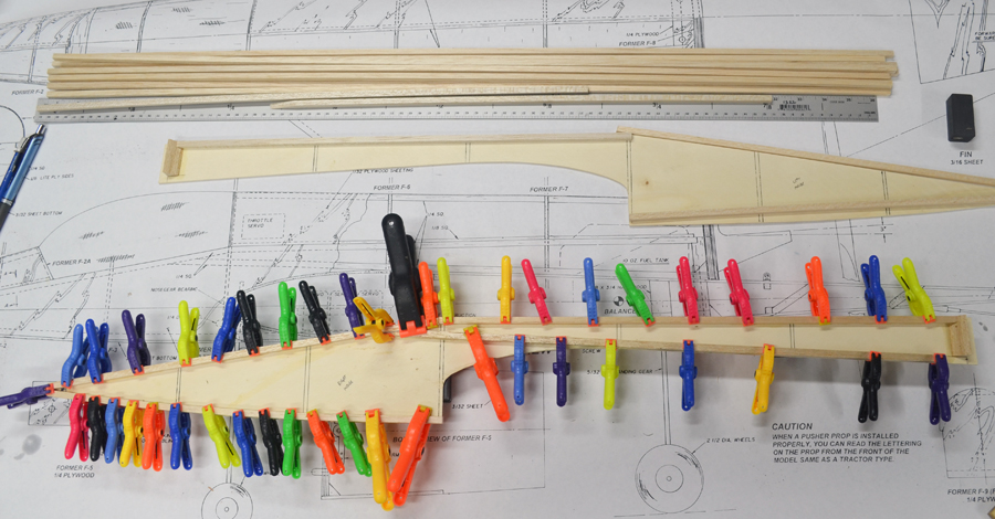

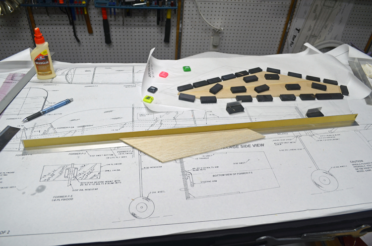

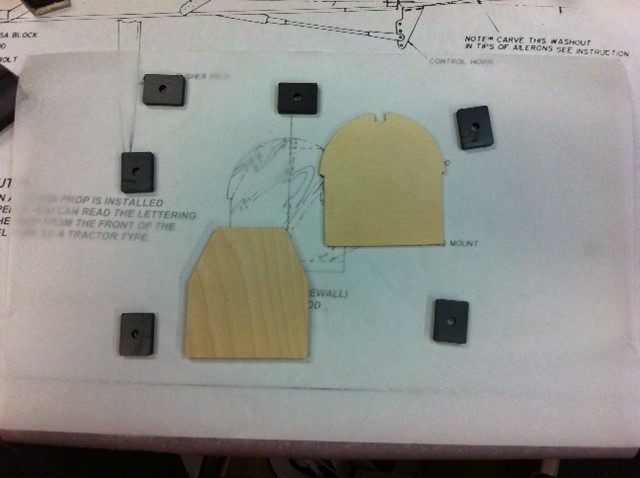

Well, I went ahead and drew the lines for the formers on the sides of the fuselage. I used a flexible ruler so I could line it up easily with the hash lines on the plans. As you might be able to tell, I am using magnets and a metal table to build instead of pins and a ceiling tile. I still use pins here and there but mostly I will use magnets. Next, it is time to laminate the two plywood firewall pieces together. In the instructions, it states to use pins around F8 to help guide F9 on top of it. Well, magnets and extruded aluminum angle will have to do. What I find interesting is that the instructions said to use thick CA to glue the two pieces together. Call me old school but for anything dealing with the firewall, I am going to use 30 minute epoxy.

I built two enforcers using magnets. Yes, epoxy for the firewall and check and double and triple check that you fuse is absolutely parallel and that the angle of the firewall at the rear is absolutely correct and that it is square with the fuse. Once you get that done the rest just falls into place.
BTW - I picked up a bunch of "welders magnets" at Harbor Freight which I find most useful. The BIG ones are great for insuring fuse sides are square and perpenducular. Plus they are heavy which is a bonus.

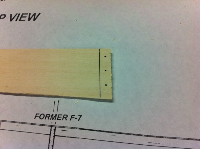

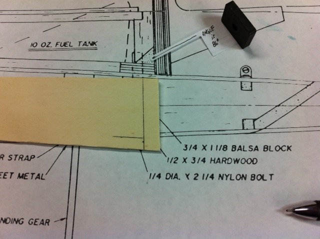

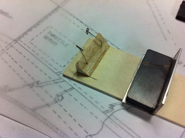

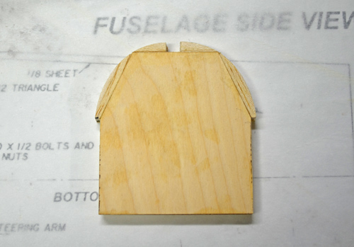

Thanks Dan for the wishing of luck! As I have said before, this will be a slow build. The laminated firewall is done. The next task is to mark the area where the firewall will attach to the back of the fuselage. Then, cut 1.5 inches of 1/2" triangle stock to glue to the fuselage side to allow more surface area for attaching the firewall later. It states to leave enough room for the wing bolt plate. I would suggest that you mark the line for the firewall and then mark the line for the wing bolt plate. Following the instructions to have the triangle stock edge flush with the top of the fuselage, the two lines do not form a 90° angle. It actually forms roughly a 86° angle. Also, I think that the length of the triangle stock is too long at 1.5 inches. I carefully measured the length for the triangle stock, cut it and sanded one edge of it to 86°. Again, the manual states to attach the triangle stock with thick CA but I am going to use 30 minute epoxy will milled fiberglass like I did with the firewall. Now, this might seem like I am splitting hairs when it comes to the angles, but doing it this way allows the wing bolt plate to lay flush on top of the triangle stock and aligns it to be flush with the wing cradle too. In the last picture, I flipped the fuselage sides over and marked where the firewall aligns and drew three dots. This is to mark the location (more or less) to "pin" the firewall to the fuselage sides with bamboo skewers or rounded toothpicks. This will give the firewall/fuselage connection more strength.

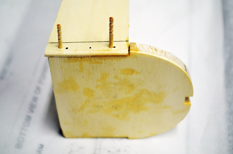

Well, I decided to add the extra balsa on the firewall before the firewall was attached. This allowed me more room and control to glue the scrap balsa to it and sand it to shape. I decided that I would glue the firewall to one fuselage side at a time. This allows me to make sure that I have a good bond and not create a mess in the process. Again, I am using 30 minute epoxy with milled fiberglass to give a strong bond. Once the epoxy has hardened (overnight), I will pin the firewall to that side. I made some "wood" nails to pin the firewall. I will put two on each side, staggering them so they are not in line with each other.

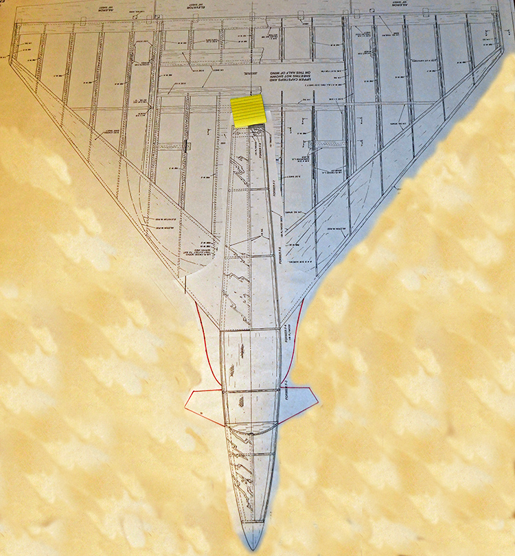

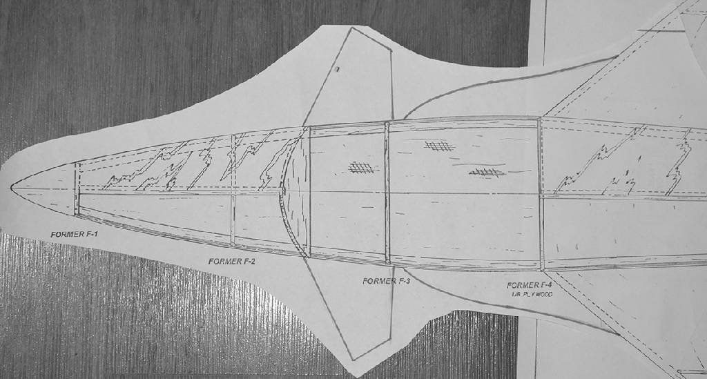

I am thinking about doing some simple mods to the Enforcer. I want to add some small canards and LEX to the plane. The first three pictures show roughly what I would like to do. Total lifting area added in front of the CG is 25 square inches. I am curious how much this will affect the CG considering how much wing (1000 square inches) is behind this small mod. Any suggestions out there? Does anybody think that the CG would be greatly affected (no more than 1/4 inch movement at most)? I would like some opinions or suggestions. Anyway, I went ahead and drilled two holes in the side of the firewall to pin it. I put wood glue inside the holes and slightly tapped the "wood" nails in. I then went ahead and let it dry. I put the other side of the fuselage on and epoxied it to the firewall. As you can see, I made sure that both fuselage sides were parallel to the table (look at level bubbles) and that the firewall is perpendicular to the table (see angle). Once this dries, I will pin the other side of the firewall.

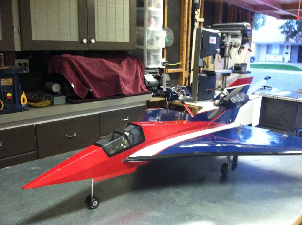

here are a few mods i have done
for more info and photos email: [email protected]
Bill
