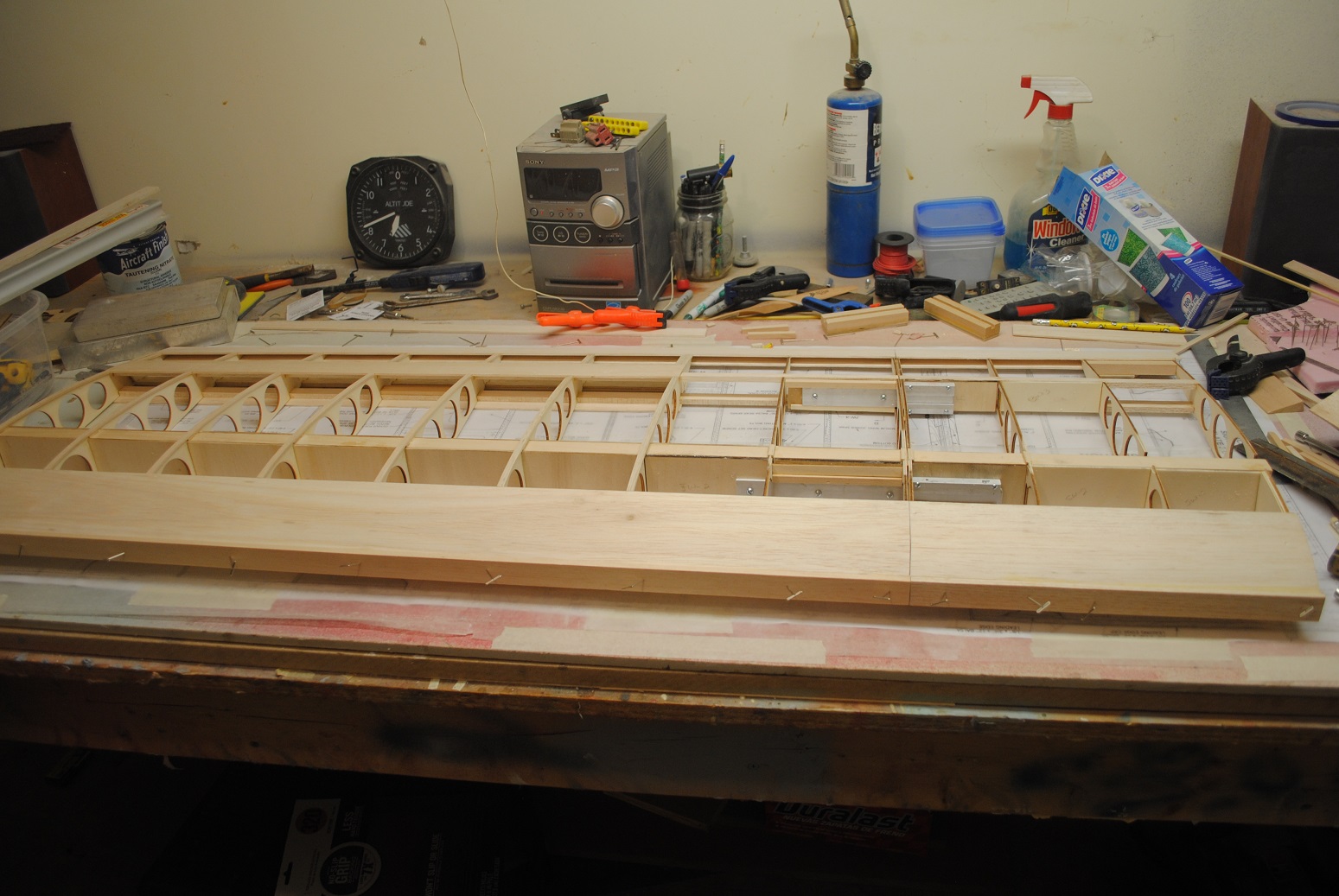

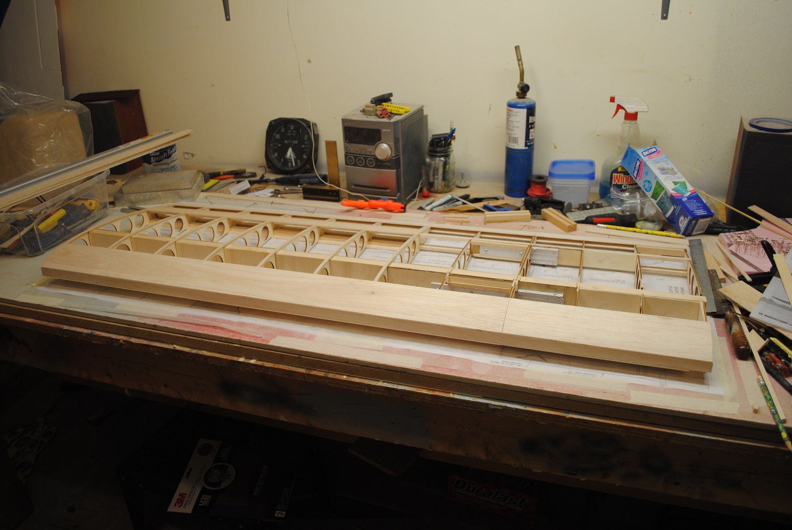

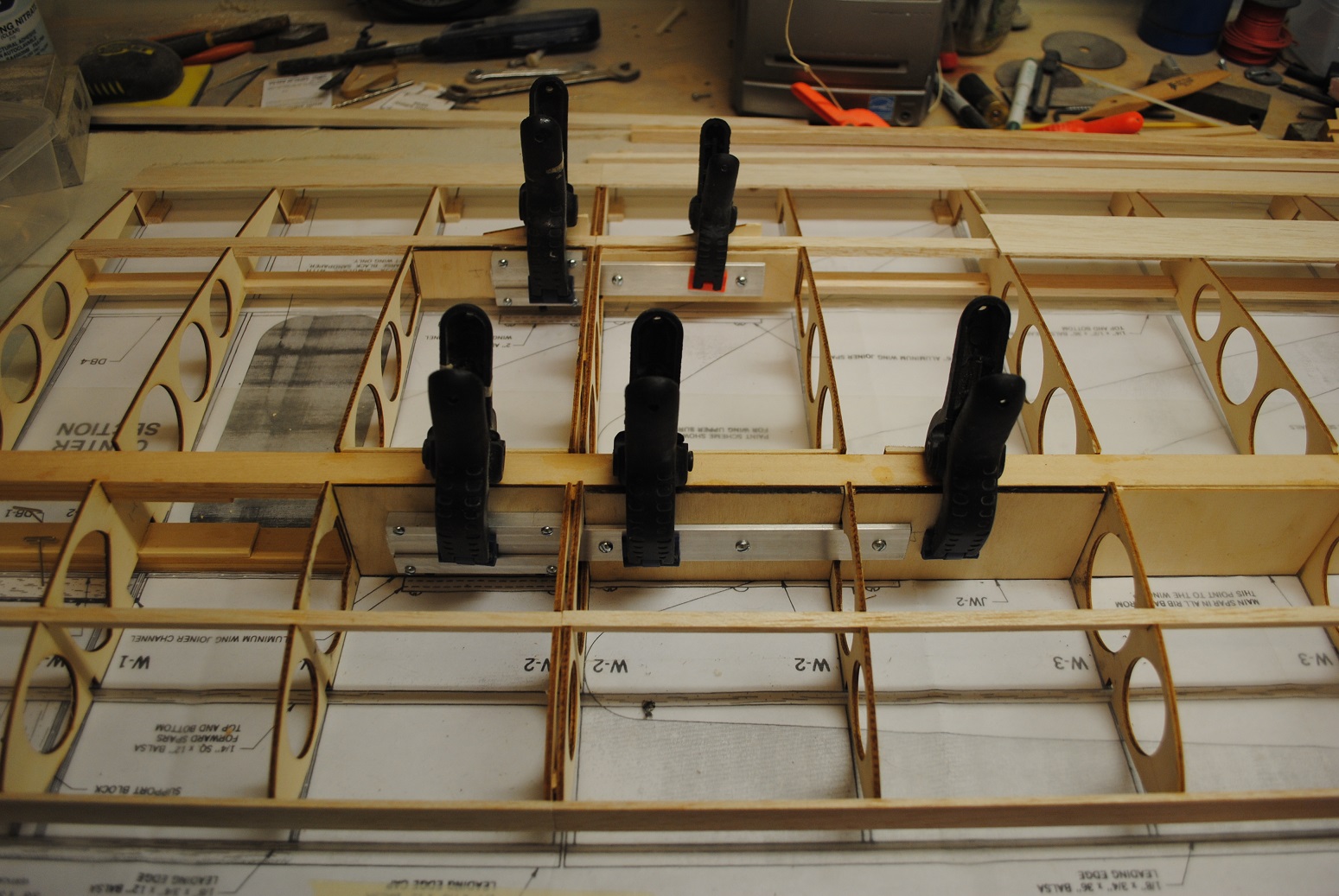

Wing Continued:
I really like the design of the wing. The kit contains lase cut ply shear webs. Once these are installed on the front and back of the main spar you are basically creating a very strong box spar. Very little trimming/sanding was required to get a good fit of the shear webs. I have the top sheeted and cap stripped and the bottom sheeting installed. The sheeting has been sanded flush with the sub-L/E and the 1/4" L/E stock is glued in place with Titebond. I will let this dry until tomorrow and sand the L/E to shape and cap strip the bottom of the wing. You can see the line in the sheeting where the outer panel and the center section join together.
More tomorrow.
Anthony

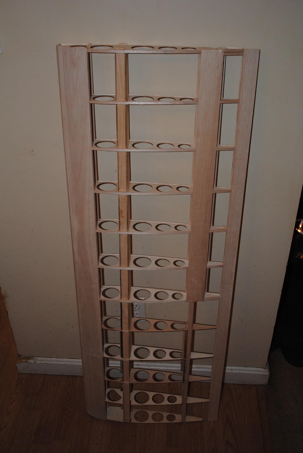

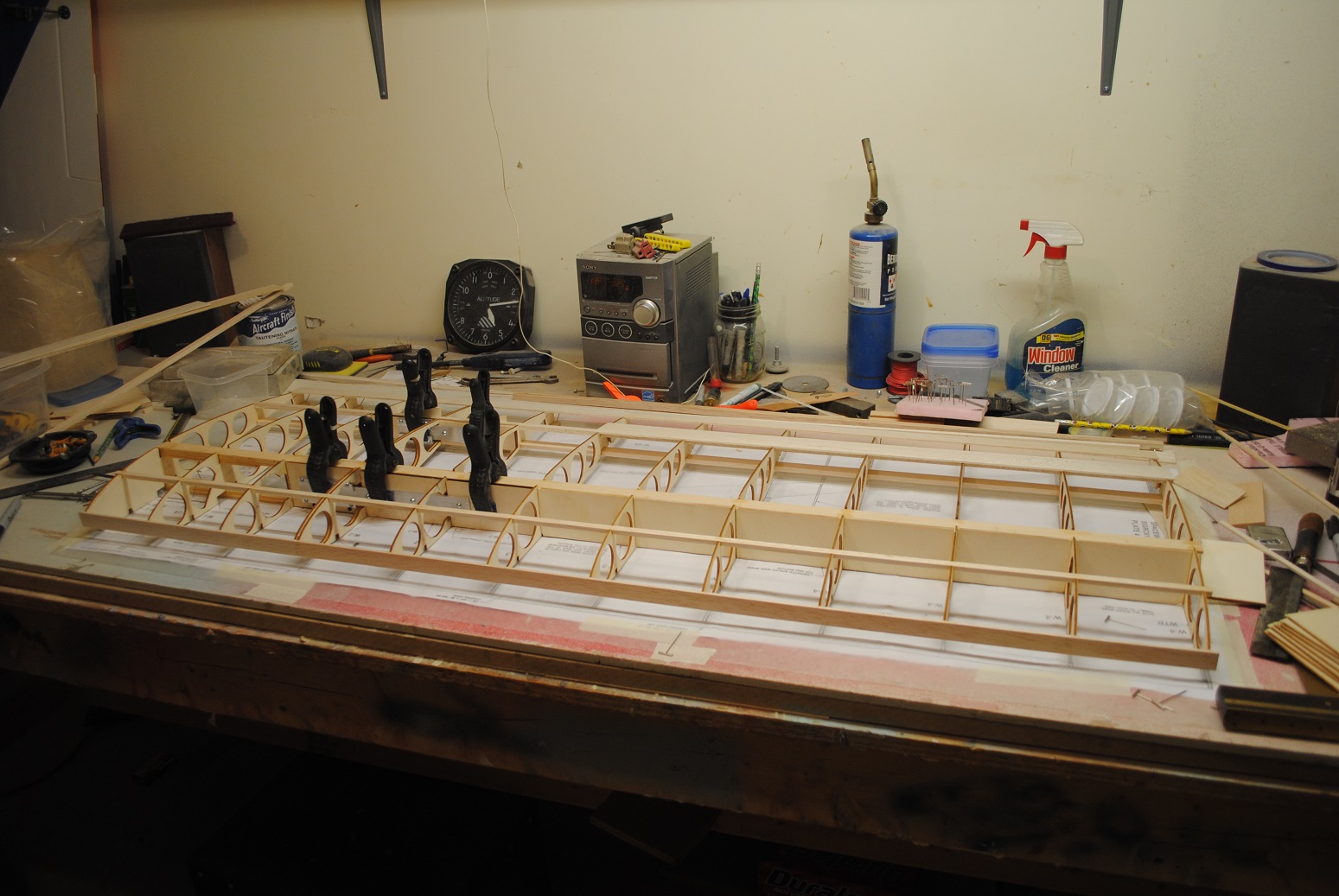

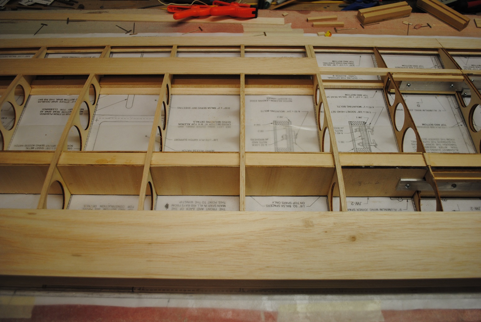

The left wing panel is framed up on the table and the wing joiner is installed and epoxied into place. I should be able to finish the left panel tomorrow. I discovered I do not have enough sheeting on hand to sheet the center section and the inboard bay on the outer panels. The wife is going shopping tomorrow so she is going to pick some up for me.
Will be nice to get the wings completed and move on to the tail surfaces.
