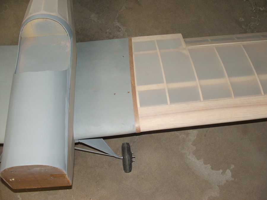

Anthony,
I made a 2 piece wing with a box spar,and an aluminum joiner.The landing gear is also aluminum bolted to the fuse,just ahead of the wing.I know it's not scale,but it sure is a lot easier to store,and assemble at the field.My buddy also had one,and liked how much simpler it was to handle.-jeffo
I'm glad to see you are building this one, Anthony. I think you will like the build.
Sig did a good job with this kit. I didn't find much that I felt need to be changed. I did, as you plan to do, sheet the entire wing center section, and for the reasons that you stated.
I suggest that before starting the wings, you take a look at the retention system.
Although I am told that it is perfectly reliable, it makes me nervous. I wish that I had added a wing tube, which is a very simple modification, on this design.
Enjoy your build !

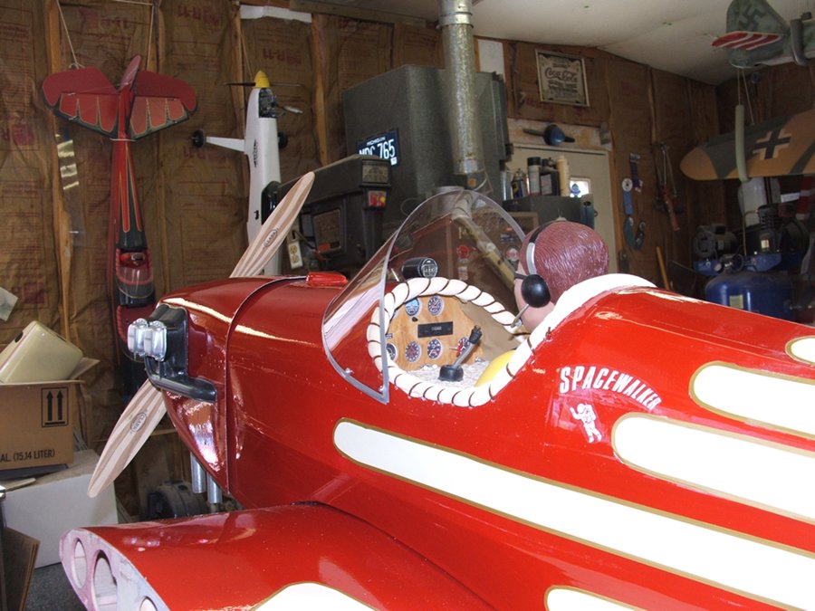

Here's are pics of mine.
Enjoy your build !

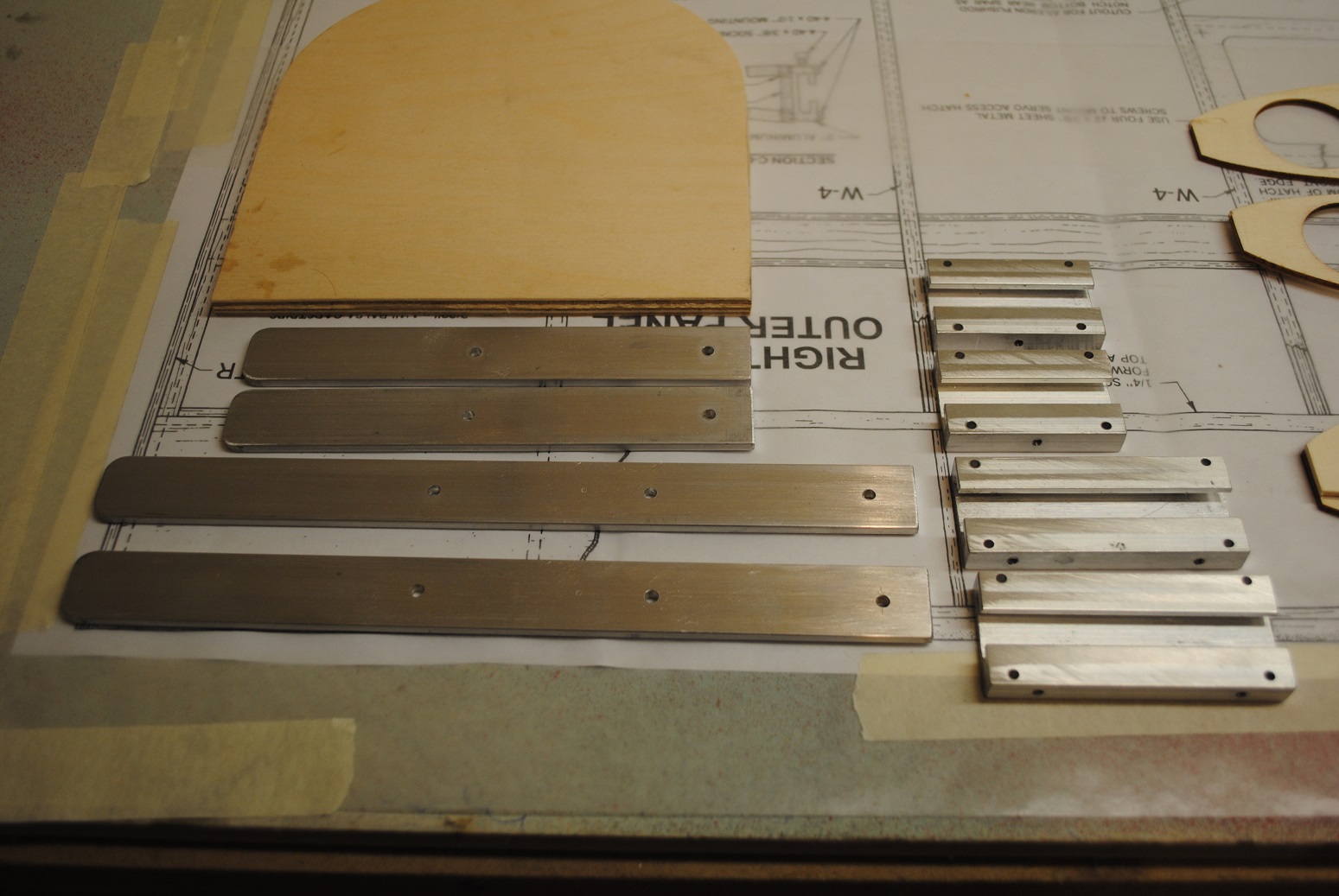

Getting ready to glue and epoxy the different laminates together.
I discovered none of the laser cut parts are marked. This required a bit of time to go thru and label the parts to the diagrams supplied in the instructions. The main wing spars are laminated from 1/8x3/4" spruce stock. I am going to go thru the manual and try to locate all the laminations and get them all out of the way before I get started. Should make the build go smoother down the road.
I am using T-88 epoxy for the spar laminations. This is a very slow cure epoxy so the actual construction will not begin until tomorrow.

Tom,
Did you install the ply bands to cover the wing joints? Just wondering how that works out? looks like it would be easy to break.

Anthony, I did install the ply bands. I purchased a sheet of 1/32 ply, and cut and extra set of bands. I laid down two layers of the ply strips. The first layer (bottom layer) was 1/4" narrower Than the top.
The narrow band was glued flush to the rib. The top band was glued over it, with a 1/4" overhang.. This is plenty to hide the joint, and the extra layer allows the outside wing panel to slide on easily, without snagging that thin ply strip.
I glassed the strips with 1/2 oz cloth for durability.

I am getting ready to drill out the aluminum wing joiners, I could not find my 4-40 tap so I borrowed one from a club member. The laminations are all cured and ready to start assembly. I can only stand to be on my feet for about an hour max then I have to sit for a while to rest my back. I need to find a taller chair that I can sit in at my work table, maybe that will help.

I just finished the drilling and tapping of the wing joiner blocks. The tap I borrowed was a 4-40 3 flute tap. Wouldn't you know it on the 3rd hole it snapped with very little pressure
. I was stopping and turning back every 1/4 turn to clear the chips and it still snapped on me. As always happens 5 minutes later I found my missing tap. It is a 2 flute tap which is much stronger and I was able to finish tapping the holes.

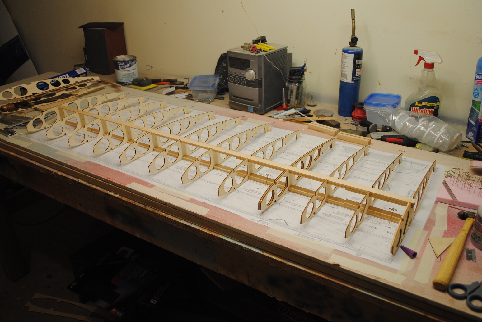

I have started framing up the wing. So far so good. The 1/8" ply ribs are bowed pretty good but are straightening out fine. At the rate I am going it will take me all week to complete the right wing. I don't think you have anything to worry about Robert my back just won't let me stay working at my usual pace. I might even be as slow as David right now.
For those considering this kit, it is a fine kit but if you do not have a drill press or access to one you will get frustrated pretty quick. I can't imagine trying to build this plane without one. The wing joiners require a lot of drilling of aluminum bars and brackets. Here are a few pics of the wing joiners and the laminations and the starting of the right wing. The wing panel builds together with 1/2 of the center section and after the wing is framed and the joiner is installed the outer panel is cut loose.
