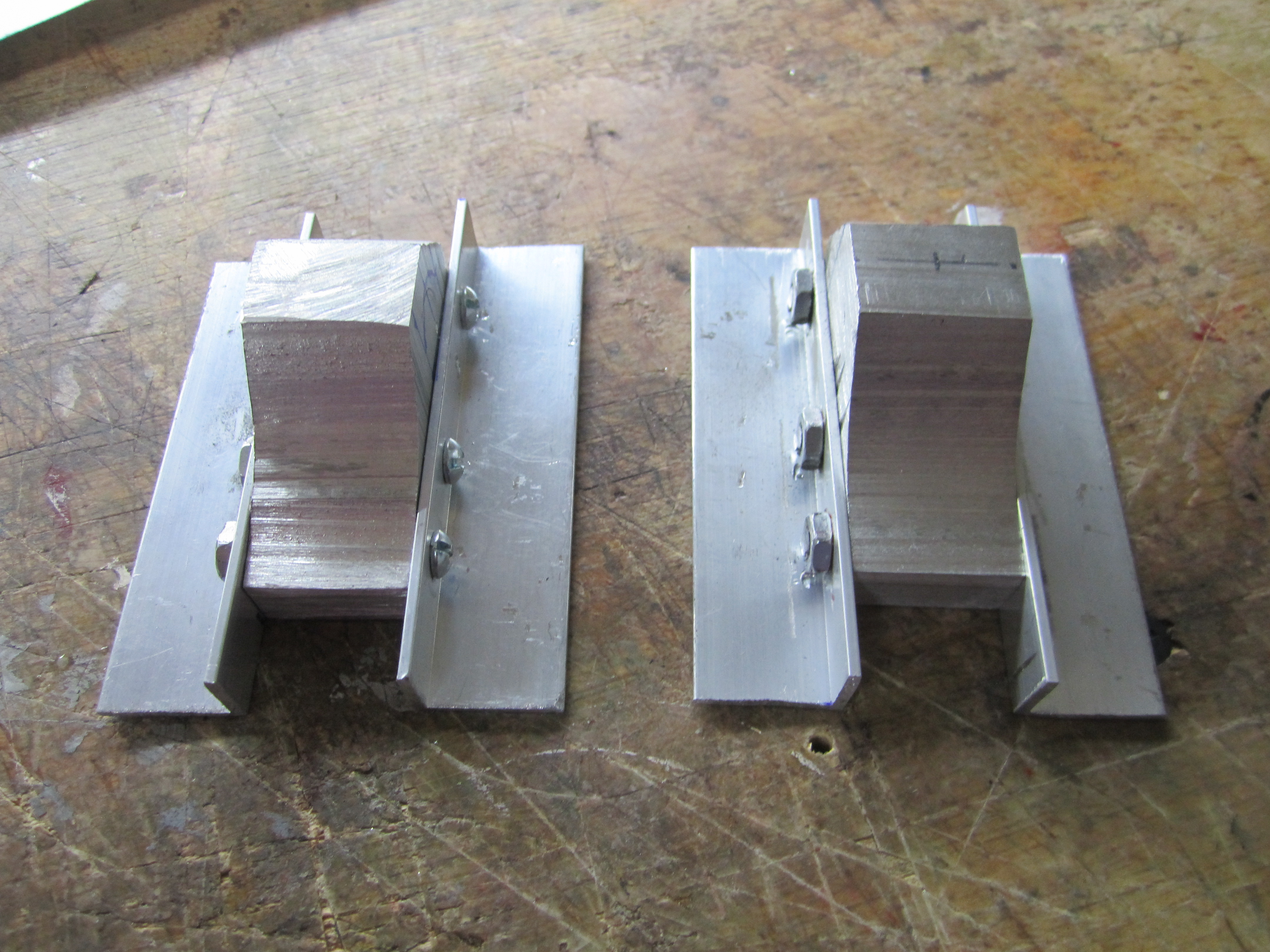

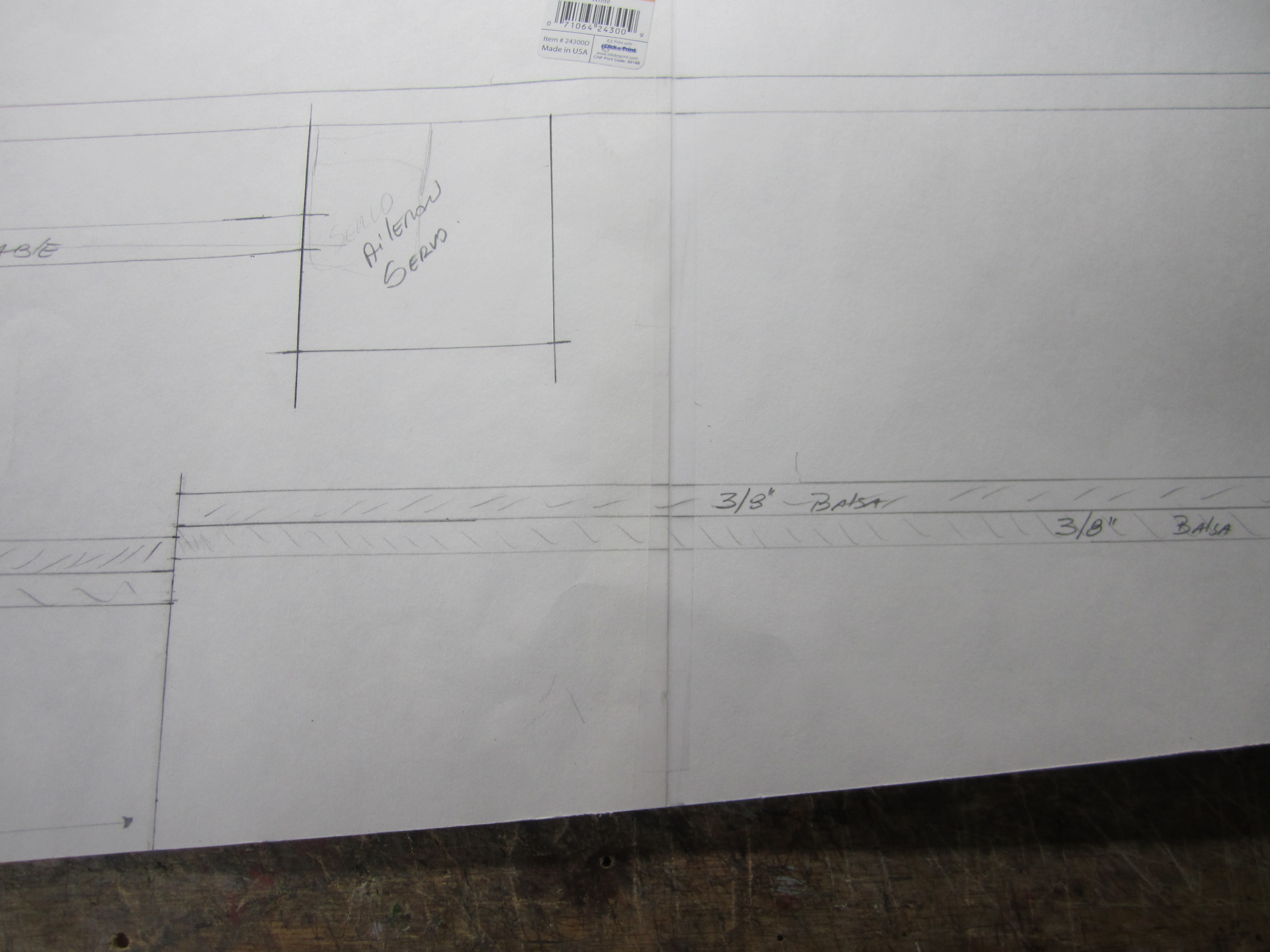

I started to build the G&L Hobbies Chipmunk. A friend of mine recommended this kit to me and I got it in a heartbeat.
My plans are to fiberglass the wings, rudder, stab and elevators. I bought Robart ½" struts for the fixed landing gear. I also bought a DLE 55RA.

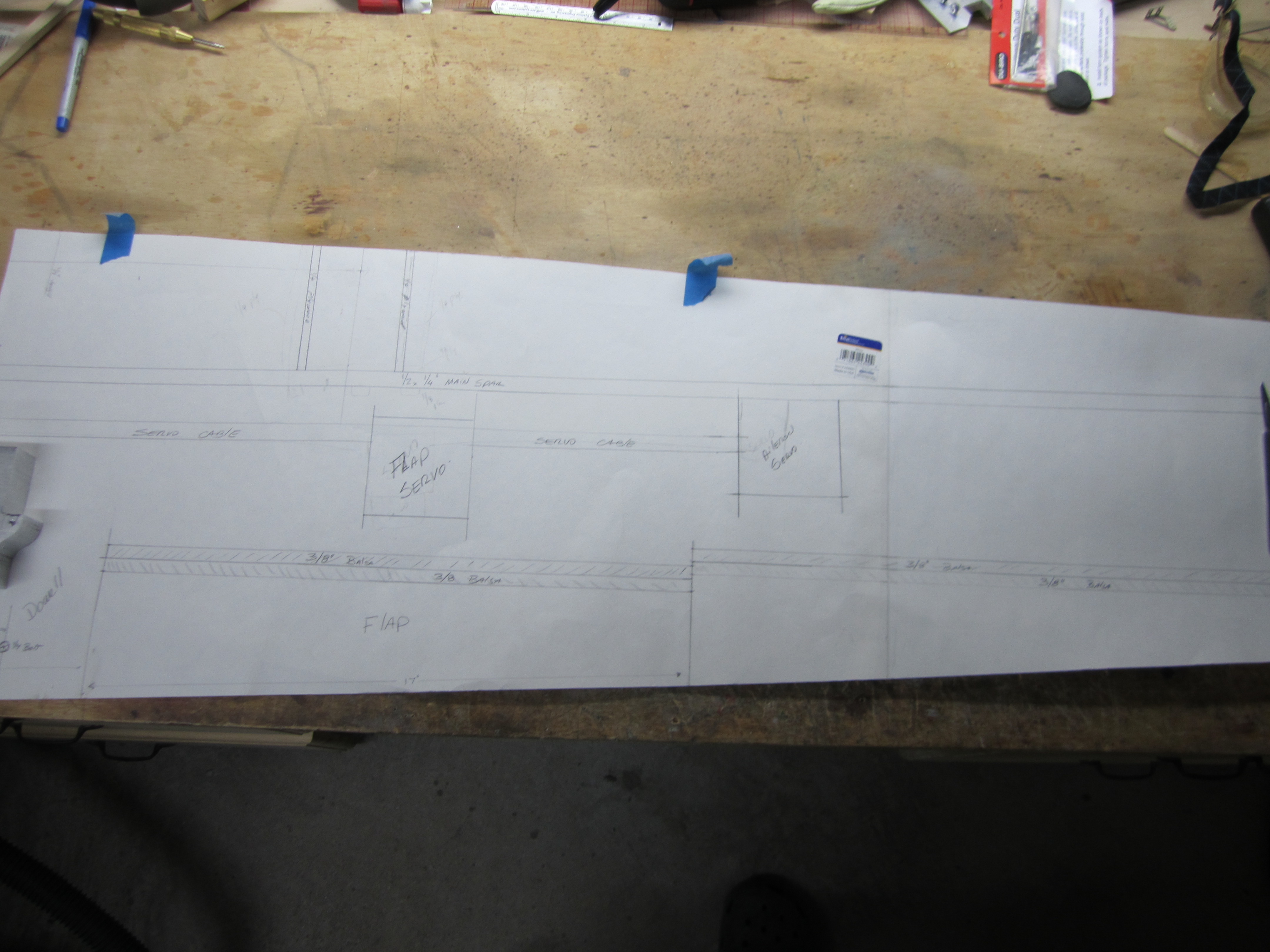

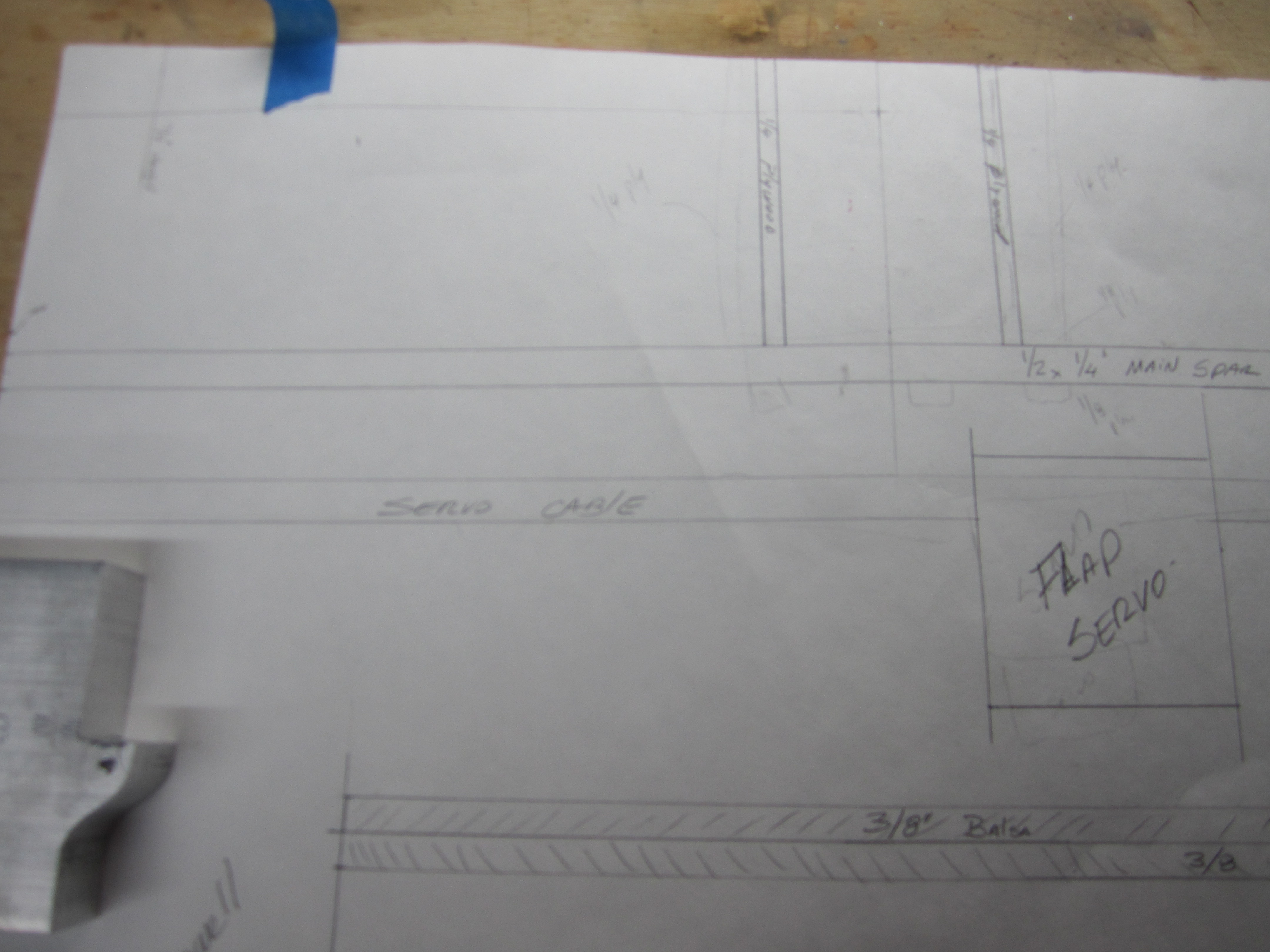

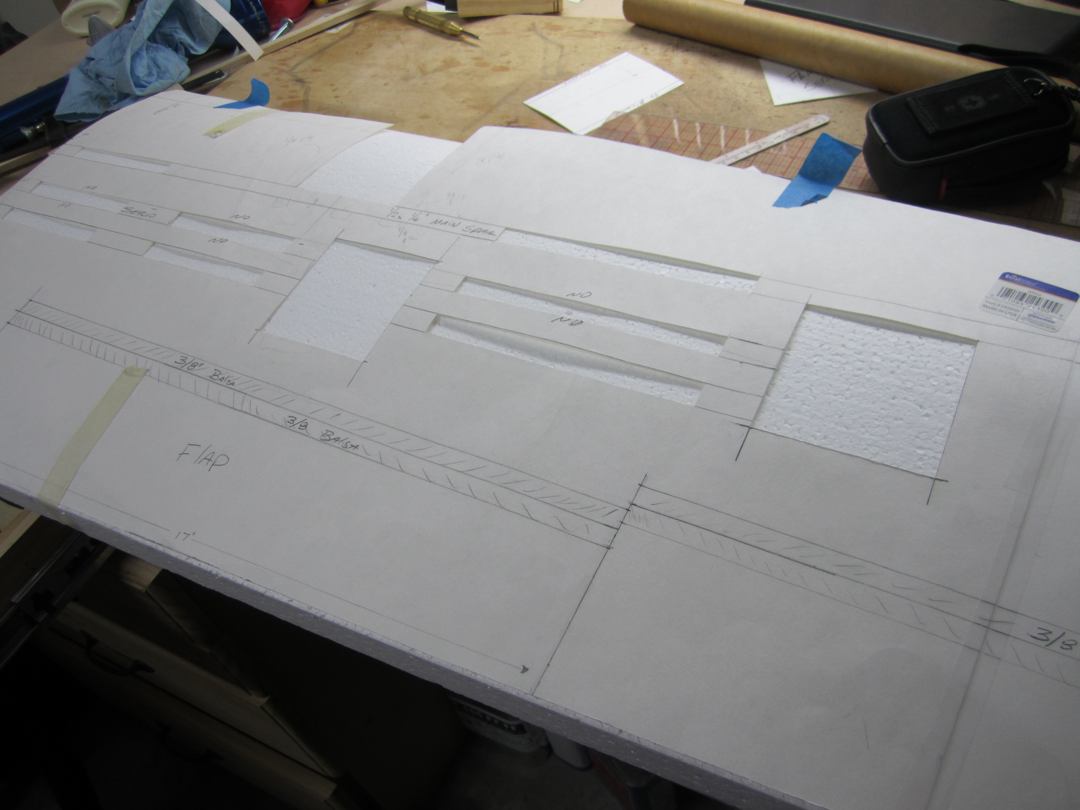

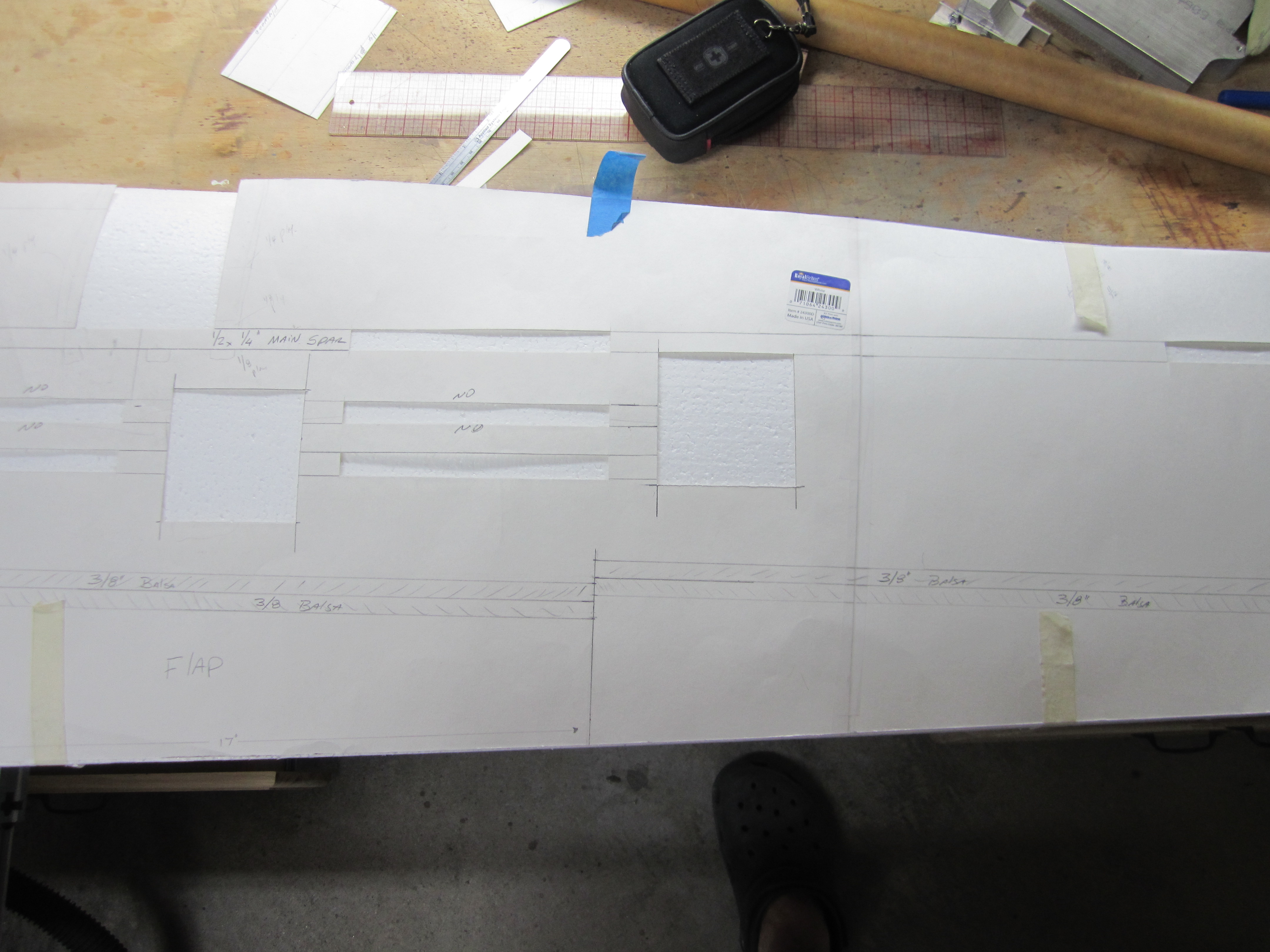

I started by making a template of the wing flaps and ailerons. I also added to the template the servos pockets, the landing gear cuts and the spars.

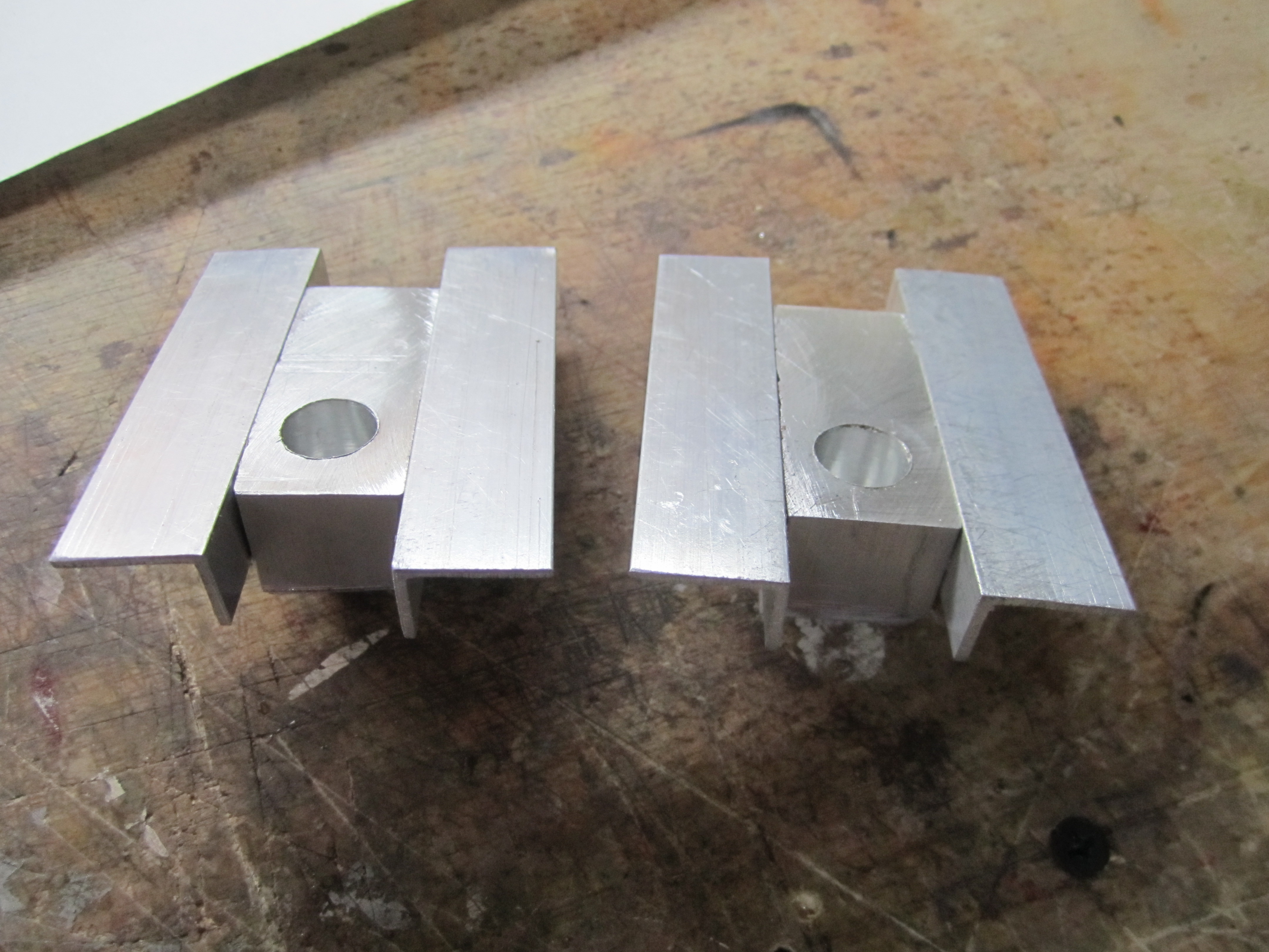

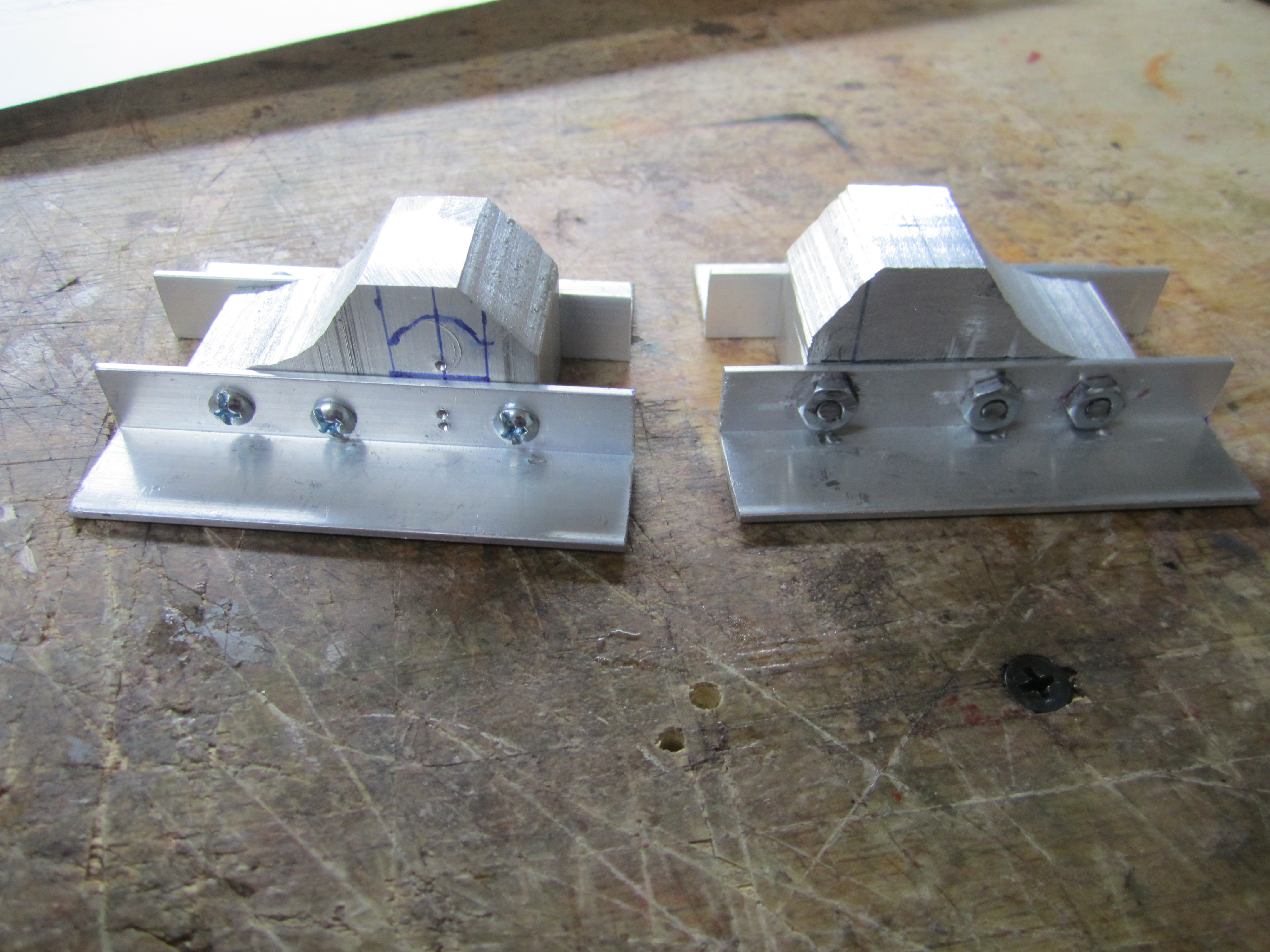

I bought a block of aluminum on ebay to make the landing gear blocks.

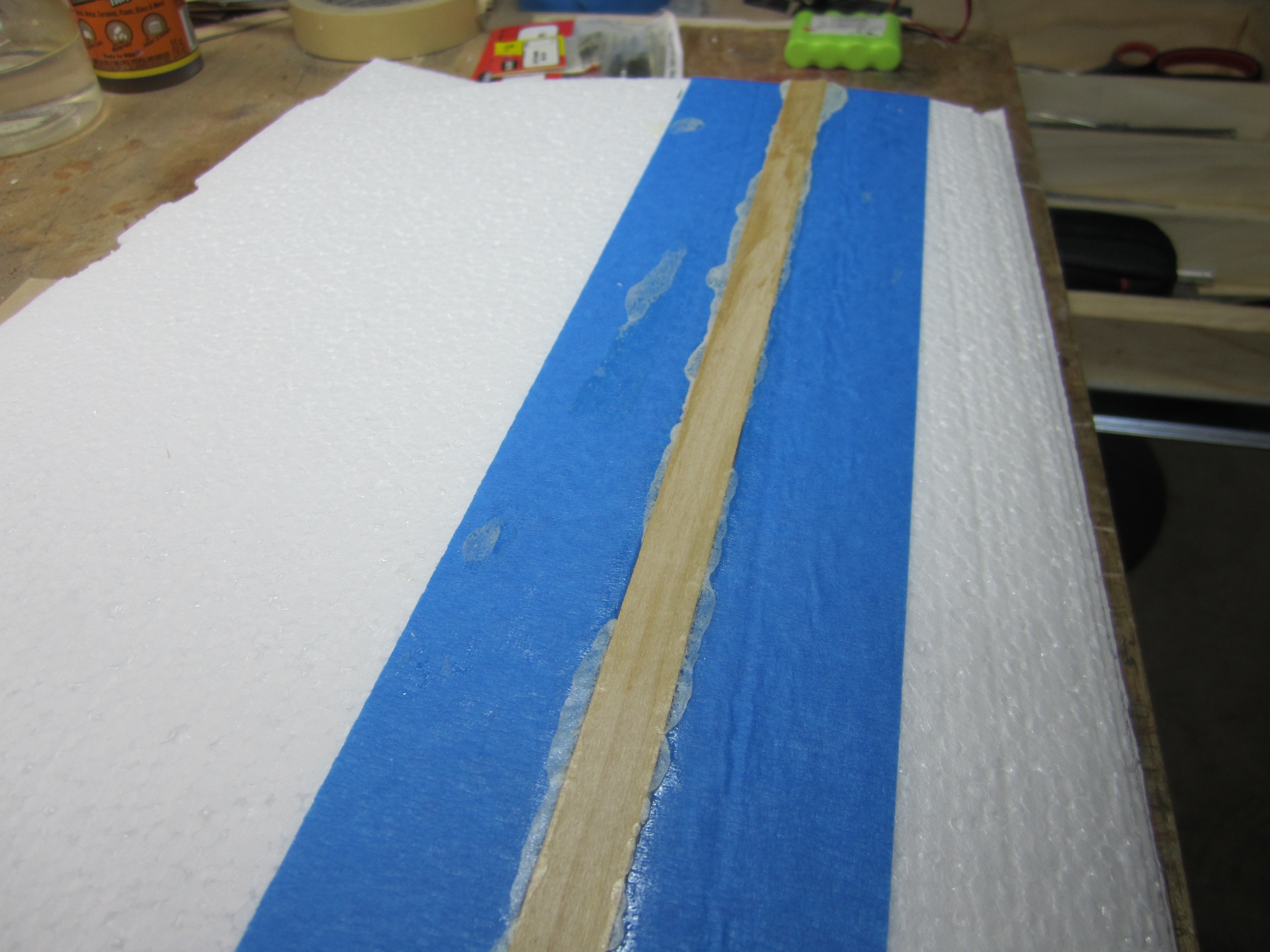

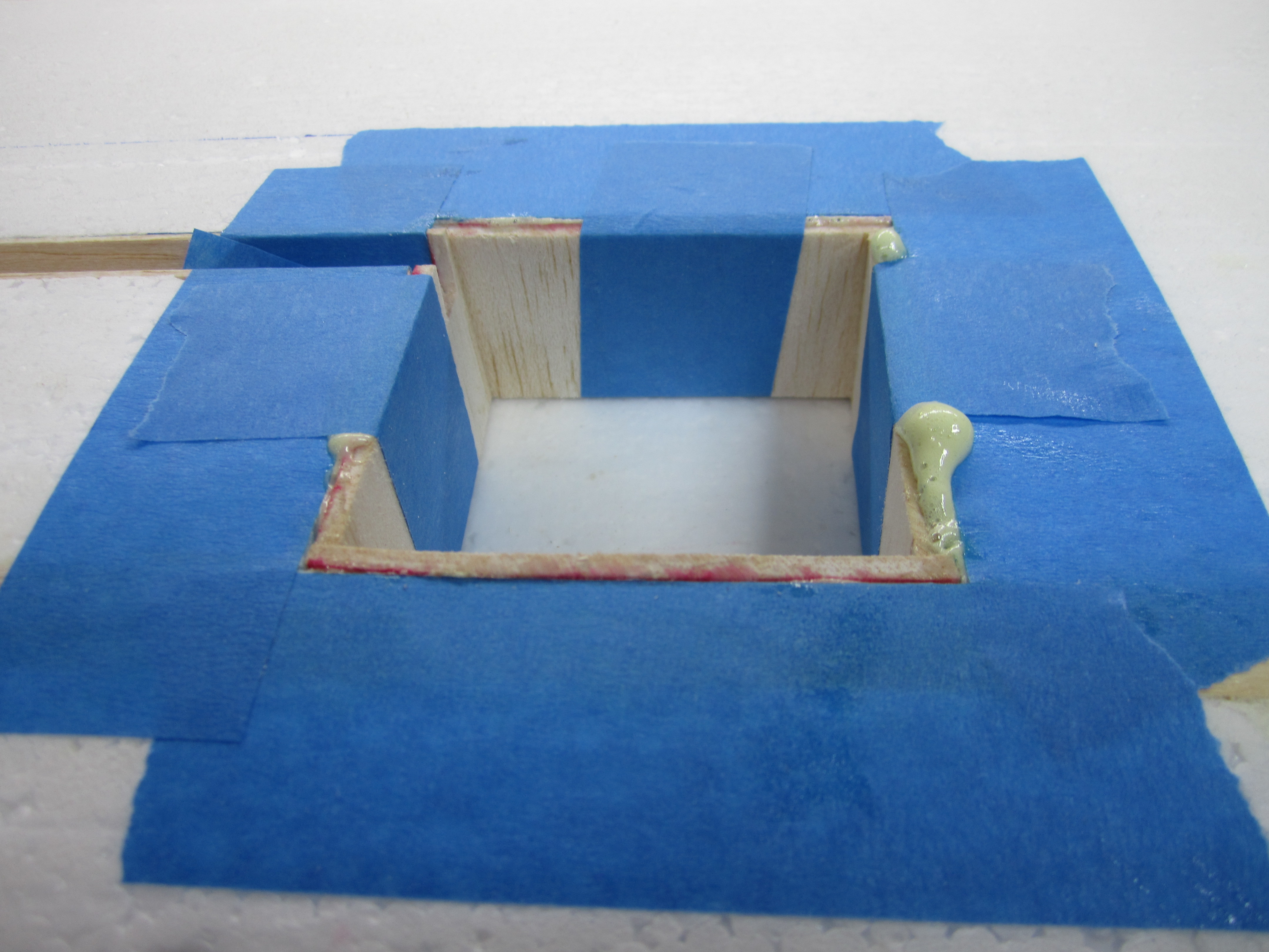

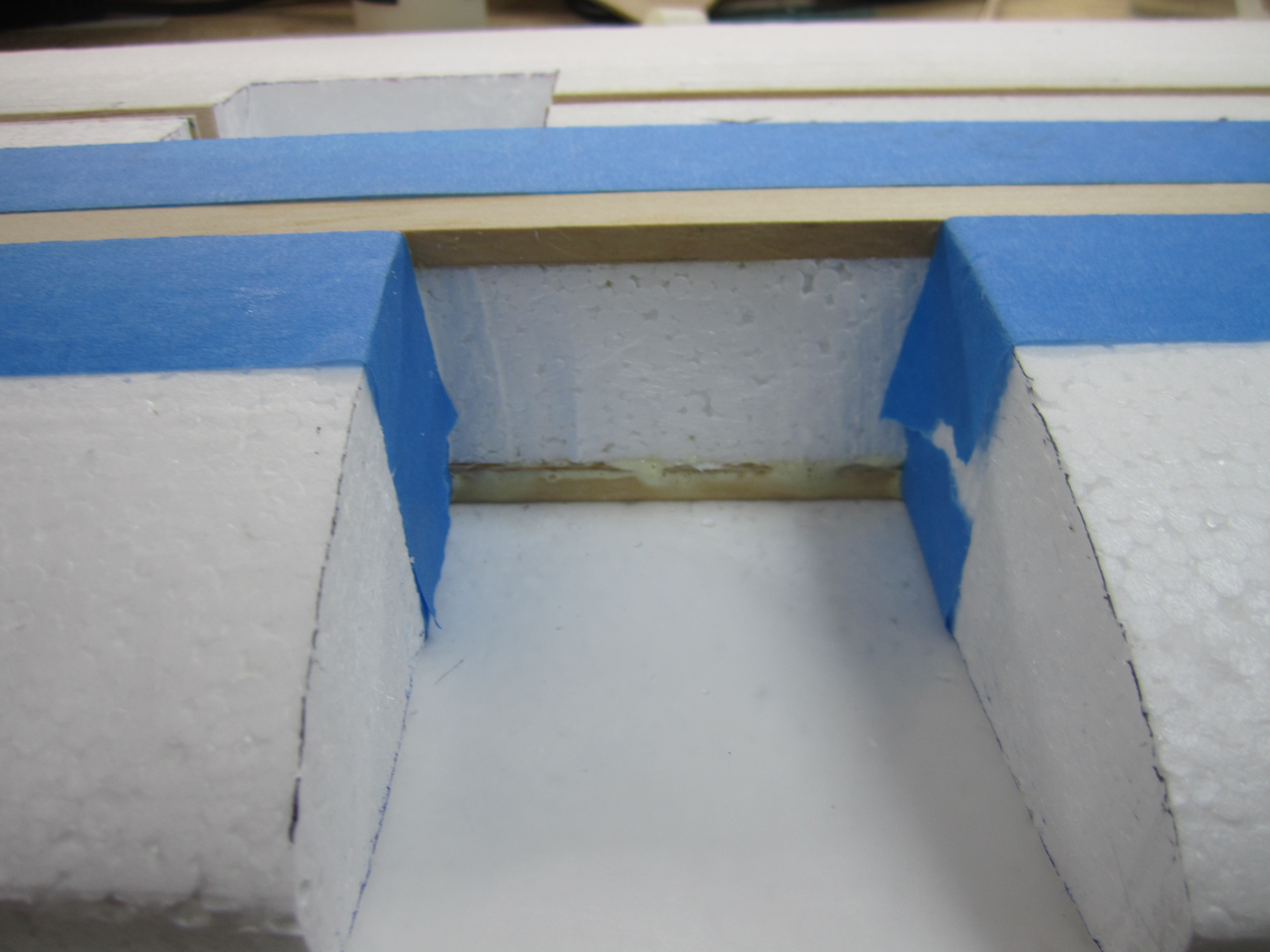

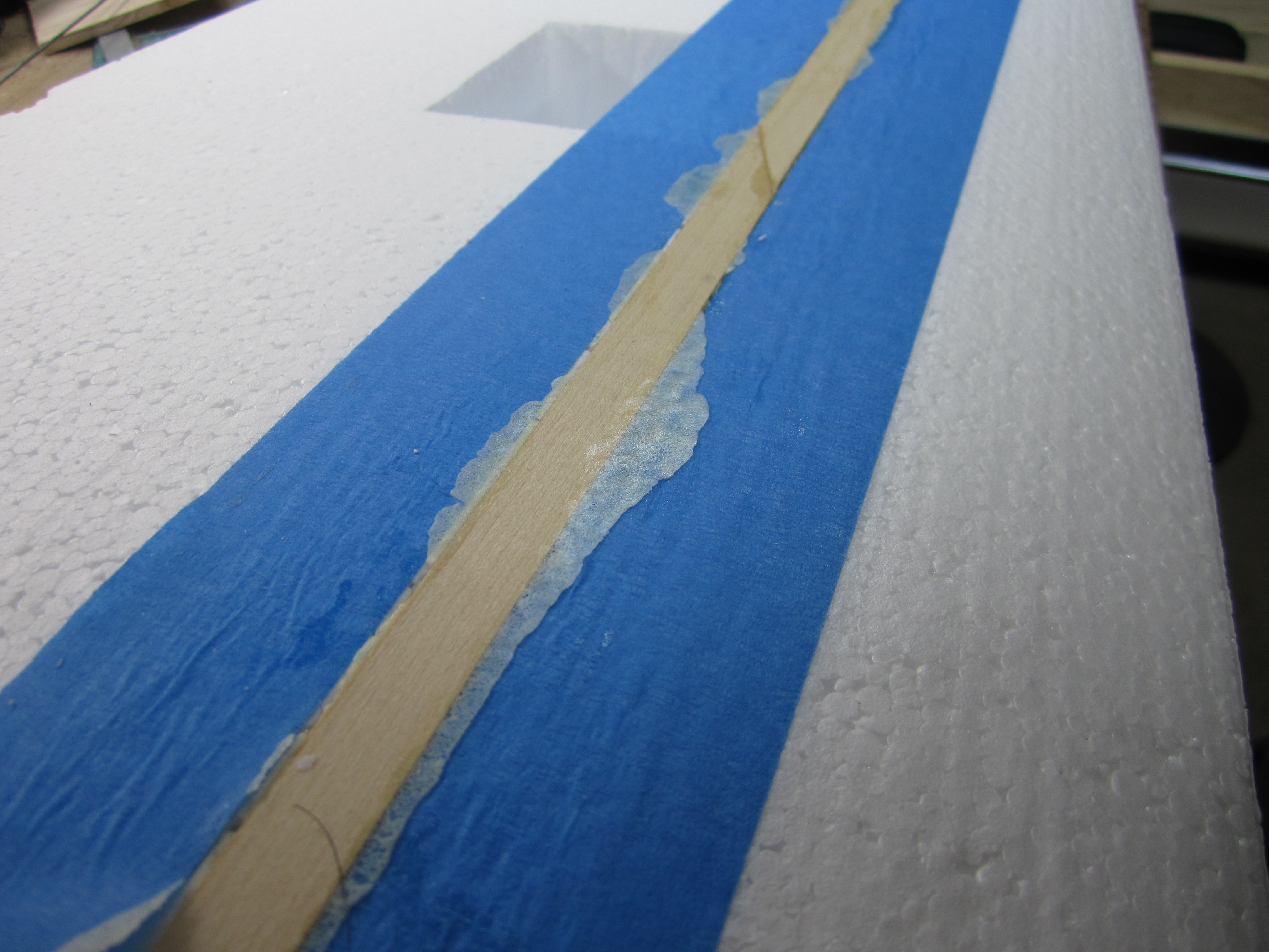

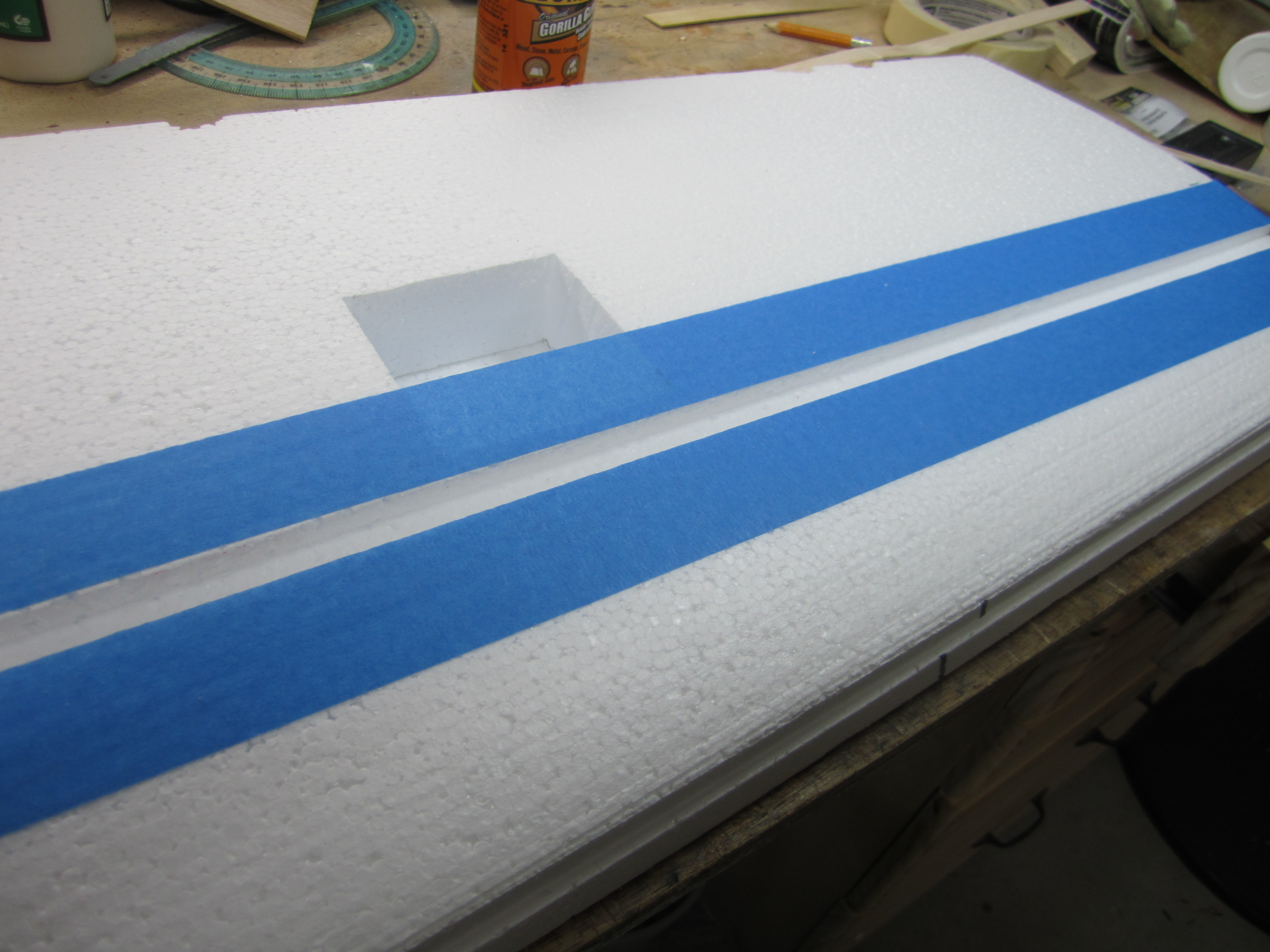

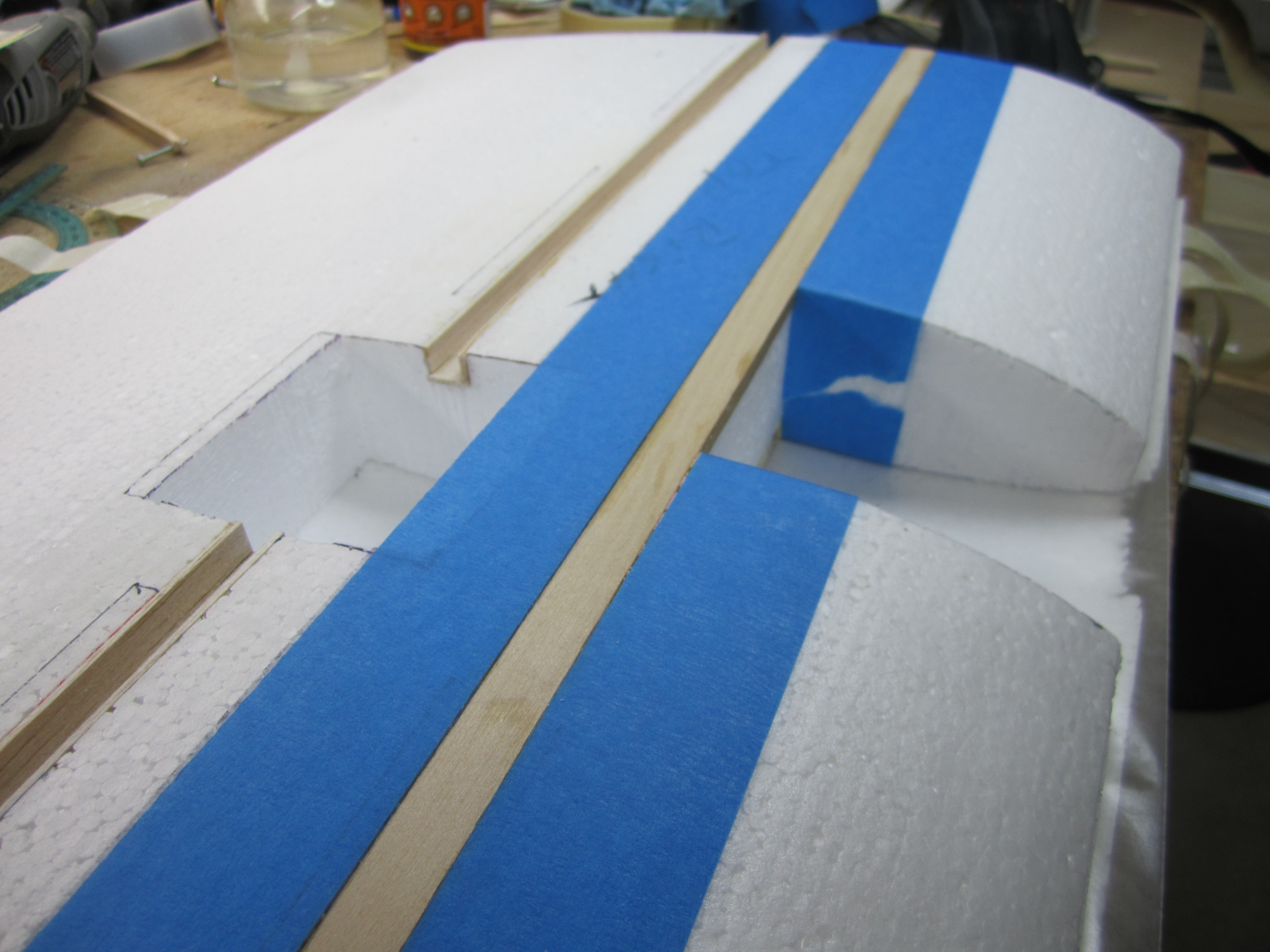

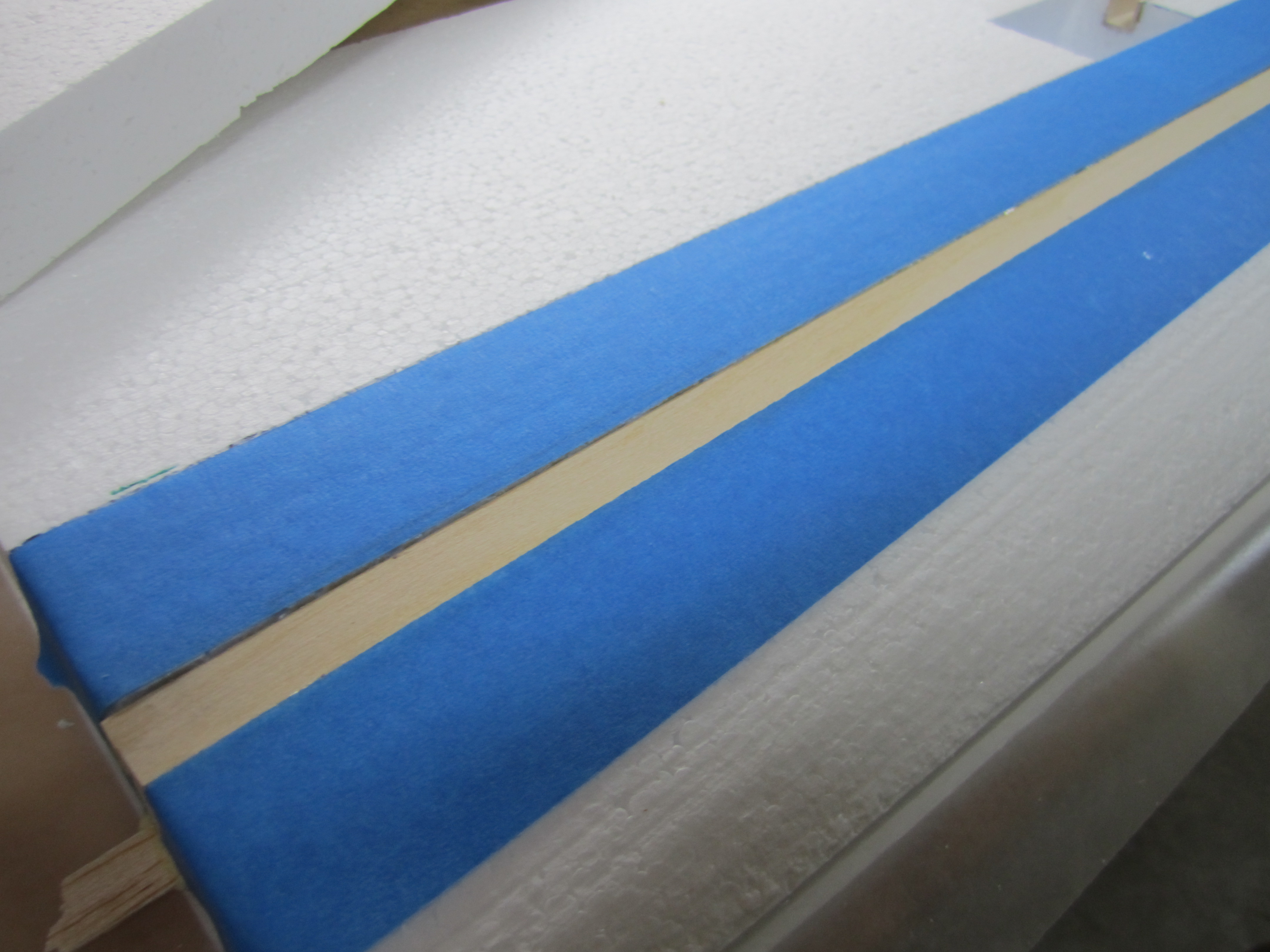

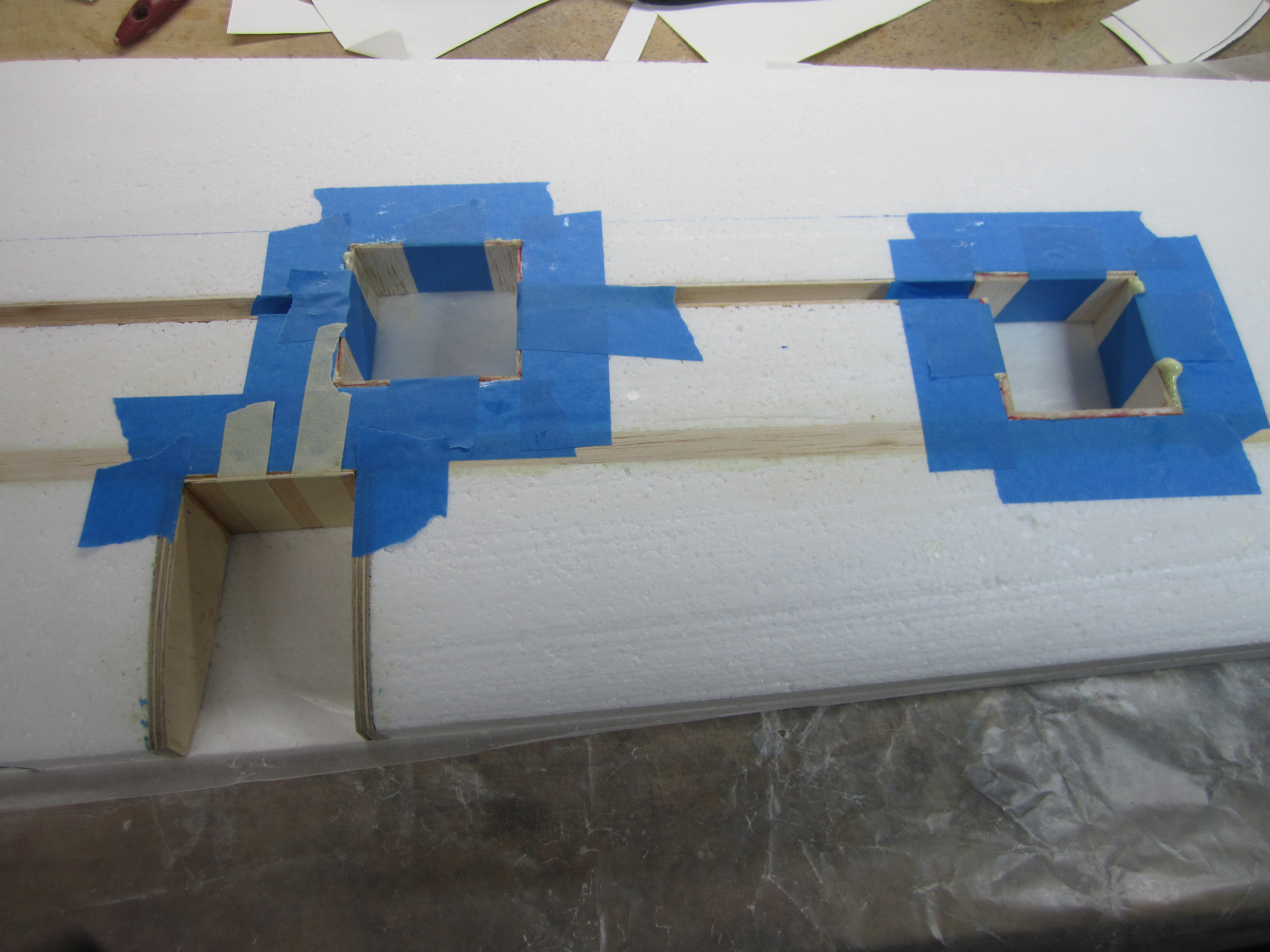

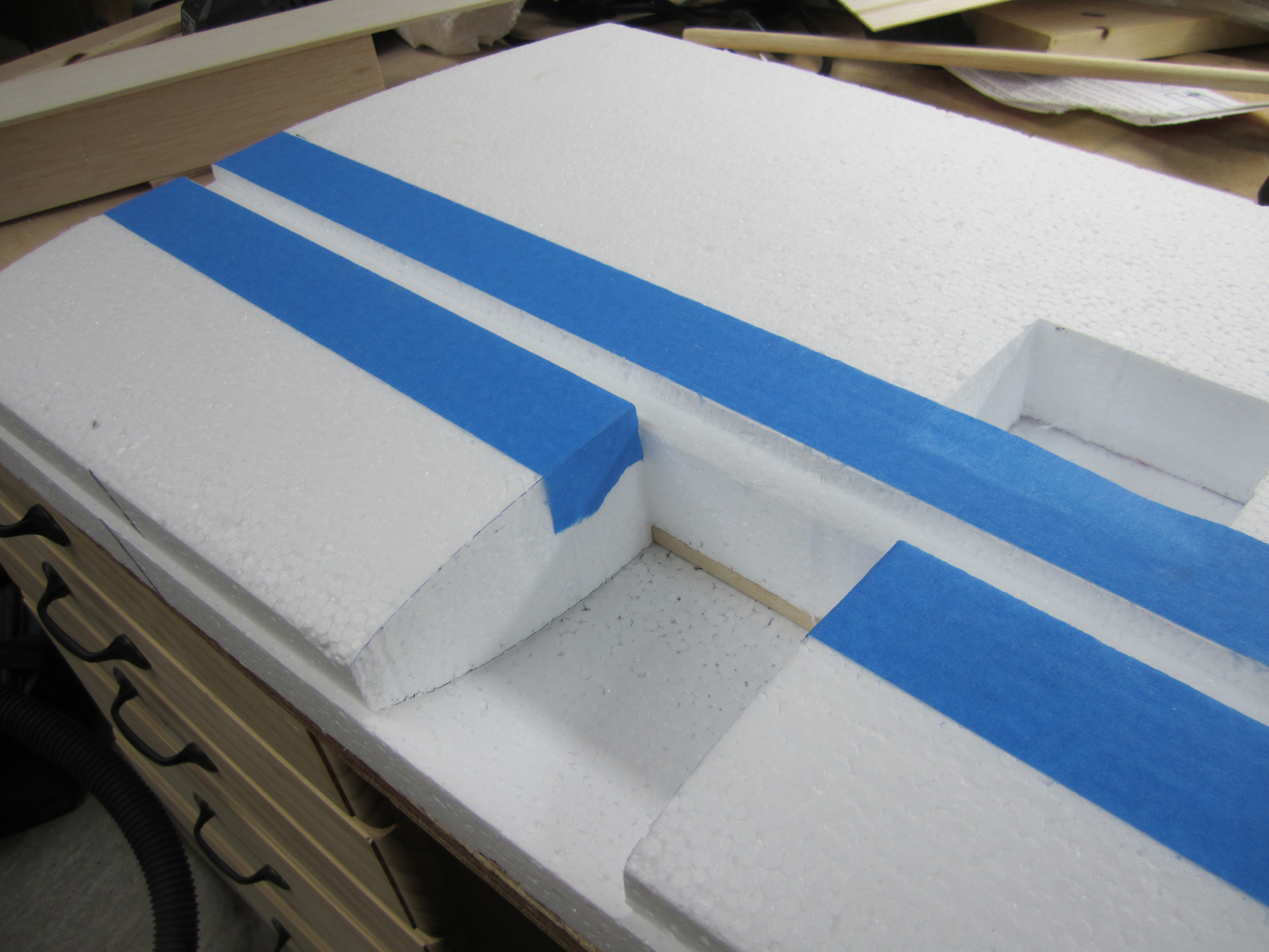

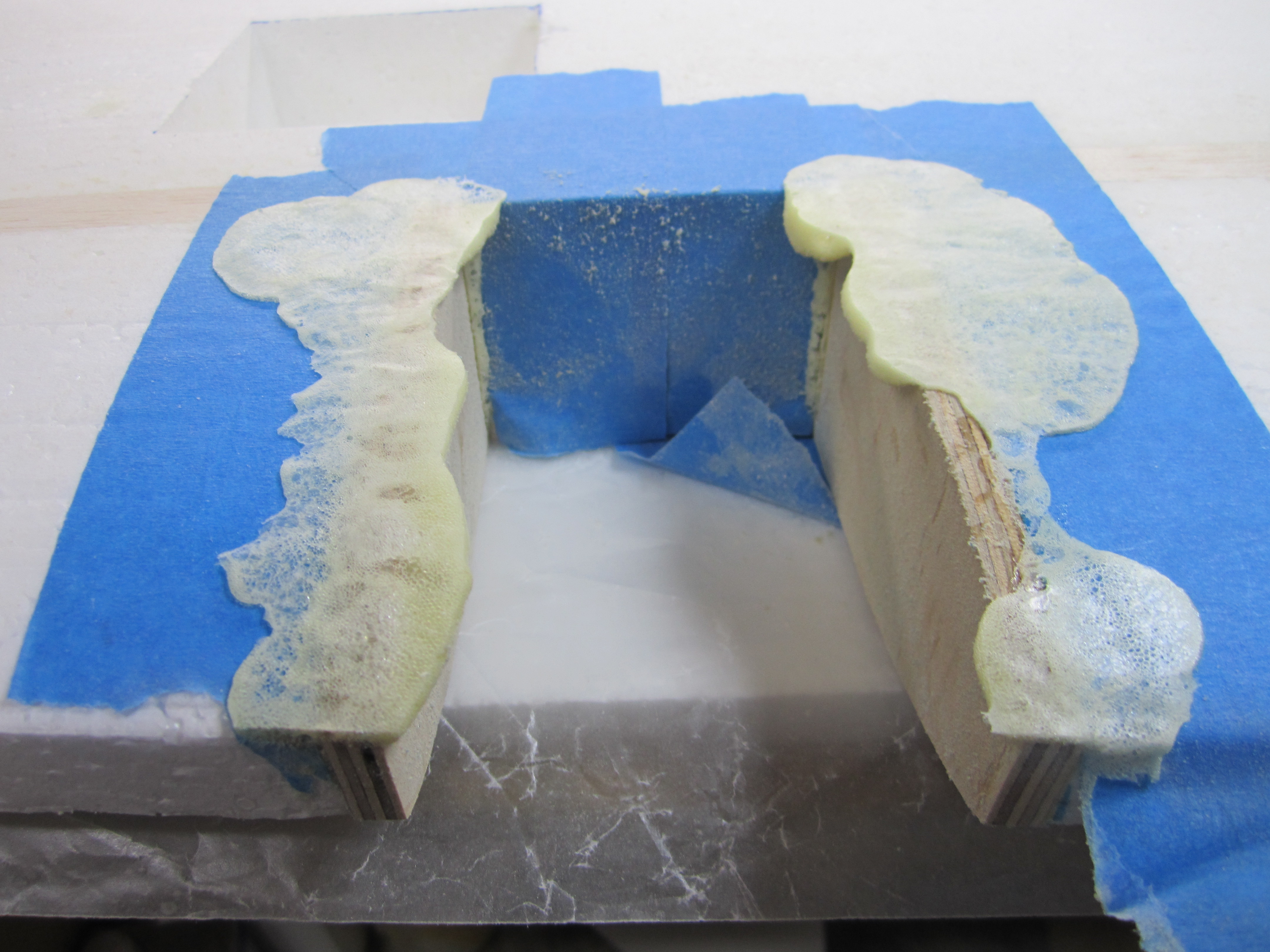

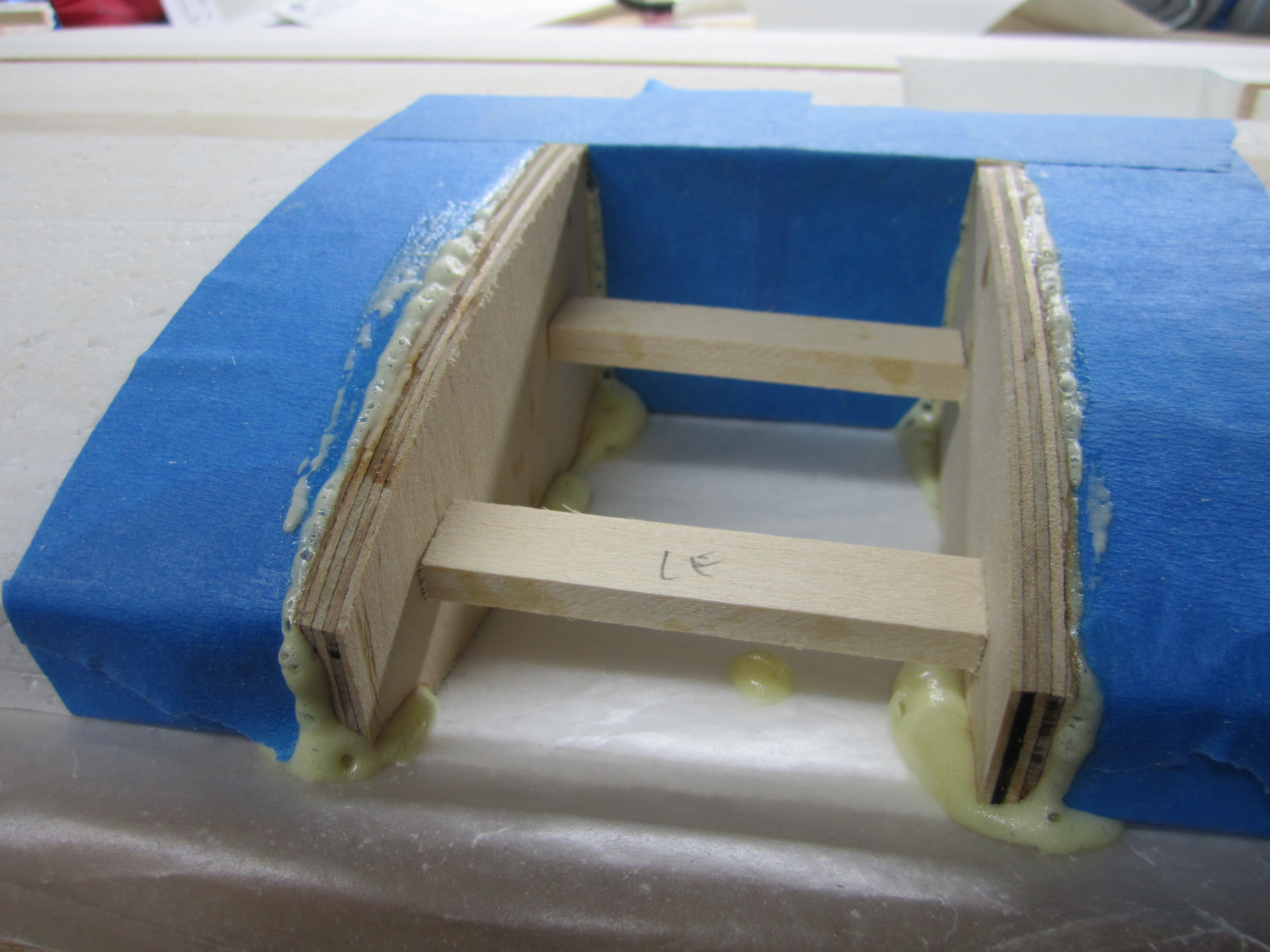

After I marked the wings with the templates, I cut the spars slots (¼ x ½" top and bottom) and the servo wires slot with a router. The holes were cut with a hot wire.
I masked the cuts before gluing the spars, servos canal and landing gear ¼" plywood mountings because I am using Gorilla glue for this and I don't want to clean the mess when it expands.

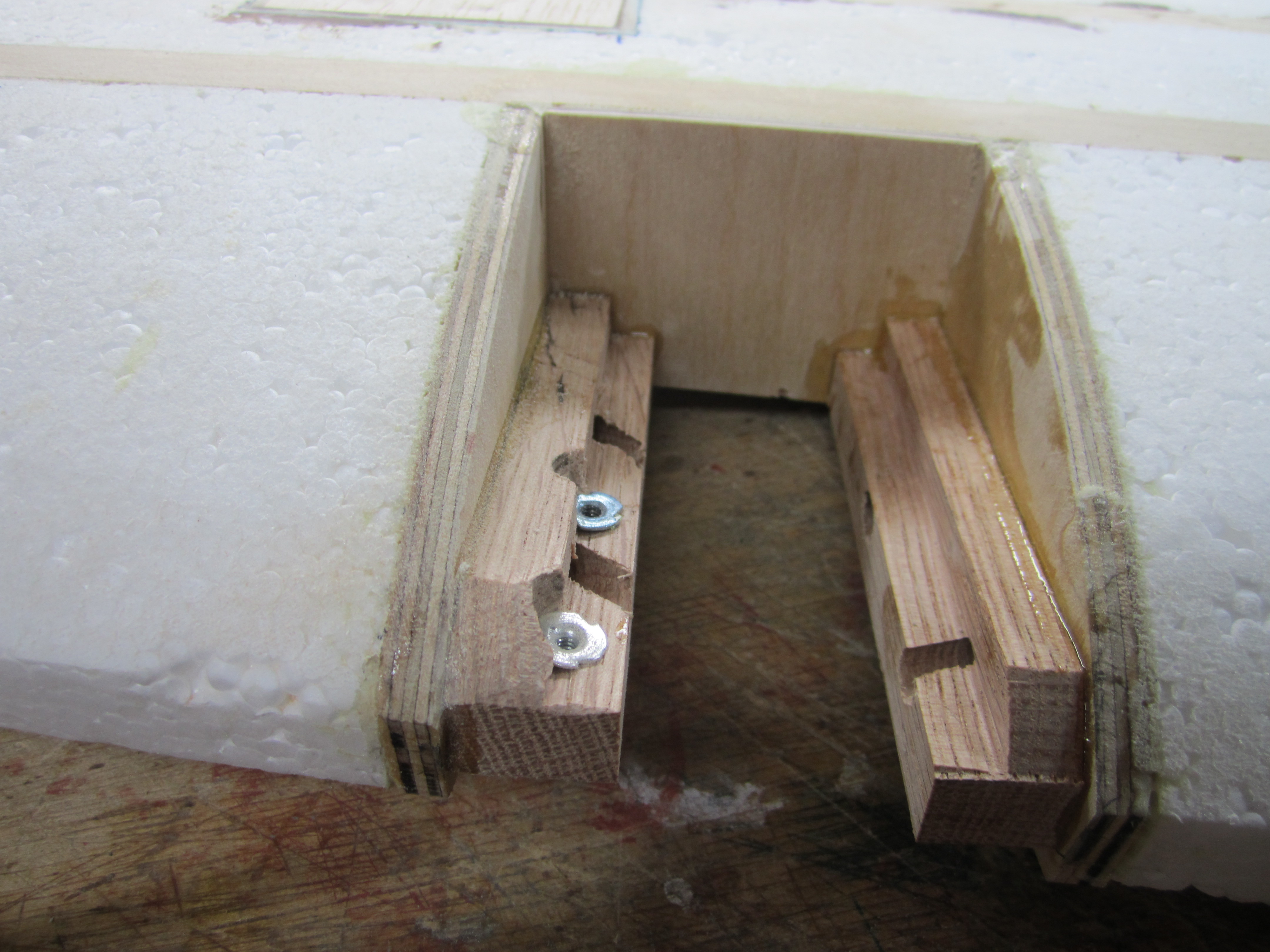

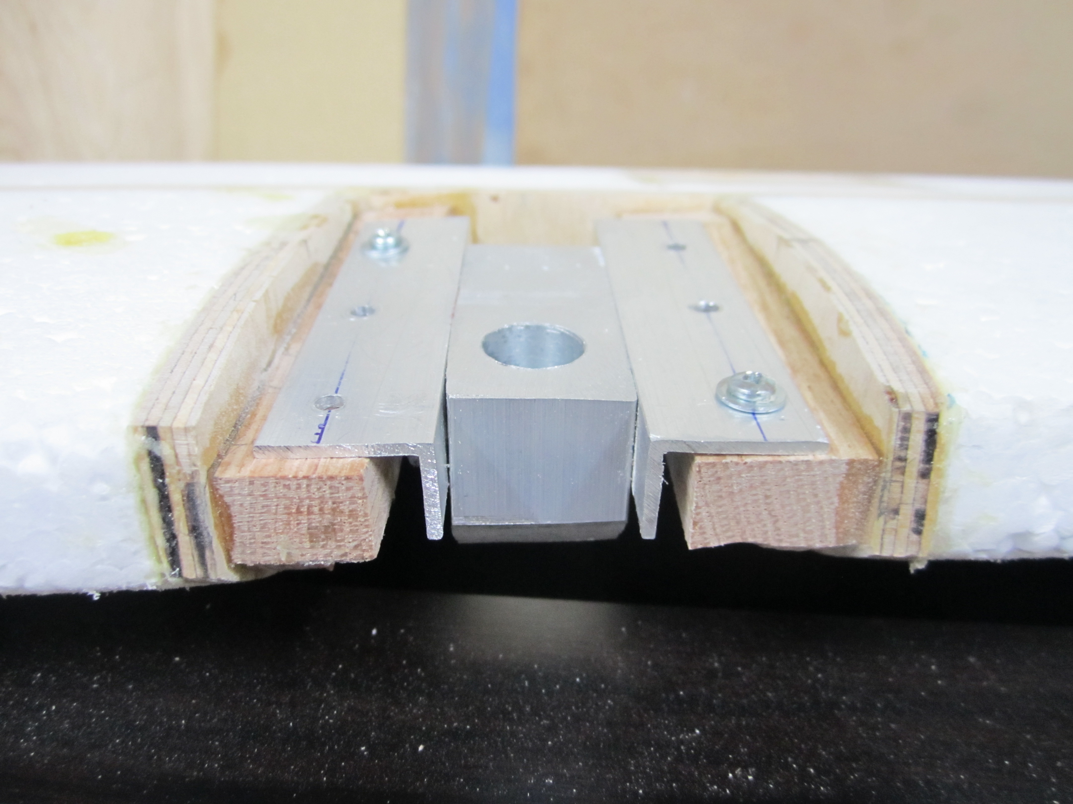

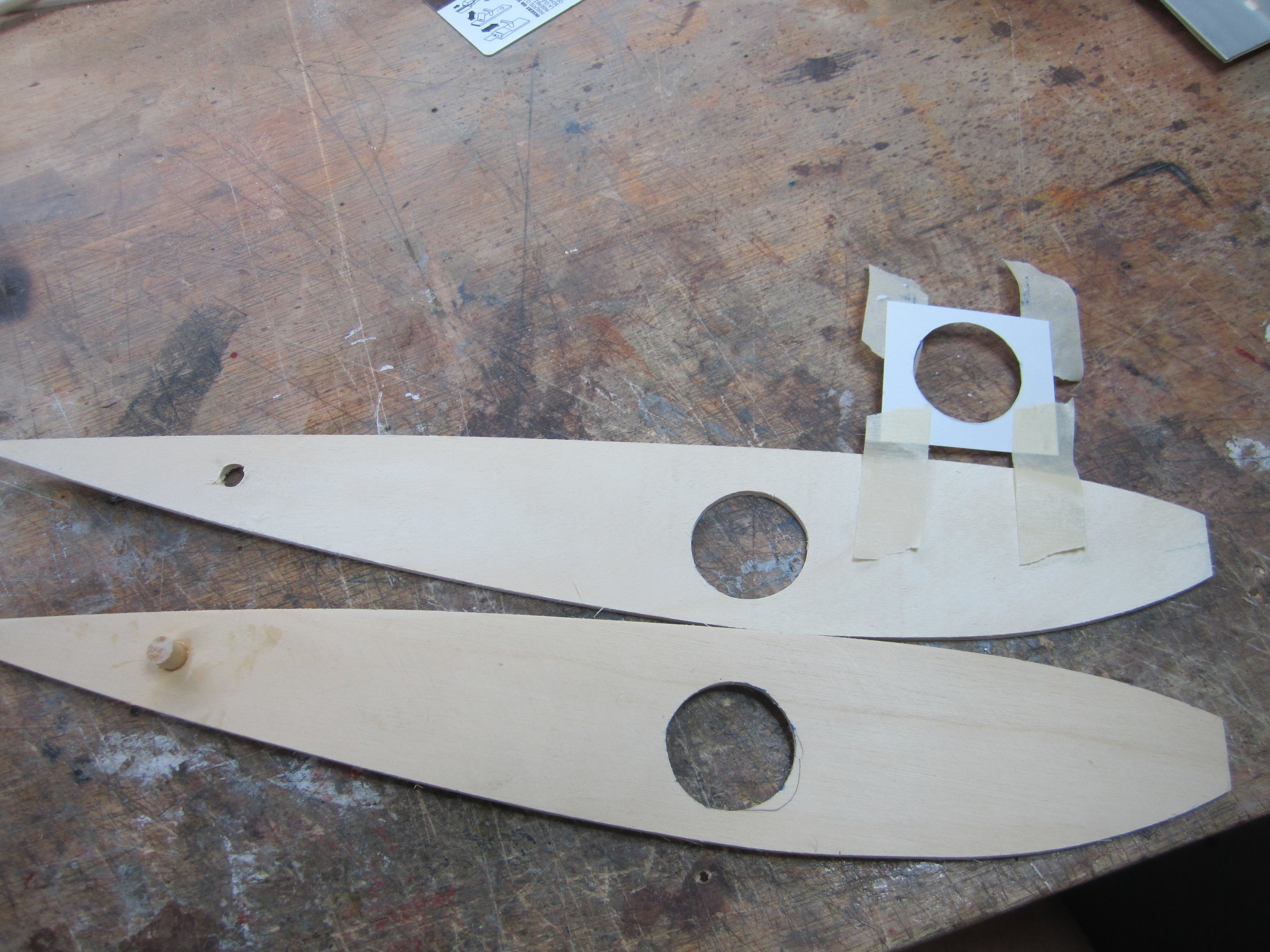

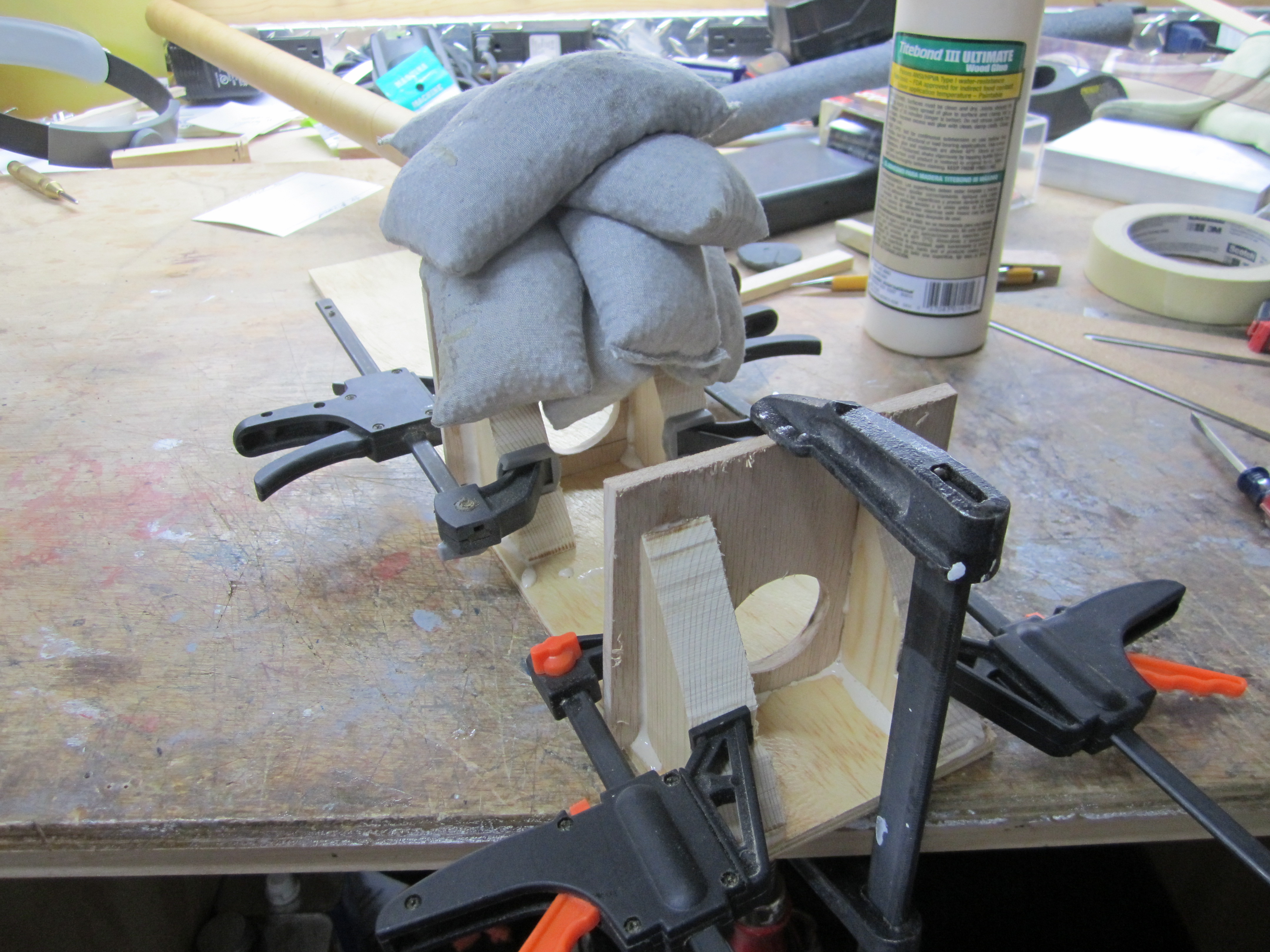

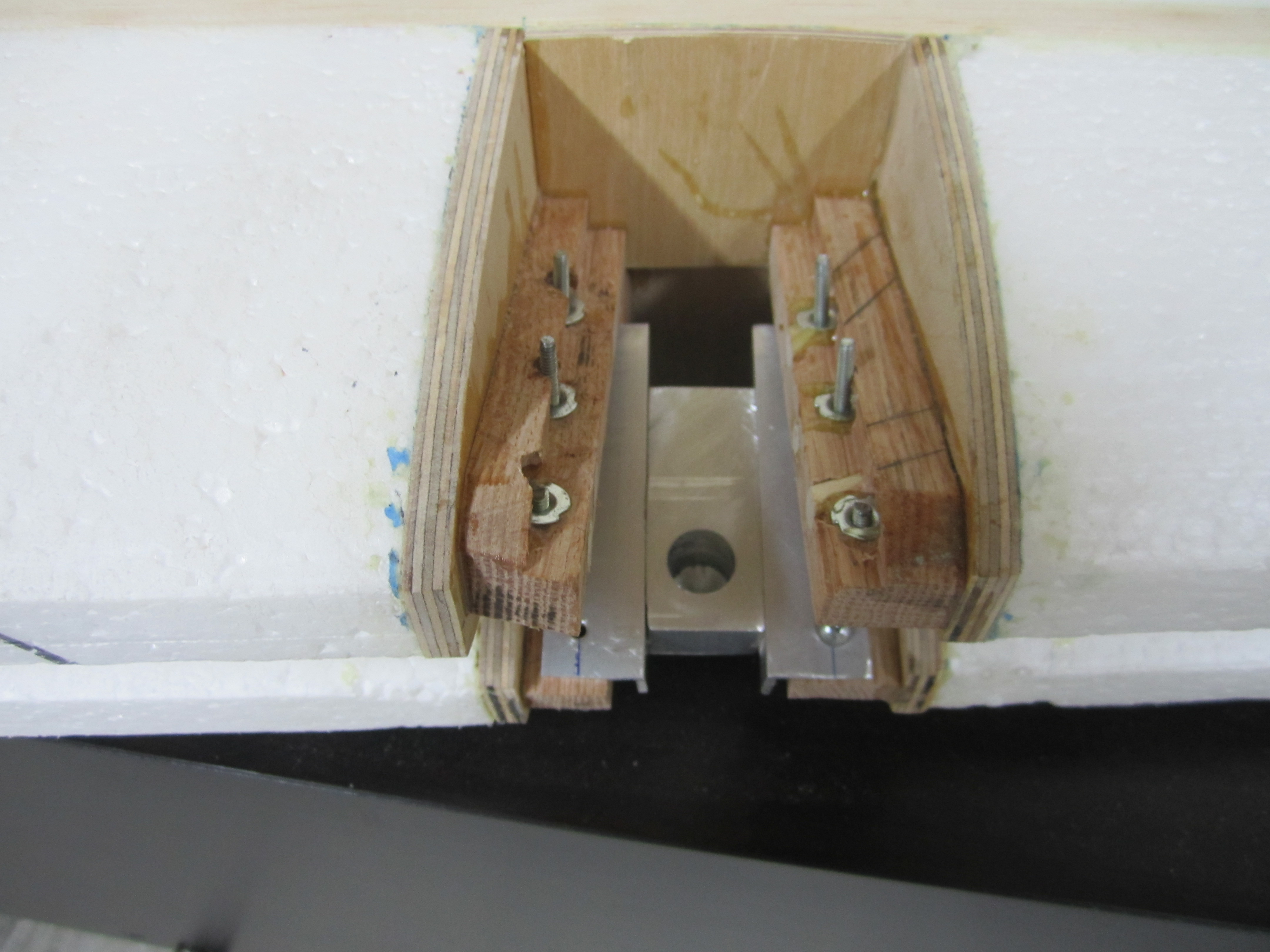

Since I am not going to joint the two wings, I will use an aluminum tube that I ordered from Nick Ziroli. I had to make a jig to get a straight line when cutting the holes.
I drilled the holes with the tube itself. I took into account the dihedral, so I put a piece of wood at the wing tip to elevate it 1 ½" (plans says 2 ⅛ but is too much for me) before cutting it. Then I aligned very carefully the tube and by hand I opened the wing holes.

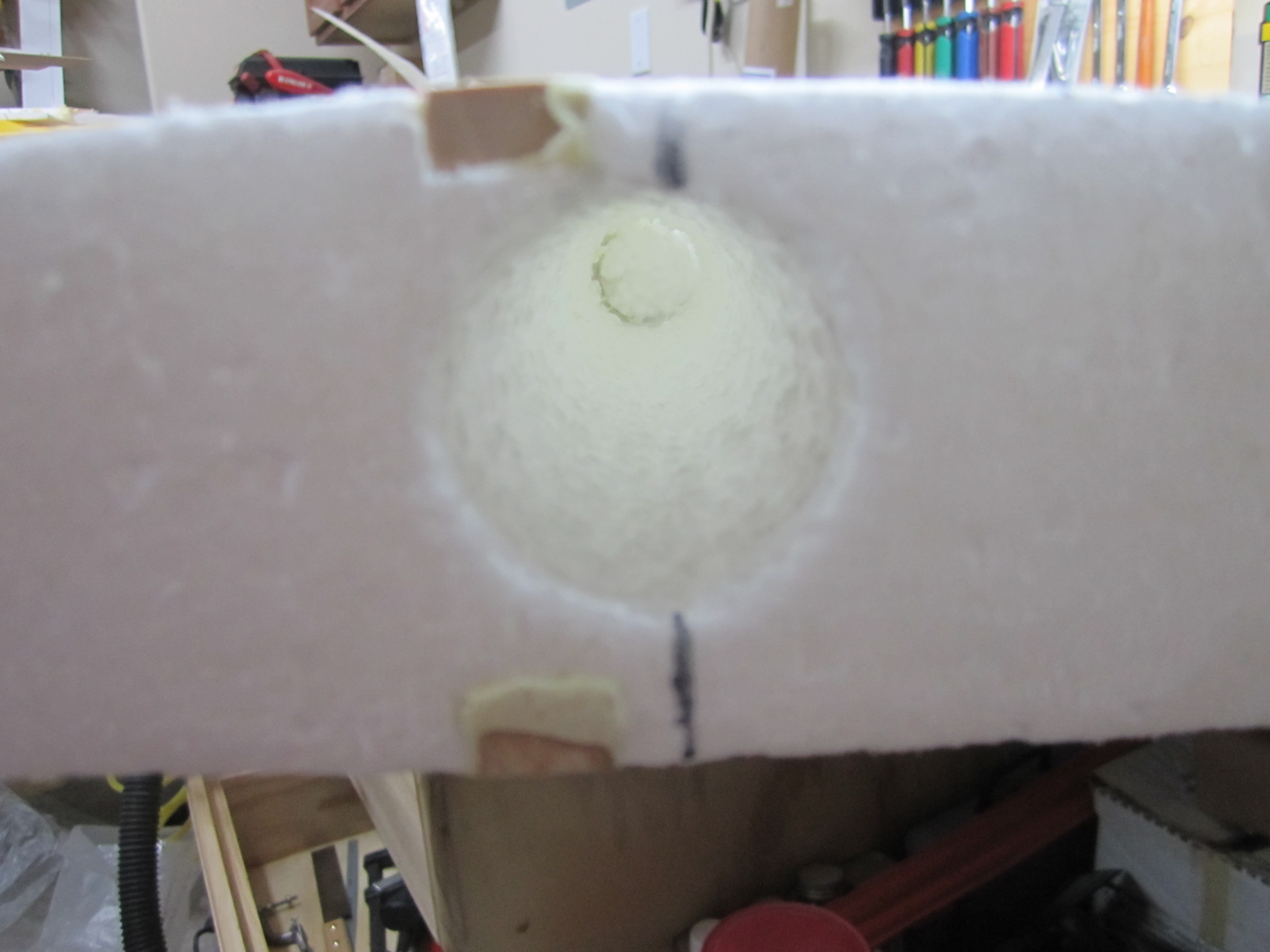

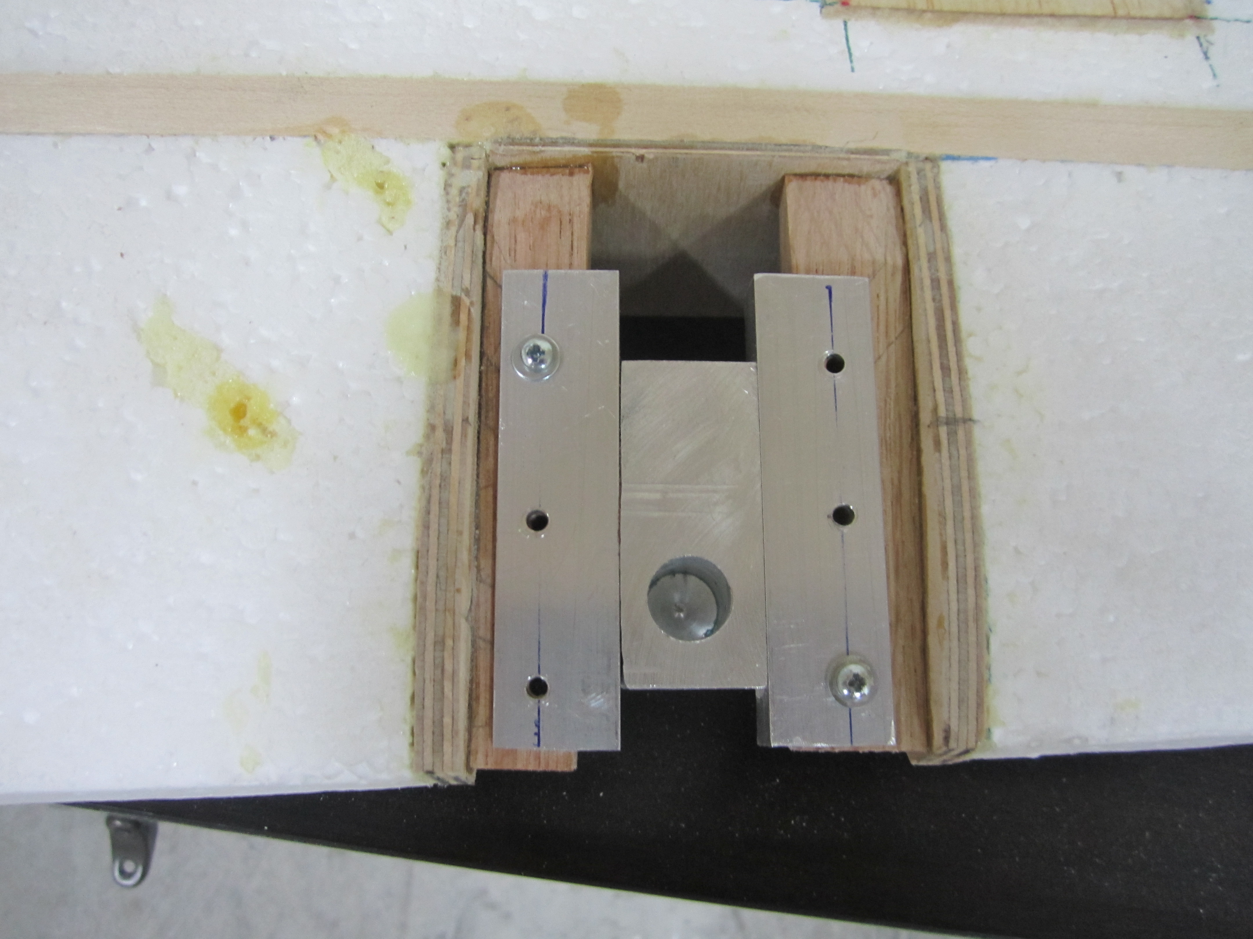

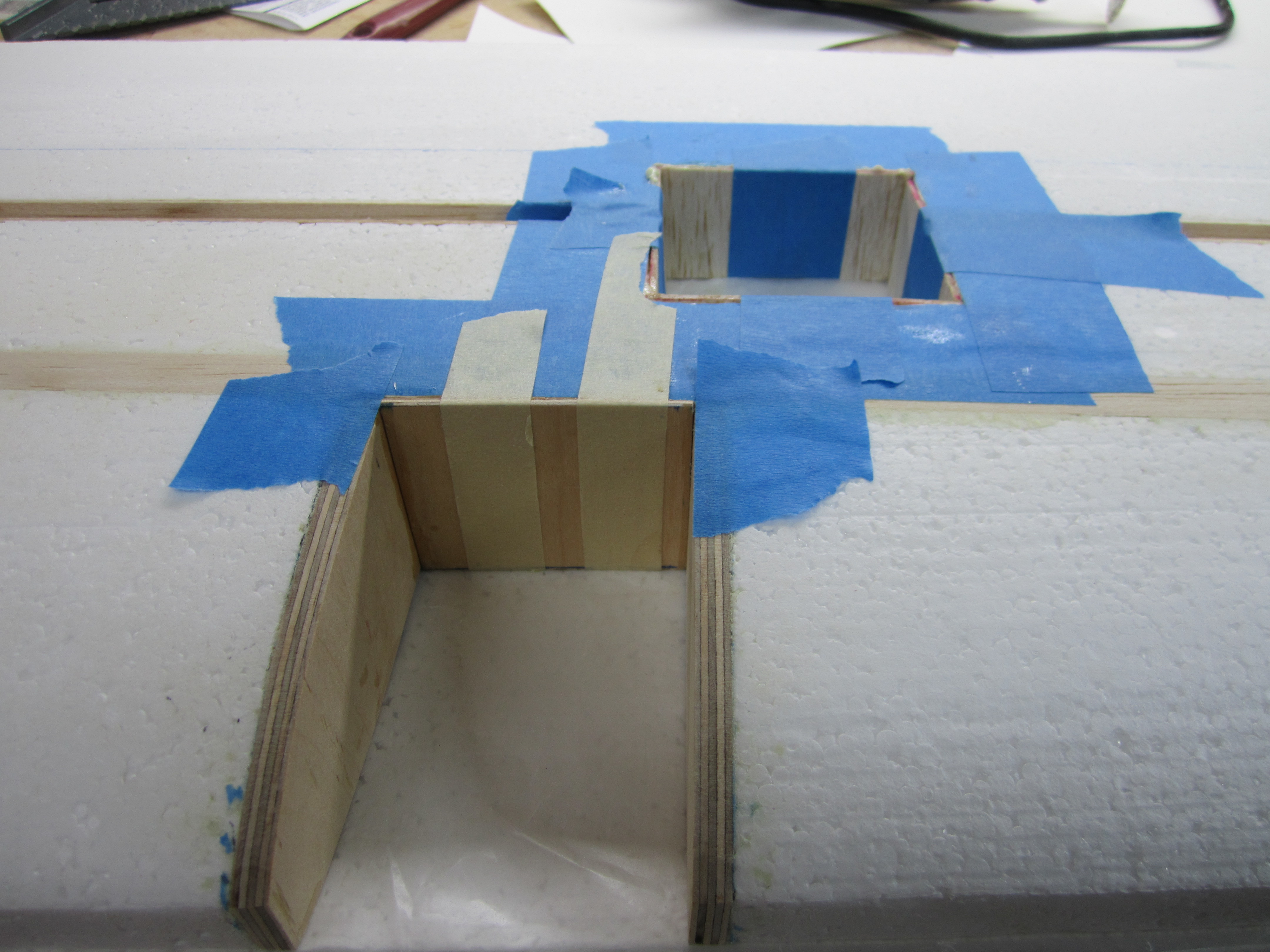

After that, I mounted the landing gear supports (red oak) and installed blind nuts. I also drilled ¼" hole in those wood blocks al the way through the plywood and into the foam and inserted ¼" wood dwell with gorilla glue. I was looking to have some extra support to this blocks. I don't want my landing gears to fail.
Since I will cover all the holes, with 1/16" balsa to avoid the gorilla glue going into them, I am concern with the top part of the landing gear holes, since we use that area of the wing when handling it. I am running a test with carbon fiber cloth in a piece of foam that I am planning to glue in the top part (for the bottom part I will make it with fiber glass or carbon fiber) to see how it looks once it dries and I apply a 1/16" piece of balsa. Not sure if the CF will raise the balsa in the wing that you will notice when I glue the sheeting.
In the mean time, I glued the stab with 30 min epoxy. I had to install "shims" in one of the half since they were not level.

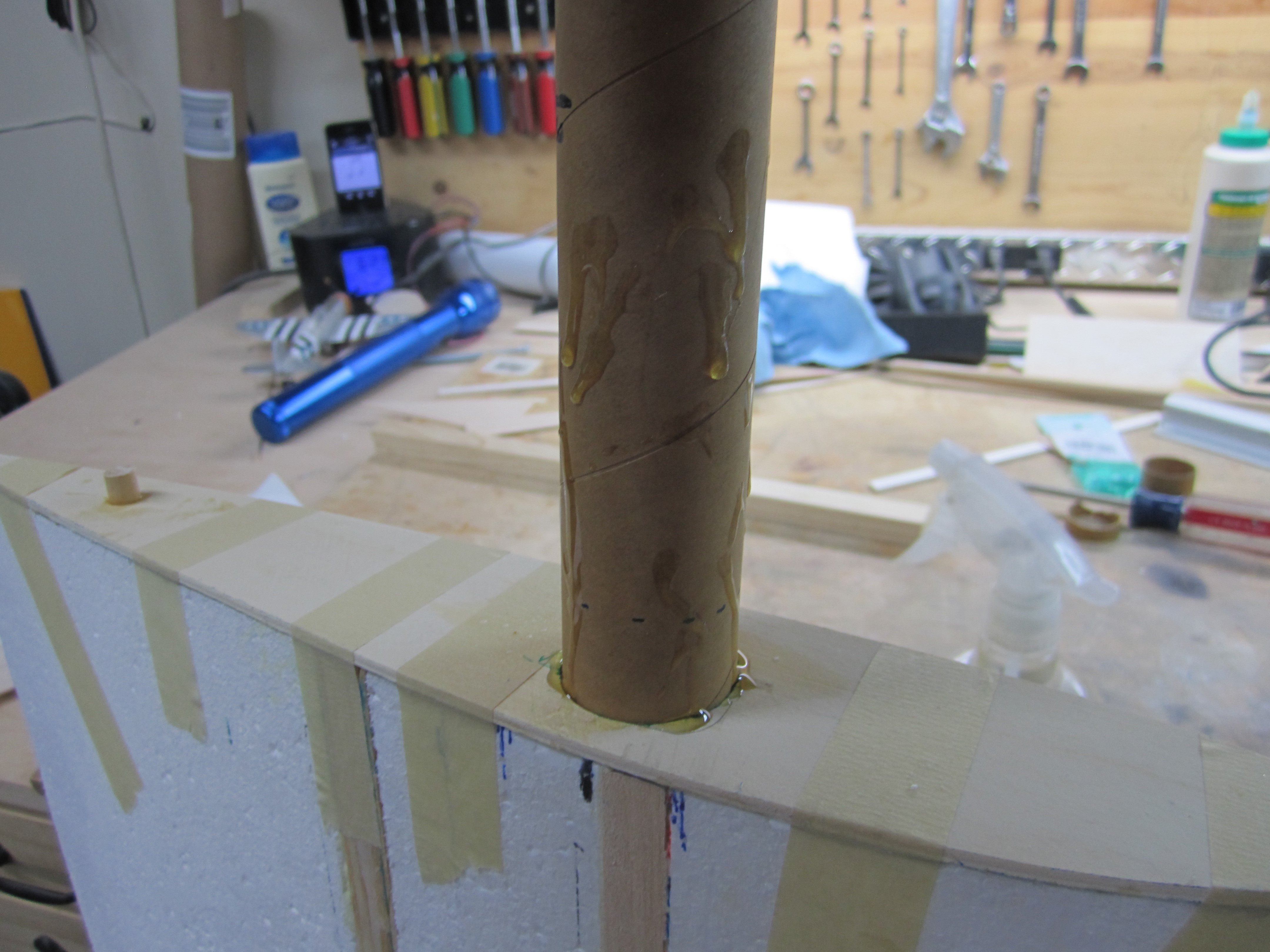

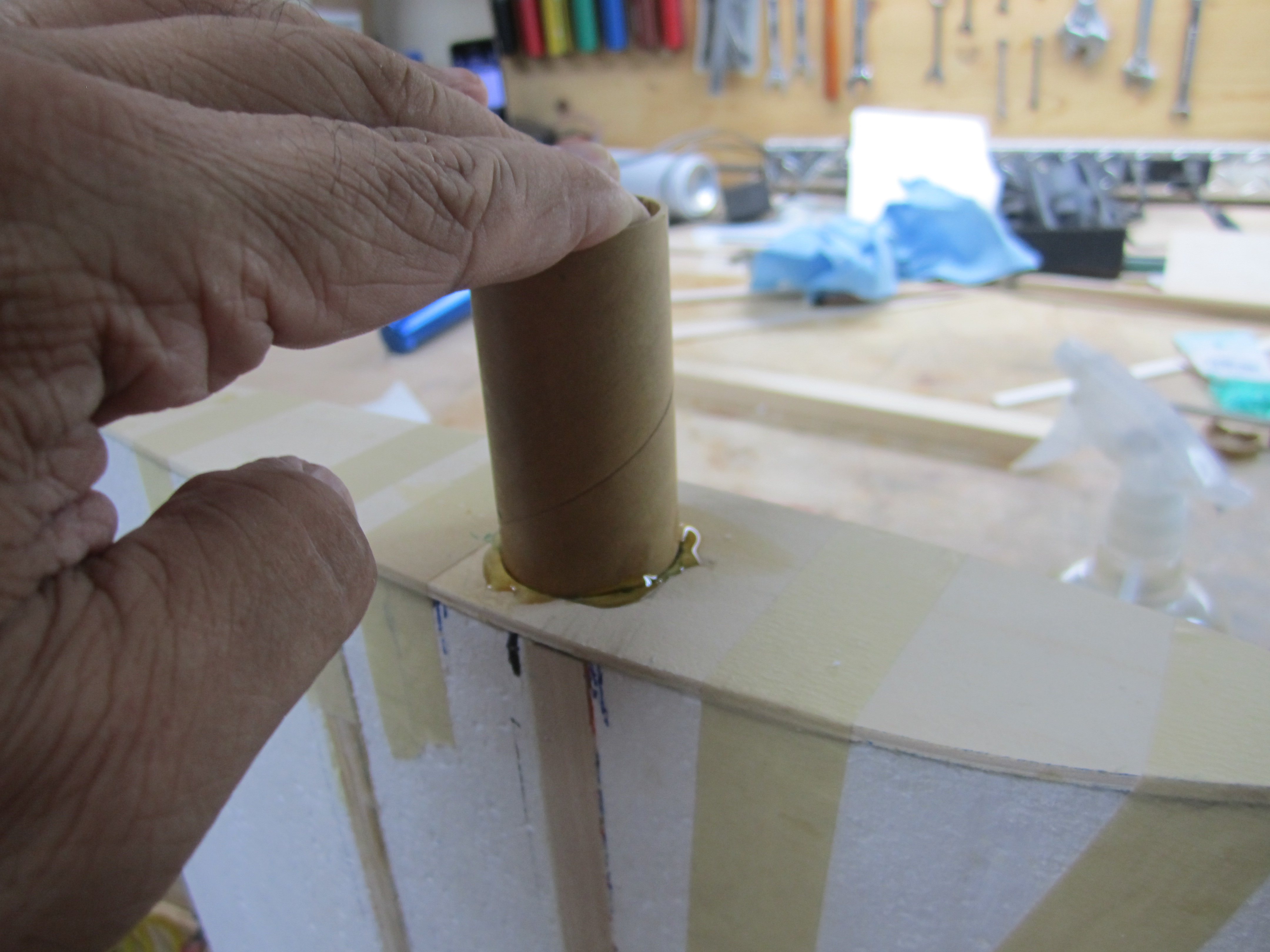

I also would recommend a paper tube for wires if you haven't already done this. The DLE55 is perfect for this and when I build my third as a super chipmunk I may squeeze a 61 in it. I would pin the side ply on your gear bays with dowels into the foam, otherwise your doing good.

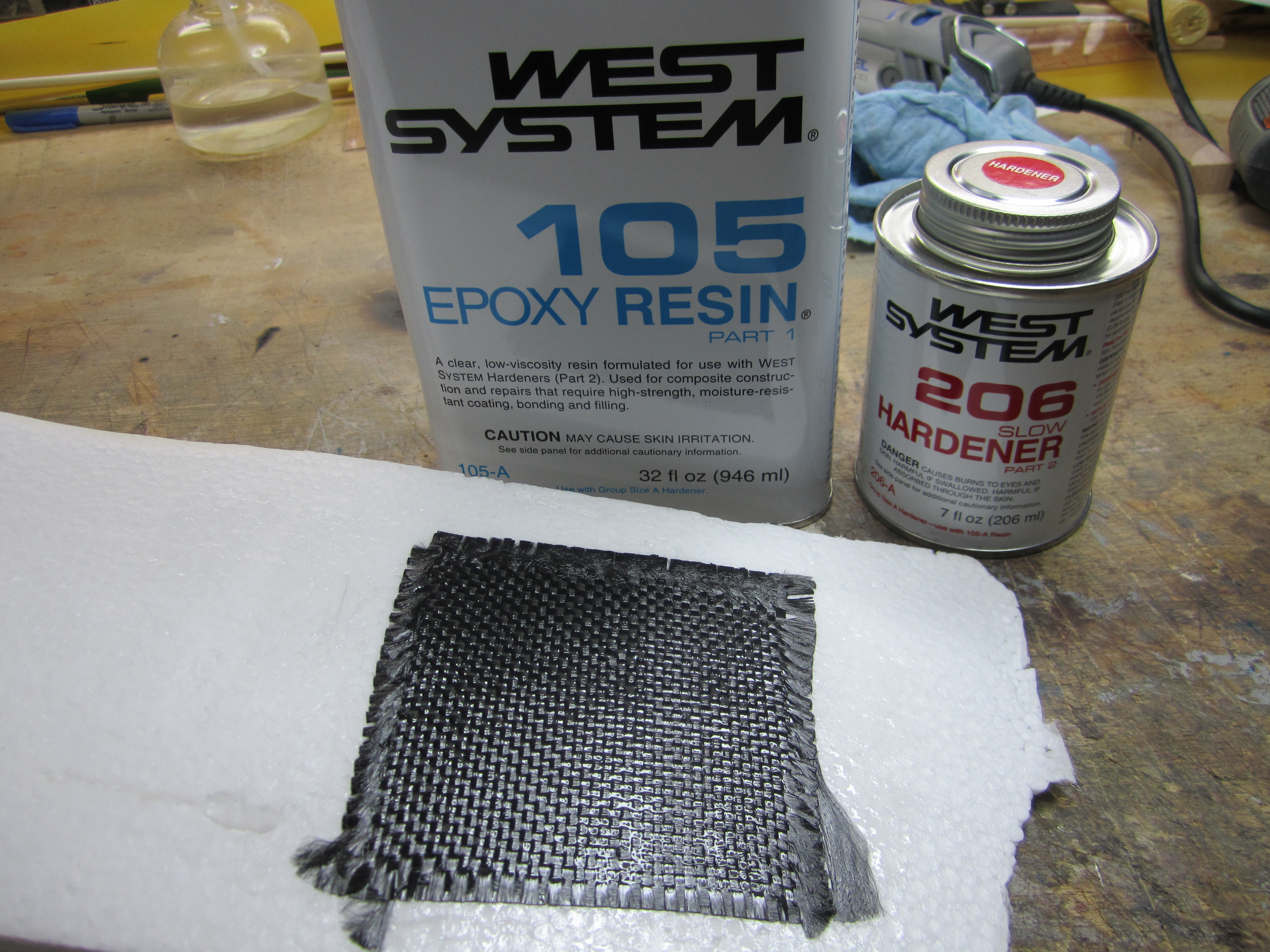

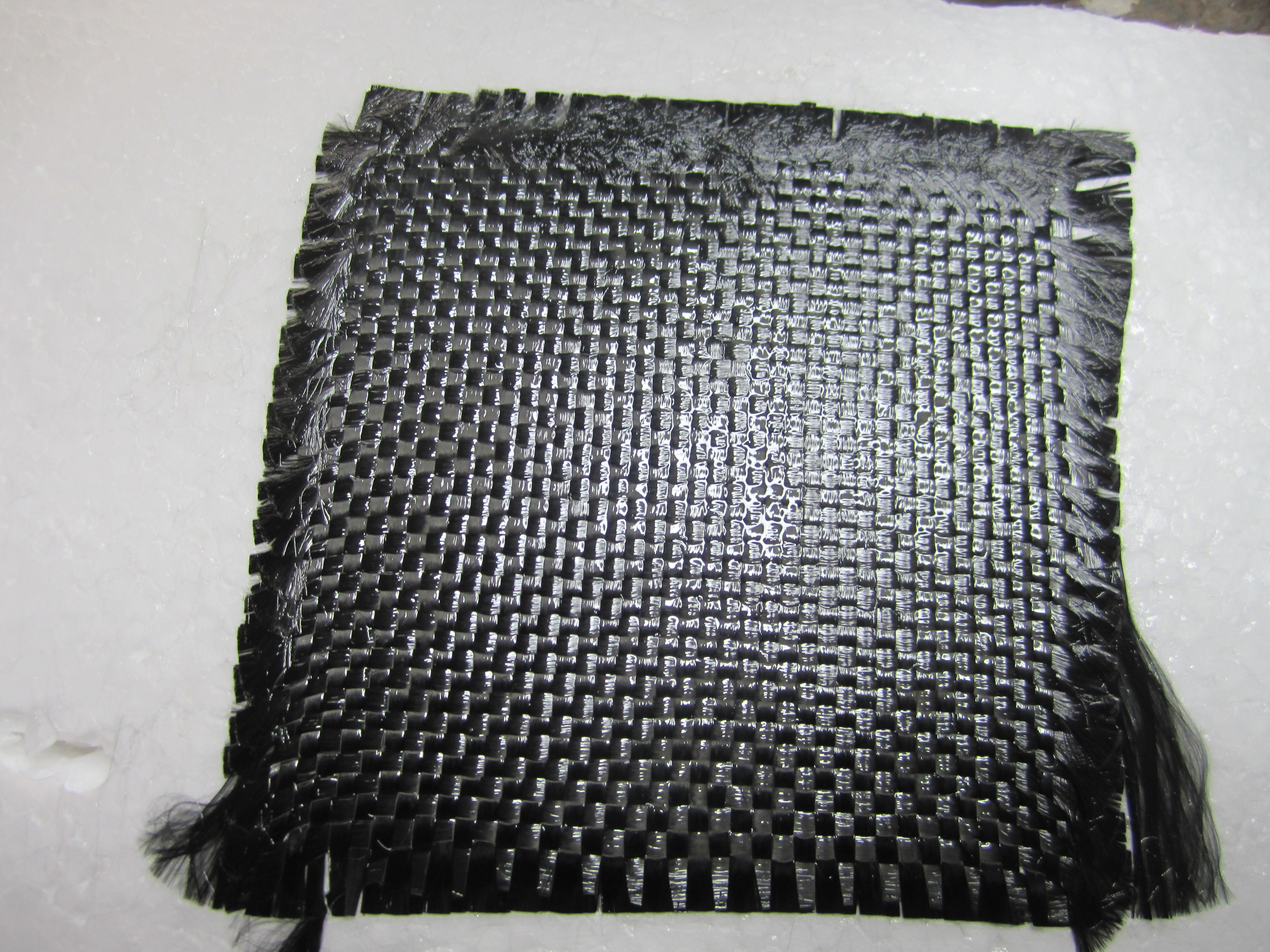

Thank you TB, your Chipmunk job was just impressive, and I will "borrow" with your permission some of your ideas.
My progress this week have been slow due to some commitments, but here we go.

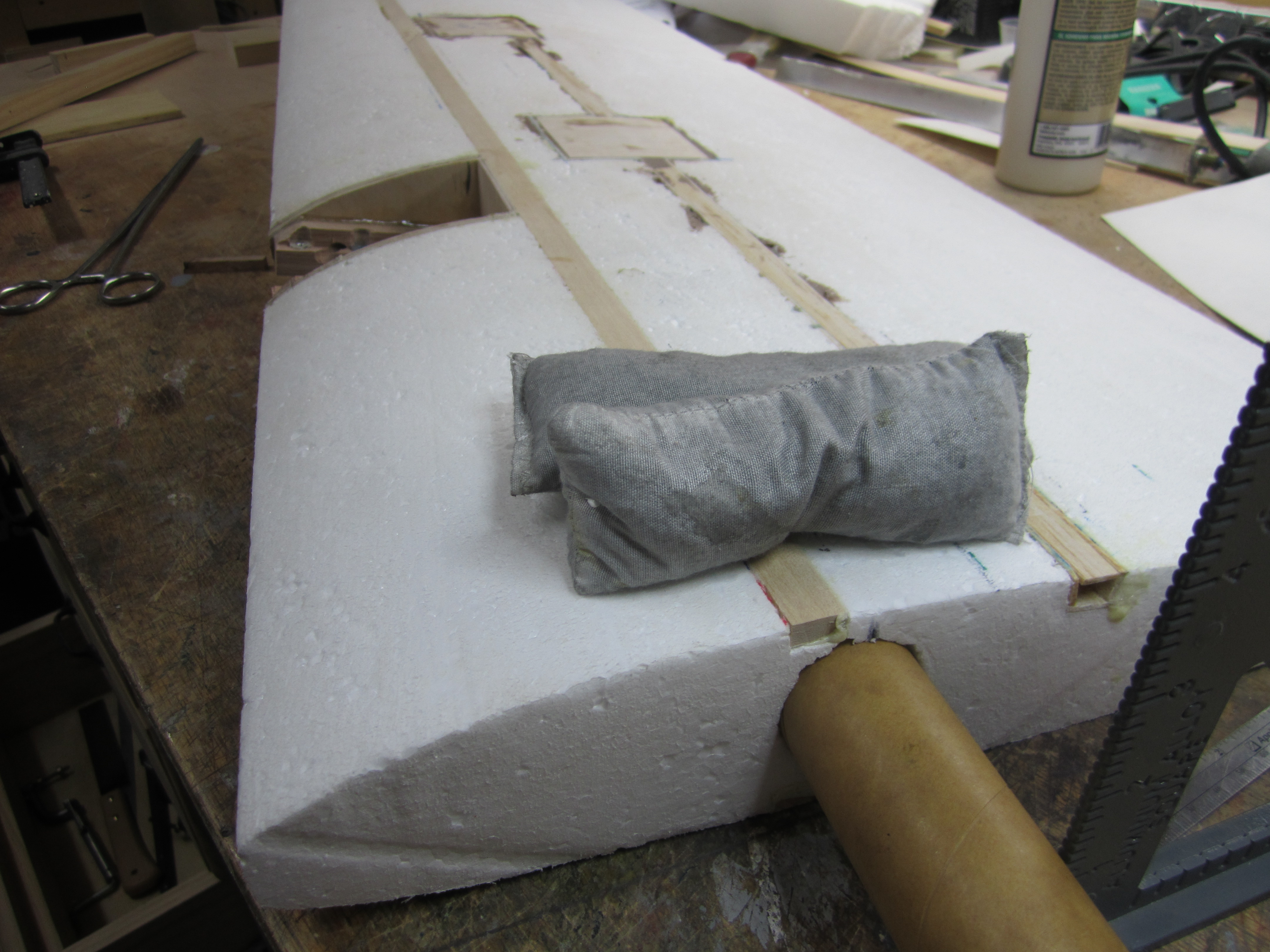

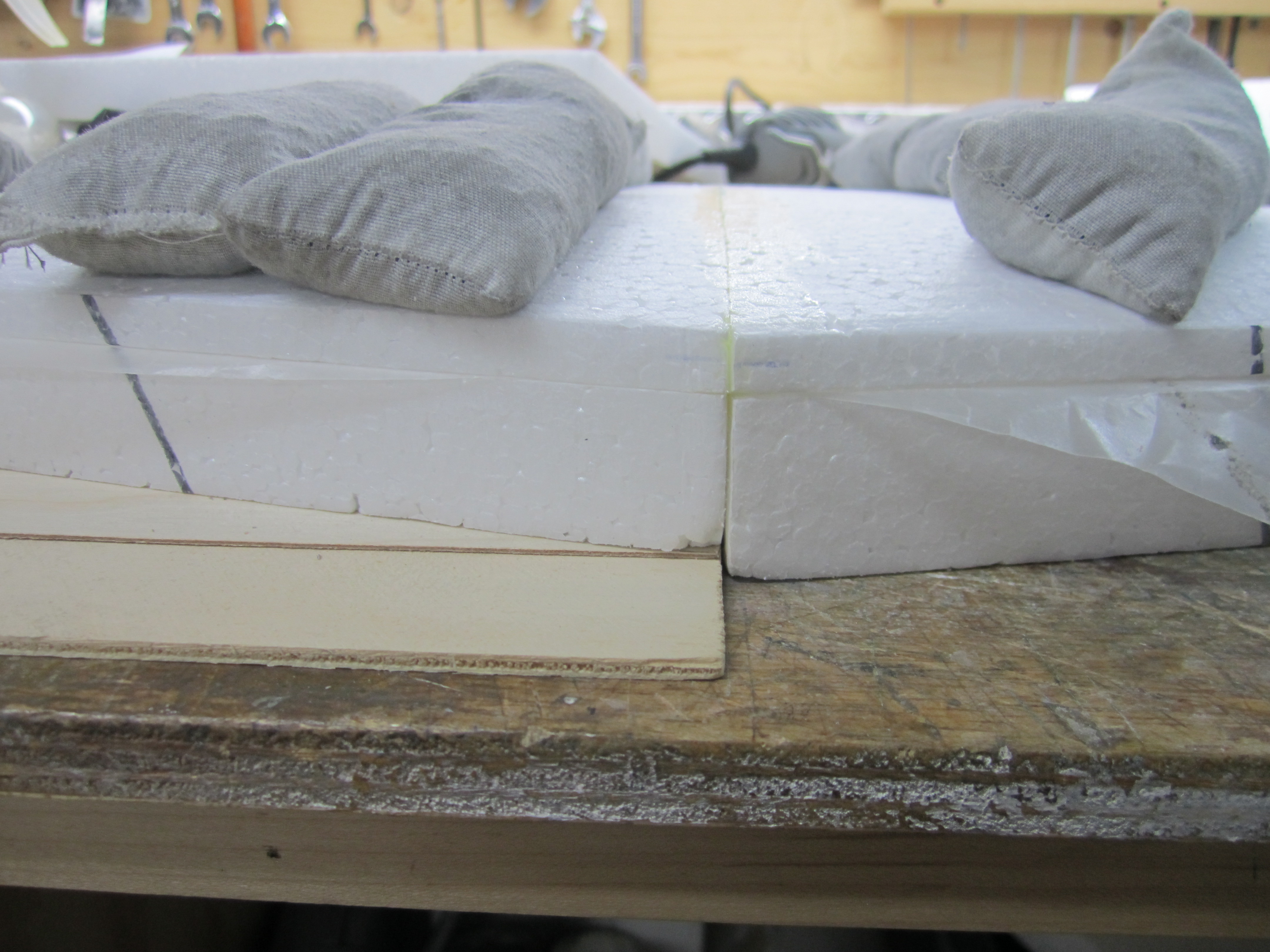

I did put some dowels into the ply on the side and into the foam. I think I went around an inch into the foam... do you think that I should go more?

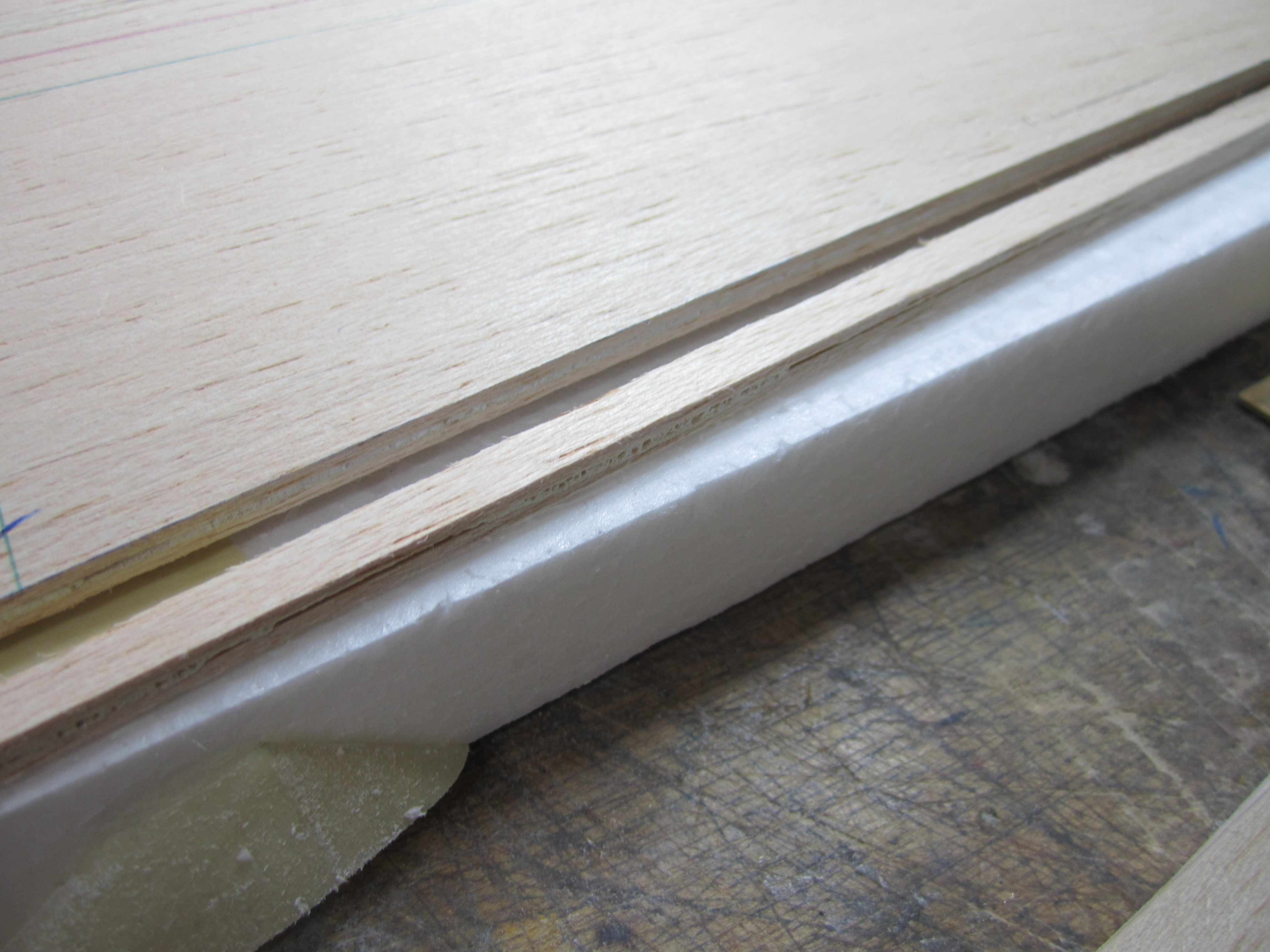

TB, I am using 1/16 x 4" balsa for the sheeting and gorilla glue on everything. I sanded very smooth on the bench and then I applied the gorilla glue on the rudder and the stab. I haven't sheeted the wings yet, but I am planning to do it this weekend, so please I will appreciate your opinion on how deeps do you think the dowels should go into the wing, because this is the perfect time to do it before I sheet the wings.

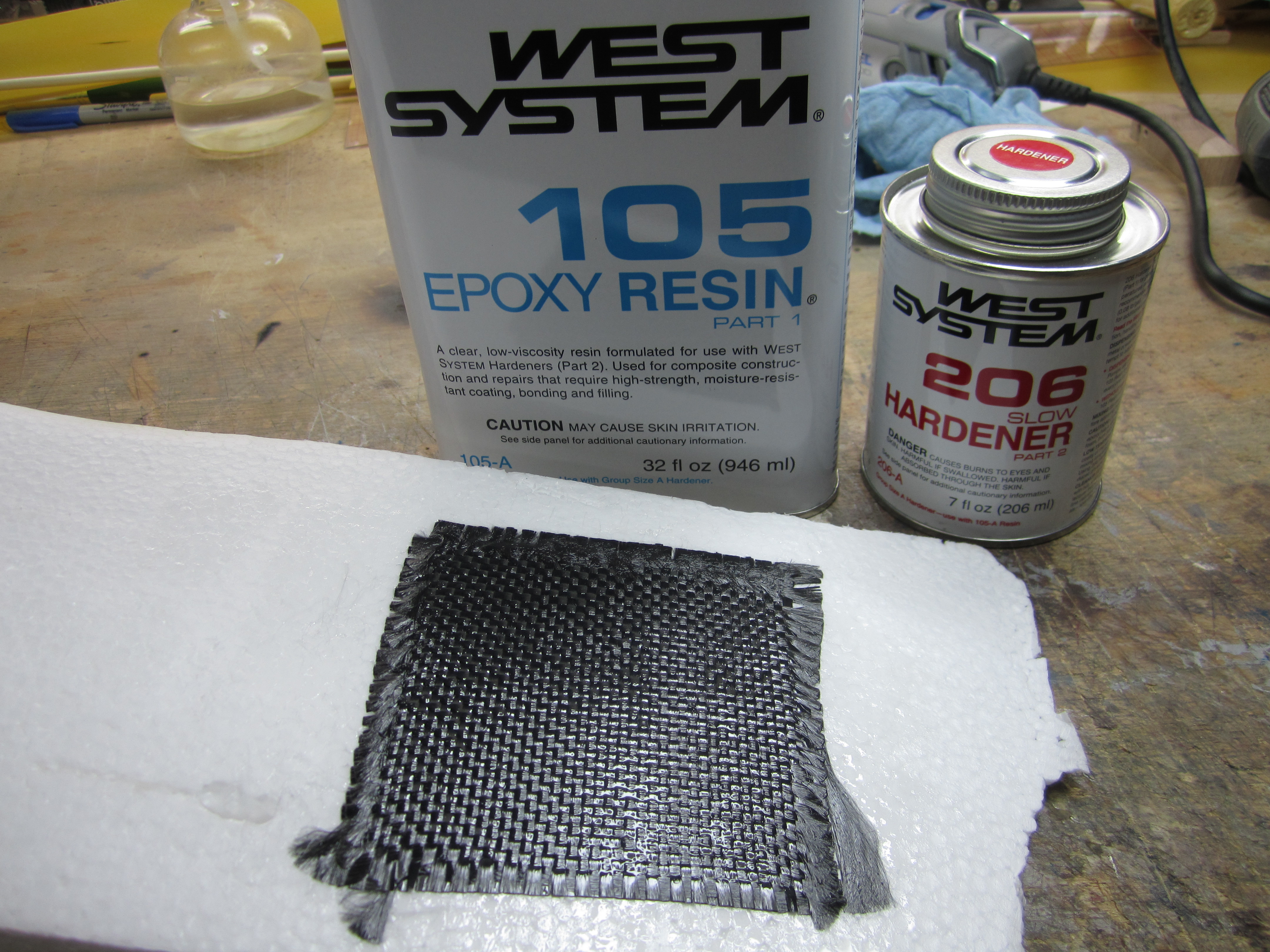

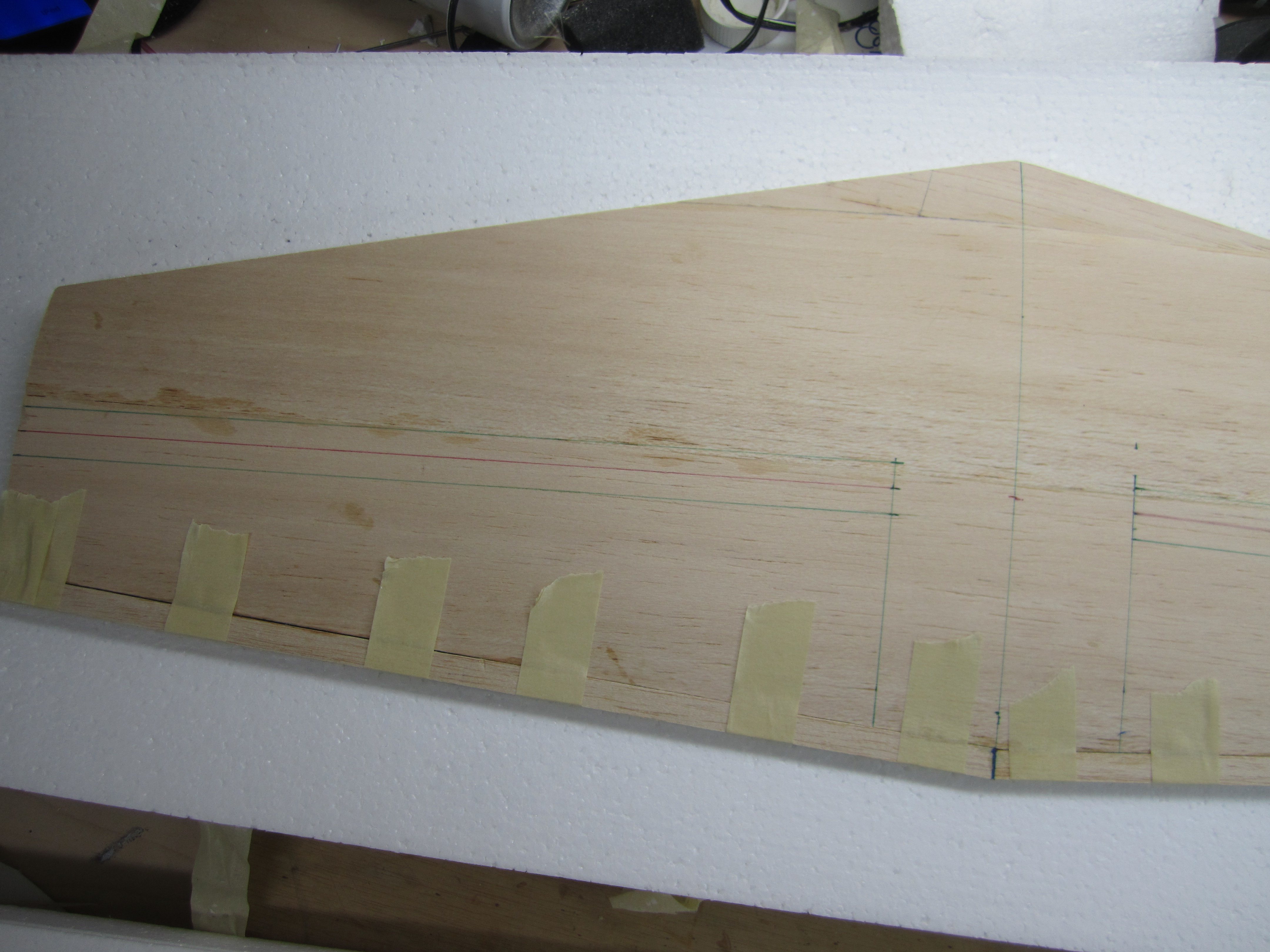

Progress on the wing.
I installed the tube, sanded the dihedral, cut the rib # 1, opened the wings tube, added an alignment dowel and the glued the ribs using the tube as a guide.
I did a mistake with the photos... I saved from my camera SD into the computer as the original file, and now those are too big. I had to create a copy of a few of them with a lower resolution to upload those to this site.... lesson learned...

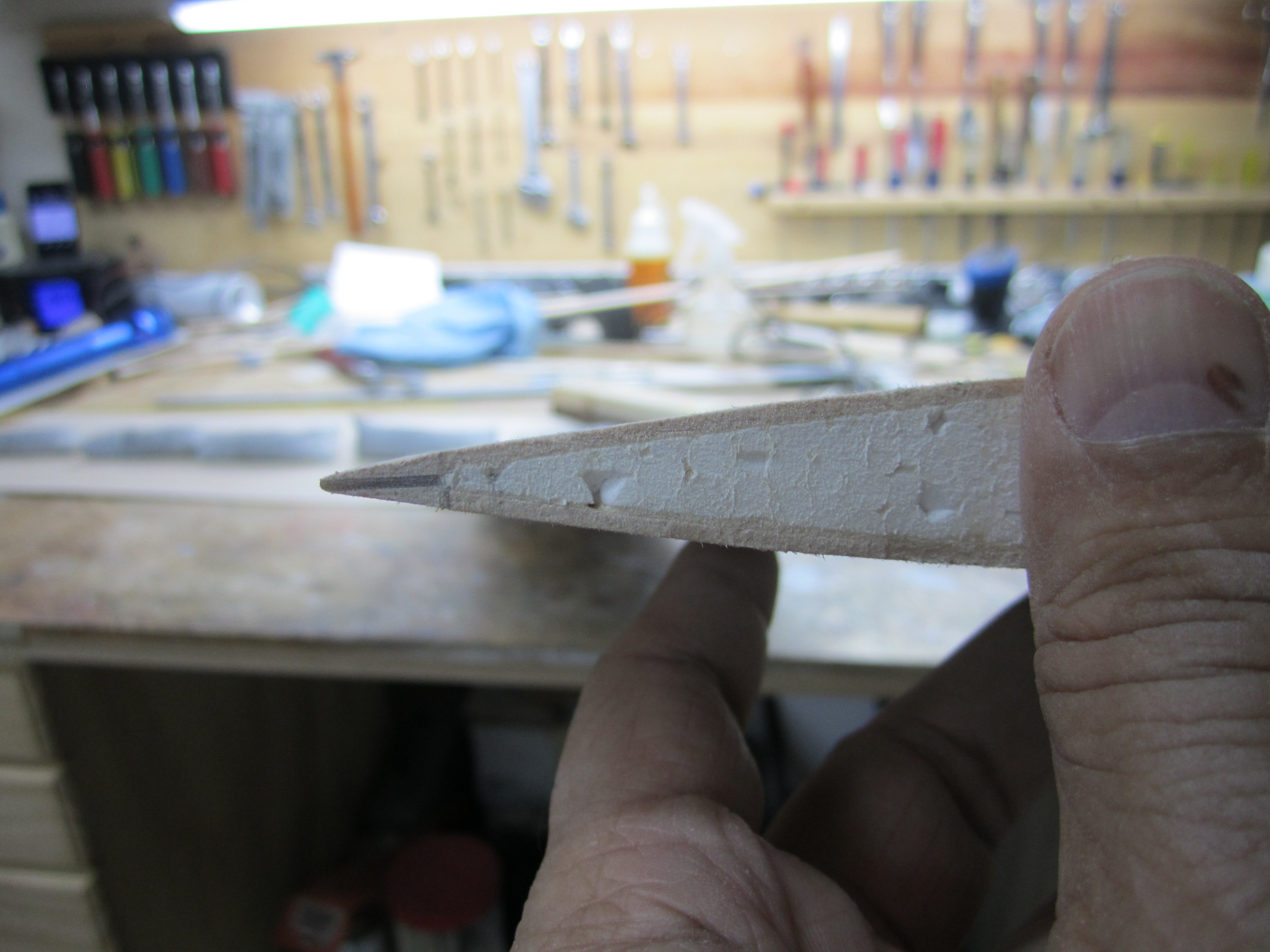

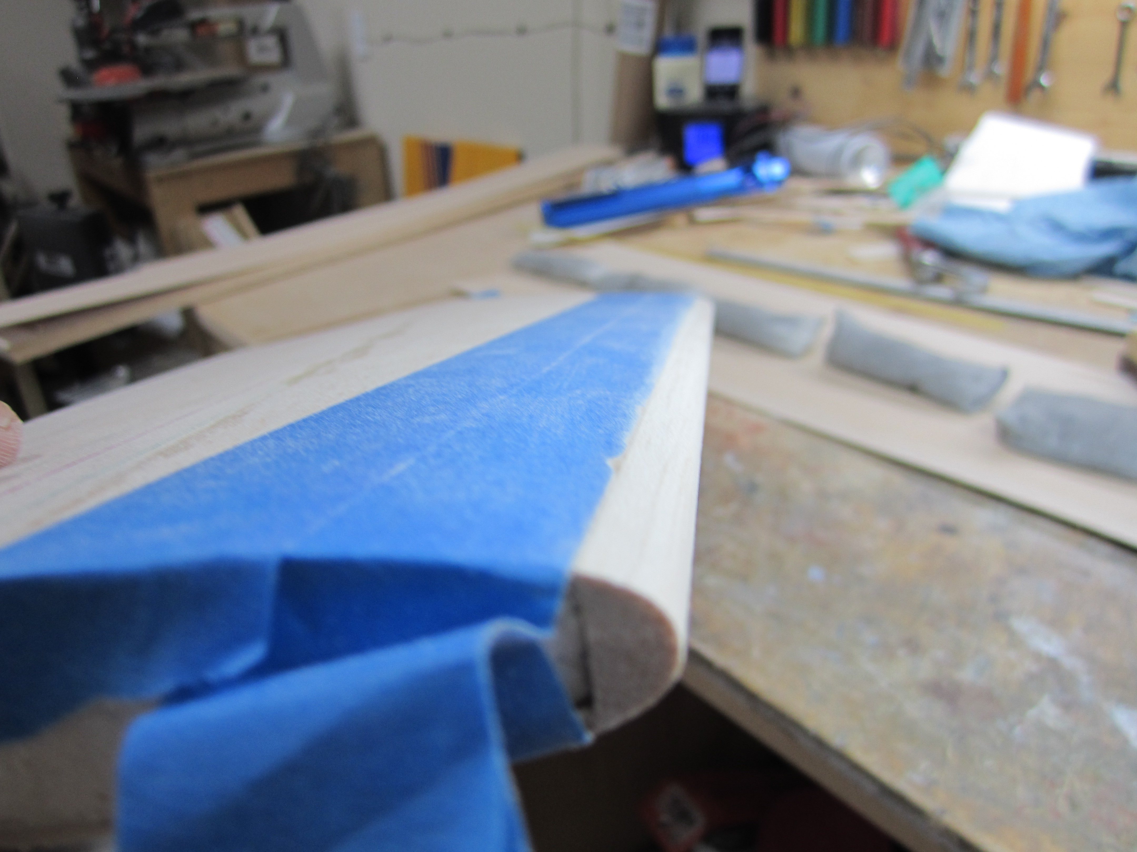

STAB

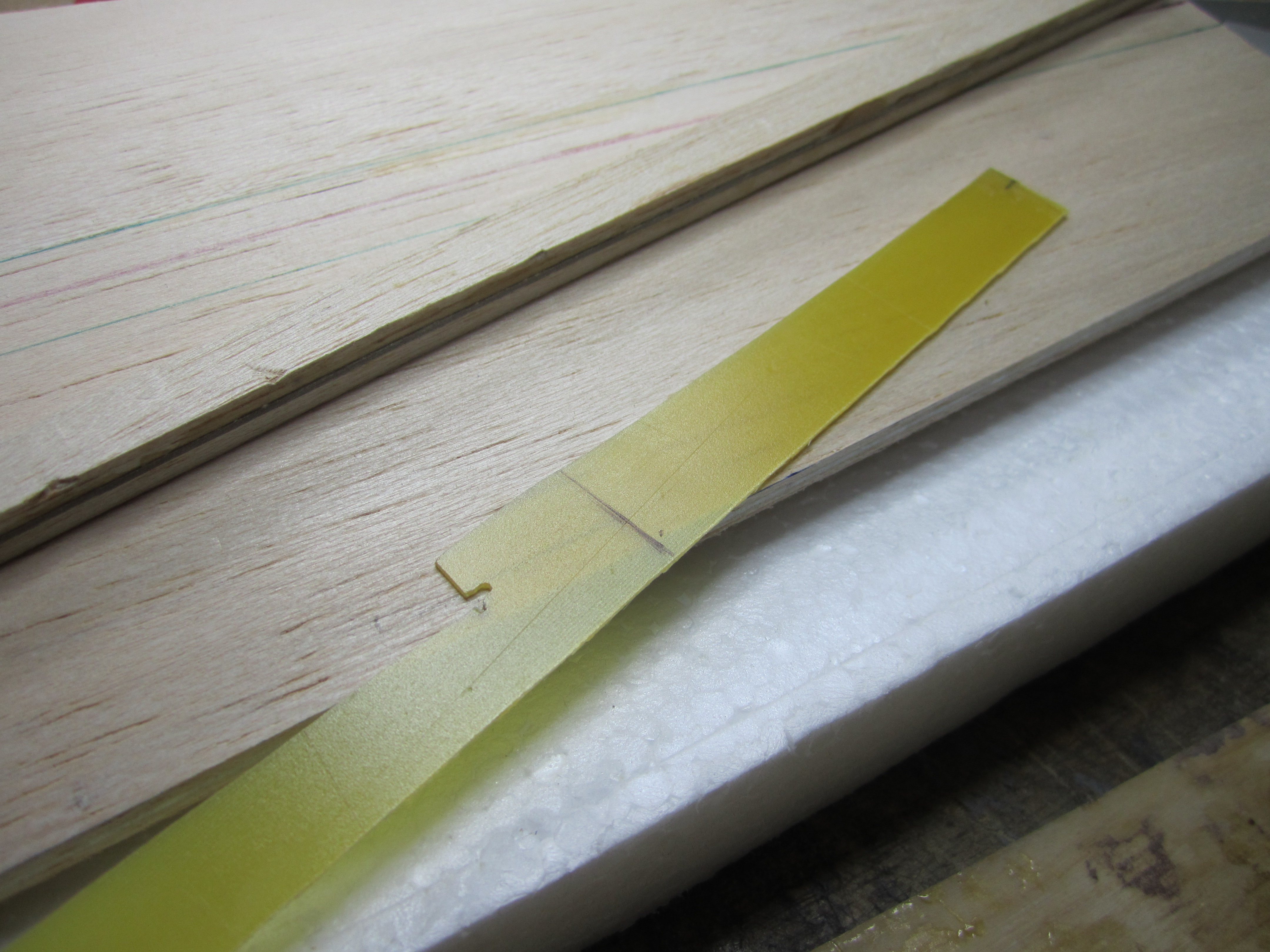

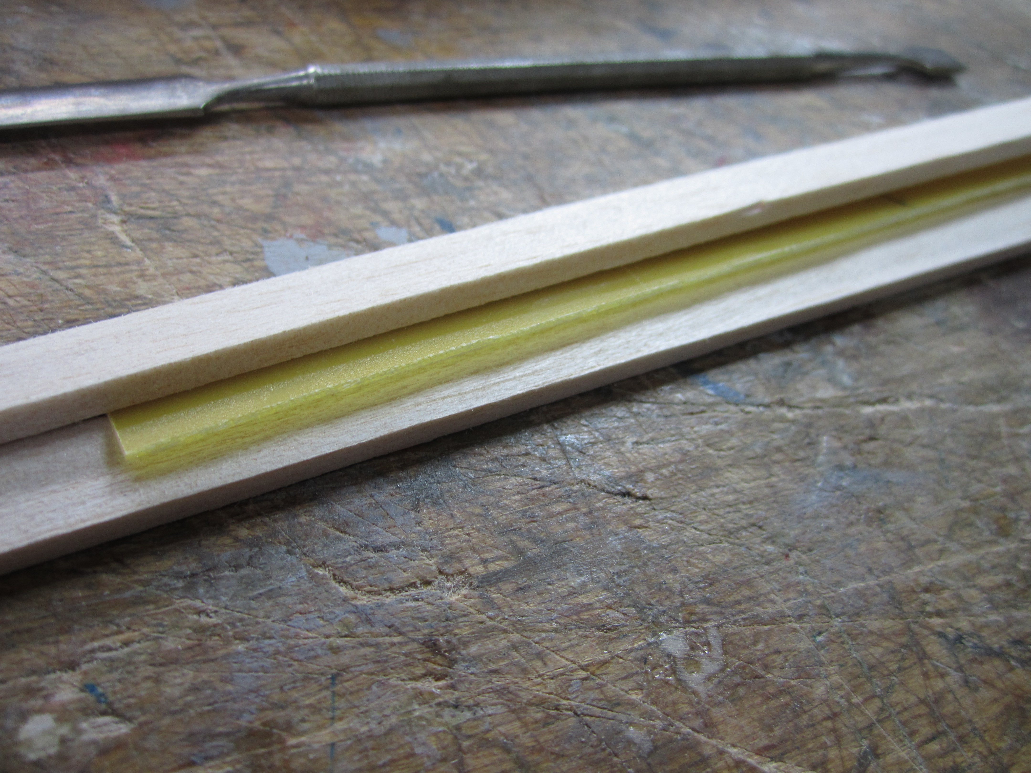

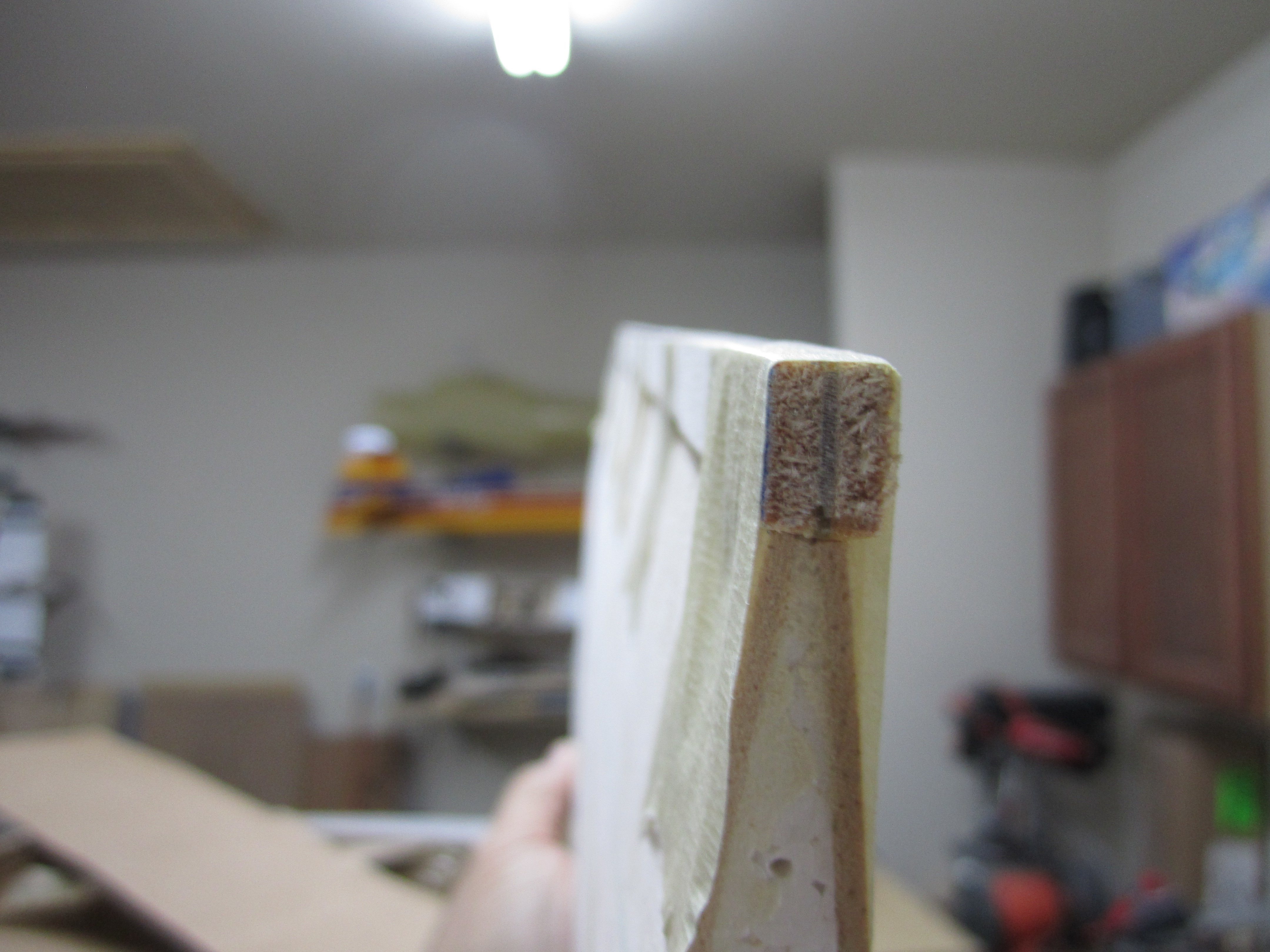

I sheeted the stab with 1/16" balsa and gorilla glue activated with water (applied water in spray).
I like a very thin trailing edge on my control surfaces (1/32"), but you cannot do that with balsa because you'll ruin it just on transportation. So I use G10. I make a "g10 sandwich" with 1/32" g10 an ⅛" of balsa. I cut an strip of ⅜" of g10 to make the
sandwich. I use carpenter glue for this.
Then I cut the trailing edge (around ⅜") -the elevators in this case- and glue the g10 sandwich. The next day I sand the sandwich until I get to the g10. With this you can get a very thin trailing edge and not a fatty one like ⅛" or ¼".
Now you can hit the trailing edge with pliers and you will not damage it.... Just a preference.
the deeper the better as the foam will absorb the stress if they are longer. I used carbon fiber dowels. But your install looks good and should be ok. When I crashed mine the wings broke right after the gear, you can only make it so strong till something has to give.
1/16 sheeting should be ok, I like to use 3/32 as I like to sand and don't want to burn threw and end up with 1/16" anyways. If you pre sand you should be good.
