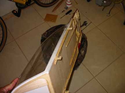

I buillt and am flying one of these now.
It came out tail heavy with the ZDZ80rv, I have had to add close to a pound of lead to the nose. My plane is about 23lbs with the lead.
it might help to invest in a digital scale so you can choose the lighter sheeting for the stab/rudder.
There are a couple reports of people who had wing failure, you should brace up the main ribs which hold the wing tube especially where there are those big lightening holes.
The shear web system is pretty good, don't try to force the spars to fit extremely closely
if they don't fit flush top/bottom with the shear webs, if you force them it will cause warping, better to fill the gap later with soda/thick CA. This is especially important on the leading and trailing edge shear webs.
The canopy mounting method is not optimal, it is better to build the entire top hatch removable similar to the Cardens/Aeroworks. Ron Eisner posted pictures a while back on how to do this. Also build the cowl with a cowl ring so that it mounts from bolts from inside the fuse instead of all those bolts going around the edge of the cowl. This is much better.

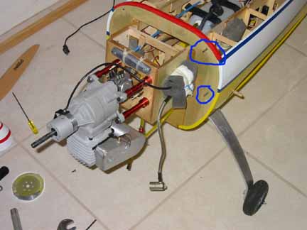

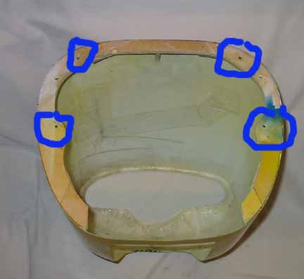

The 3w100 should be just right! What I did for the cowl mounting is cut a 1/8 ply solid ring that matched the supplied pieces(I think there are six) then used # 10 socket heads with blind nuts in the fire wall. As for the servos I used Hitec (4)5625 digitals in the wing, too much surface for one ea. The wing mounting idea sounds good but there is a advantage of using GP's mounting. You can make spacers for each wing that will let you change the span from 100.5 to 103.5 and have two mounting threads in the alum. tube depending on what type of flying your going to do. When there outward you gain about 45 sq inch in wing area with no adverse affect(I checked with GP before hand that said no problem). I'll post some pics tonight.
My Feedback: (12)
Posts: 619
From: Port of Spain, FL
Chuck, I have attached a few pics, blue circles on the cowl are where there is a blind nut behind which accepts the bolt from behind the first former, I have also circled the bolts for you to see. I use a 2-56 ball driver from inside. There are also a couple 1/8 dowels used to help align the cowl when holding it whilst bolting.
I made a little booboo in that I made a former over the top, this was not necessary and could have been done a different way but I did it from scratch as a first try. You can look at other people's Carden's build pics and see how the hatch could be done without that former running over the top, the hatch will run straight to the cowl.

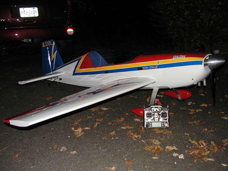

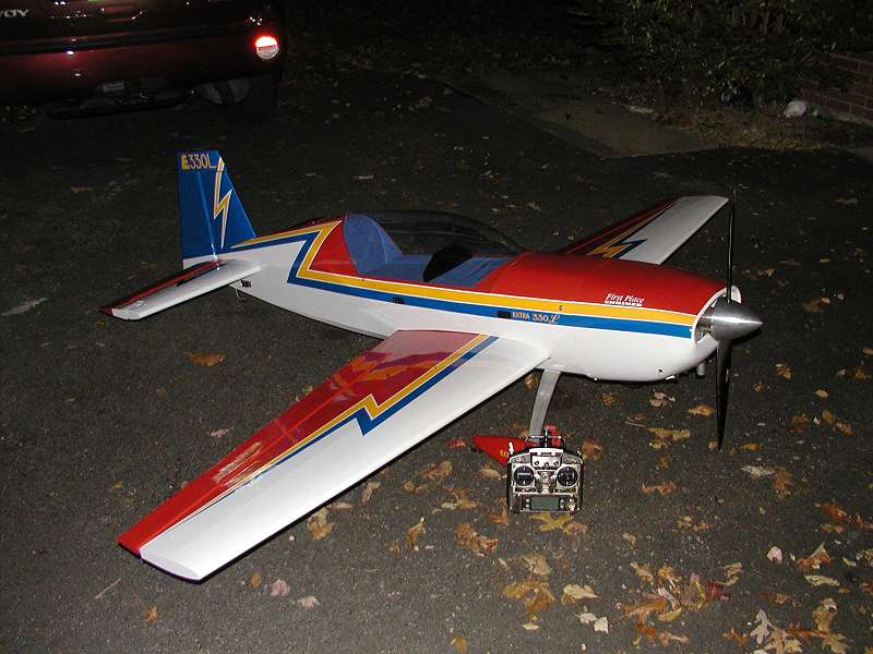

Yes, if you have not made the wings use the root ribs to make four copies. Here are some pics of my 330L it was dark out(went flying) I'll try and get better ones
My Feedback: (25)
Posts: 380
From: Greenville, PA
I did not notice who the reply was to. Your plane is together,no problem same idea but you will need to trace them. Then make blocks to space them(where the dowels are) so the trailing edge of the wing is 1/4" inside the fuselage. Then sheet the top and bottom for strength. You can put them in or take them out as you like. I use them for slow speed maneuvers and you can land the plane at slower speeds.

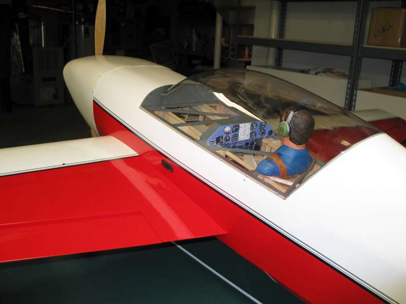

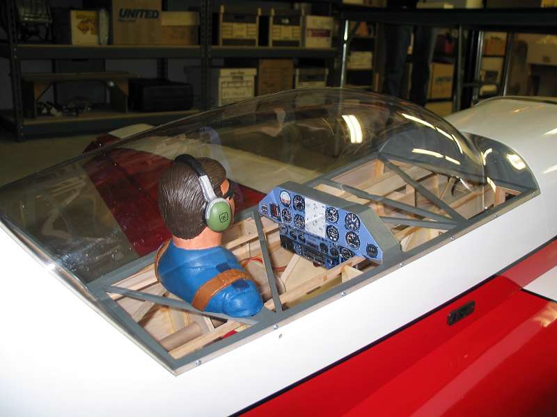

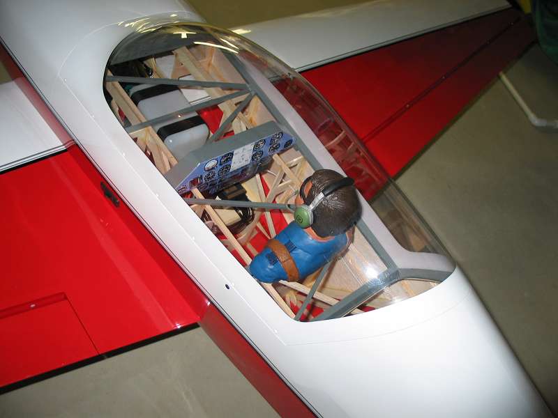

To give you another idea, here is how my engine is mounted. I didn't use the standoffs.
I built my canopy a little different to give better support for the plastic.
I'm in the process of adding a phenolic bearing to the wing socket on each side of the fuselage. The cardboard tube is a little sloppy for me.
