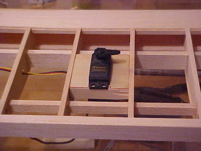

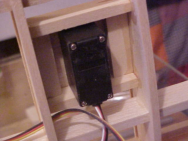

I'm building a Sig Citabria designed for bell crank aileron control. I am going with servos out on the wing, one for each aileron.
I've been standing here staring at it for quite a while and just can't figure it out...YET I see the need to have a box with a removable cover so all that shows is the control arm but I don't want to put a whole Forrest in the wing
so I thought I'd ask for a pictorial from the experts. show me your custom servo boxes please.
Miloh.

I got wound up and went for it with my own design, wish I had waited cause Minnflyer's design is much nicer to look at I'm sure but this will work fine.
Thanks to everyone for your replies.
Miloh.

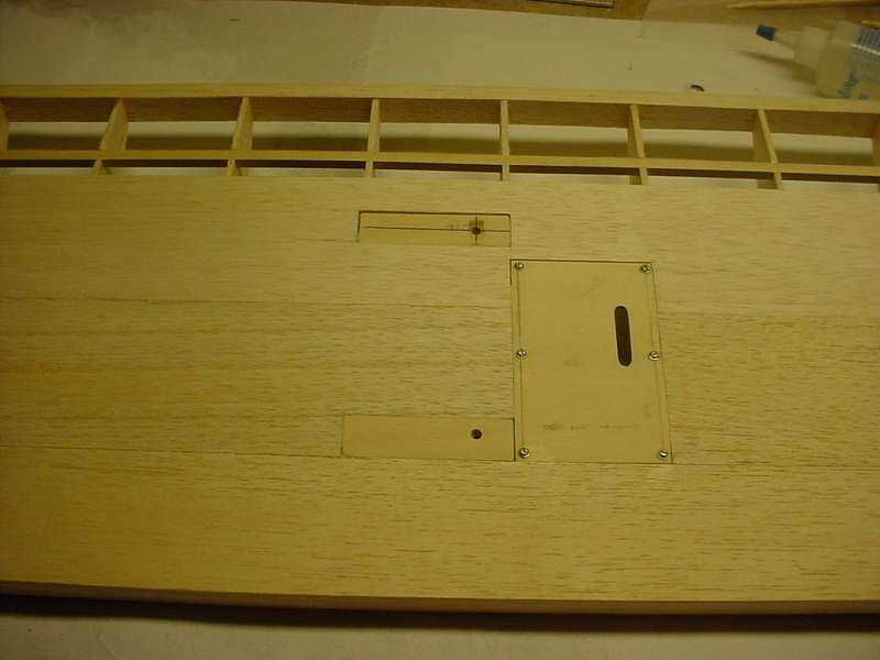

Not pretty and not what I wanted but it works!!!
Thanks to everyone that replied.
Miloh.

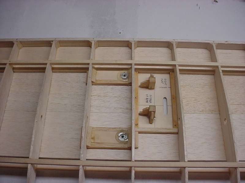

Miloh,
Was digging out pics of my Mr. Mulligan while you were posting yours, but thought Id put them on anyway for future reference. Servos lay flat on hatch cover and are screwed to posts. Hatch covers screw to spruce rails along side of ribs. BTW, in the last pic, the servo arm slot is crooked to be perpendicular to the hinge line of the aileron. Its not an illusion, lol.
