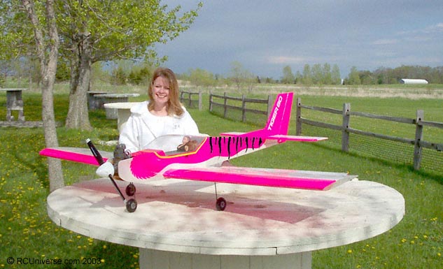

The only weakness of this kit is that not enough fliers own one. Any good BB .46 engine will be plenty for it.
I don't know about a cowl, but this is one plane where I really liked having "Cheeks". I did the same pattern on both the Tiger II that I built for my son (Orange/white) and the Tiger 60 that I built for my wife (Neon Pink/Pearl). I cut the dark color to look like tiger cheeks aroung the engine, and it looked pretty cool!
