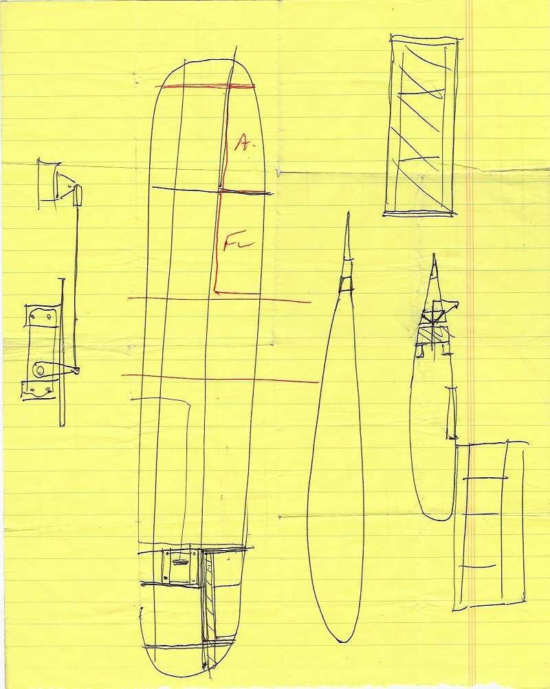

Also one other thig about the Kadet Senior, it is three channel. Throttle, Elevator, and Rudder. Well, I have tried to fly my Superstar with just the rubber and elevator like i would with the Senior. I just wanted to get some practice. But, I really would like to cut ailerons into the wings. Well, I have this picture that I will post that the guy that gave the guy that plans drew me. So, is this pretty much how it will work if I put a servo in each wing half. All help I thank you so much. Thanks Alot...........Well, I might get to show you that picture.....ok here we go...........ok.......there...........do you understand that............whould I just follow that........I'll just probable just get the guy who gave the plane to me to help me when I get to it.............

Yeah forgot one thing...........sorry about the lost image quality when you click on the picture for the full image...........Thanks for the info in advance............THanks

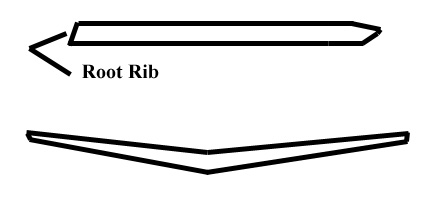

Quite simply, look at the sketch below. Two root (or center) ribs, each set at an angle when the wing is built. If the plan calls for a dihedral angle of 2 degrees, then each root rib is set at a 1 degree angle. The result is two degrees.
By the way, as a rudder & elevator only airplane, that Kadet will have a larger dihedral angle than your Superstar. Dihedral helps the aircraft turn when using rudder, so flying your Superstar with rudder and elevator will not be exactly like flying the Kadet.

Michael, If you put ailerons in the wings, you'll want less dihedral than called for in the plans. Local help may be your best bet. The modifications you desire aren't difficult, but to me, at least, are hard to explain in a clear, understandable manor.

I believe that I finally understand that drawing.........thanks.........I'm glad that I got a picture...........sorry i'm so slow to understand.........Thanks Alot though..........
