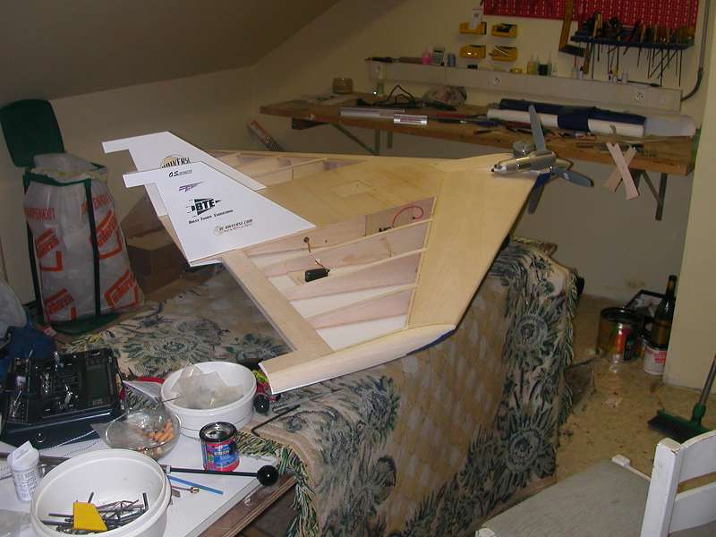

I made some stock work on my DV today and I also filled the triangular gap between the wing and the cowl using some scrap and filler
here are 2 more views of the cowl
I like what I see growing on the building board, any way you build a plane, bashing it or not the most important is to be happy and proud of your work

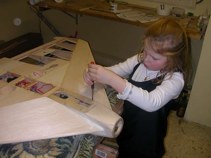

open all the panels to perform some final inside amenagements and fuel proofing job is a task for a master builder

fuel proofing job
That is a basic question but which varnish/paint do u use ? It's always interesting to find alternative solutions ...
Personaly, I use G4 Polyurethan 1-component varnish (a Soloplast product) : fuel resistance is amazing but it STIIIIIIIIIIIIIIIIIIIIINKS, and is a little bit expensive...

thined epoxy........, fuel proofing garantee
in the case of this plane, because the exhaust is on top, the wheel wells and nose gear aera will receive a very thin coat to save weight. the engine bay and tank bay a normal one

this is a pic I took when I was instaling the race expander and the external hhokup of the eagletree stuff, lot of wires and pneumatic lines in that bird
