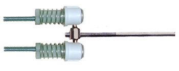

I found this in the Sullivan page http://sullivanproducts.com/ContSysAccMainFrame.htm
Double Ball Joints
Elevator Splitter. Two ball links with locking sleeves connected to a plated steel “dumbbell†allows motion from the servo arm to two parallel surfaces at the same time.
S558 2-56 Threaded "Dumbbell" and sockets
S559 4-40 Threaded "Dumbbell" and sockets
Any other option.

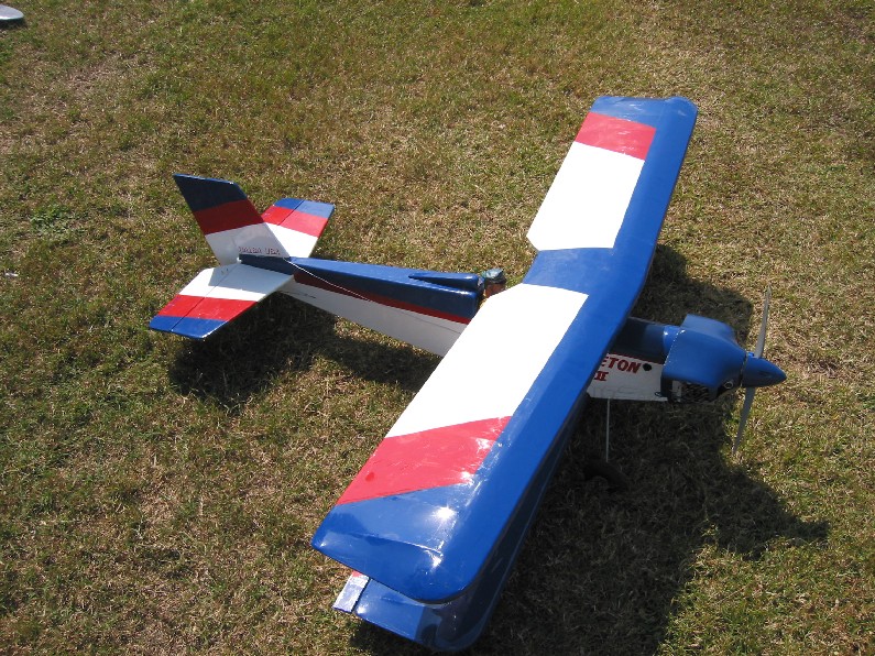

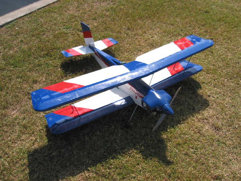

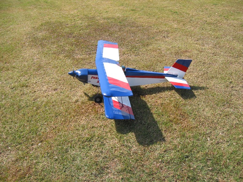

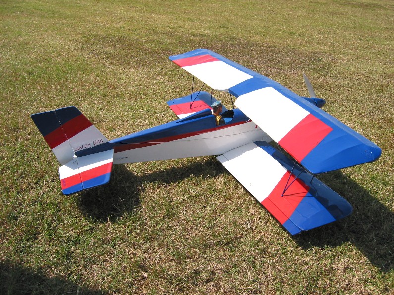

I ask a friend to take some pictures of the plane, I will be posting them very soon. I must say it was a nice experience building this kit and a great sensation to see it fly for the first time and of course land with out a hitch.

Finally some pics

Was looking at the pictures of your Phaeton 2. I've got a kit I've had for over 15 years and am ready to build it since getting in the air again. Was wondering where you found you pilot figure. I'm looking for something a little light-hearted and comical like the one you have. Have seen it online but unable to recall location. Thanks.

The pilot is fron Slimlines Products, I belive Tower sells them. Now for the plane being tail heavy actually mine was nose heavy with an OS FX 61 in the nose; these is a gentle fliying bipe will do only basic aerobatics, so maybe you want to save that 91 for something else.
