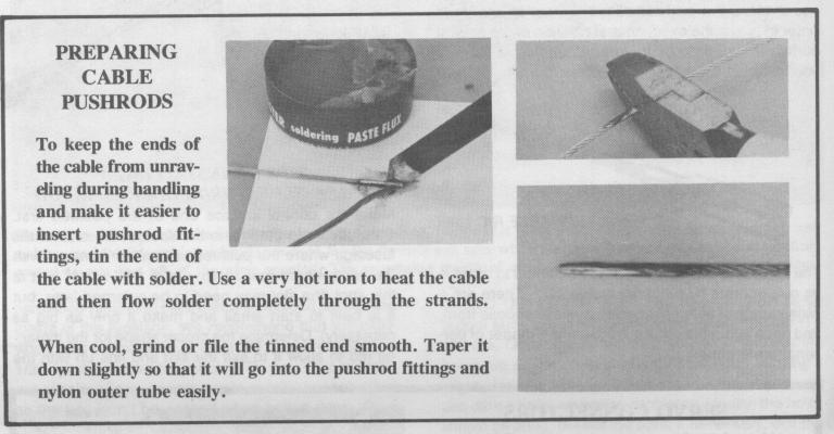

I suspect your cable ends are frayed. Solder the ends and file them up to a nice taper

Taken off SIG's booklet. Hope this helps

I cant solder for my life, the solder doesnt stick to anything it just falls all over, and if it does stick its very weak and i wount be able to file it without it falling off, thats y i didnt want to use the stock hardware in the kit as most of it you have to use solder.
I would rather not spend money on this and i dont have money (im 14), cant i just cut off the tip thats frayed?
John

If you have a dremmel and a cut off wheel, You can cut the frayed end off using the outer housing. you will loose s short piece of housing but usualy not a problem. or a peice of shrink tube will work also. The type of solder is important here also. Should have some "Stay Brite Solder" by Great Planes It comes with a tube of liqued flux. Note Flux is a assidic substance! and please read the instructions! and protetct you eyes, lunges, and furniture!

Trouble with frayed ends is the individual strands of loose wires "digs" into the internal wall of the tube as you push it through, hence increasing the resistance as you push it through. Of course you could use a larger tube, but if it is too large, it will increase side play. Holding an accurate idle rpm will be more difficult due to the inconsistent position of the linkage, as the cable "buckles" inside the tube.

Hey guys I got it thru no problem. I cleaned the tip with rubbing alchohol and sanded it a little and I actually soldered good for the first time. It looked exactly like the cable in the pic. It moves nice and free now but i had to trim off some of the tube because it was too long and only a half inch of cable or less could stick out on each side. Now i might even try to solder the metal clevises onto the push rods, i hate z-bends. LOL i also got electricuted by my soldering iron, i have no idea why it happened i just touched the wire and my hand fell asleep for like 2min.
