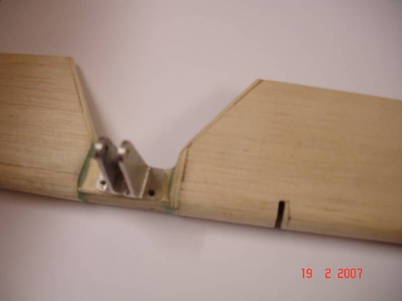

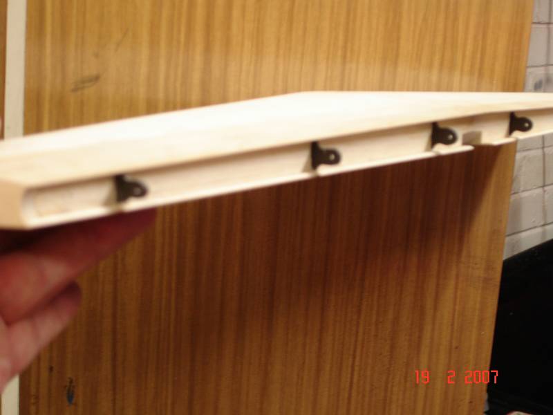

Anyway, I promised you some piccies of my elevator hinges etc so here they are...bit out of focus but you'll get the idea. Buried in the elevator LE between each hinge are lengths of Sullivan goldenrod inners which act as the hinge beaing in the elevator. The Hinge itself is a close fitting (inside the goldenrod) length of music wire which is silver soldered to a bored out cap screw as pictured....this screws into a "tee" nut which is buried in the tip rib of each elevator half...it'll be "locked" with silicone cement to stop it from coming out (ouch!). The hinges themselves are pieces of CFRP sheet (each one of three per side slightly bigger than its neighbour. I'll cobble up a sketch of the elevator cross-section so you can better see how I did it. Ailerons and Rudde will be accomplished similarly. More anon and hope you enjoy your full size experiences in one of my associated (Boeing) products...you didn't say which dash number of '37!

Superworm good to see ya. Well looks the old gang is gathered onece agian.
I fly the 300 and 500. Allthough I did my initial training on the 700 (NG). I just love the way she flies. The only way to describe it is with music and poetry wich does not fit on this sigth.
Myself is keeping my hinges simple. I have the leading edge of the controlsurface rounded wich in turn mates with a cuped trailing edge flying surface. For hinges I am using Robarts. This style of hinges is keeping it simple, fast built, low weight, and a more scalish look to it compared to reg rc pointed hingelines.
For the moment I am researching different covering alternatives to Ultracote. I guess I have been somewhat triggered by your ideas on this plane. A scalish aerobat is just very cool. After all this is not a 3D plane. I guess I am hoping to find a middle way of performance and some scale to it.
As meantioned erlier on this thread I am def putting on side stringers, anything else will not do for me when it comes to an extra. Now you did meantion something about cloth covering and this is exactly what I am researching about, or more specifically what weight penalty it imposes compared to reg film covering.
I guess my dream cenario would be following your ideas of part fiber glased and aft fuz doped cloth (Sig Koverall) but at the same weight as film covering. Some guys here on RCU is claiming that a glassed surface could actually be lighter weight than that of film. Further, some other are claiming that a doped and painted cloth covering is not too much more weight compared to Ultracote... Then again there are those that are saying that this is not true...
Basically I am torn on what covering to use. I am ready to sacrifise some ounces for a durable good looking finish, some ounces but not a whole pound.
I have said it before but i say it again. Your hingeline is a piece of art. I love it.

Yo Rate1...I agree...nothing wrong with the 'NG's (with which I was more closely associated with...but not as much as 777 and 757 (and later -300)...wonder whats coming next after 737s ...Boeing appears non-committal at the moment.
Nothing wrong with Robart Hinges either but I wanted to be able to remove my elevators, ailerons etc for later maintenance if necessary but Robart hinge "pockets" were too big for the elevators (would be ok for ailerons though).

I did aquire the Robart hing sockets for exactly that purpose. However I have yet to decide if to use them or not? Yes they are fat but offers a great feature to a finished plane.
My hingeline looks much like yours but with straight Robart hinges (and not even close to your perfection) I used TLAREB-system (that looks about right eye ball) to make them.

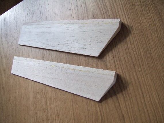

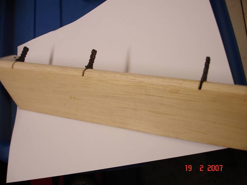

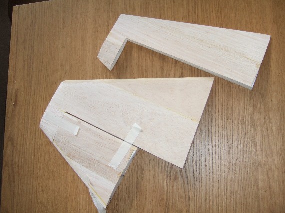

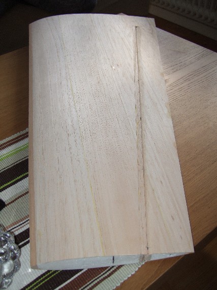

I am making slow progress... Anyways, the latest in my build is going for cuped hingelines. I have enlarged the ailerons by approx 20% by extending them towards the wingroot. Enlarged the rudder by approx 40%, enlarged the elev by approx 30%. The rudder and elev is made from build up wood (=same weight as the smaller sized stock balsa sheeted foam core).
Obviously this is not a 3D plane considering its older design, its wingloading (fairly small wingarea) and the smaller sized controlsurfaces. Nor am I trying to make it a 3D plane. My ambition is to have a well flying plane, basically a good aerobat (built straight and with a low weight). However, I want bigger controlsurfaces in order to be able to hover.

Tails look good btw

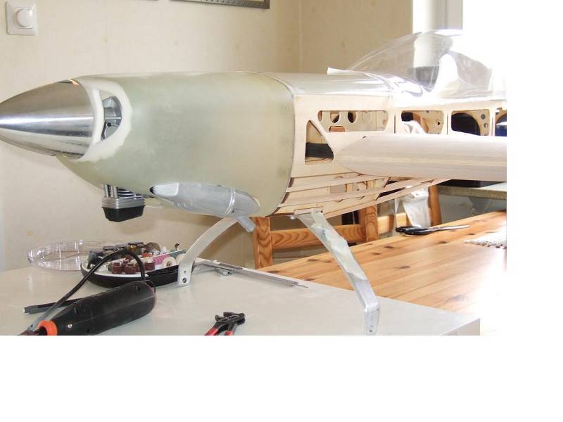

Looking at the plane I realize that there is not too much area left that needs to be covered with fabric.
This as the cowl and front hatch is made out of fiberglass. Further the airfoils are sheeted where I am contemplating to fiberglass. Will see on the fiberglass issue...if I manage to fiberglass a test item well I might go ahead...if not back to brainstorming.
Therefor coming to the conclusion that covering what is left to be cover on the plane, after fiberglass, will be less than a squere meter and not matter any from a weight perspective on a plane that hopefully will be around 11 lbs.

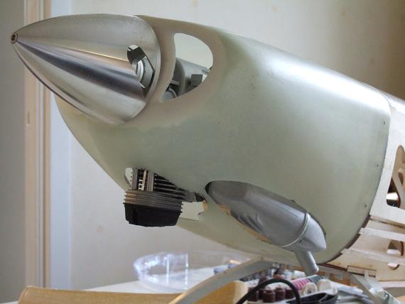

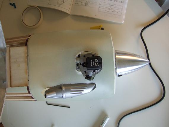

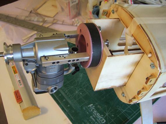

Thanks for the info and the links. As soon as I have completed filling out my order for a OS200 I'll dig into it...
Yup I ended up with the OS200Fs with a Hyde soft mount for this plane.
Allthough tempted to try out and see what all this YS hype is all about, I opt to go for ol trusty OS as I have great experience with em. Also I am somewhat limited to 15% fuel (unless I want to mix the brew myself....NOT). Also the idea of getting down to the field and just be able to start the engine right up without the DZ an...al tinckering that I know nothing about makes me belive this engine is the right choise for me.

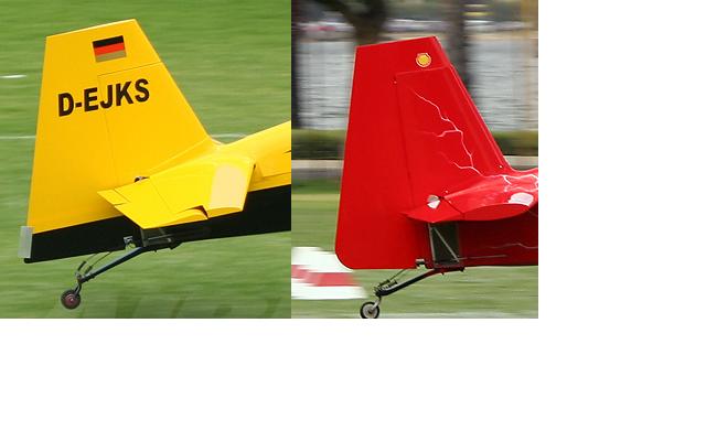

The Extra 300 is a funny plane. Meaning that it has been around long enough for several alterations and versions been implemented to it.
Looking at the following pictures you can see that the smaller rudder on the first picture is the one designed into this kit. While the larger rudder that I want on my plane is showing on next 4 pictures. The last pic show a blow-up of the rudder btw Klaus Schrodt Yellow Extra and Frank Versteegh Red Extra. Aso note on the blow-up pic that you can see a differences on the elevators.

Yup !!! I see what you mean !!. I hadn't noticed this before ...you can see the elevator aerodynamic balance on Klaus's Extra also

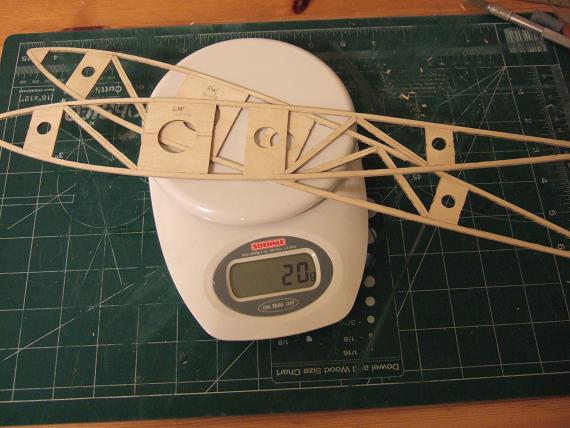

Myself had a look at the root wing ribs and though them to be a bit on the robust side, so I slughtered them a tad... (I hope I didn't take off too much
...d*m dremel).
Initial weight; 45 grams= 1,59 oz
Final weight; 20 grams= 0,71 oz
Saved weight 25 grams= 0,88 oz (or 55%)

Been fideling with the cowl trying to get it decent straight. Hyde mount is in place. Muffler of the OS200 is BIG and forced me to cut up the cowl, but I kind of like having the muffler sticking out this way... I guess I need to open up the cowl some more on the bottomside for cooling.
#195
Joined: Sep 2004
Posts: 80
From: Casper,
WY
Rate1,
Muffler looks pretty sharp. I like the way it kind of blends with the cowling and where the outlet is.
You'll definitely have to open it up some. I forget the ratio of intake area to outlet area. Somewhere between 1.5 and 2 outlet to 1 inlet I think. You might be able to get by with somewhat less where you are.
I've been covering a smaller project in Polycover, and it is what you would expect for something that is lighter. It is the thinnest of the coverings I've used, and seems to have the least adhesive. It works around corners well, and shrinks well (even at the lower heats). I'll be interested in how it holds up at the field. The other low temperature covering I've worked with seem to unshrink on a hot day. By the time I get it back in the air, I think we'll be all out of hot days for the year.

PizzaMan, is the Polycover transparent film covering or does it look like reg solid colour covering?
Yes you are right about the ratio of inlet vs outlet. I have even heard of a 1:2,5 ratio. No matter, I will open it up for a good cooling.

Hi Rate1 - Engine installation looks good - my - that is a big engine!!!!!
However, I don't see any triangular stock on the inside corners of the engine box - I also recommend drilling 3mm ish holes in the engine box sides into the firewall bulkhead so that you can glue in dowel pegs to strengthen the firewall connection to the sides....methinks that is a "stump-puller of an engine you have there !!
Cheers
Cheers
#200
Joined: Jul 2004
Posts: 558
From: Stockholm, SWEDEN
Superworm,
Yes, the instructions call for dowels to be drilled into the firewall, but the dowel is only some very thin made of somekind of hardwood. Also, the instruction is recomending 3 dowels at each side of the engine box. This pretty much translate exactly to your recomendation. I will also attach some triangular stock to the corners. Thanks for the advice mate. Considering this is only my second kit ever I do need all the help I can get.
I keep progressing with little bits and pieces on this plane whenever I get some spare time. However, I need to get my filthy hands on an incident meter so I can go ahead attaching the stab inorder to move on building the balsa turtledeck...
