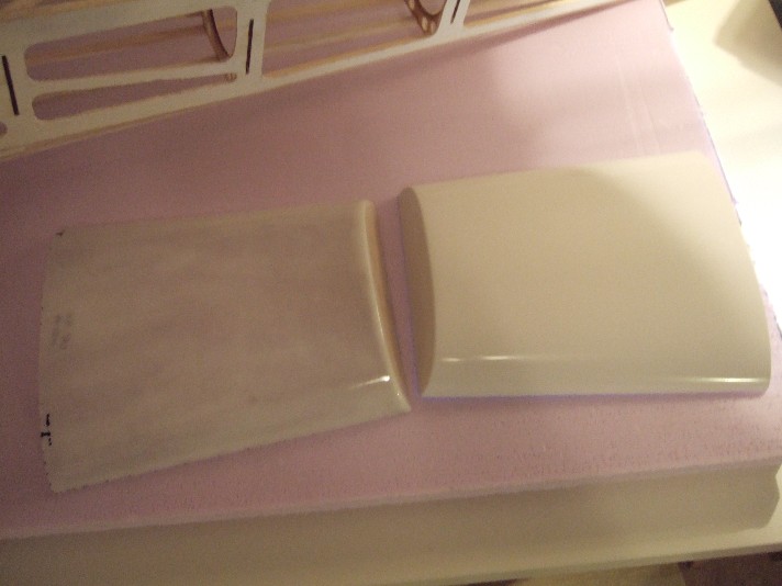

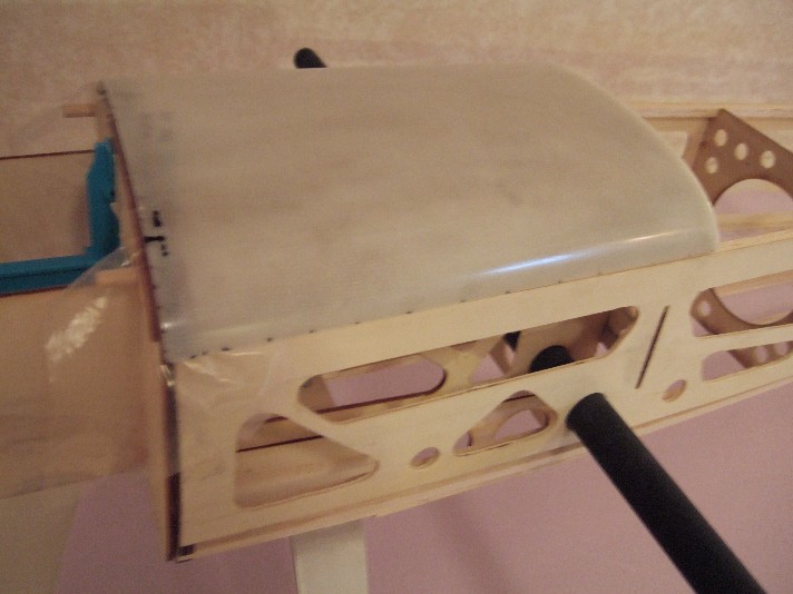

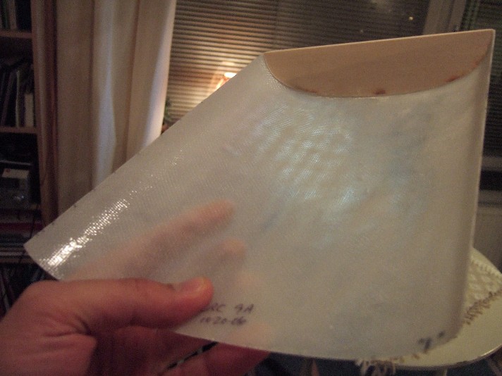

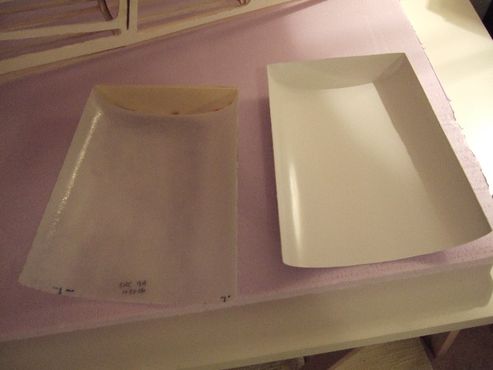

Hello Superworm,
I certainly can do. I recomend the fiberglass hatch eventhough it is slightly hevier than stock, it is more solid, has a great finish, and offer a better quality plane in the end. I suppose F/G specialties cowl is of great quality as well, allthough I opt to include the Lanier F/G cowl with my order of this kit.
For the moment I am thinking on how to attach the front hatch as there is several ways of doing it. Obviosly I would like it to be as neat as possible. Have in mind that the fiberglass cowl does not go over the F1 former, but stay flush to F1. With this in mind the instructions call for the front hatch to overlap F1 former thus the forward edge of the front hatch will be exposed and giving a less attractive finish. This is not desired.
Hatch to the left is made out of F/G, the right one is the stock ABS. Also I have allready attached the ply former at the rear of the F/G hatch.

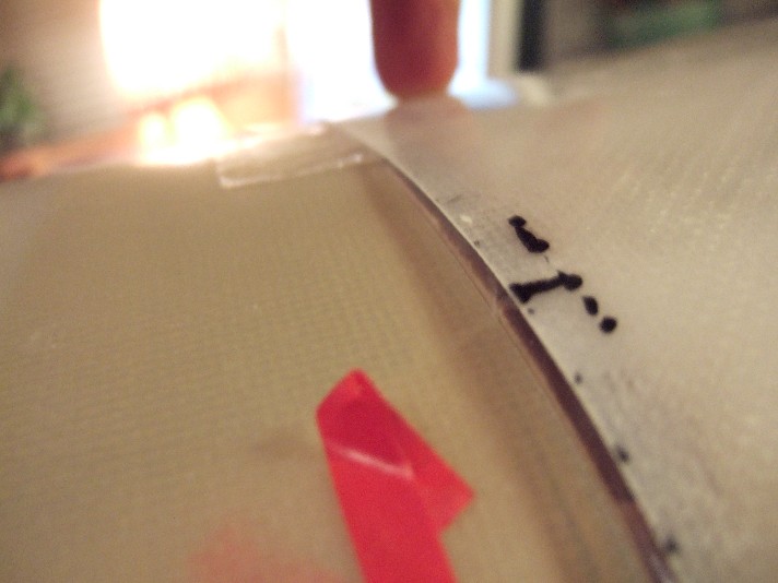

Hi Rate1..thanks for the piccies...very useful
with regards to

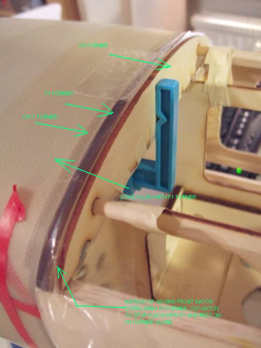

If the front hatch goes over F1 as per drg, doesn't it then meet up with and be flush with the back edge of the cowl which is positioned by the Cowl former (CW1/CW4)??. There is not supposed by any step anywhere around the periphery of the cowling !
with regards to
#163
Joined: Jul 2004
Posts: 558
From: Stockholm, SWEDEN
As I understand, and I could be wrong, the front hatch front edge does not meet the rear edge of the cowl. As the cowl is flush with the forward former, F1, and the front hatch overlaps F1, there will be a visable edge from the front hatch...
Ways to solve this could be to not let the front hatch overlap F1, or to sand F1 so the front hatch meets the rear edge of the cowl.

Hi Rate1
Plse check again.....but I'll have to dig out my formers>>>
The cowl former (CW1) should be exactly the same size as former FI. With the cowl overlapping CW1 and the hatch overlapping F1 as per drawing, then there should be no visible edge showing at the join..there will only be the join line showing with no protusions of either edge...it should be flush all the way around.....that is one of the things that I liked about this model....all the ARFs and most of the kits (including all my other Extras and my Goldberg Ultimate) have the cowls overlapping the structure underneath...not scalish at all!

I have dug out my formers and you are absolutely correct. Former F1 is too big around the top edge even tho' the drawing does not show it so. The Cowl Former CW1 has to line up with the engine box sides and the corresponding cut-outs in F1. This gives extra material over the top arc of F1 which will be even worse when the top hatch is positioned over F1 as per drawing.. Methinks the only way will be to sand off the excess at the top and upper corners of F1 so that the cowling and top edge of the hatch line up at the joint. I'm presuming your F1 former is now glued in place but if you use CW1 as a template positioned on the engine box to locate it then you should be able to draw round it (or the cowling if attached to CW1 and make the necessary adjustment to the cut line to allow for the thickness of the pencil/scribe line and/or the thickness of the cowling if attached.
I've drawn a big arrow complete with question mark on my F1 so I'll remember to trim as required. Good luck

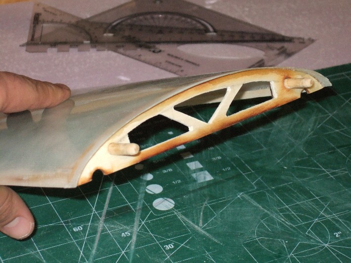

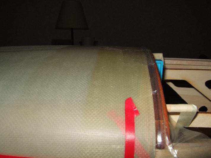

Superworm,
Sanding down F1 former to match the CW1 former is exactly what I have been contemplating about. I just want to make sure I am chosing the right route on this one as there is no turning back when starting to sand F1. Also, considering my limited building experience I am afraid to make visable mistakes. However I agree with you that this way is probably the best way of solving the problem and to get a nice end result. Another easier, but much less satisfactory, way could be to sand a transition on the hatch so it meets the cowl without a rising ridge. A third way would be to not let the hatch overlap F1 former, but instead rest on H1 former alone, wich would then be the very front end of the hatch. This last option is going to be flush with the rest of the front top part of the fuz but have less strenght compered to the way you suggested.
Uncertain if the instructions are correct written, meaning that there could be a chance that the designer actually ment that the hatch would end at H1 former and not overlap F1. This as the H1 is supposed to be glued together with the hatch, and the hight of H1 together with the hatch has the same hight as the F1 former, hence giving a flush front fuz. However, if I would follow the instructions there is no way I could glue H1 former together with the hatch and let the hatch overlap F1 former in the same time.
Looking at the attached piture, taken from above and rear looking forward. You can see that the H1 former, front rest/end of the hatch, is actually lower than the F1 former, and when putting the hatch ontop of H1 the fuz is then flush. I hope you understand what I am trying to explain.

Tricky one Rate1
I should go with plan "A"....the cowling and the hatch have to be in alighnment for the full extent of the hatch (width wise) with the hatch overlapping FI so that there is only a "witness" line of the join as stated on the plan "Note: Hatch overlaps F1 and ends here" which is at the front side of F1. It should be flush to the extent of the hatch. The hatch of course is permanently attached to H1. Just be carefull and keep checking as you sand down F1. Have you glued the cowling to CW1 yet ??
Plans "B" will weaken the hatch (and probably still show a "bump") and "C" will leave you with 2 witness lines and you'll never finish off a raw plywood edge the same as the surface of a fibre glass part.
I was also thinking of adding a sliver of wood the fwd few inches of fuselage sides if a ridge was left from the cowling since solartex or film isn't as thick as the f/g cowl if you see what I mean.....I'm looking for the cowling to be flush with the rest of the fuse all the way around the cowl except for air exits, at the bottom.
Cheers

Superworm,
For the reasons you meantioned, regarding front hatch attachment, I am leaning towards alternative A as well.
