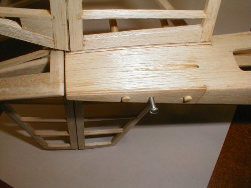

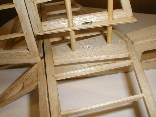

I recently began making all my tails removable. Parts required are a piece of 1/16 plywood cut to shape of the fuse stab area. Draw a centerline and drill 2 holes 3/16" for dowels, and 1 hole 1/8" for a 4-40 attachment bolt. A T-nut is glued into the smaller hole. Epoxy the fin to the ply plate, then drill thru the holes into the fin for dowels. (Before gluing anything, use the ply plate as a template to also drill holes down through the stab bearing area and the stab). The pictures below show the detail.. Use hand drills (pin vises) files, and a lot of patience, takes some precise work. Hope this helps.

Thanks Bo, those pics really help me out on the tail situation.

I recently broke a stab on my electric plane (one pictured), it was sure nice to be able to just unplug it to make the repairs. Good luck, if you have any questions let me know.

Great pictures - so once you have your holes drilled the stab and the rudder fin are not glued together and the stab is not glue to the fuse? So the rudder and the stab are all covered separately and are only held on with the bottom screw? Are you able to apply enough pressure with that one screw to hold the rudder and elevator in place? Sounds great. This sure would make it easier to change out the rudder if you need a larger one or as you said if it is damaged. I have a Challenger and the tail assembly is held on with two threaded rods that go through the tail and holds it on very well from the bottom side with nuts. I am getting ready to order one of the Senior Telemasters to build. And I would like to know if you or anyone else has drawings or pictures of how to make the telemaster wing into three pieces. I have a problem of transporting an 8 foot wing. Also has anyone built the wing in more than one piece without the use of wires on the outside? I want the wing to look like one piece once it is attached to the fuse. I have enjoyed reading this forum. Great assistance and ideas - keep it coming. CARPER
