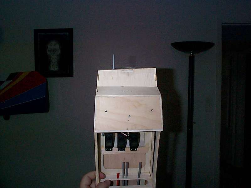

was wondering if anyone had pictures of their RV-4 that was in the process of being built. specifcally the nose end. this is my first kit (not sure if that was a good idea but hey) so i wanted to see what others looked like.

What exactly are you wanting to see of the nose of the RV? I have mine to the point of covering (been that way for about 5 months now), so I could get you some pics.

just how the fire wall went on and that area... i think mines screwed up... =\

If you are thinking that the firewall is twisted or not perpindicular, this is correct. This firewall is designed with a thrust angle. The torque from the the prop spinning causes the plane to spin the other way. The angle of the firewall has the same effect as the rudder being trimmed to recover from this. So, no worries. I put this plane together but haven't flown it yet. Just a note, the tail wheel assembly included with the kit might not be the best for the plane. From threads that I have read, most kit owners have replaced them. I have yet to fly mine so I don't know how effective it actually is.

Sorry about not getting these to you any sooner. Kinda forgot about them. Lemme know if you need anymore.

I noticed you have your servos mounted very far forward. You might be sorry. I used a .46FX and I ended up needing to mount the battery in the extreme rear of the plane (extreme as in under the stab) to get the plane to balance. Make sure you check your CG prior to covering!

Servos are where they should be, the CG is located 3.75 inches from the leading edge. But ur right about the battery/reciever part. Talk about nose heavy eh? (not sure if i should put the battery and reciever up there but we'll see when i balance it) Heres a pic of my nose section. it seemed like mine didn't piece together as well as i thought but i think it will be fine.

It took a good bit of futzing around with the parts to get the cleanliness of construction that I got. And the photos don't really show it, but a bit of that has to do with using filler to fill up some of the more obnoxious deficiencies. I like this plane a lot (well, so far at least) but I think GP could improve it a lot by upgrading the quality of the wood and maybe changing over to laser cutting the kits.
