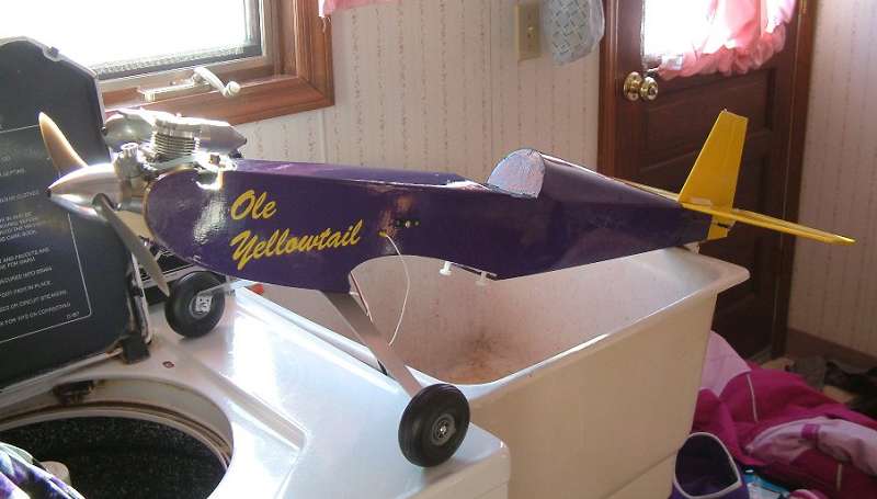

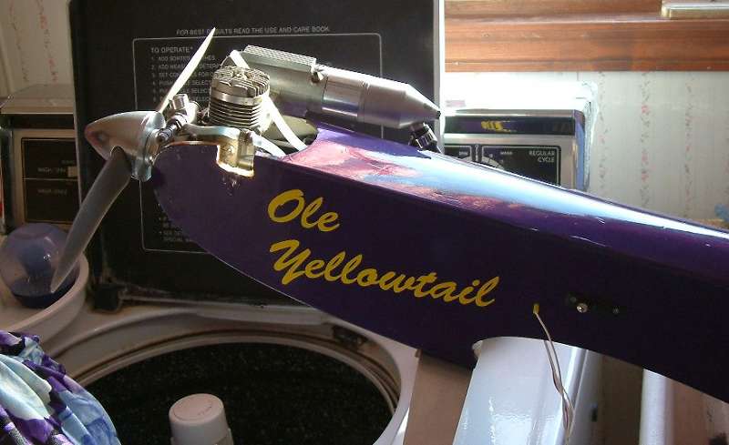

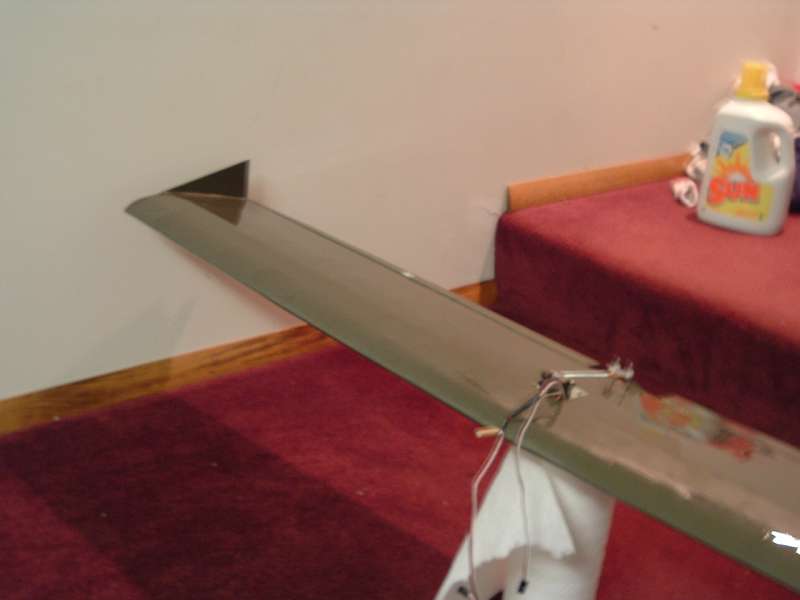

Added a name!
Also changed to all metal control rods!

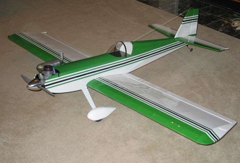

I finished a 4* 60 recently and made some of the mods suggested on RCU. From what I've read, the recommendations for the 40 apply to the 60. I shorted my wings, sheeted the turtle deck, and trimmed the canopy. I also added round tips to the wings and replaced the ailerons (a.k.a. ugly thick slabs of balsa) with some 2" aileron stock from SIG. Plus I added wheel pants for looks.

I think cutting them was worse than applying them. The Top-Flite striping tool is only fair at keeping the stripes even width.
The landing gear is the stock aluminum that I painted with LusterKote (primer and paint). The wheel pants are made for a 60 size Great Planes U-Can-Do 3D. They have molded on ridges that the gear is supposed to fit through. You either have to grind the landing gear to narrow it up, or grind off one of the ridges on the pants. I chose the easier and ground the pant. Underlying surface isn't great, but I figure who's going to notice. Just sprayed it with white and called it good enough. Probably most any 60 size pant would work. Just didn't know the ones I ordered had the ridge till I got them.

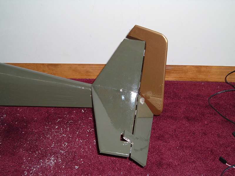

Old 08-08-2006 | 09:28 PM
  #172
Joined: Jun 2003
Posts: 583
From: Baldwinsville, NY
Default RE: 4 Star 40 building has commenced!
Lost the 4 Star on a flight Saturday. Airframe was a total write-off.
Too bad, she was a good plane.
