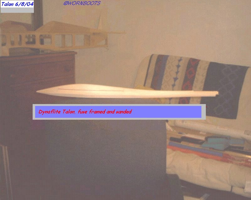

All went well with the basic build and layout of the fuse, though the manual is pretty good and folowing it was straight forward, the curves formed by the fuse sheeting are a bit tough to keep aligned but not a major prob. just chech & re-check before gluing.
I found that aligning the upper sides with the formers / blkhds were critical. As well as keeping the fuse middle flat on the table as required when installing the blkhds.
I stuck a t-pin through the fuse sides flush with the front of blkhd#3 out each side so I had a tiny hole for an exact ref to where the cut ot was going to be.

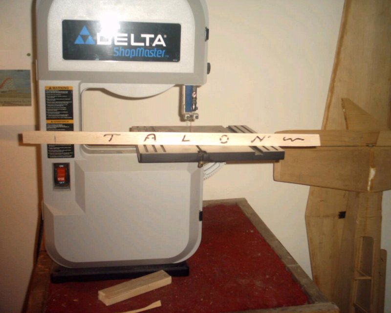

Fuse cutout completed, I followed the suggested marking method but I replaced the marker with my xacto knife to make the cut, the block held it secure and paralell.
Wing"

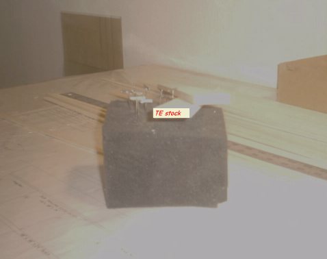

Peoblem on the get go, the 5/16" X 1 1/4" X 24" T E stock was actually not tapered, although it has guide markes on the ends where it should have been.
No biggie though, just a lot of sanding or a trip to the LHS.
NOTE" if you have the older plan and manual as I do, BE SURE to check the online manual from Dynaflite. There is a good deal more info in the online version, and better views of the tail set-up and TE steps.

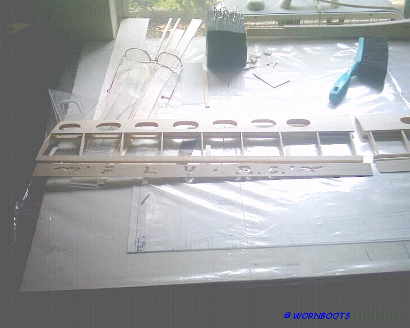

1st Wing half went smooth after I compared the two manuals, the pdf online and the older one I have. I decided to mod the ailerons from TE stock and capping the front edge with square, added a little strength and allows for the hinging of the TE and square stock. Then once sanded to shape the ailerons can be glued to the square stock in alignment, I chose this route to aid in hinge installation.
This has been a nice kit as usaul with Dynaflite and I actually have very luttle time in it, between 5-6 hrs.

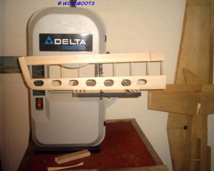

One of the ways I saved some weight on my old one was to use a hole saw and cut holes along the alieron stock that came in the kit. The wood that the alierons were made from looked like the hard, heavy, stringy balsa that the old Guillows kits had.
Does the newer kits do the alierons in a different way??
Dru.

They give you rectangular T E stock now, (see pick above and maybe the kit mfg support forum where I asked about it)
that yuo are to plane n sand to shape. I think they are after a little beef_up doing it that way, the newer manual shows a little thicker T E / aileron shape then the one I have.
Anyway I plan to air-out the ailerons as well as the tips (ones done), I want to keep it as light as possible because I want to glass inside the compartment for the saddle and a portion of the fuse.
Instead of holes on the ailerons I opted for a differant appraoch, the left side will have Fly RC (dynaflite wont fit)

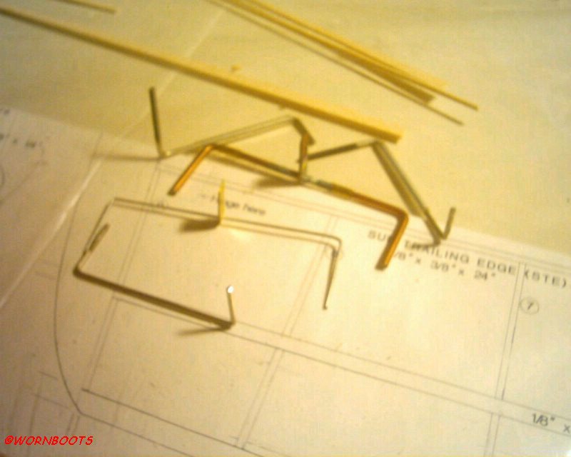

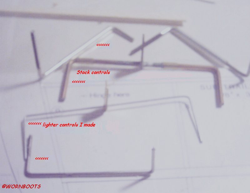

I found the stock aileron control wires to be way tpp large and heavy, I bent my own from smaller threaded rods. one LE was much heavier than the other too and a bit harder, I also changed it out.

It has been a while, but I just remember that it had a sub trailing edge where the ribs glued to that was something like 1/4X1/4 balsa then it was the shaped trailing edge that weighed almost as much as the wing panel. I like the cut outs in the wing sheeting.
The top of the fuse where you cut it from the rest to make the wing saddle and hatch, I had alittle warping after I covered it, I used some 1/64 ply to hold it in shape. The glass should do a good job too.
If I had a hill to fly from any where near me I would get another one and see if I could do a better job this time.

There is a Sub T E thats only 1/8 X 3/8 X 24 to form the rear of the panel, and to hold the ribs, hinges etc.
I could have shaped the one piece T E to taper, but by using the two piece method I used lighter wood and installing the hinges was a bit easier.

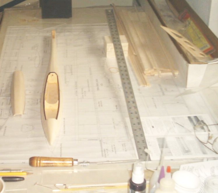

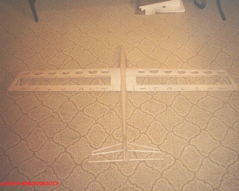

Allthough its not taken much time to build to this stage, getting the time to work on has been a problem.
The wings, ailerons and fuse/hatch assemblies are ready for final sanding and skins. The fit for the hatch to wing should be done in slow steps, getting a good fit is not hard but requires a good deal of attention. The Sub Trailing Edge (STE) is only 1/8 inch thick, attatching the hinges to it after covering the two-peice aleron(s) will require sme additional support. IMO

Can you fit blocks where you plan to put the hinges??? I have even used the expanding foam to fill an area so as to give the hinges a little more support. How about some baking soda and Ca??
Dru.

I was thinking of bending the inward portion of the hinges up against the STE and aplying drops of CA, but I may use your mention of blocks and cut from 1/4" sq. soft and slot. It seems like the weight to the rear is already adding up, will check it though.

Another negative is the size of the tail control wire and horn for the horz-stab, huge for such a light soarer. the aileron controls were also too large, so I opted to make new ones. There plenty strong and much smaller than the stock ones, wonder if all the kits come with those larger controls?

From what I remember they look as if they would work on a .40 sized glow plane. Just watch how much throw you give he stabilator, it can be mighty twichy.

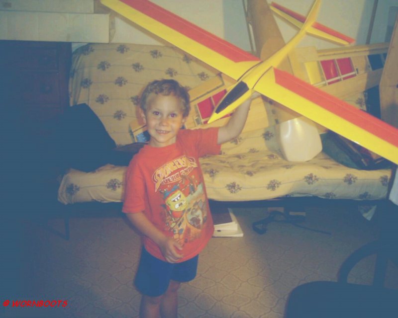

The covering went pretty smooth for a small plane, and now Danny Joe can see his actual plane instead of just sticks. I think I prefer the Gentle lady, Wanderer or Sail Aire's as far as building, but this one was for him.
Actualy it was a fairly simple build, and with the online manual most instructions were straight forward. The fuse had enough strength I chose not to re-inforce it with glass, but I did add some glass tape to the inside around wing bolt block and each side under the wing saddle.
Wings seem well designed and seem strong enough for the size and weight, but I did use the smaller control wires for ailerons.

Looks good. When do we get a flight report???? What servos are you using?? What is the all up weight of the Talon???
Dru.

Dru' I am planning on using my older Hitec system with HS 101 servos (installing tonight) Flite reports will be awhile, as I live in Taxas now and will have to also be creative.
