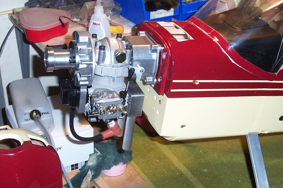

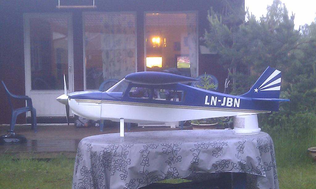

2. I'm using a G-38 in mine which means that I have to remove practically all of the bottom cowl. Is the Fibreglass specialties a better option? I mean, do I have to do the
same amount of removal of material? I think I read somewhere that this cowl is a better fit for this engine.
Your response is very appreciated.

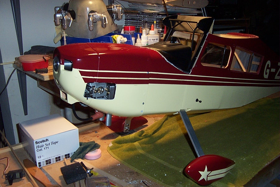

I'm in the process of replacing my Saito 180 with a G-38. As you did, I cut out most of the bottom to clear the spark plug, wire and cylinder head. Some was already missing from the Saito install so I could possibly fill back in a part behind the lower scoop. On the side I had to cut out about a 1 inch by 1 1/2 inch hole to clear the carb.
I don't think any cowl could enclose it all. The Fiberglass Specialties version looks like it might be a bit wider (?) so it may enclose the carb.
Overall I'm not worried about the open bottom and the carb is accessible too. (My G-38 is the B&B Specialties/Bennett version so yours could possibly have a different carb mount). I was actually amazed that the flywheel and magneto parts fit inside as well as they do.
Dave

I have a G38 in mine, and i did not remove any material of the bottom of cowlat all.
(see pictures of original cowl)
Maiden flight:
http://www.youtube.com/watch?v=QvqYuCDdWhg
RGS
Jan

As I mentioned earlier, I've been retrofitting my SD with a G-38. See pics. Hole in top of cowl deck is to access mounting bolts. Fortunately it's covered by the cowling. Now I need to install the tank and plumbing. Been thinking about going with a two battery/two receiver set up. Would appreciate any comments on doing so. My purpose in doing so is to increase reliability through redundancy.
dave
