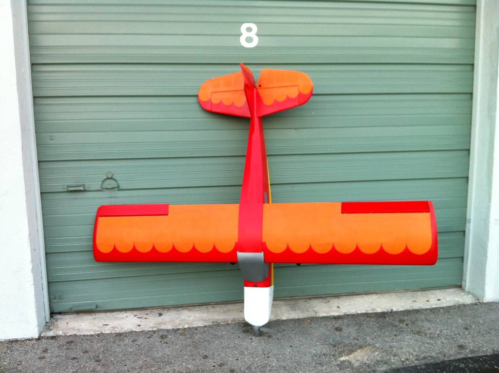

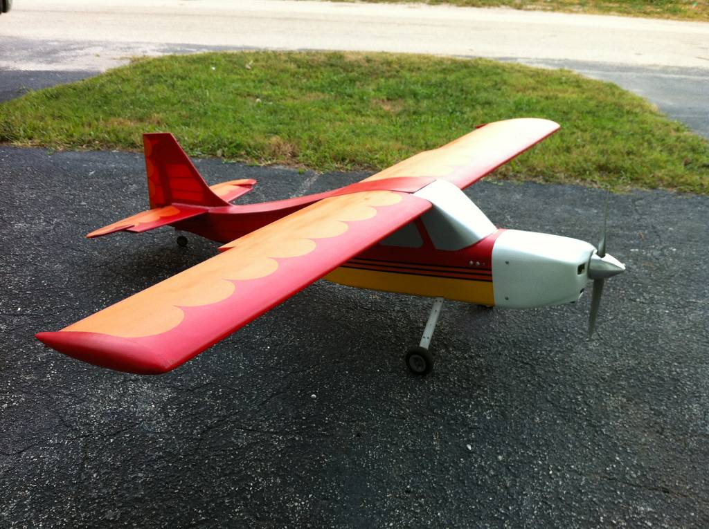

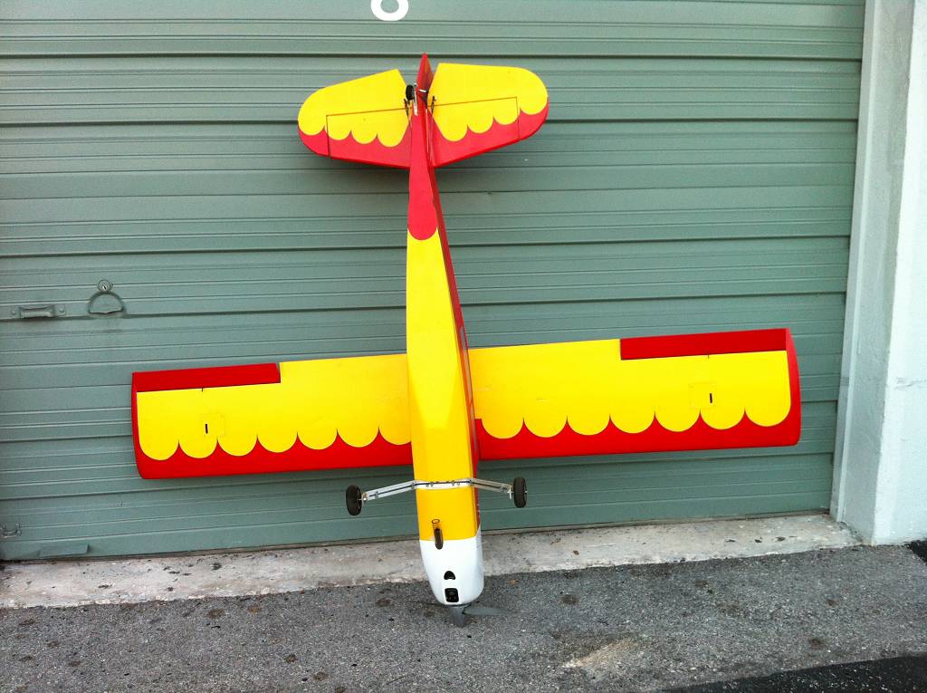

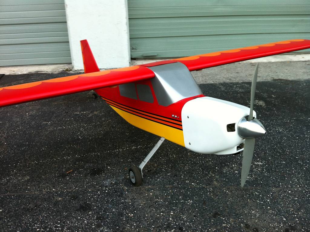

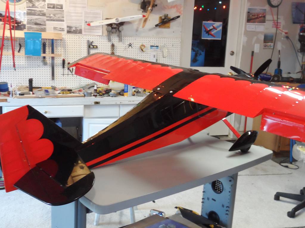

Here's my rebuilt Decathlon back after it was shot down (fm radio) by a fellow flyer.... Yes it was on FM because everbody has gone to 2.4 (well almost...smile). The bird has numerous alterations which made it one of my favorite planes, hence the rebuild. If you look closely at the angled profile photo you will see where there is a diagonal line running just behind the rear window; almost everything from there forward is new. The rest of the plane was perfect..... Until it crashed again fifteen minutes after the first crash. You see as I was riding back with the crashed plane on a golf cart if fell off the back and that gave it some minor road rash on the wing tip and tail. I was amazed how well it with stood the initial crash, being buried in the gound and all.... build em strong I always sy.
Anyways, It initially had a Saito 150 aboard, but now it has YS DZ140 as it was in the barn doing nothing. I loved that saito though, will rebuild one day, just need a cylinder head. Looking closely at the images many of you will see other changes, like the wing mounting method. It screws on from the top, leaving access from the top if you remove the small cap just behind the front window. Its not scrwed on in the photo so you will see a minor gap. The front window is just taped on for the photo, but you get the idea. I also shorted up the wings by four ribs total (say 9 inches shorter) and it now has a Fiberglass Specialty cowl. Great cowl but tight fit, I made the mistake and recovered it first before the cowl arrives so I had to sand a bit down and will recover... barely visible amount. Not being a fantastic flyer I did not mount the tuned pipe (mabe later) on the underside of the fuse; thats why you see the header only sticking neatly from the underside. Does anybody know if this will compromise the performance of the YS? I don't mind a power loss of say 10% as it's build super strong yet light weight. Finally the covering is Solartex, which I love working with. I will paint the cowl later.... Maybe, as I want to fly it sooner..
OK Guy's great to be a part of the Decathlon fleet again and keep em flying ... even after the crash.<br type="_moz" />

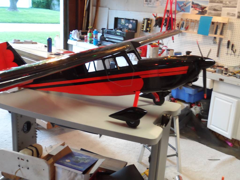

Well guys,
I finally got around to balancing my Decath last weekend. I plan to take a week's vacation maiden the Decath. Have had one issue after another the first half of the year and have not been able to do much in the way of building or flying [:@]. I normally begin flying in March or April but this year my first flight other than a little foamie out on the farm will be next week. Anyway... I removed the cowl and had to epoxy 8 oz of lead in the very front of the cowl to get anything close to a balance. Looks like it's balancing at 3 and 7/8 inchs, which is the maximum rear balance in the instructions. I don't like to maiden with a rearward CG but I'm going to on this one. Hopefully it will behave and not be a 1st flight of stark raving terror
. Since the plane was so tail heavy and I had to add so much weight, the plane's all up weight is 18 lbs and 9.6 oz.
I took a picture of the weight in the cowl and attached below. If I hadn't mounted in the very front, there's no telling how much lead I would have needed. I noticed nh4cio4 also added 8 oz on an earlier post but I'm not sure what his all up weight was. I'm thinking, installing the tail wires hurt me in the weight department. Maybe I should go back and remove them. I would think with the engine I'm useing, tail heavy would have gone away but not in this case.
After I report on my maiden, I will be finished on this thread but if anyone adds to it I'll check it from time to time. I plan to start monitoring mattnew's new thread as he started one on bash and build of the Super Decath.

I didn't add any weight, The G 38 was more than enough, I am around 17 pounds, I don't think your weight will be a problem, Mine just keeps floating when landing, so a little more might be better for you.
Good luck with the maiden
ED
ED

Your plane looks great. My plane is still slightly tail heavy. I'm planning on flying Tuesday. If I don't like how it handles I may may delete one of the elevator servos. I'll have to check and see how much torque is needed for the elevator vs how much is available on my servo.
Thanks for the idea.
