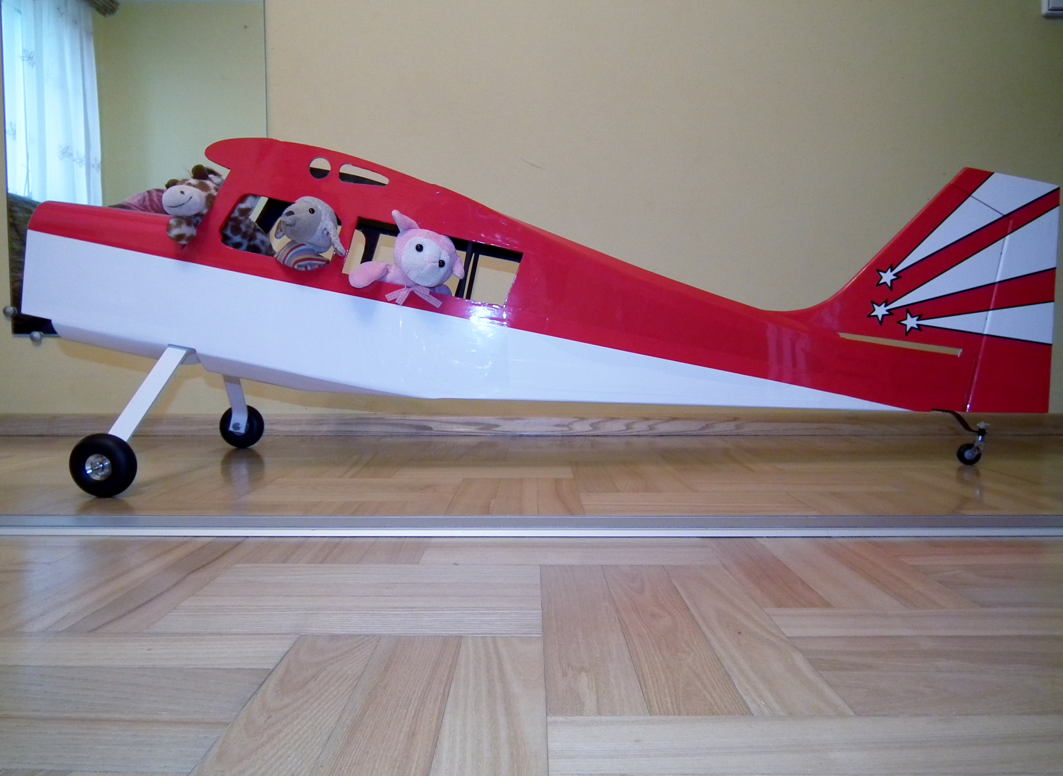

Nice Start Valius! I wish I had built my plane with a bolt-on to rib (like yours) as opposed to the engineering Dyna-Flite put forth.
I want to build another Dyna-Flite Decathlon with that wing side bolt-on and put it on a diet and make the plane lighter.
Also would like to put a 1/2 degree of dihedrel in the wings, mine look almost like they have negitive - they are almost droopy.
Kind of sad looking! Lol! check it out in my gallery. Good Luck with it!

Valius I am refering to the angle each wing has to the other wing. Check out the picture of the full scale Decathlon.
As you can see each wing is at a slight angle away from the fuselage. Hope that helps! Good Luck!

Memory serves - the wings are built with zero dihedral. The built-in washout results in the leading edges appearing to droop. I agree that adding a small amount of dihedral would give a better appearance without changing the flight characteristics.

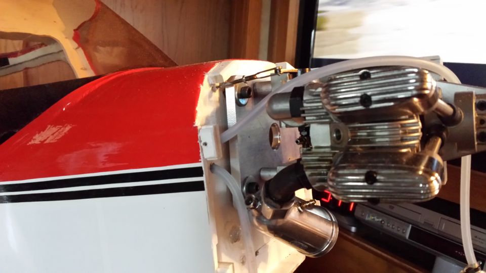

funnotcrazy....I live in Highlands, TX and am a member of http://www.propnuts.com/ Club we fly off a grass runway over a grass farm. Propnuts is and may be one of the oldest R/C clubs in Houston. I have a 16/6 (not sure on the pitch due to the spinner) Master Airscrew K-Series and I have been using Omega 10% but may have to switch to Ritches Brew soon. My source ( Odessy Hobbies) for Omega dried up and the local Hobby shop (Razor) carries RBrew. It should run fine I'v used RB 10% before and had no problems but everyone has thier favorite.
I built it back in 08 and it has been a work in progress. It has about 5 flights on it and I am not real excited about the planes flying performance. So I am making adjustments and changing things - I used to have a Sullivan on board glow plug lighter but found the Saito 180 to idol just fine without it- so I removed it and the battery. I am going to change the 2.3 G radio to duel recievers for safety.
And I'v got to change that dihedrel in that wing! Come on out to the April swap meet!
Question : Is your Saito 180 mounted inverted (with the engine upside down) ?

Here is a picture of the windshield with the Mono-cote over it.... And here is a picture of the new horizontal Saito 180 with adaptor plate and some of the pan head screws on the side of the windshield. Just take your time and make it fit well.

funnotcrazy....I have not tried any larger props yet. I may in the future. When I had the Saito inverted I had to clean out the glow plug before the first flight and remove the oil in it. (a real pain when the cowling was on) Also it seemed very rich and would sometimes cause hydrolic lock on the valves. The reason I mounted it Inverted was to save on the looks of the plane - but like they say "beauty follows function " lol!
