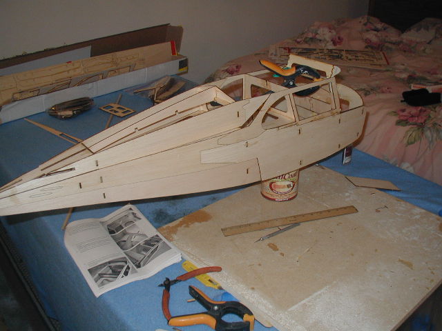

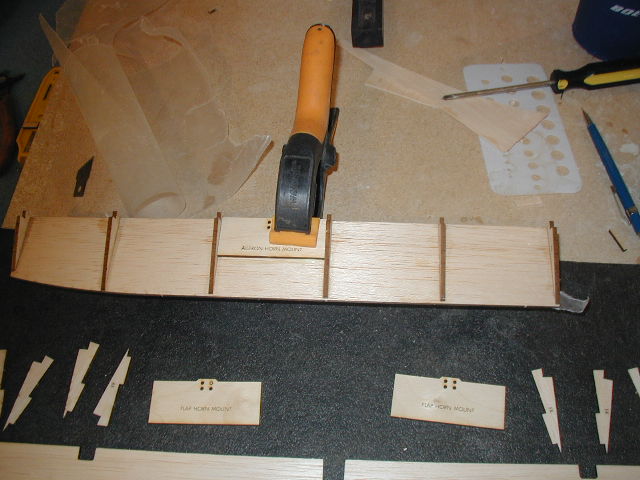

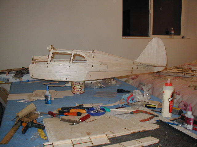

Last night I got started by doing some subassembly work. There are a number of parts that have to be glued up befor the actual construction starts. Nothing to it really, all the parts to be assembled are shown on the plans in quarter scale and they are all labeled.
I had planned to build the wing first but when I broke out the parts I found that one of the ply ribs had fallen out of the cut sheet. Unfortunately it fell out in Canada and was not in the box. Before I turned in last nite I shot a quick Email to Mosquitobite. I had an answer this morning. The real suprise was that Ken called me this afternoon to make sure we were talking about the same part. He said he was sending two ribs so they would be a matched pair. How cool is that?
So now we start the Fuselage.
As you can see, this plane is not built "over the plans" all you need is a flat spot. I use a 2 foot square high density fiber board. The stuff used for counter top underlayment. Cover it with something that CA won't stick to, like wax paper. They call their system FastFit and it really is. If I had a faster drying wood glue I would have completed the major assembly in about 2 hours. It took 4 hours because I use Tite Bond and like to give the glue plenty of time set up. The fuselge in built up mostly dry. Glue is only applied to tack the tabs once the parts are aligned. Pay close attention to the instrctions and it's a snap. One caution though, while the balsa in this kit is very good I did find it somewhat soft in a couple of instances. This Airplane is very light for it's size so some of the formers will seem filmsy Once they are glued in they lock into the structure. I got a litte heavy handed and broke a tab off one of them. Remember, This setup fits very, very well. Do not force anything. If something does not want to fit it is more than likely your fault.
I will add the internal braces and stiffeners tomorrow, sheet the forward section, and begin on the gear.
I have some more fotos so I will see how this comes out and post the rest after dinner.

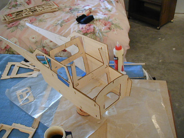

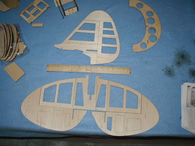

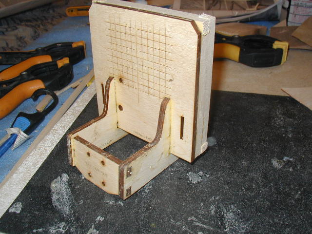

I just got back from dinner so I will add comments to the photos in my last post. I am not yet compleatly confidant with this upload process so we will take it slow.
The photos obviously loaded out of sequence but they dont need a lot of commentary. The first shot is of the nearly completed fuselage structure. As you can see there are no sticks. The tube structure is simulated by using sheets at various elevations rather than the sticks often used for fabric airframes. This goes together very quickly after the forward section is setup. As I said in the prior post most of the glue goes on at this stage.
Second Shot: What can I say? Parts! Not that many for a unit of this size.
Third Shot: This is about 20 min. into construction. Both sidwalls have been tacked to the formers and the floor plates are going in.
Forth Shot: The wing bolts go thru a ply doubler block right behind the windshield. I used Titebond and clamped it after aligning the bolt holes.
By the way, to give you an idea of size, the ruler in some of the shots is 15 inches.

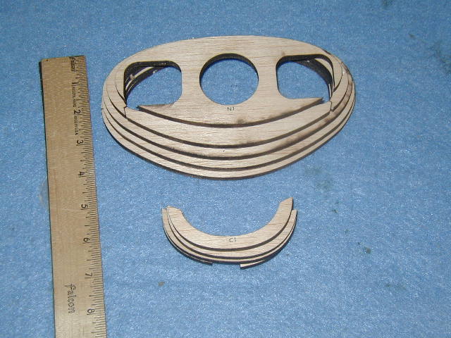

New Shots. The first is the tail feathers after the joining operation. They are cut from 1/16 sheet and then sheeted cross grain again with 1/16. The rudder,vert stab and elevators are each made from 2 pieces and the horizontal stab comes in 3 parts. The Ply wing tip bow is to the right of the fin/rudder assy.
The last shot is the stack of 1/4" parts that become the nose. Each has a 1/4 square indexing hole so you can stack them on a 1/4" stick. once stacked they are self aligning. CA the stack and start sanding. Each part is cut so that when you sand off the lazer char (black line) you have the correct contour. Lots better than the 4"x3" balsa block of yesteryear.
More later.

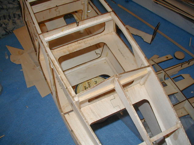

Its sunday night and I got some work in on the TriPacer over the weekend. So far I have skinned all of the tail feathers, built up the flaps and ailerons, and added all the internal braces to the fuselage. With the tail on it really is starting to look like a triPacer.

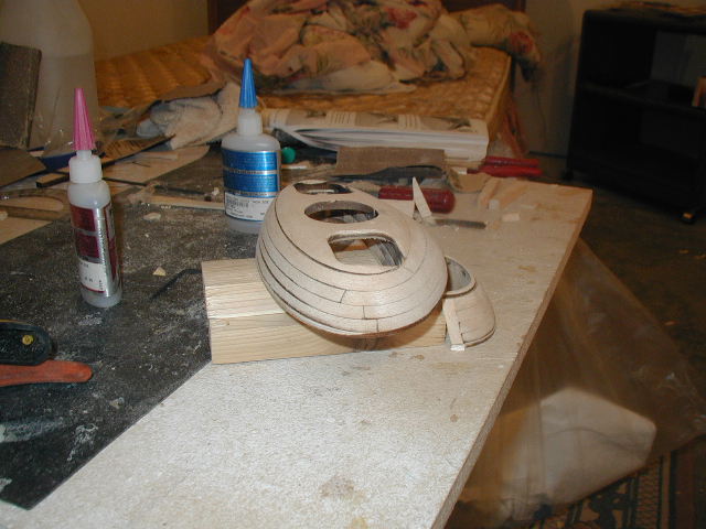

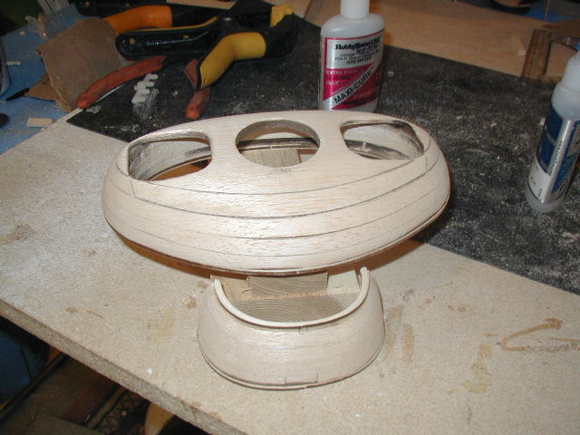

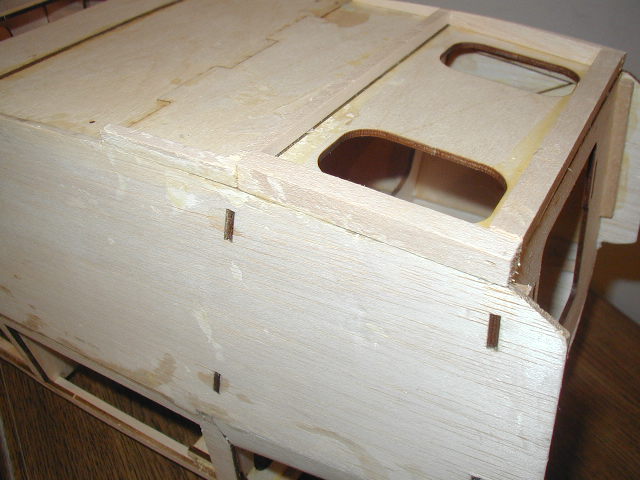

Last nite I sheeted the nose . Did it just as shown in the instructions, 1 piece on each side with a triangle in the middle. Used a spritz of water and amonia, let it set a few min. and bent it down. Thats the easist sheetig job I have ever done. Glued down some 3/8 and 1/4 sq sticks to the bottom of the fuselage and let them dry over nite. sanded the contour this AM. The gear goes in just aft of the faired area. Built up a box of 3/8 sq sticks on the firewall per the instructionsand set it aside. Dru fit the firewall/engine box/nosegear assembly as you see it. It gets glued in once the engine is set. The arms protruding from the firewall are to hold the cowl nose block. That gets started after supper.

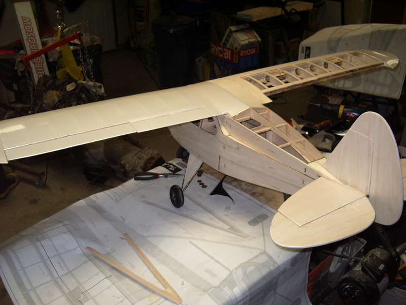

I'm also building a Mosquitobiteplanes Tri-Pacer. Just about done buiding it. Just have to complete the covering and install the flight pack, fuel tank and engine. Oh yeah, and install the second strut.
This kit is a dream to build. Most of it was completed in about 7 days. I couldn't stop building once I started. The instructions are very complete and clear. Anything you're not sure of when reading the instructions is quickly apperent when you look over the two roled plan sheets.
The wing went together very quickly and is nice and straight, but then again this didn't really surprise me since I'd already built one of their T-Rex's this spring. They've used the same style of wing construction, complete with clamping the main spar root in a vice and hanging the spar extensions and ribs off of that.
To make sure the wing was straight, I once again used a laser line generator sitting on one end of the main spar and aimed it along the spar toward the other wing tip. Once again a perfectly straight wing!

Worked a little after dinner. Stacked and sanded the nose piece and scoop. Total time for that was one hour. The "sand to the marks" system works great. Got the gear wires installed and bent and soldered the joiner wires. Got to run into town tomorrow and get some 22 ga. bare wire. I just finished building this house and there is not one inch of it here. Too bad Icant' use 12 ga. I've got lots of that.

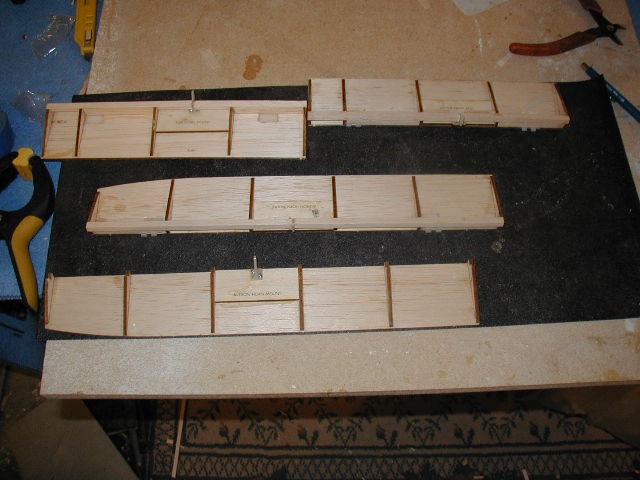

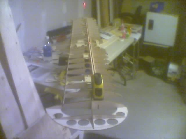

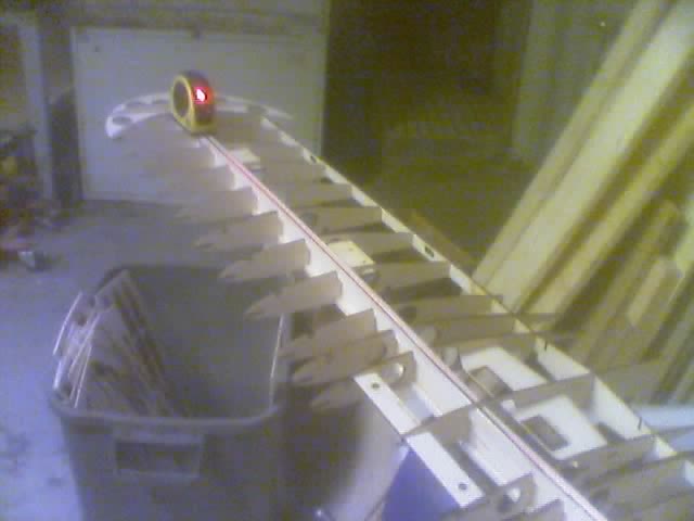

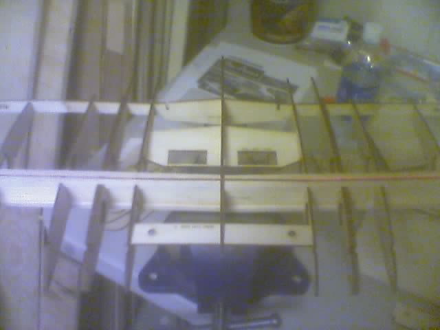

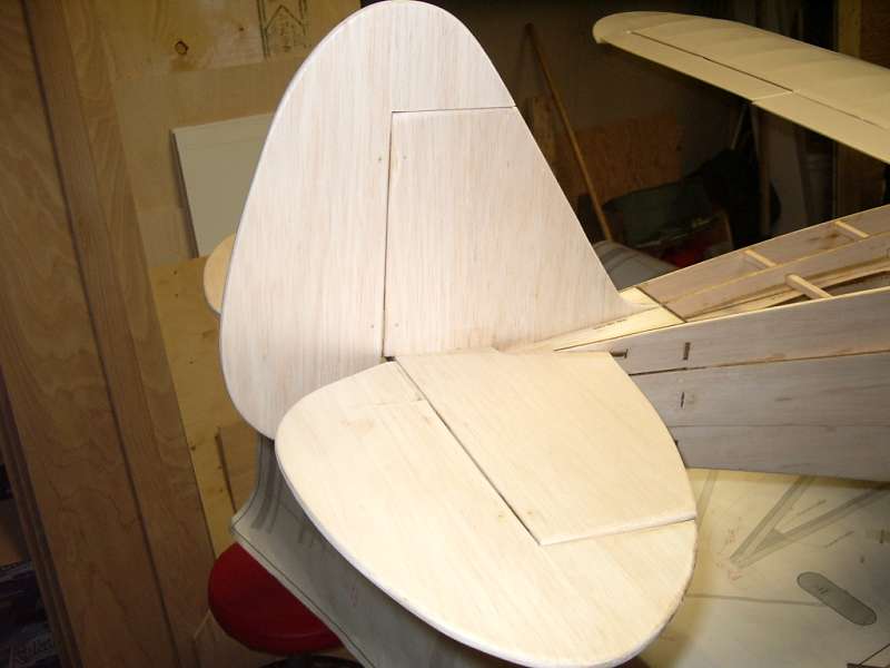

Here are a couple of pictures of the wing when it was in progress. Sorry for the quality of the pictures, I don't own a digital camera as yet, so used the picture function on my cell phone. Not too clear.
If you look hard enough you'll see the laser line generator on the wing shining down the main spar.
Since I have to rely on the kindness of friends for good digital shots I am at their mercy and also ended up with this cockpit view of myself!

Wascamp,
I love it! "Beat a brick to the ground!"

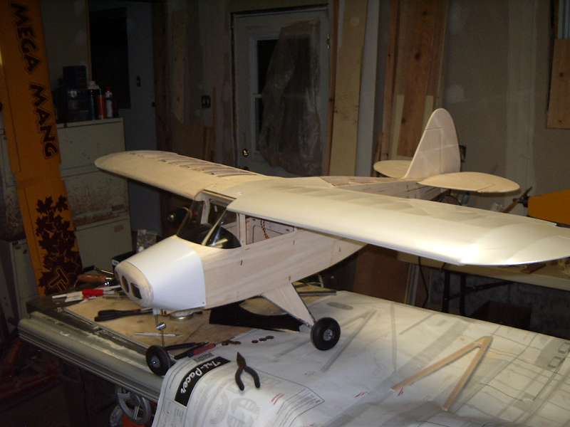

The flat ABS for the nose cone worked beautifuly. The only real hard part was lining it up so that it was centered before wrapping down to install the side screws. I just taped it along the trailing edge at the top and wrapped the sides down averaging the amount showing on each side so that it was ballanced, then installed the two screws. Admittedly this required lifting the tape a few times to reset it in a new position before it was in the right place. Flip the plane over and bring the two tangs together on top of the cowl block, presto!
The real beauty was the windshield. If you use the template it's a perfect fit. Once it's installed you won't believe how easy it was and how good it looks for a flat piece of plastic!
I've seen five or six tripe photos that show what you mean about the doors. I look forward to seing your modification.
Re the phone line... are you talking about single strand or multi-strand? The single strand will probably work. The thing I liked about the lamp-cord was that the wire strands are quite fine, but there are so many that it's very strong. Because they are fine strands you can flatten them down nicely for a really smooth finish.
I've actually got some filler with micro-baloons in it to keep it nice and light. I've been meaning to try it out, but have been too impatient to wait for it to dry properly. Now that I'm committed to filling, I'll wait the time and do it right.
The 1/8 balsa in my kit was pretty good. Like all sheet stock it had some harder spots in it, but nothing too hard. I use a small hobby saw for cross grain cutting. I find I get less end grain break out that way.

MegaMang
That's great to hear about the cowl and the windshield. I built a sig Kadet a few years back and the W/S was a real pain. The telephone wire is about 28 ga. solid. It worked pretty good. I had to go to town anyway because I needed some flux.
Its funny that you mention micro balloons. Thats to high tech for me. I have all this wood filler left over from trimming out the house that it never occured to me to get "modlling filler" I must have 5 or 6 different types of wood filler here. Say, has a picture of your T-rex been on the net. There is one built in Canada that has maple leaf motif that is beautyfull. Is that one yours?

Wascamp,
Glad you liked the Canada Leaf motif. You guessed it right, that is my plane. It flies very nicely. No complaints about that kit. Just had to try the Tri-Pacer after that kit.
What do you think of the building instructions so far?

Wascamp,
Did I see in another posts that you were building a garage, so you wouldn't be building this kit until December? Couldn't wait?!
