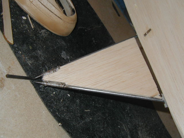

Well today was one of those grunt work days. Soldered the gear join and fit the leg fillers. As mike and I talked about in a post above the join of the two gear wires is sort of old school. You will see what I mean about it works but it's not pretty. It gets covered up later and hopefilly it won't look too bad. The last two shots are just to show the filling I did on the nose and scoop. It's not extensive, just a little to smooth out the transitions of the sanded layers. I am at that point in every build where things start to get sanded. I finished rounding the edges of the control surfaces : that reproduces the real airplane which used steel tube build the tail members.

Your soldering job turned out very nice. Pretty smooth in fact. Much better than mine turned out. One thing I reallized once I'd covered my landing gear is that a little filler would have gone a long way here! Oh well, next time! Yours should blend into the background once covered without any problems. I really have to work on my soldering skills. I've got a huge 500 watt iron that didn't work as nice as I'd like. Going to have to pick up some silver solder. I used to have some, but when I built the addition on our house it somehow dissapeared. I've used silver solder for stuff like this before and it works much better than lead. It seems to stick to a much wider selection of metals. I just can't remember if I had to use any flux when I used it...

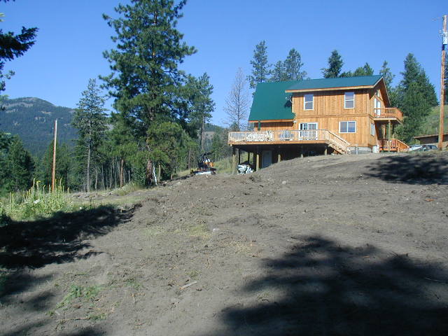

I suspected that you had a nice view from the picture of your garage pad in another thread. Well done. Did you do the building yourself or contract it out?
I work as a Lan Administrator for a canadian government agency, so it's no problem to keep a window open on a site like RC Universe. Only thing is, I only get around to looking at it when everything is calm here. At home I have so little time right now that I seldom get online like this. I suspect we've probably got a 3 hour time difference going between us! Chances are good that I'll be online a few hours before you, and you'll be online a few hours after me.
Right now my other projects are much like yours. The house addition, which I have yet to complete. A house next door that a good friend of mine is building himself. I spend most of my off work hours there right now. Trying to get it all closed in before the snows hit. Almost there.

I contracted the foundation, framing , roof, and windows. The rest, plumbing, wireing, insulatoin. sheet rock. and finish work I did myself. I had a lot of help from the family and I used at least one paid helper for a lot of it. There is 900 sq ft of oak floor and 8000 feet of ceder siding that I personally but down. There are 59 light fixtures installed on three levels. I still have to finish the basement bathroom and put down flooring. Lukily we ran out of money so I can put off the basement for a while.

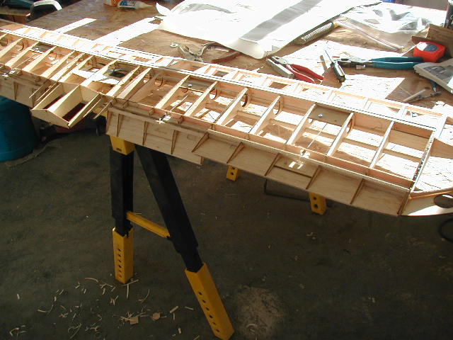

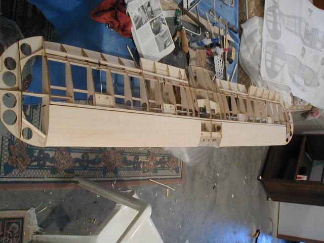

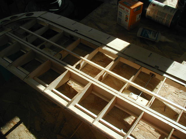

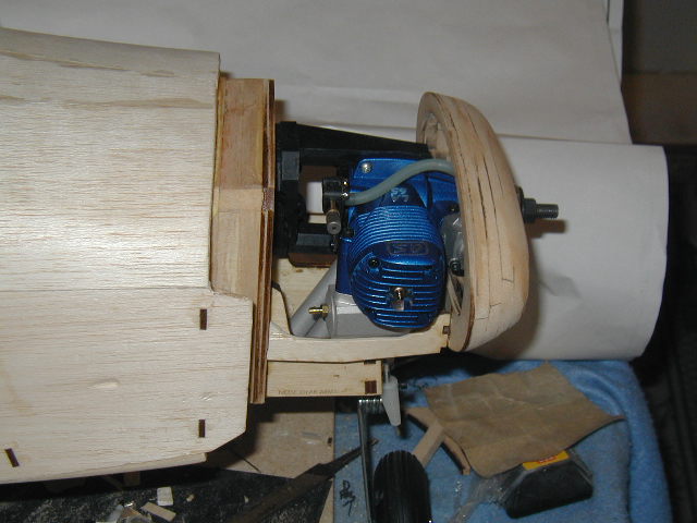

A short session tonigth fellows. I am in the middle of a beastly head cold and between blowing and coughing It's hard to type. As you see I buildt the wing yesterday. The photo shows the Ply Wing Cage which is the self jigging fixture that builds the Mosquitobite wing system. It works very well and ensures a straight wing. One thing I will caution you about. Build it one side at a time. You may want to get ahead of the instructions and build from the inside out on both sides at once. Dont'. With the spine locked into a vice it is very stable. When you build one side it is easy to keep evrything aligned. I glued both the left and right main spars joints and built the right hand panel. When I went over to the left hand side i noticed that the Spar doubler had shifted slightly at the joint. Not enough to cause a bent wing but I had to shave the spar caps to get them to align flush with the spar and ribs. Speaking of the spar caps. The instructions show the wing first in order of build. There is a reason for this. I was missing a ply rib so in my haste to get under way I built the fuselage first. The reason you build the wing first is because while there is plenty of 1/4 sq. balsa sitck in the kit for both the wing and the fuselage ther are only so many full length sticks. You need twelve 48 in sticks to build the wing spars and caps. The cut offs from these are more than enough to reinforce the fuselage. DOH! I had to cut acute angle scarf joints in a few of the cutoffs to finish my spar work. Not a disaster, but just more work. Another word of caution to builders of this kit. The pieces are cut for very precise fit and as such, care must be taken when installing the ribs. Dont' force any of them. There are small tabs and large holes in many of the ribs. Untill they are all glued up they can be damaged if you are not careful. After all balsa is balsa. Nuff said.
I will work on the wing and mount the control surfaces and linkages over the next few days. That is if I dont' DIE first from the crud.
#43
I should have mentioned about the sticks needed for the wing when you mentioned that you were building out of order... I did the same myself with the last kit I built! For me, it's no big deal since I'm only 35 Miles from the nearest LHS.
I had built my wing up one side at a time and had no trouble with the spar doubler.
Yours is looking very clean. Well done.
Your engine is certainly a better fit than my MDS .58. I'm completely envious. You'll have a very neat end product at this rate.

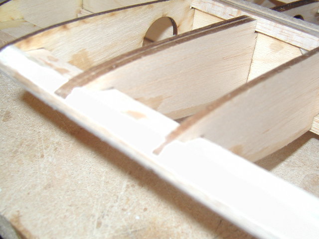

I am alive. The reason I know, is that dead people don't cough! I had a rough couple of days but it looks as if I will pull through. Even sick I worked on the plane for a few hours. I hinged the control surfaces, and mounted the flaps and ailerons. Installed the bell cranks and push rods for the flaps and ailerons. I would add a CAUTION here about the pushrod installation. The instructions call out some very precise lengths for the rods. I found that the lengths of the flap rods were incorrect. At least in my case. I measured the plans and all the numbers agreed. However using the factory numbers put the servo end clevises into the bay for the aileron servo. I had to lenghten the left rod and shorten the right one. Do some measuring on your wing before you cut the rods. The aileron rods were ok, but all of the control surface push rods were about 3/8 in. too long. Don't tighten the bellcrank screws or cut them to length untill you have completed the installation. you will be removing the nuts several times to get things sorted out. With the trailing edge done I moved on to sheeting the leading edge. WARNING: CAUTION: Do not build the fuselage first. If you do you had better be close to a sheet of 1/16 x 6 x 48 balsa, or know how to edge glue a couple of pieces together! Don't aske me how I know this.
This plane has a rather unique leading edge set up. There is a leading edge spar of 1/8 th x 1/2 sheet that slots into the wing ribs. 1/16 x3/8 strips are glued on to the spar between the ribs on the top and bottom of the wing. The strips are flush with the forward edge of the spar which brings them proud of the rib noses. All of these strips are then carved and sanded to the rib contour on their leading edge. It only took about 20 min. to accomplish this. The leading edge sheet is then CA'd to the main spar cap, ribs and leading edge block strips. When the glue has set the upper and lower sheets are sanded flush with the leading edge spar. It's not as complicated as I may make it sound. What you are left with is a FLAT leading edge. A 1/16 x 3/8 strip is glued flat to flat. Sand most of this off and you have a nice rounded leading edge. More later.
