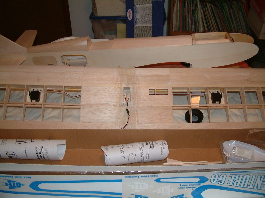

For placement of the servo in the wing. I count the bays and go back toward the fuselage one bay. The Airelons are bigger as you get toward the fuselage so I tend to go in that direction.
The photos are of my BTE Venture 60 build.
WOW! I dont know why these photos did not thumbnail!

Swager,
Are you going to make access panels to cover where you hooked up your 'Y' harness to your servo?
BG

Default RE: Sig 4 Star 40 Mods
No access cover. I screwed up on my planning. I am going to make the holes bigger in the wing ribs so it will be easier to pass the lead thru from either open side.

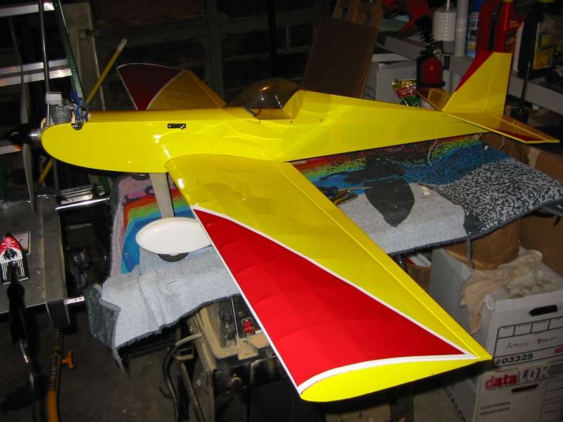

I just finished my 4*40 arf (does that count?)
Here's a few pictures - when I fly it in the next few weeks I'll take a better final picture.
