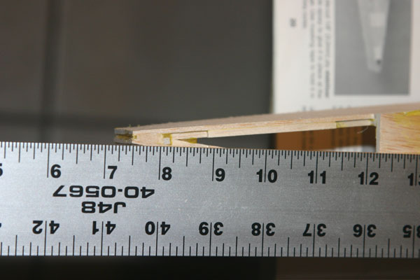

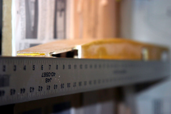

Uh-oh,
after glueing in the tapered tail post i checked with a straight edge
and "oh well" see pictures. the fuselage ends needed to be held in place
with a clamp to avoid springing back. didn't see they weren't straight.[&o]
anyone has an idea how to fix that?
thanks, pat

OK Miami, you are still ok. when you glue the stab and fin on just be sure they are centered. Should not make too much difference in how thw plane flies. There is very little offset there. If it concerns you you could cut the fuse sides at the tail and re glue them. Use a small piece of balsa in the nothc to reinforce it. Too be sure the glue joint is good. That should be a simple fix. Don't sweat it too much. Just take your time and be careful and all will be fine.

[8D] my bad,
i assumed clamping the tail together gets the end right in the middle.
the instructions don't say anything about checking. looked kind of funky
pointing to the left.

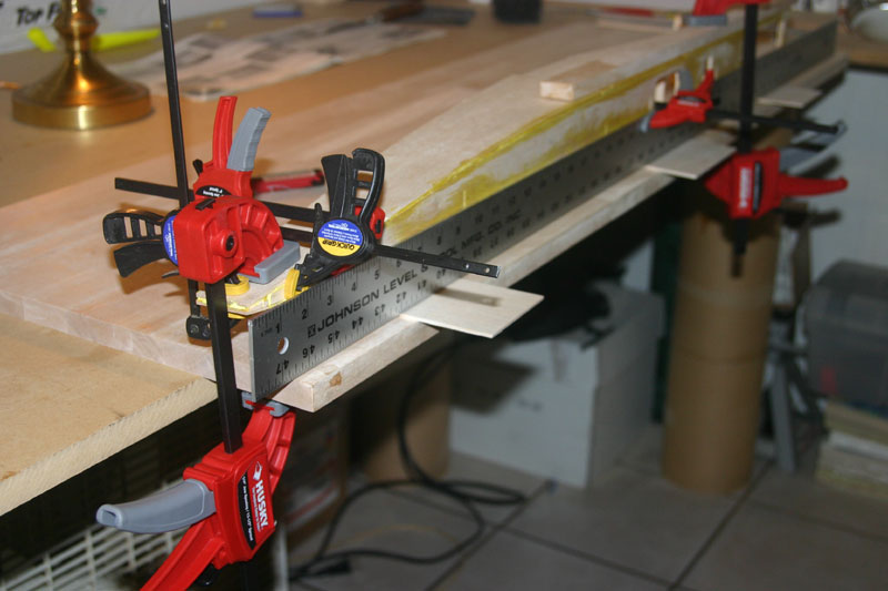

i just cut it again and reglued but this time holding the tail down with the fuse on the side
and the straight edge attached. hope this works out.

It's probably a good thing that you cut and reglued the tail. Remember the top and bottom fins on the Contender should be in alignment as the rudder hinges to both of those above and below the fuselage. If you had left it alone, you could have set the stabilizer correctly, but the fins and rudder arrangement would have been out of whack. Good job.

good point robert,
i forgot about it also. everything is straight now and i moved on to the firewall.
