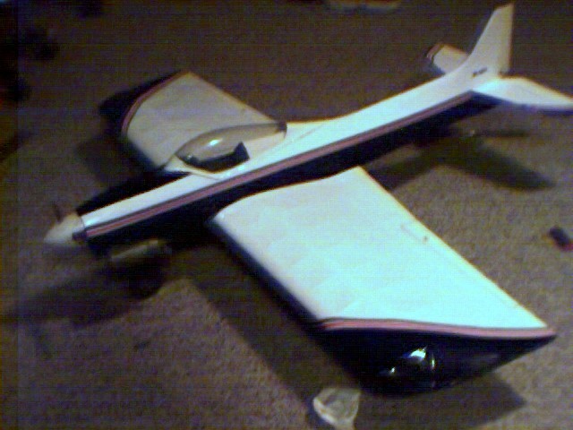

I received a partially completed original (20 years old) contender about 5 years ago and completed it . Powered by a 40FP inverted with a functional chin scoop as per the original. No flap, straight wing. On the original you had a choice to build it with either a straight wing or with a dehedral break at the joint between the ailerons and flap.Since the wing was 90% done i just added a slight upturn on the tip though not as much as on the new edition. With the staight wing it has some adverse roll coupling with the rudder. You can do a roll using only the rudder, the interesting thing is that it is opposite the rudder deflection. It makes control coordination for knife edge kind of interesting.
I also stretched the covering over the fin and body joint not easy but it does look nice. If some one tells me how to attach pictures i'll try to post them

fox,
of course we would love to see your contender.
hit reply and below the window for the text message is
the word "file" click here to upload.
than browse to locate the file on you computer and hit ok.
#86
Join Date: May 2004
Location: Knoxville,
TN
Posts: 162
RE: Top Flite Contender
NICE!
that is one sexy contender!
should've gone inverted with mine, looks so much better.
do you remember the covering sequence?
are you still flying it?
it must be 25 years old right?

foxflyr,
I had to look carefully to beleive that was the Contender. Nice job on the alteration. That inverted engine sure does look good. How old did you say that plane is? - 20 years?. WOW ! I am impressed.
Sledge_78
Sledge_78

Foxflyr,
I would have to agree with Sledge 78, the cover scheme on your Contender looks great and the inverted engine really adds to the overall effect. The front of the airplane looks so much cleaner. Well done!
Regards
Regards

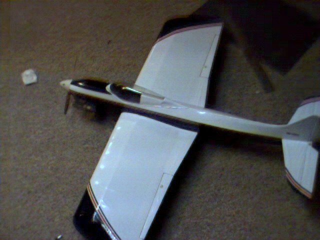

Thank you for all the compliments. The kit was 20 years old, I finished it 5 years ago and have been flying it since.
For the covering,I started on the top centerline and applied the white on the left and right down to the uppercorner on the side. Then the bottom and lower side was done in dark blue. On the wing, I pre cut the blue ond white panels, overlapped them 1/8" and joined them with a trim iron. This piece was then applied to the wing,
I have included some more pictures. As a note the old kit only had a 46" wing span. The inverted engine was the recomended way to build the original kit. If you look at the pictures you will notice that the ailerons are driven by a single servo thru belcanks at the ends.
