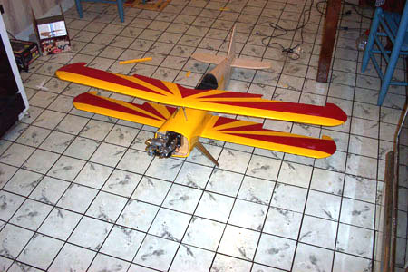

I haven't messed with this for a month or so because I was finishing up my Seduction Freestyle. Here are some pics of my progress:
Great Planes Super Skybolt
Saito .91 4 stroke engine 14X6 Prop
S3001 Futaba Servos
1200 MAh NiMH battery (very light)
Pull Pull on elevator and Rudder (to save on weight)
21st Century fabric (missle red and cub yellow)
I should be finished covering in the next day or so (it's going real quick) and hopefully ready to fly by Labor Day....Heh, have to go show it off when there are a lot of people at the field. I must say, this has been the most involved kit I've ever built. I was soo worried about covering in between the cabanes, but had no problems, and looks quite good. Chuck, you'd be proud

It looks nice, but it also looks like you made a little boo boo. You should ALWAYS cover the fuse (and everything else for that matter) starting at the rear, and working your way to the front. That way, all of your overlaping seams are away from the airflow so they can't be lifted by the air blowing over them.

I definatly agree (and honestly didn't think about it), I was very worried about the complications with covering around the cabanes, I wanted to get that done as soon as possible. I'm putting two fairly large pinstripes down each side and one on top, so I am hoping that will help to keep the monocote down. Thanks for pointing that out tho!

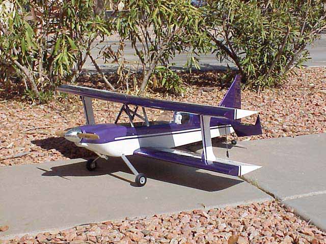

Well, after getting used to the difference in flying characteristics I decided that I really like how biplanes fly. I started flying planes with a GP Cap 232. I decided on this as my trainer because I am an RC Heli Pilot and I thought, how hard could it be. I was correct in my decision. I still have my cap and it has never been crashed. I am a self taught pilot and I guess I just got lucky. Actually, I owe most of my sucess to Real Flight. After the Cap I decided that I wanted a biplane so I got the GP Ultimate. Was a joy to build and it flys great. I seems a little heavy but still has good flight characteristics. After seeing your pics of the skybolt I decided that I would do something that I said I would never do again, and that is build another biplane. I figure this kit will really test my building skills! So far I have the Cap, Ultimate, 90% of a GP Extra (.60 size), and my heli (Raptor 30). This will be a welcome airplane to my fleet, Hopefully! After the rave reviews that everyone seems to have about this plane I hope they are right.
Let the Building Continue!!!! Phil (Mesa, AZ)
By the way, the 90% of the extra is because it is almost done being covered and not a crash related deduction of 10%!

Hi tmproff, minnflyer pointed out correctly but what you can do is to seal that seam with clear lusterkote. Spray some into the can top cover, use a fine brush and apply two-three thin coatings over the seam. Doesn't turn yellow and fuelproof seam. Good luck..........

I did go and purchase a copy of clear and sprayed down all my pin striping, and also added a futaba sticker right where the seam is on the side of the plane. I dont' think the monocote is going to come up there.
