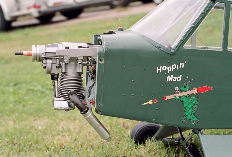

Depends on how much scale detail, or how faithful to scale you want. I've seen the GP Cub, nice plane and durable, and the Goldberg, a bit more scale and also durable, but my vote is for the SIG. I've built one of them, and they are very close to scale in all respects, they have functional door and window on the right, the wing is two-piece with tubes to support the roots and the struts are functional and necessary to fly the plane. The plans show both ways to build, full span or clipped wing. It is a builder's kit, the fuse has a lot of modular construction but the wings, tail and rear deck are pretty well stick built. The 1/5 scale is now laser cut, pieces fit perfectly. The wire landing gear is durable and builds fairly easily, but if you want a really nice looking plane, spend the extra bucks ($110) on scale gear from Robart, or if you can find them, William Wallace ( a little cheaper, more scale, but not quite as durable as Robart). Here's a picture of mine, modified to a L-4. The gear is Wm. Wallace, the cover is Sig Koverall and dope, motive power is an inverted .65 Saito, but if i had to do it over I would put in a .72, only because it will fit completely within the cowl. The .65 is a tad taller and the tips of the valve covers are visible in one of the photos. The .72 would give you a bit better aerobatic performance with the clipped wings. Mine is full span.

More- About the center section being weak. This may be, but if so, it is because Sig stressed scale over strength. It is an easy thing to modify, just add 1/4 inch round hardwood dowels to the upright pieces that support the center section. The presence of the door may have something to do with strength, but it still can take a pretty good licking, as evidenced by the many ground loops and hard landings I made while learning to fly mine. I was wooried, also, that because of my modifications, I had weakened the center section and cabin, but I found out the hard way a couple of weeks ago that my center section is actually stronger than the wing roots, which tore out of the wings when I landed on the nose after managing to return to the field after taking off without hooking up the aileron servos after I attached the wings. How stupid am I? They're already repaired, took about 4 hours per wing.. As far as the flat bottom wing goes, full size Cubs have a flat bottom wing, I don't think it will affect your aerobatics too much; after all, it's a CUB, not a Cap or Extra.
Another comment about strength of design. One of our "old timers" has four Cubs of different makes and scales, been flying them for years. He says it's inherent in the Cub design, and not the kit, because of all the window area, there's not as much space for a strong sidewall under the wing. I've also stalled mine straight down from about 75 feet, landed vertically in a kudzu patch with absolutely no damage to my plane. That has to say something for strength, too. here's a couple more pix, look at the dowels on the upright supports for the center section.
