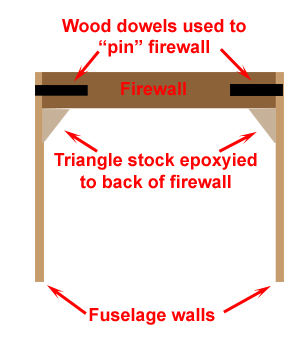

I have been reading past posts and have a few questions pertaining to kit building.
I have read about people fiberglassing the firewall for reinforcement.
I have to guess that they are fiberglassing the back of the firewall to the sides and top of fuselage. Is this correct?

as far as the first question goes i have not done it but i believe they are running the fiberglass around the front of the firewall kind of like a limmiter strap incase the glue lets loose. I dont think it neccecary in most cases. but never hurts to have a little extra support if you want to do it. the second question there is a couple ways you can do this one is by putting some epoxy down 30 min then pressing the mat down on top then come back with some more epoxy and smooth it all out. the second is to glue the mat down with a adhesive I ussually use the stuff in the aresol can from the hardware store. then smooth the mat and push the epoxy in from the top getting it flat and smooth as possible. i have better luck with second option. oh ya i just use a scrp thin piece of wood about 2 to 3 inches wide to smooth and spread epoxy happy building and flying
RCU Forum Manager/Admin
Fiberglassing the firewalll is pretty much making more work for yourself that you don't need. For most planes a good tight fit, 30 minute epoxy, and triangle stock will be more than enough to make a strong firewall. Use the triangle stock on the backside of the firewall where the firewall meets the fuselage sides. (maybe we can talk Minnflyer to do a one of his great graphics showing this). If you do this you shouldn't need anything else to secure your firewall in for most planes

I'd also have to agree with the posts in this forum. Fiberglassing the nose of the airplane really isn' necessary unless specifically called for during the assembly of the airframe. What "is" necessary is "fuel proofing" the nose section so that the oil and nitro won't migrate into the wood and glue joints and then start to do bad things. What I've used to fuel proof mine is epoxy finish resin which works well for me.
If you are concerned about the firewall being secure with the airframe there two thing that I've done which has worked well. One is to drill about 4 1/8" holes through the side of the fuselage and about a 1/2" deep into the firewall and then glue some 1/8" hardwood dowel stock in them. A little work but once completed and sanded smooth it would be hard to tell when covered. Believe me you'd total the airframe up before that firewall will let loose.
Another more simpler way is to glue some triangle stock on the front side of the firewall and the fuselage side. Not as pretty but it works well.

No graphic needed Ken, I think your description sums it up well. No fiberglass needed either, not for a firewall anyway.

Probably the best way to do that is to remove the engine mount (if it's there) and screw the screws back in flush with the rear side of firewall. This is done to keep the glue from filling the screw holes if blind nuts were used to hold the engine mount to the firewall. If there were just some drill holes then disregard and proceed further. Now go and get yourself some glass cloth (medium to heavy weight will do) and with a very sharp pair of scissors cut a piece to match the size of the firewall. Spray the backside of the firewall with a light coat of contact cement and let it get to a tacky state and then place your cut piece of glass cloth on it and smooth it out to where no wrinkles. Then mix a good size batch of 30 or 45 minute epoxy up and with the fuselage vertical on your bench (maybe leaning against the wall or something) pour it in onto the glass cloth and "dab" it into the fibers using a cheap brush or even a foam type brush. Don't go to heavy with the epoxy and try not to push the glue around too much to where it'll move the glass cloth. The idea is to get the epoxy to soak through the fibers of the glass cloth and good contact made to the wood of the firewall. The epoxy will flow a little on its own. Some guys will actually add a small amount of alcohol to the epoxy to thin it out which helps and it'll also increase the amount of working time. Be careful when doing this since very little is needed to change the consistency of the epoxy. Use alcohol soak paper towel to clean up the area's outside of the firewall which may have gotten a drop or a splatter of glue. Let the work sit for a few hours and then go back pull the screws out (if you had them screwed in into blind nuts) and drill out the existing holes on the firewall. Should look pretty nice and added a good deal of strength to your firewall.
But you're right, fiberglassing the rear of a firewall WOULD be messy... It's also unnecessary.
If you want to fuel-proof that area, you could spray or brush it with polyurethane, or any of the fuel-proof paints that are on the market, or you could use finishing resin, or epoxy thinned with alcohol.

Why fiberglass the back of the firewall? That is uneccesary work. All you need to reinforce it is either some 1/2 X 1/2 or slightly smaller square basswood stock, or triangle stock. Get the corner all smeared with 30min epoxy, and place the block into place. Then, smear some more epoxy into the corners that produced (for a little added piece of mind, but not really necessary). You have a joint that will not let go. This is easiest done while building (if it's a kit). If it's an arf, I wouldn't worry about it, unless you are grossly overpowering the model.

Minn and the others are correct, fiberglassing the firewall is not needed. IF you feel like you need more strength than triangle stock will give you, then you should pin the firewall. after epoxying the firewall to the fuselage drill through the fuselage and into the firewall. use carpenter's glue in the hole and then tap in a wooden dowel. cut the dowel flush with the fuselage. This is cleaner than fiberglass. it is lighter than fiberglass. and is easier than fiberglass. Built this way, you won't be able to pull the firewall out.

Yea it looks like pinning the firewall would be much easier.
