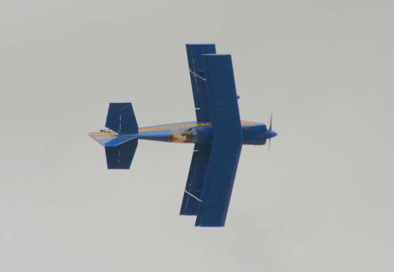

I fly my Ultimate on a O.S.90 2 Stroke. It flys great. I think the 108 is a bit much for this plane. The Evolution should work out just fine.-Good Luck.-Mike
