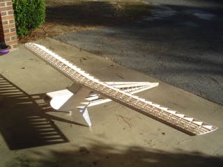

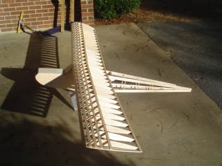

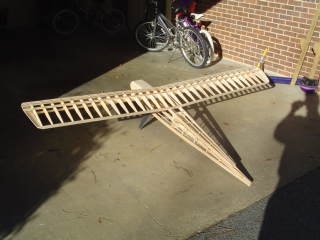

After getting back into the hobby I was surprised to see that Hobby Lobby was still advertising the Sr Telemaster with the same old photo I remembered from the 80's. The chick in the pasture shot. I had to build one for old times sake. My wife gave me the kit for Christmas and my Mom and Dad gave me a Saito 82 to power it. As you can see the project is moving right along! I plan to install a candy "bomb bay" and a glider tow hook. Dual aileron servos installed in the wing so I can mix flaps. 4" tires for soft field landings! Thinking about moving the rudder and elevator servos to the tail.

Old 02-11-2005 | 05:17 PM
My Feedback: (20)
Joined: Nov 2001
Posts: 2,424
From: Kotzebue, AK
Default RE: 8 ft of bones! Sr Telemaster
Looks really nice. Well Done!
Don
Old 02-11-2005 | 05:41 PM
MinnFlyer's Avatar
Posts: 28,519
Received 9 Likes on 9 Posts
From: Willmar, MN
You forgot to build the tail
Old 02-11-2005 | 06:23 PM
hookedonrc's Avatar
Joined: Dec 2002
Posts: 2,891
From: Tulsa, OK
Isn't that the other 1/2 of a foot? Looks really great, keep posting updates.

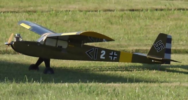

Looks Good!, You can have a lot of fun with covering this airplane. I built one several years ago and had a bunch of olive drab covering left from another project. This is what I ended up with
I was kinda going for that Fiesler Storch look.

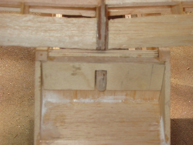

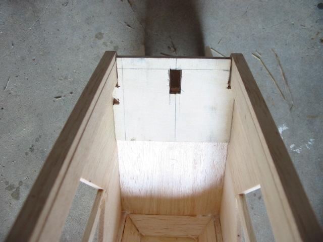

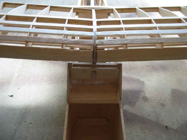

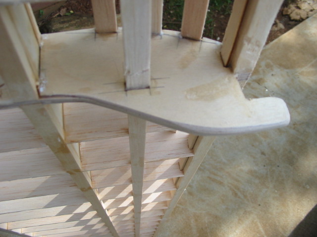

As it would happen, there's a Sr. Telemaster for sale on RCU with bolt on wings. A simple message to the seller got me some pic's of how he did it, so let me see if I can attach them here.

The Sr. Telemaster is a great flying plane, I've had three of them. I took all the dihedral out of the second two and it was a great improvement in how it flew. I also added quite a bit of area to the rudder on the last two which made it much more fun. Without the dihedral and with the larger rudder, it would do some very nice but slow aerobatics.

Forgot to give thanks to stickmaster for the pics. I had hoped that he would come join us in the forum. I also notice that the pics don't show the trailing edge, but I think you guys have a pretty good handle on that

Thanks for the info. I have already joined my winghalves and enclosed the area of the fuselage in front of the leading edge (windshield area). However, with a little tinkering I can probably create the same type design as his.

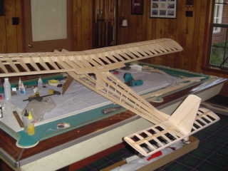

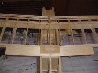

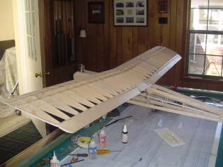

I got the tail finished! I spent all day converting the wing and fuselage so I can do away with the rubber bands. For the front of the wing I used a design as seen in a previous post to this thread (thanks guys). I beefed up the rear attach point on the fuselage with Birch plywood and installed 1/4" blind nuts and nylon bolts. I had to shim the fuselage sides to keep the wing from rocking due to the diehedral. The fuselage still has a lot of twist when you rock the wing tips but I believe this can not be avoided unless I install wing struts. Leading and trailing edges of stabalizer took a lot of sanding to shape as you start out with square stock. Saito looks nice sticking up proudly! All I need now is $100 worth of Olive Drab Monokote.

Hi PortCityFlier,
Your Tely is looking good. But in my own opinion it's ashame that you are going to cover all that fine wood work with a solid color and not transparent Monokote. Been trying to upload pictures but the dang site keeps erring out on me.
A little advice as you complete the tail feathers...Add an additional 2" to your rudder so that it'll be effective enough to prevent the airframe from veering off the runway with the slightest of crosswinds. I learned the hard way and had to cut my rudder off and add the two additional inches of surface length. It made a world of difference for me and the rudder was controllable clear down to a stop. With the additional torque that the Saito will introduce to the airframe during takeoff, you'll need it.

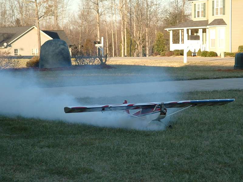

Portcityflyer, I have the plane you want yours to be, except mine is wraped with stars and bars...I customized mine also with a 11" bombay with side door, glider tow, two piece bolt on wing, rear mounted servo's, flaperons, 2X rudder, and a smoke system... This is my new favorite plane, she flies great with a OS 120 FS, with power to spare...I can't remember how to post pics so look in my gallory for a pic...Thanks Kneesaknocken

Ugh, I hate to tell you, but the star is upside down.
Old 03-03-2005 | 11:06 AM
Joined: Feb 2004
Posts: 96
From: Bainbridge, GA
Ugh is correct. I am trying to not stress over the star problem. I only look at the airplane when I am standing on my head.
Old 03-03-2005 | 03:36 PM
Posts: 121
From: Salisbury, NC
Who cares, as long as it looks good in the air, RIGHT!!!
