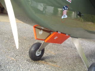

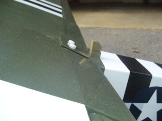

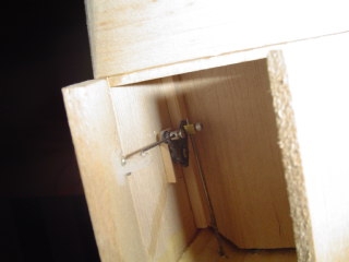

The following are the pics of today's progress. I used a bellcrank system to actuate the bomb bay doors. Two bellcranks being driven by one servo through a "Y" shaped wire pushrod. The doors look pretty awsome as they swing open and closed. They open to about a 45 degree angle which will be plenty to drop the gumballs and the occasional GI Joe parachuter. It took some real tinkering to keep the servo from chattering. If the doors open further it puts the pushrods in a bind and the servo starts dragging. All in all it is a very realistic and rugged setup. The good part is that the doors close flush and firm. I am now in the process of building a glider tow hard point. I am going to use the same receiver channel for the doors and the tow release. I will just plug in whichever servo I plan to use that flight. My six channel Futaba is one channel short for my needs on this airplane! (Flaperons are using two of my channels)

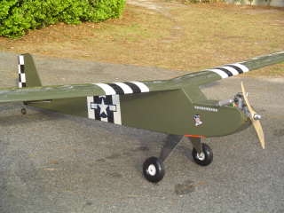

Well, here is the finished product. Two months of working a couple of days a week and three full days of work this week. I cranked the Saito up for the first time today. Man what a hoot. Sounds like it is just loafing along yet it is pulling like a mad man. I had a hard time getting the throttle set correctly and it still needs some tinkering. I ran two tanks through it today. The airplane looks really cool. I am going to get the local sign shop to cut me some windows out of gold vinyl. I am also going to get some registration numbers cut and a little nose art. She will be "Lucky Lucy" in honor of my wife! I am probably going to paint the landing gear with some olive drab spray paint.
I only have one concern at this point. My rudder and elevator are running on Futaba 3003 servos. These were the bottom of the batch (this plane took seven servos!). The rudder is smooth and strong but the elevator can be overpowered if I put pressure against the direction of travel. This is especially noticeable when the push rod is pushing. The pushing is when up elevator is applied! When the push rod pulls it has more power. Throttle and tow hook use Futaba mini servos and ailerons use Futaba high torque. Bomb drop uses and older Futaba standard servo. I sure do wish I had a half dozen Hitec 635's with Karbonite gears. Until I upgrade the elevator and rudder I will probably just taxi this baby around.
This was a fun project. However, I am glad to be through as all of my other chores have gone unattended for at least three weeks.

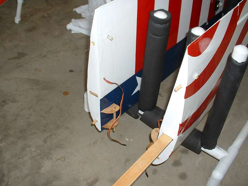

Finally, here are a few photos to inspire your two piece wing...Hope this helps...

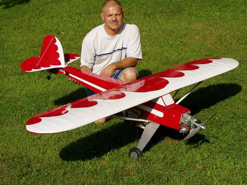

Great jobs on the Telemasters, I have one and was going to order foam wing cores and use alum. wing tubes to make a two piece wing.
However, I decided to go a different route. I bought a Kangke 1/4 scale Monocoupe with a G-26 that had the fuseladge broken in half.
I was going to fix the fuse, but when I took the covering off it was alot worse than I thought, and a replacement fuse cost $180.
I tore the center section apart, made a few more ribs and attached it to the tele's fuseladge, and the "Telecoupe" was born.
I also used the complete tail group from the Monocoupe. The white stripe's one the sides of the fuse are the actual one's from the Monocoupe.
Tha main gear was recycled from another plane. and the front end had to be wacked off accommodate the G-26 engine. I'm still debating on weather to make a fiberglass cowl for it or not, I kinda like the accessability to the engine.
I cut the elevator in half and used twin servos, also the rudder and elevator servos were moved to the rear to help counter the extra weight of the gas engine. Luckily, I didn't have to add any extra weight for balance.
I can't really say how it flies compared to the Telemaster or the Monocoupe, but I think it flies very well. I use it for a drop plane for R/C Skydiving.
