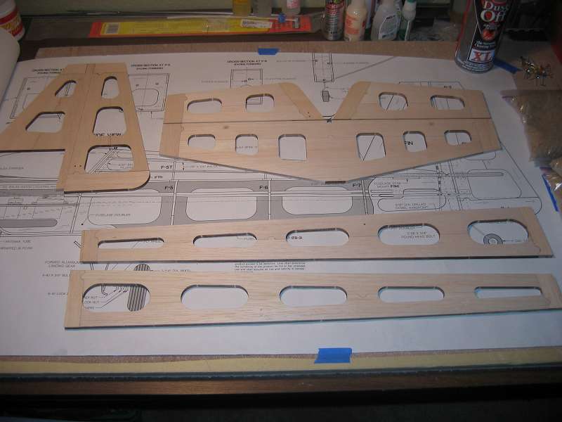

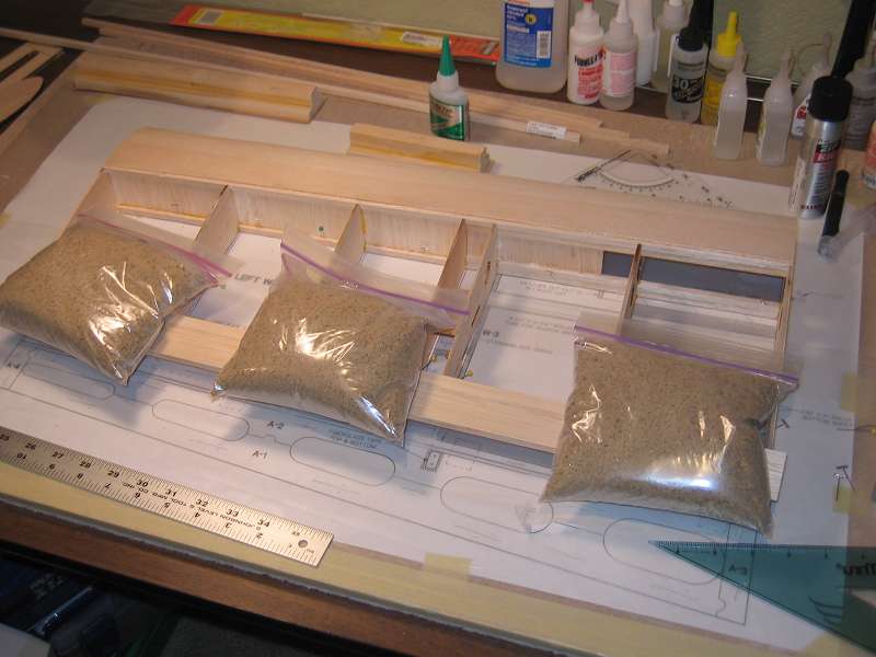

I've started building the left wing. This is how far I've gotten between yesterday and today:

Just a thought, but shouldn't you of put the tubes in for the wingtube and the servo wire first?

I think the answer to your question is no. If I remember right, the wing tube gets put in after you remove the wing from the building board and turn it over to sheet the underneath side. The instructions for the SE are very good and detailed, so if tychoc is following them, he will do fine.

aerobatixkid: No, according to the instructions you put the wing tube in without gluing it, to fit the shear web. Once the web is glued in all the way you remove the tube and it's put back in and glued into place, as hookedonrc points out, just before you sheet the underside. So far so good. I'm sure I will have questions as I go along, so I will post them here.

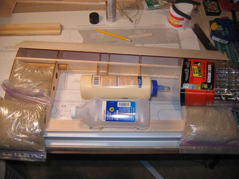

Moving along with the wings. Finishing the left panel and started the right.
I'm using a mixture of woodglue (Titebond II) and CA. Whenever possible I use the woodglue. Easier to sand and more working time to ensure a good fit. CA is very helful though in order to make rapid progress.

tychoc - What is in the bags? I have been trying to figure out what type of bags to use for weighting down items while I build. What you are using looks like just what I need...plus I can get different size bags for different uses.

Default RE: First build - Sig SE started
I went the cheap way. Two ziplock lunchbags filled with sand. Works great. No leaks yet.
Total cost: Lunchbags 2 cents each + 25lb bag of sand at Home Depot for $2.19....

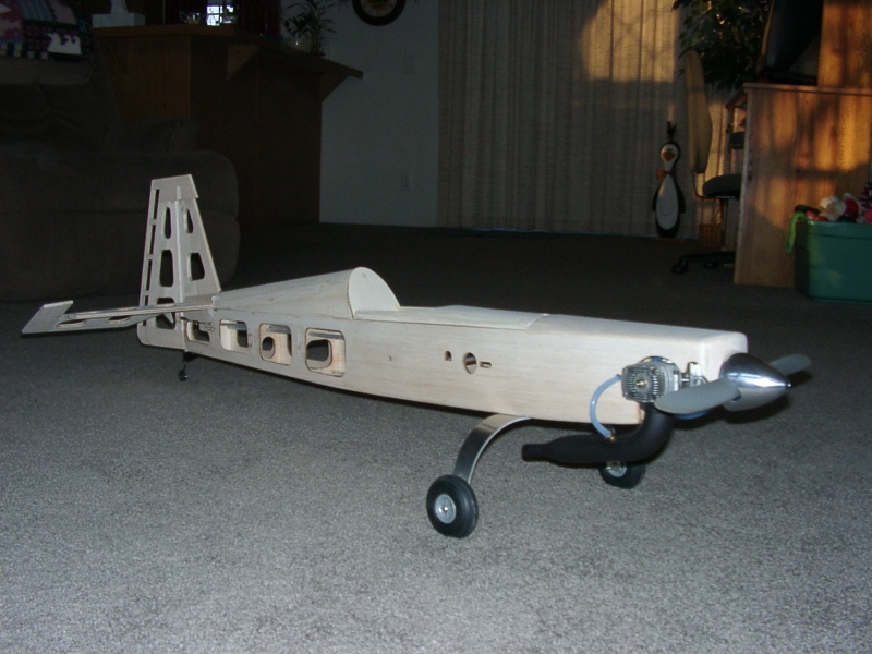

I used short pieces of the stringer on top of each bulkhead and sand to shape. lay sheeting over that.
Steve

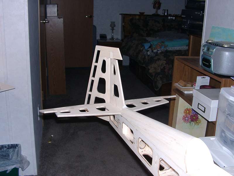

I'm glad I didn't increase the size of the tail feathers on mine, I built it stock and STILL had to add 6oz of weight to the nose.

h@h racing: The turtle deck looks nice!
Connery: What engine do you have and how much does it weigh?
In general, does the SE usually come out tail-heavy?
Today I've almost finished up both wings and started the fin and stab. So far so good - no surprises or difficulties yet.

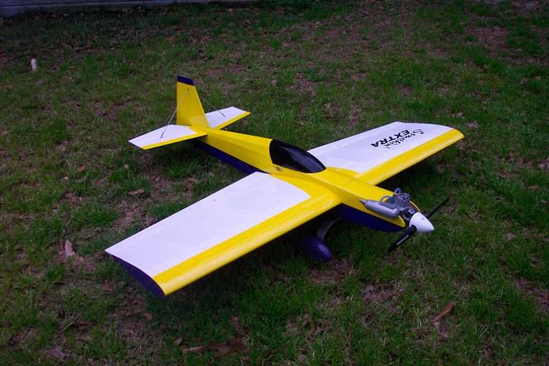

Not that much extra balsa was added. Fin and stabilizer were reduced and added to control surfaces. some extra was added to each also. Added a balsa cowl to the front so balance was not that bad.

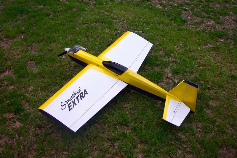

I managed to use to original fuel tubing holes in the firewall. It may depend on which tank you use if new holes in the firewall are necessary or not.
Here is a picture of my SE. I choose to build separate flaps in order to be able to use crow mixing. Great fun!
/Red B.
