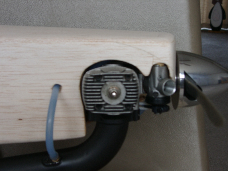

Wow, I'd really be inteterested in seeing that cowled front in more detail. Would you mind posting some close-up pics?
I'm seriously thinking about doing that with a Saito .72.

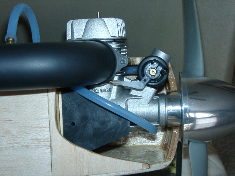

I had several pictures of the process of building the cowl but I lost them when my harddrive got corrupted (common problem on Dell laptops). And even being an IT person, it had been over a year since I had made a backup lol.
I used 3/8" balsa for the four sides. The engine to mount is rotated to 45 degrees. That was just enough to get the engine off of verticle and still have the muffler clear without having to have too much of the lower cowl open. Here are the steps I used to make it:
Cut the cheaks off the fuselage
Mount the engine
Cut a circle out of thin ply the same diameter of the back of the prop spinner, then cut the center out to clear the prop hub.
Mount the spinner and use a little CA to tack the ply circle to the back of the spinner with some small 1/16 or so spacers.
Make some measurements from the firewall to the back of the ply circle and cut out the 3/8 balsa to fit around the engine.
Once the rough shape is in place, permanantly glue the ply ring to the cowling and remove the spinner and engine.
Sand to shape from the squared off fuselage out to the ply circle
Mount the engine

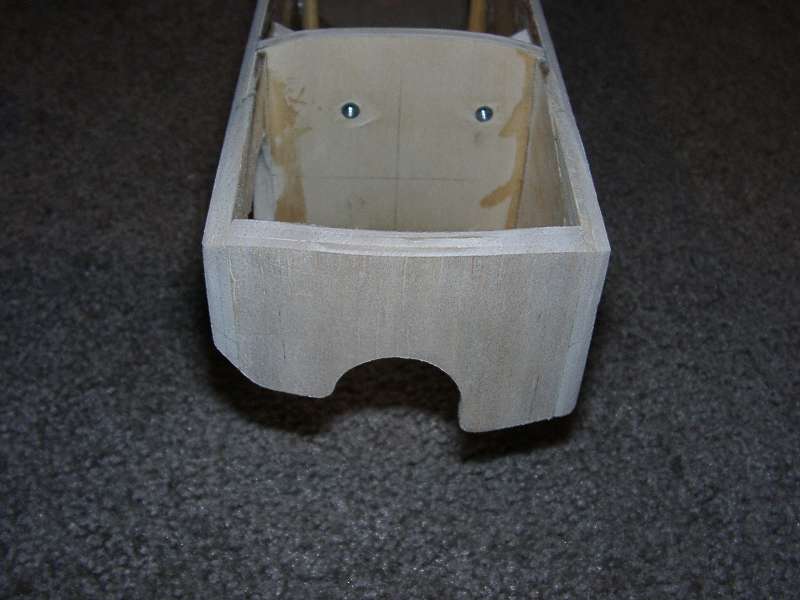

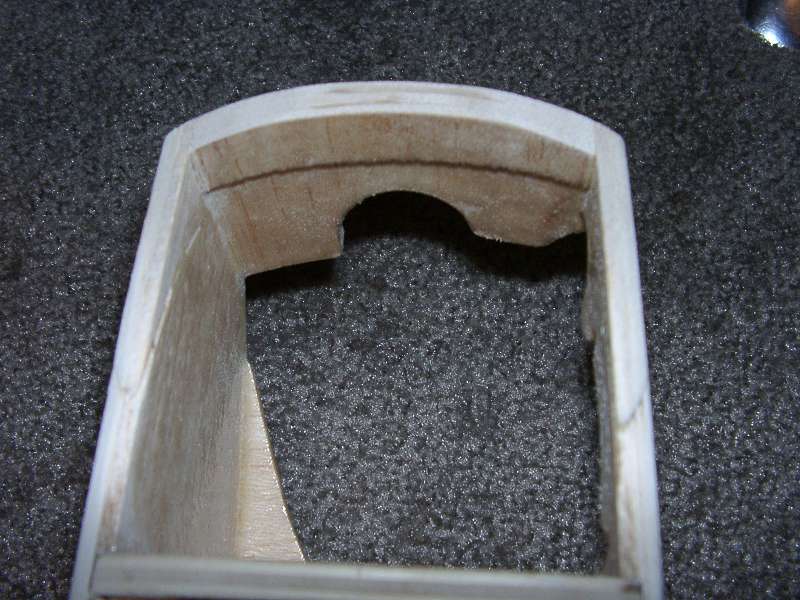

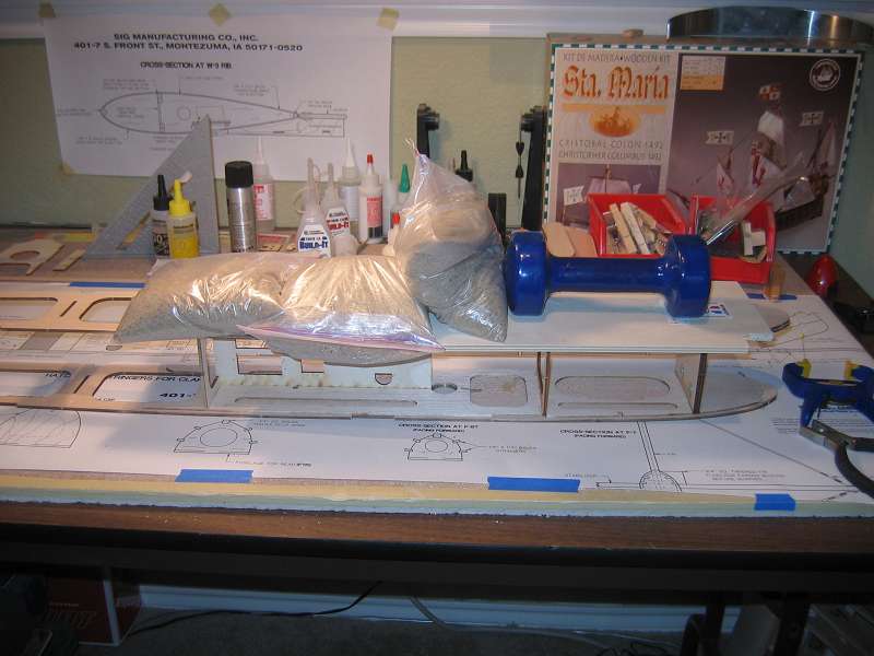

Not much time to work on the SE this weekend, but I did get the fuse started.
I haven't come up with any covering scheme yet, but from what I've read I think I will use UltraCote. I'm a little worried about doing a good job. Is the [link=http://www2.towerhobbies.com/cgi-bin/wti0001p?&I=LXHZ84&P=7]video [/link] that Tower sells any good for teaching a beginner?
-tychoc
-tychoc

I extended the sides with parts from the kit. You took the sides of the fuse out of the lazer cut balsa sheets. This extra from the sheet is what I used to extend the sides. The front is made out of balsa sheet and formed to get the curve and two pieces laminated together and cut to size to fit between the sides. The top is one sheet from the front of the hatch to the front of the cowl. It was soaked with water and taped to fuse to form the top. I will get pictures of the bottom at lunch and post. The bottom is open for access to the engine.

A couple more questions:
It looks like the top is permanently attached. Do you have any trouble accessing the motor mount bolts or the motor mounting screws? Have you got pix of the right side and bottom with the engine mounted?
I'm in the process of trying to do this with a Saito .72 and can't seem to quite find the combination of structural integrity and access that will let me access all the hardware and still get the motor in/out. It's looking like I need to attach the motor to the mount and then put the mount in the plane. And the throttle linkage is a *real* picnic [sm=spinnyeyes.gif]

Top mount is installed first then engine is installed to top mount. Access for screws on top mount are through the space between the head and the side. Install bottom mount and tighten all screws. Top engine mount to firewall screws are accessed before the engine is installed. It can be a pain to get all the screws where they need to be but I think it is worth it. The engine mount is the mount that came with the kit drilled to fit the engine then blind nuts installed in the mount. 4-40 socket head screws and flat washers hold the engine to the mount. With the socket head screws you can put them on a allen wrench and through the space above the head.
There are two places that make fiberglass cowls but could not get a good picture to see what it looked like on the plane. Also the cowls were built to fit with the engine setting upright.

Ahh - that's the trick! I never thought about blind nuts and sequenced installation.
That's a really nice piece of work you've got there - very clean. I was half way thinking about looking into the cowl until I saw yours. I had just assumed that the glass cowls were for a side mount, but hadn't been able to locate a picture. Besides, the challenge of custom construction is half the fun, right? Thanks for the insight, I'll try and get some pix posted when I have something to show.

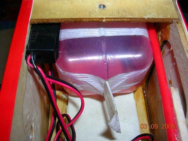

Someone here has suggested a 4*60 gear to replace the original. This is a cheap way to replace the gear. I have seen a pic here on RCU of an SE ith this gear. I was thinking of doing that.
As far as the tank is concerned, I replaced it with a Sullivan flex tank. I made a handle out of some nylon reinforced tape, then wrapped the same tape around the tank. This way you have a little handle to hold on to get your tank out. I will post a pic tonight when I get home.
Bill
Bill

Here is a pic of my tank.
With the tank being flexable, it helps when removing it.
The tape just gives you a handle.
This has been like this for 3 years and no problems.
Bill
Bill
