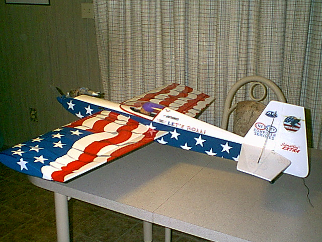

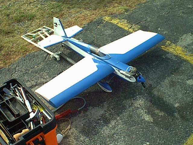

I've had two SE. The first I covered like the box. The second one I did a 3D Flag as suggested elsewhere here on RCU.

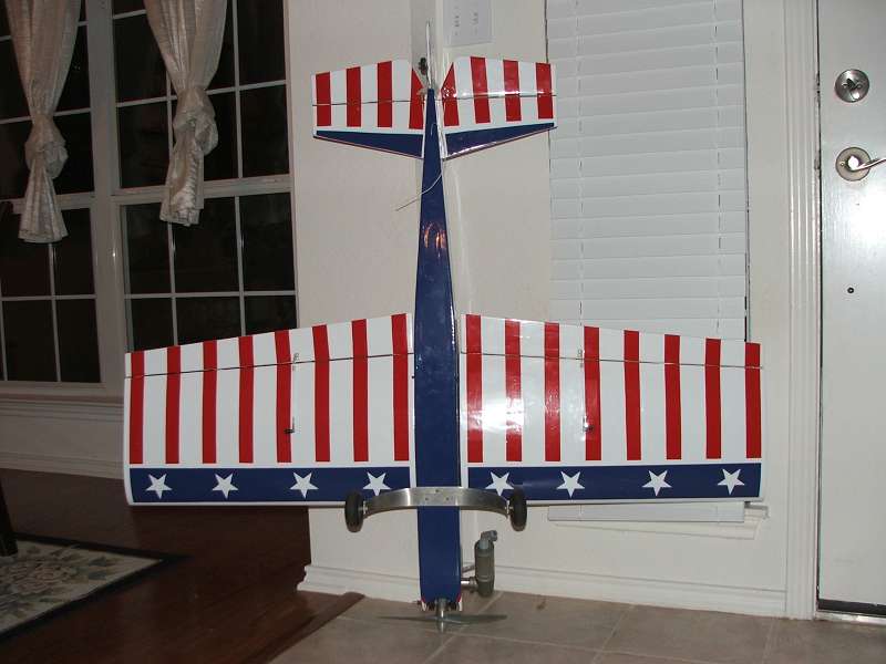

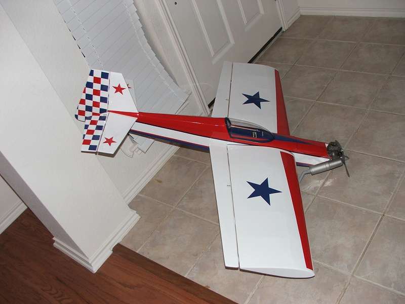

Here's my recently recovered SE. Flies great!! I decided to use up my red, white and blue ultracote...

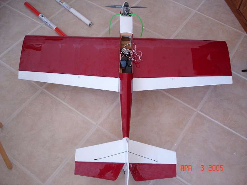

Here is mine, its almost done. Just need to finish canopy, and radio install and a little more trim on the covering. I have an OS 70 fs on the front and a Carbon fiber landing gear.

I think that is the best looking 3D Flag I have seen so far!!! Good Job!!!
