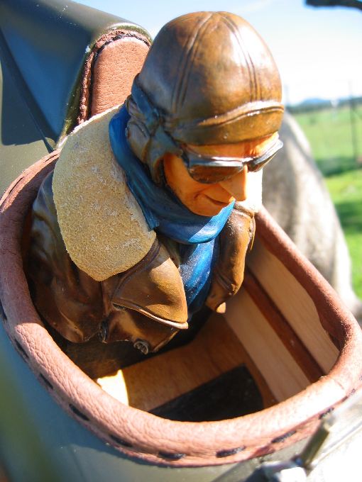

I love this kit, but do agree that some mods need doing. The upper wing is to high and the top of the fuslage slopes to much, due I think to errors in drawings published by Model Aircraft News.
Have a look at my Photo Gallery and let me know what you think. I have won first place with this for stand off scale at the 2005 Coffs Harbour Scale Rally. I installed the motor upright and routed the exhaust out the scale pipes. I will post more pictures when I take some.

That looks great, I would love to see more pictures. And lots of details of what you did and how you did them.

Mcubed, The changes you alluded to have been discussed here. You may be the only one whom has actually performed the changes and could comment on what you did and how it affected the airplane. I have this kit and will be starting it soon and am most interested in any comments you could make.

Here are some more picks. As you can see I did a lot of work around the nose. The next one I build I will modify the whole fuse in line with the correct silhouette IE reduce the hight right through as the hump I now have at the cockpit is to high. I have had no trouble with the tale wheel but did reinforce it during the build. I always fly of a grass field!
Reducing the height of the fuse realy accentuates the fact that the upper wing is to high, I have not changed this on this model as it will require a major refit to fix. The markings on my plane reflect the real SE5A which resides in the Australian War Memorial in Canberra Australia, this is where i also got most of the nose detail.

Mcubed, beautiful job. Pilot and plane look great!
