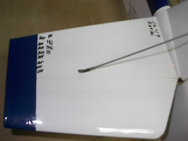

Dale...Below are a few pics of one of my old SSE's that is starting to show it's age (built on a TV stand during one of my cross country moves). The receiver battery is braced just ahead of the landing gear mount block. I hear some people are building hatches under the fuel tank and that sounds like a great idea. If I had done that on this plane I probably wouldn't have needed the heavy hub to balance it.
The other pic is just a picture of the stabilizer where I always write the channel #, weight and make a little mark for each flight.
Damon
Edit---Wanted to point out the aileron and elevator hinges are done with Monokote and have held up for almost 4 years and almost 60 flights. A lot of people boo hoo this idea but I'll tell ya, there is no chance of flutter and it doesn't look like it's anywhere near failing.

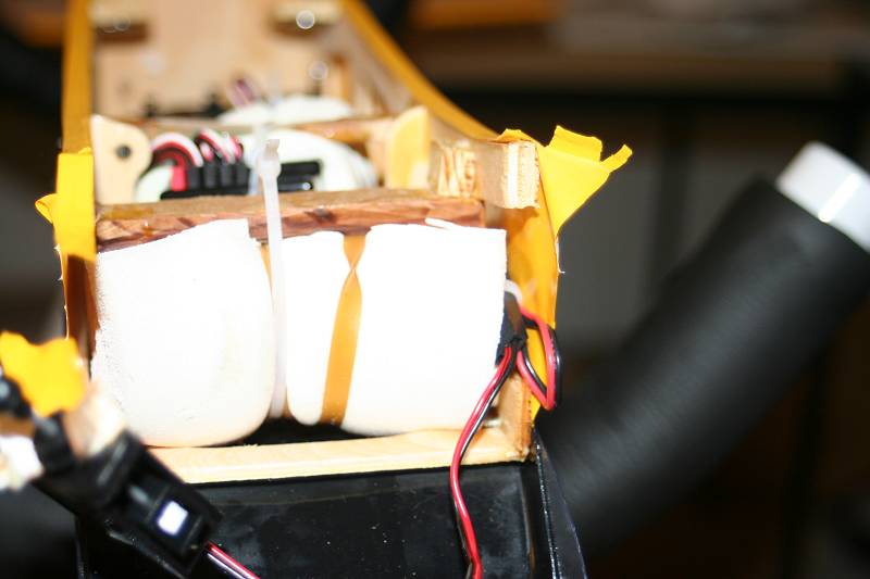

I was playing with the idea for a hatch for the tank compartment and/or battery up front but decided to scratch the idea on my first build. Partly because the manual discouranged this due to structual strength, although, I've seen many having at least done the tank hatch.
I'm at work now, but my battery installation basically consisted of putting a piece of velcro up front under the tank. The battery is stuck in there pretty good now, in fact, when trying to remove it I had to use a flat metal ruler to release the grip of the velcro since there's not enough space to get your fingers in there.
I'll see if I can't post a picture later tonight. The more I read, the more convinced I'm that putting a hatch in is generally a good idea. A little planning/work up front could possbly save tons of work later

Mine came out tail heavy as well. I put a 2oz prop nut, moved the engine forward on the mount and added an additional 1 oz of lead to make it balance. Sounds like you should get close with the heavier engine. Just don't drill the engine mount holes until you're ready to balance it. That way you can shift it around a little to balance it.

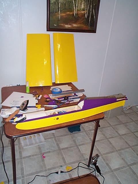

Got the manual and the plans so construction is complete. Started covering today. Using Oracote, (British product) and so far, most impressed with this covering. Low heat, super shrinkage and wild, flourescent orange color.
Covered bottoms of both wing panels and the eppange. Fuselage dark blue with white rudder and elevator.

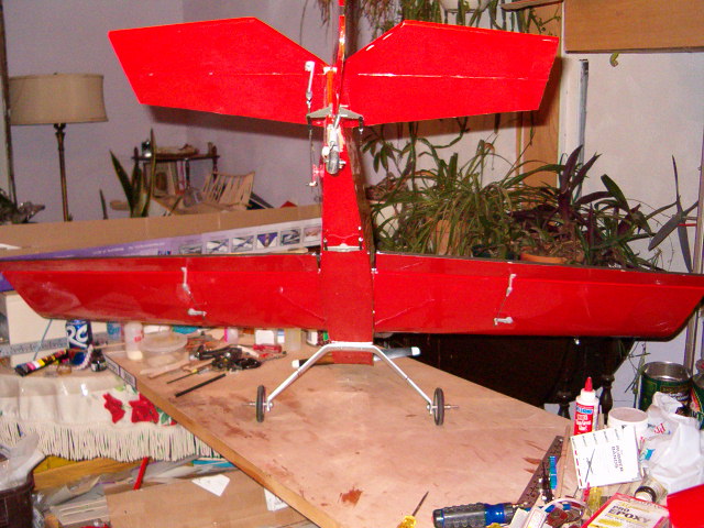

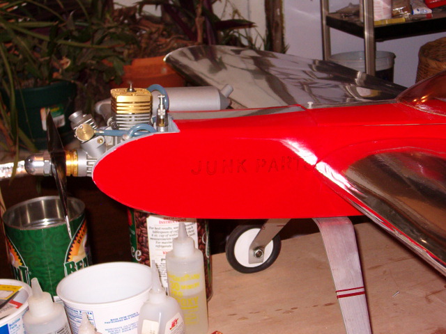

Hi Guys
Finally finished mine !!! Not the best color scheme I've ever done but overall I thought it came out alright for someone who has not built a kit plane in 15 years. I will go over it one more time to make sure I did not miss anything and will try it out on Wednesday if the weather permits.
Hey Manny... Hope yours comes out well. Send us some pics soon !!!!
I would like to thank everyone on the thread for their help and support to get mine finished.
Posted some pics below.
