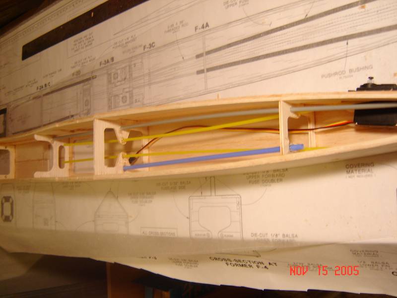

For some reason I can only upload one pic at a time... Here's #1
The small hole in front of the servo is where the strobe on the left will be, The small yellow tube under the servo is one of the rudder cable exits, the other gray tube is the antenna tube.

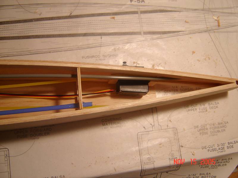

Here's #2.
From the inside you can see both rudder cable tubes and the gray antenna tube, the extra blue tube will house my wires for the rear strobes.

And one more.
I didn't take one of the right side... the only thing to see there is another strobe mounting hole directly opposite of the left side and the rudder cable exit. [8D]
I still have a bunch of lightning holes and etc... but it's a start.
#109
Keith,
Your build is really shaping up. Thanks for sharing the detail photos of your fuselage plumbing. I also like the looks of running the antenna through the fuselage in a self contained tube of it's own. I've never tried that but have heard that running the antenna through the fuselage works pretty good and it does make for a cleaner looking finish in my opinion. The strobes are a neat idea that I'm sure will be worth the effort.
Keep up the good work....

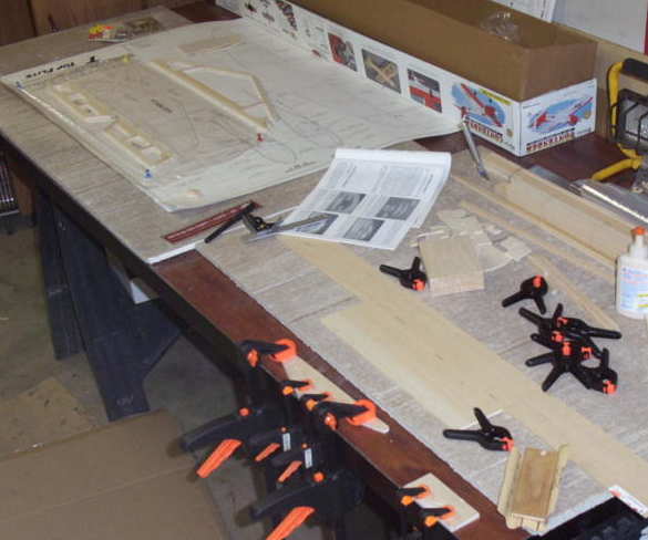

Hello Crowd:
I am going to attempt to attach 2 pics of my first day of progress. I got the parts cut out for the Horziontal Stabilizer and elevators. Took 2 1/2 hours. It was fun.
Ist mistake: Cut some pcs. of the H. Stabilizer out of basswood instead of balsa as the plans call for. Re-cut out of balsa. Glad going to LHS today. Maybe I'll settle down a little.
I set my digital camera to e-mail resolution. Let's see what happens.
