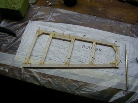

I did enlarge my rudder a little bit but I didn't increase the height of mine. I just kinda added a little more angle to "sweep" it back some. I just didn't like the way the stock rudder looked.
I'm not positive as to which tank I'm going to use on mine yet it's still to early in the building process to tell for sure. I've got a 10 oz. Sullivan Flex Tank laying around and it looks like it'll work by the plans but then again I won't know for sure until the fuselage is built.

Mike: I built my rudder just like you did. I will post some pics. tomorrow. I have finished the elevators, horizontal stabilizer, rudder and rudder fin. I have the wing plans laid down and covered with Saran wrap. It works great, nothing stick to it.

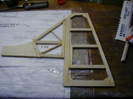

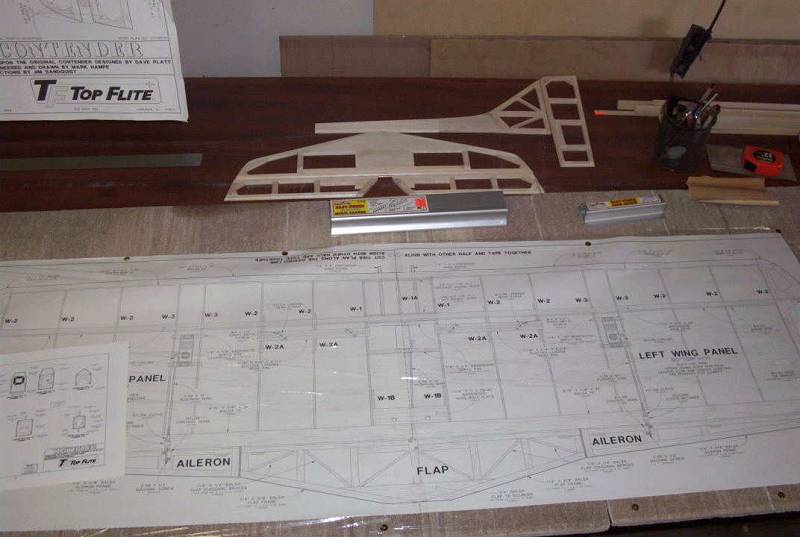

Here is pic of progress so far. I did not enlarge redduer as much as Mike did. Now, I
wonder if that was a mistake. Anyway, some progress. Got the wing plans laid down and covered. Ready to start. Kinda scary, haven't built a wing in a long time. Will separating ribs, parts etc. tomorrow.

Your rudder looks great, no mistake there. The rudder shape you've done should be just fine. Good Luck with the wing I'm sure you'll do well, just take your time pay special attention to left and right objects, such as the landing gear blocks as an example.

Read the instructions throughly before starting wing. The spar that is on the paper plan is a dry fit, it is not glued until wing is flipped over. I started my wing and had to quickly pull up the whole mess to free the spar before the glue set.
Built many wings but never had that type of construction. I just dived in and missed it. Always pays to read.

John, Mike and Scott, thank you for the tips. I will carefully read the instructions. I am glad you pointed out about the "dry" fit on the spar. I would have glued it for sure, I think. John, I think I am going to go with the 10 oz. sullivan. I don't want to get too complicated on my first kit. I am going to see if Sullivan makes a bubbleless, bladder tank. I like the idea of the bladder, thus no air. No air, no bubbles.
Scott It looks like your covering job is coming along well. For me, that's going to be the scary part. I am looking forward to the challenge.
I won't be working much on the plane until Monday. My kit was short the 2 ea,. 1/4" x 3/8" x 48" Basswood spars. I ordered them from my LHS today.

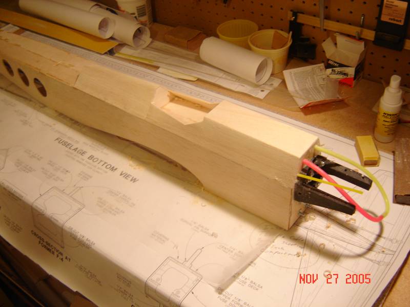

This build is going very good, so far. I have attached two more pics. I am still waiting on the 2 pcs. of 48" basswood for the spars for the wing. While waiting I decided to assy. the fuselage, optional wingtips, etc.
I assume when I glue in the firewall that I won't have to make any adjustments to it. I will be installing a .61 OS FX. I have purchased a Sulliavan Dynamount Soft Motor Mount.
The engine is dampened with rubber mounts to eliminate a great deal of vibration.
With the stock muffler I can swing the engine 90 degrees and it will clear the bottom of the firewall only if I lower the engine down from pre-marked holes by about 1/8". Do you think this will affect the thrust line enough to be detrimental?
I am a little concerned about muffler ground clearance. The muffler will be running right in line with the R.H. bottom seam of fuselage, so I think it will be ok. It will be blowing fuel underneath and between the main gear. I will not make any decisions until I am further along, wing built and mounted and gear attached.
I am depending on you guys to help me if you note anything either in my comments, pictures or just from your experience.

Your fuselage build looks great so far. I've been a little stalled on my build do to work however, tomorrow I plan on flying in the morning and then continuing my build in the afternoon for a few hours anyway
For my engine placement I plan on doing some experimenting with motor position once I have my fuselage started. I'm no expert by any means but I don't think an 1/8 inch would be that significant.
Happy building and once again your build is coming along nicely.

I agree with mike... I don't think 1/8" will make a difference. I thought about lowering my mounts to do the same thing, but I would have to go about 3/8" -1/2"... wasn't too sure about going that low.
