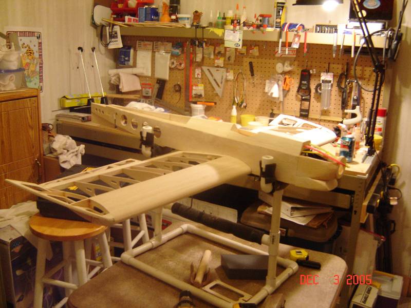

Too cold in the garage to do much today. Ready to deck the bottom of the fuselage. I have been thinking about moving the elevator servo toward the rear to help with cg. The .61 is heavier than the .46 and I don't want to have to add weight to the tail. I was considering making a hatch on the bottom of the fuselage, between formers F4a and F5a, for easy access to the servo if I decided to move it to the rear. Can anyone with a finished Contender tell me if they tend to be nose heavy with a .61 or just nose heavy in general? What do you think about moving the elevator servo to the rear?

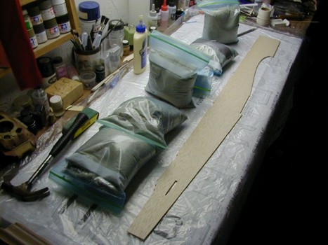

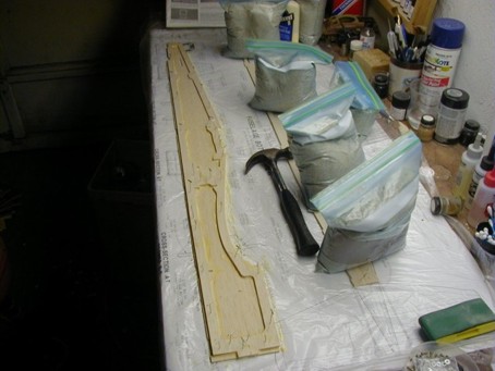

Well... It's snowing here both outside and on my work bench. Been working on carving, sanding, scraping, sanding and did I mention sanding on that cowl and scoop. [:'(][:'(][:'(][:'(] Think I've just about got it done. Gonna park it for the night and take another look at it in the morning before I post a pic.

Keith, you have done a whale of a job. It looks terrific. You wing to fuselage joint is perfect. I hope mine will turn out close. I am taking my time because it has been so many years since I have built.
I am still trying to decide whether to go 90 degrees clockwise with the engine or not. You picture of the finished cowl has been very helpful. I think I might be getting into the lower portion of the cowl which would have me cutting into the duct lower portion and I don't think that would look good.
Great job, thanks for the pic.
